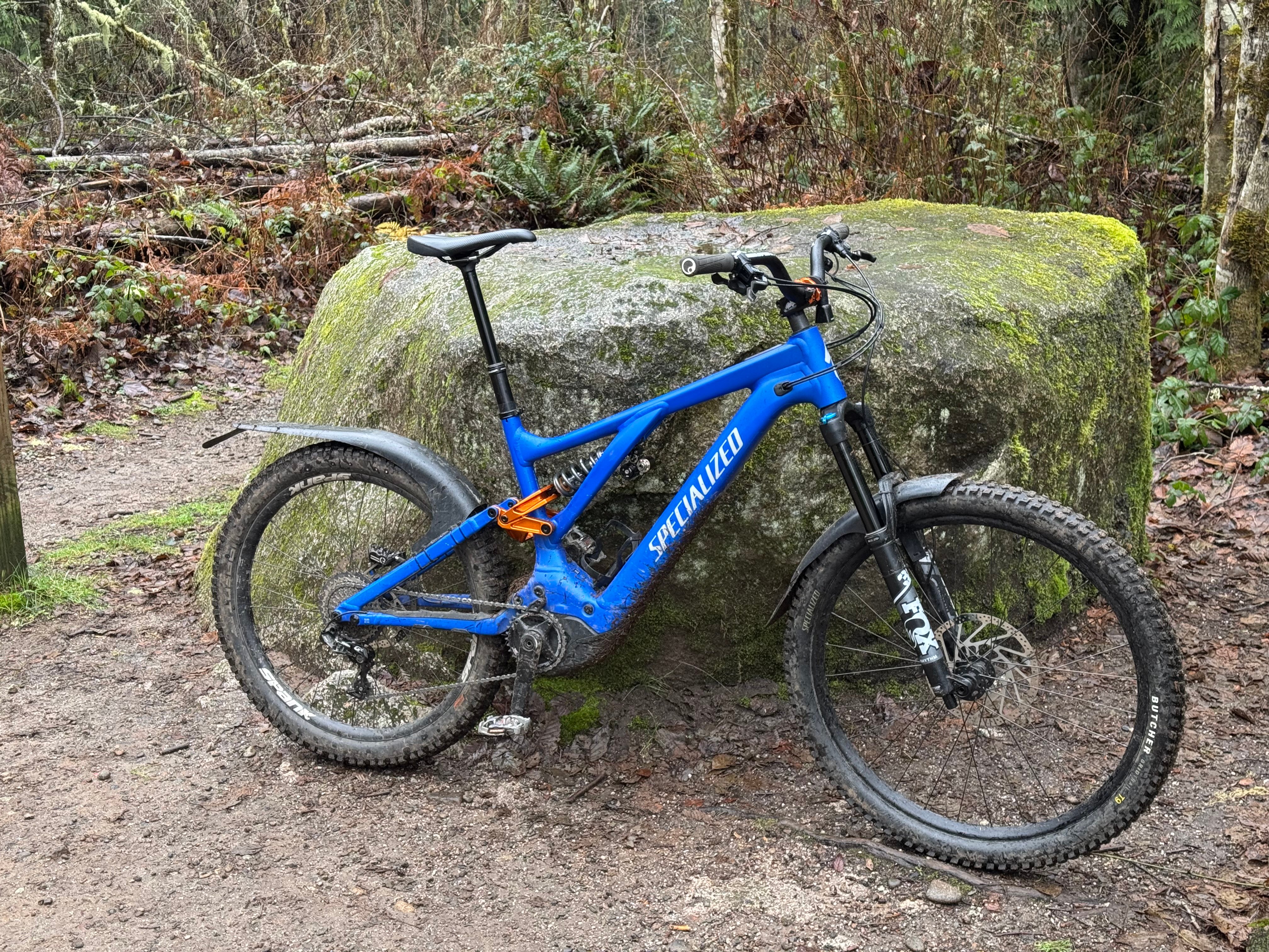

I narrowed my bar to 760mm. Shortened the stem to 45mm. Added fatter grips. Cranks reduced. Dropper increased. Moved my seat around. Angled my brakes. Adjusted the AXS shifter reach. Longer forks. Bought new riding glasses (didn’t help btw).
I’m sure I’m missing something?🤔…but it finally feels good 👍🏻.
And that only took 3-4 years. 😉
