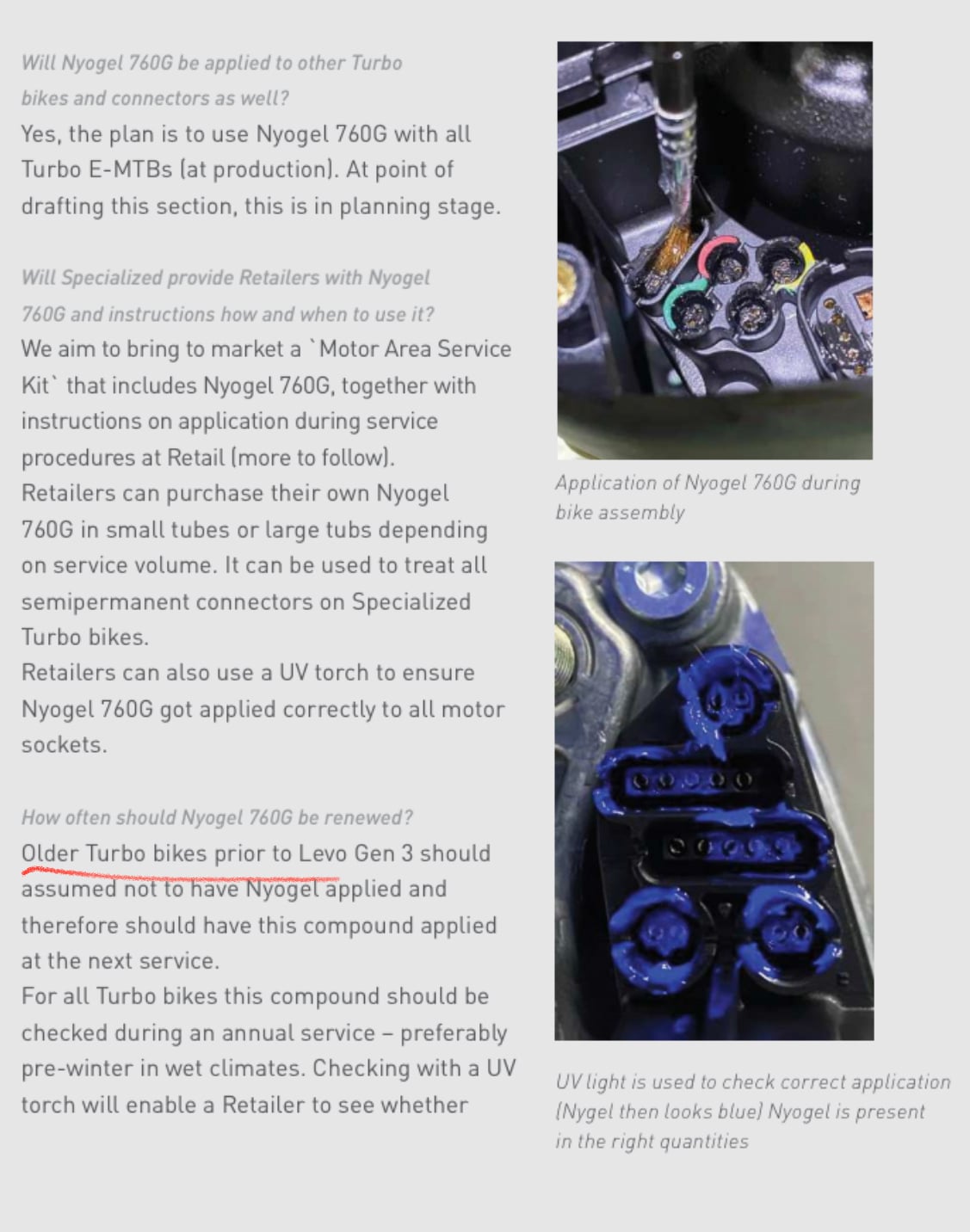

I use this stuff, but very sparingly. BC5FD38F-B633-4C1A-A9FF-6E5D666677B6.jpeg
I try to remember that if water gets in…it also needs to get out. I’ve probably been lucky because I have completely submerged my bike several times. The area I was most concerned about were the connections in the motor. I did not apply dialectic grease directly to the small metal connections but rather the rubber seal which may help keep water out. It seems to work.
Other area’s or connections seem impossible to protect.
