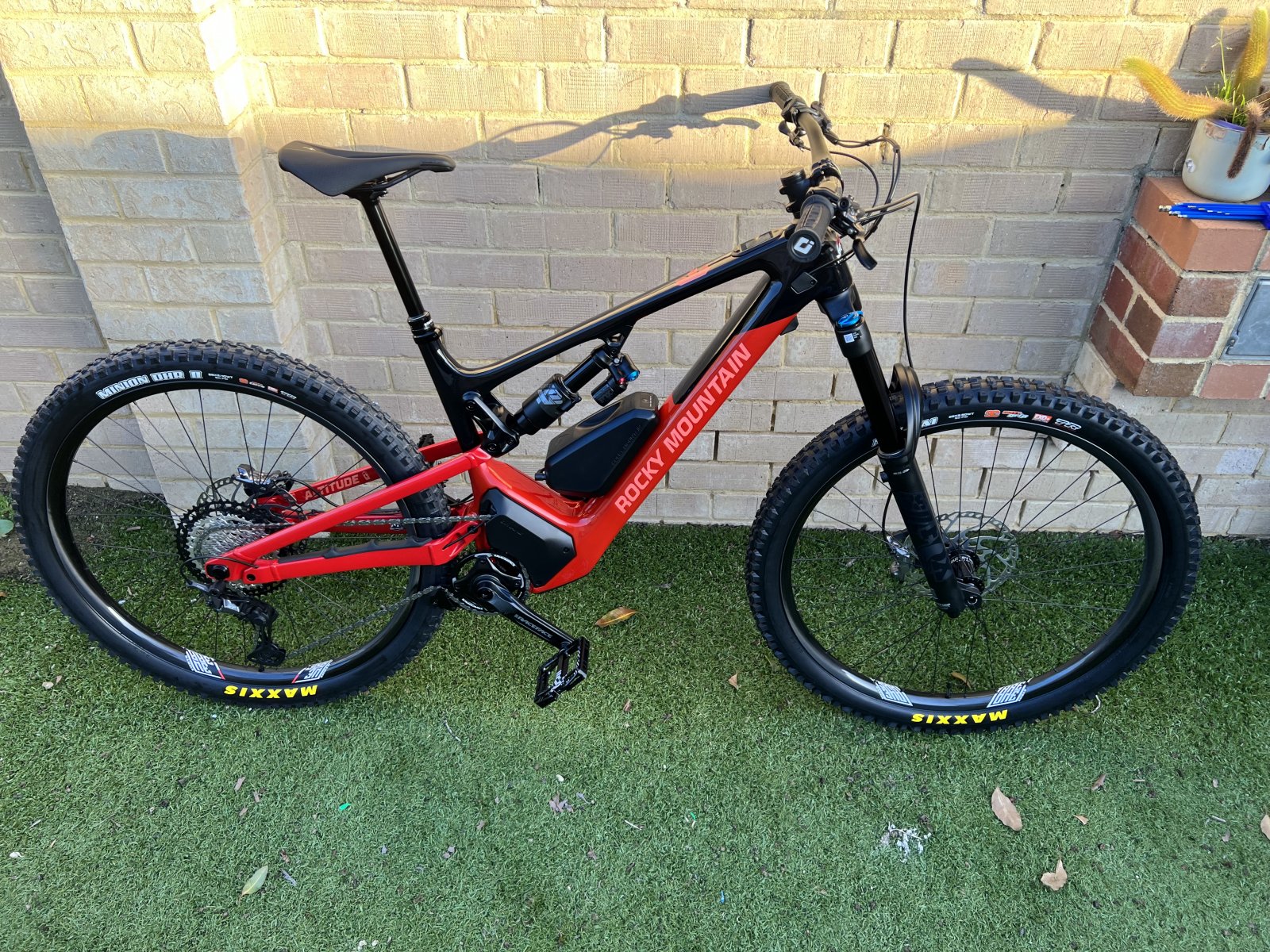

Hi. I just bought an Altitude C70. Bike feels amazing, being 23.5Kg size large with pedals I can manual it super easy (my old bike was a Giant Trance e+ and was super hard to manual it). Engine is great but I can’t feel it stronger than a Brose tbh same power delivery feeling. Definitely worthy the money

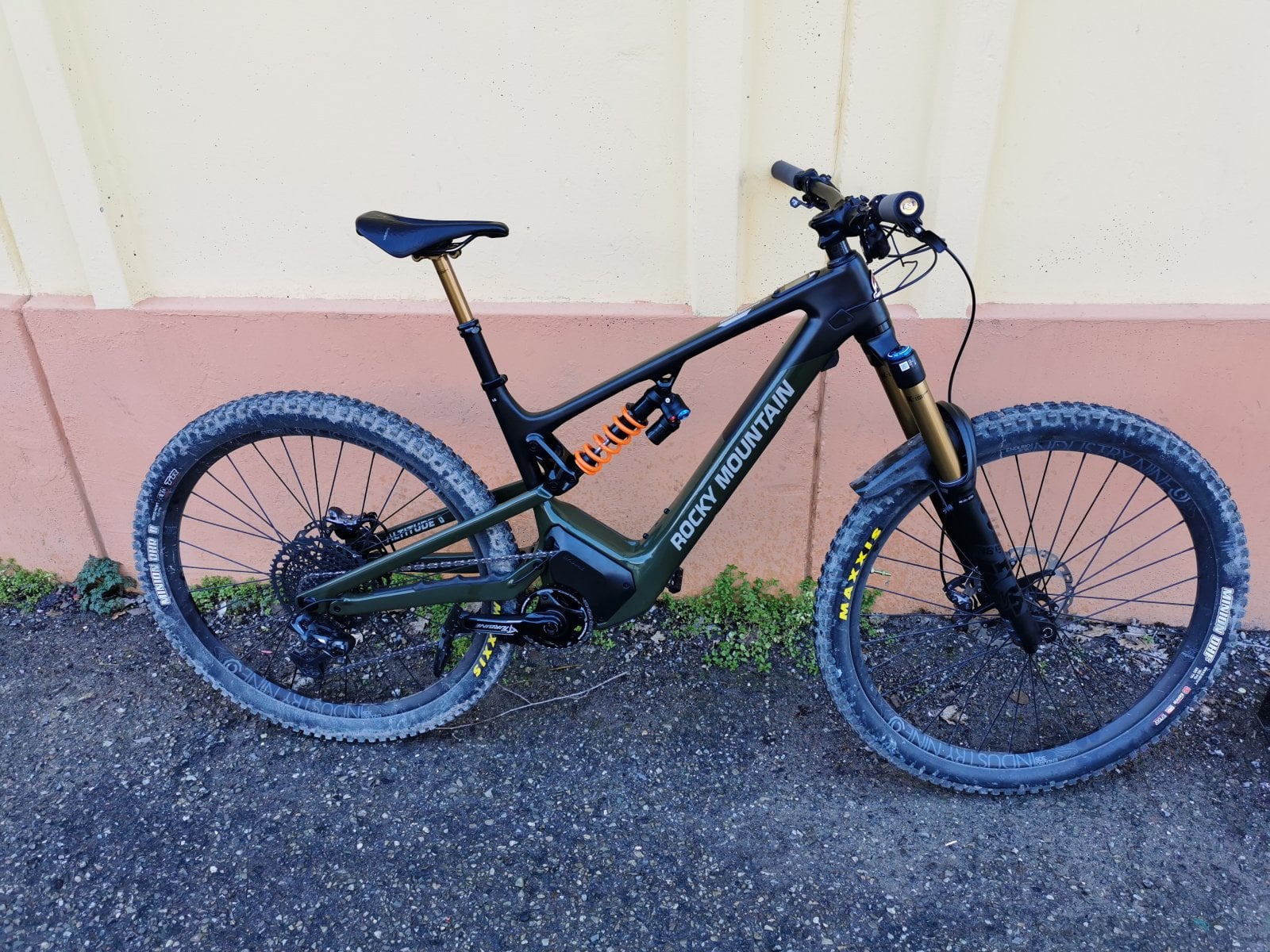

I am very satisfied with mine, although I would have preferred the C70, which is much easier to set up at the suspension level. But this one came first and I'm certainly not complaining :)

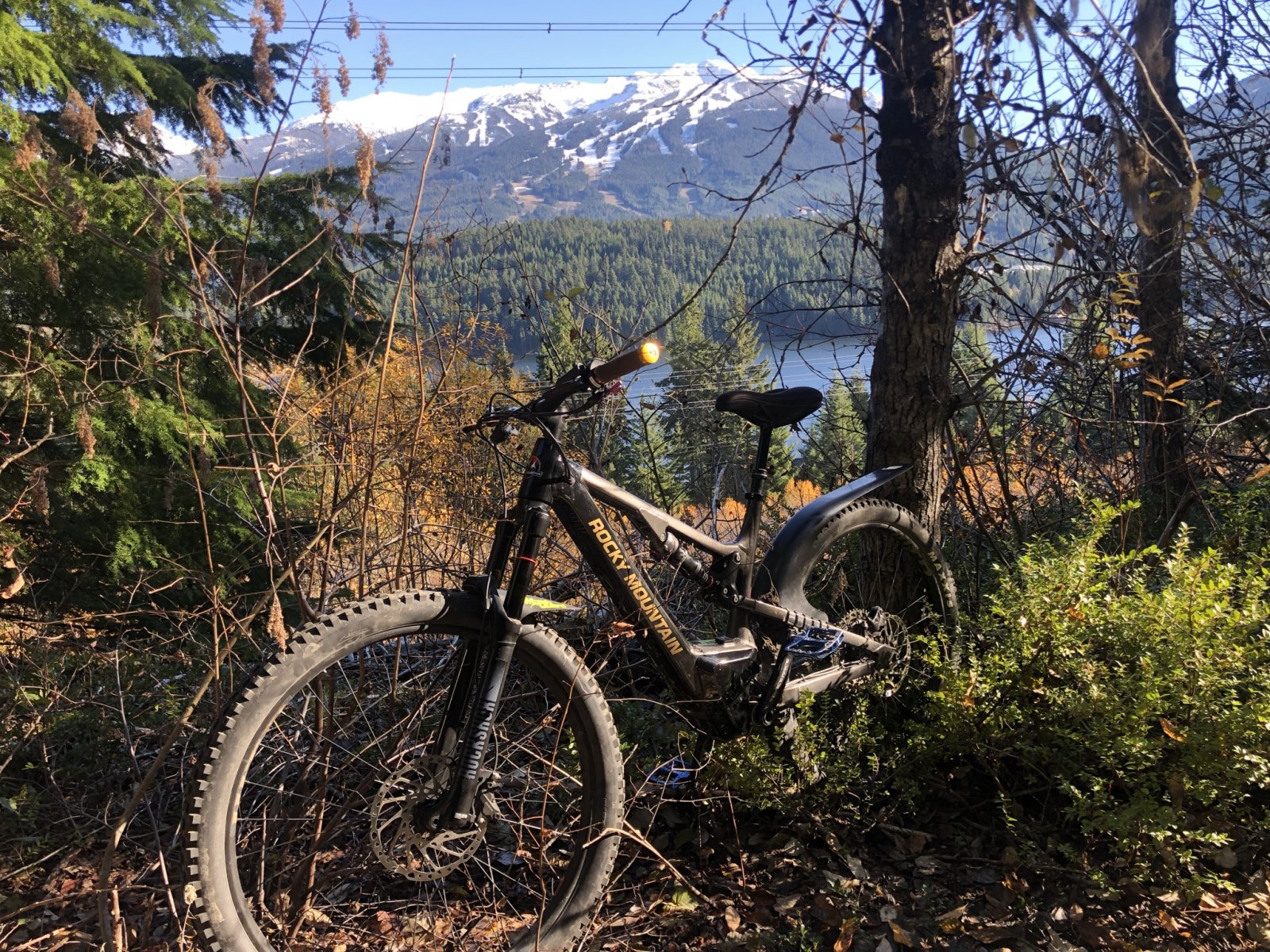

Picked one up at LBS a few weeks ago. I have spent more time fiddling with it than riding it but it is getting to where I want it to be with a couple mods and fitting almost done. Going out in a few minutes to get some more seat time and to make minor adjustments if needed. The power is awesome. Wish I could say more but so far it’s been great.

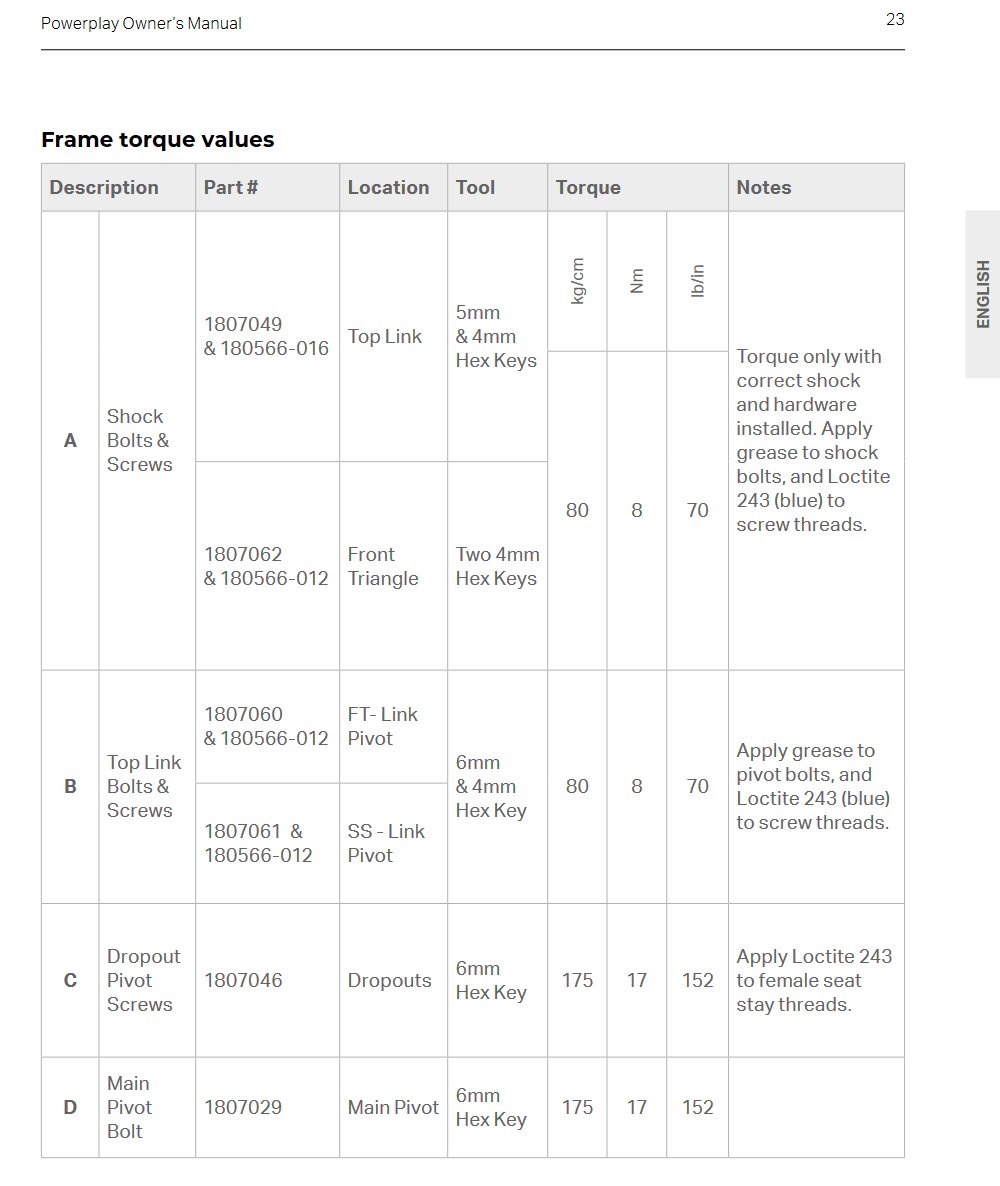

Great review man 👌. Let me ask you one question: could you somewhere find official information on the nm for all the different bolts on the Powerplay Instinct? I tried but could not find anything 🤷‍♂️
Thanks, and no. The factory manual doesn't provide the values and I don't have any source for a master list of values. I just use best judgement. If the bolt is aluminum I really try to be careful. The stainless bolts I'll stung up pretty tight. If you do find something, please share with the group. 🤙
I found this chart in the 2018-2021 Powerplay manual. The 2022 PP manual doesn't have the frame botl poundage listed only things like the cranks, stem, pedals etc.
