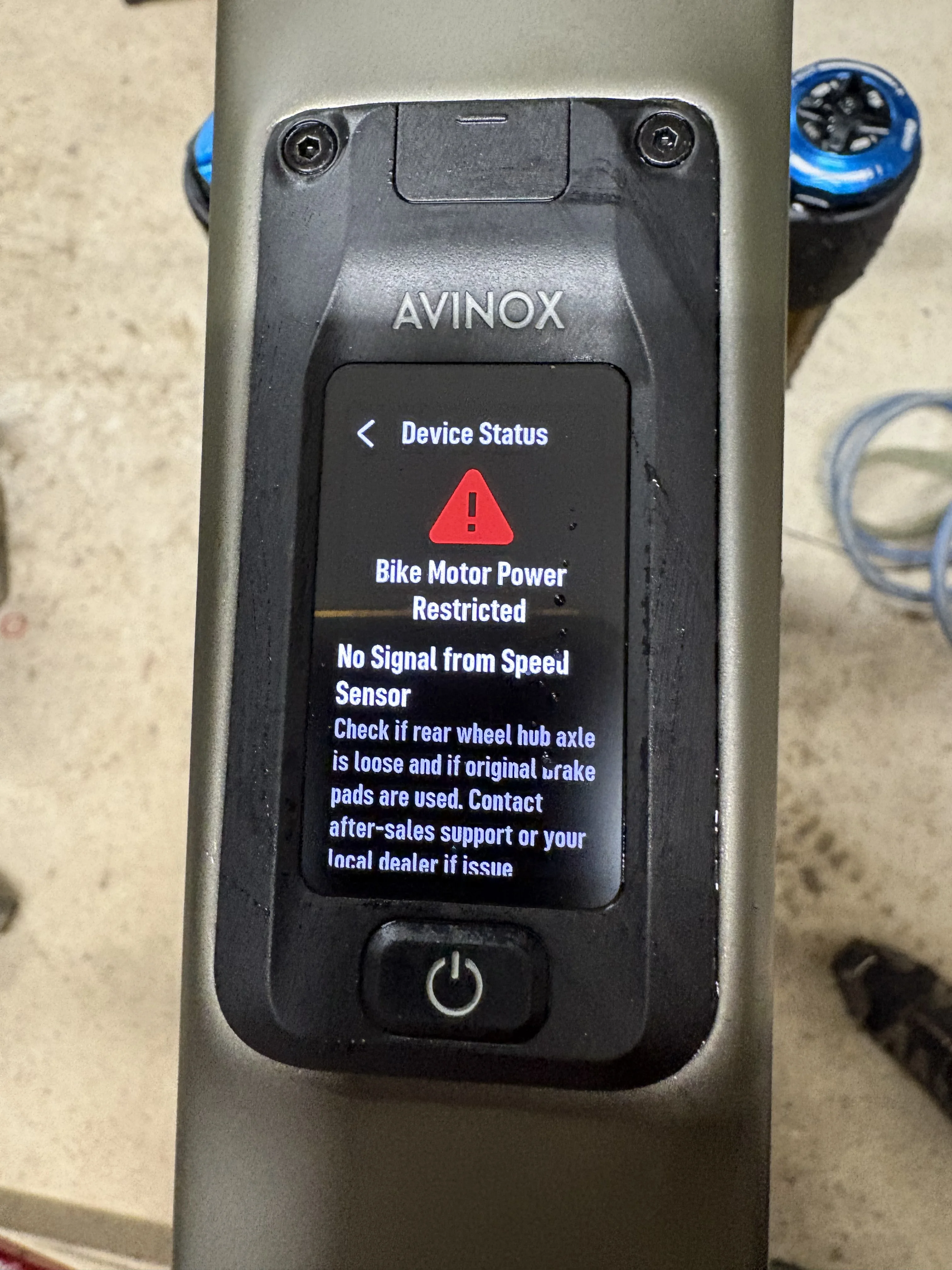

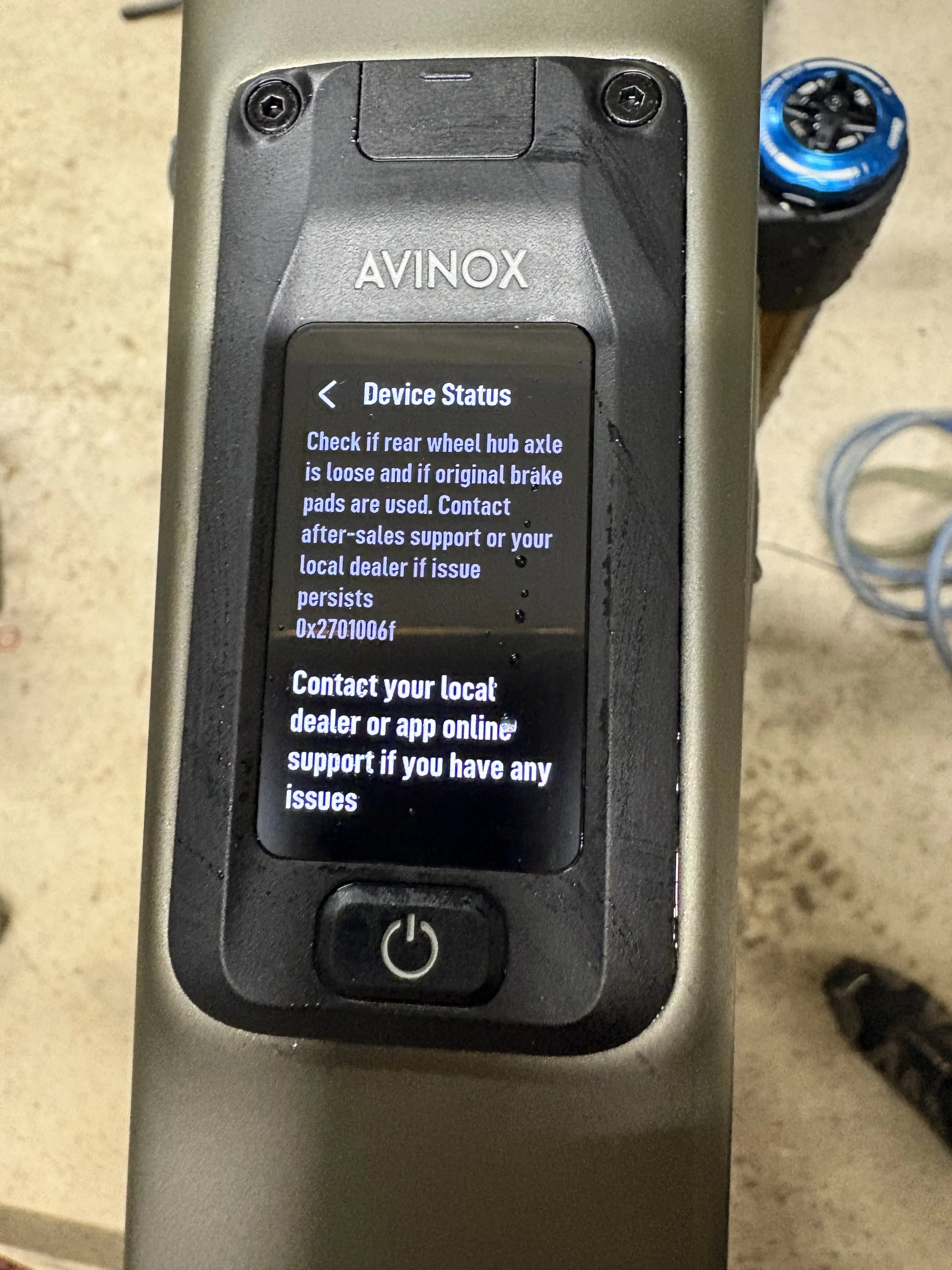

Amflow speed sensor 0x2701006f error code
PeterEden
Apr 16, 2026
8
What is the final and best solution for the Amflow speed sensor 0x2701006f error code? Replacing the speed sensor doesn't but replacing the motor does according to many people.
