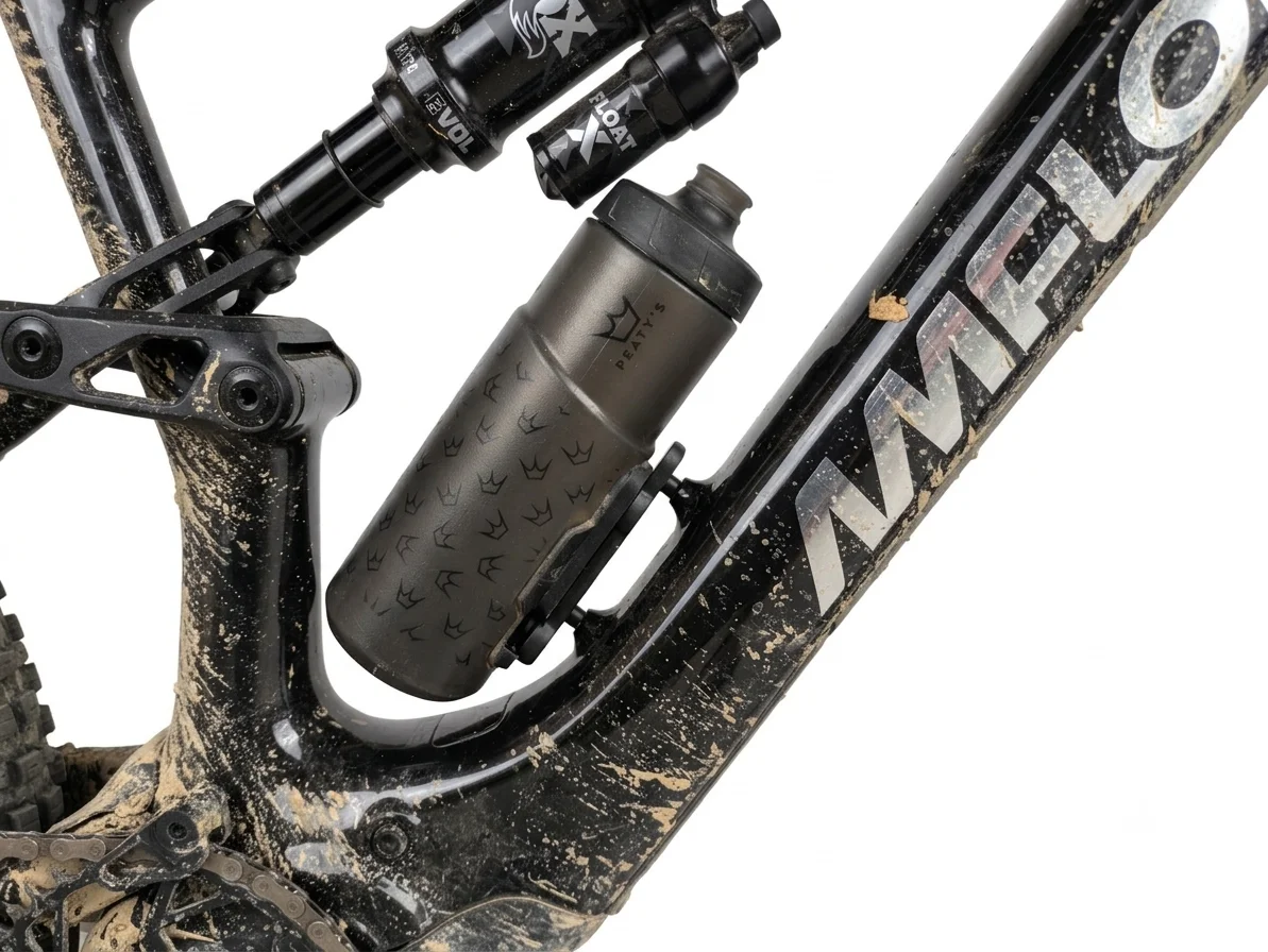

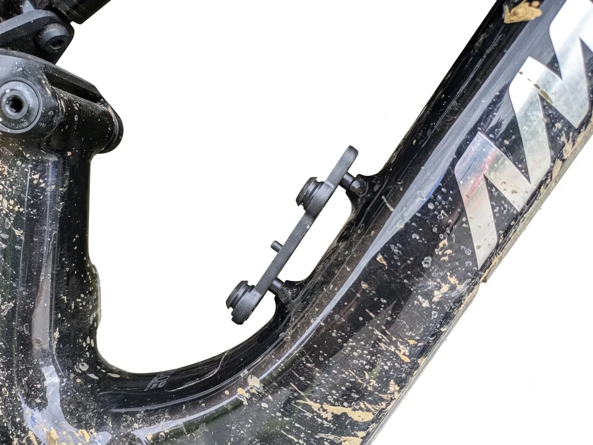

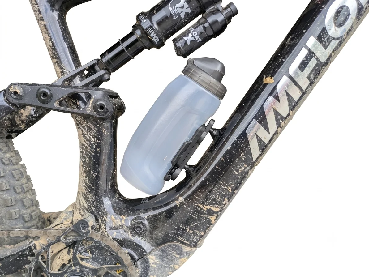

3. Fidlock Bottle (Size L frame): I’m planning to use a Fidlock TWIST magnetic system. On a Size L frame with the piggyback shock, do you think the 590ml bottle fits, or should I play it safe and go for the smaller 450ml version to avoid hitting the shock?

One other thing worth flagging since you're kitting it out - the Fidlock 590 you mentioned in the thread title: it fits the L frame fine in the main triangle with the bottle base mounted to the standard bosses, but you'll want to check it doesn't foul the Avinox battery cover when you twist it off. Most people get away with it but the angle of approach matters. Post some pics once it's built up!
