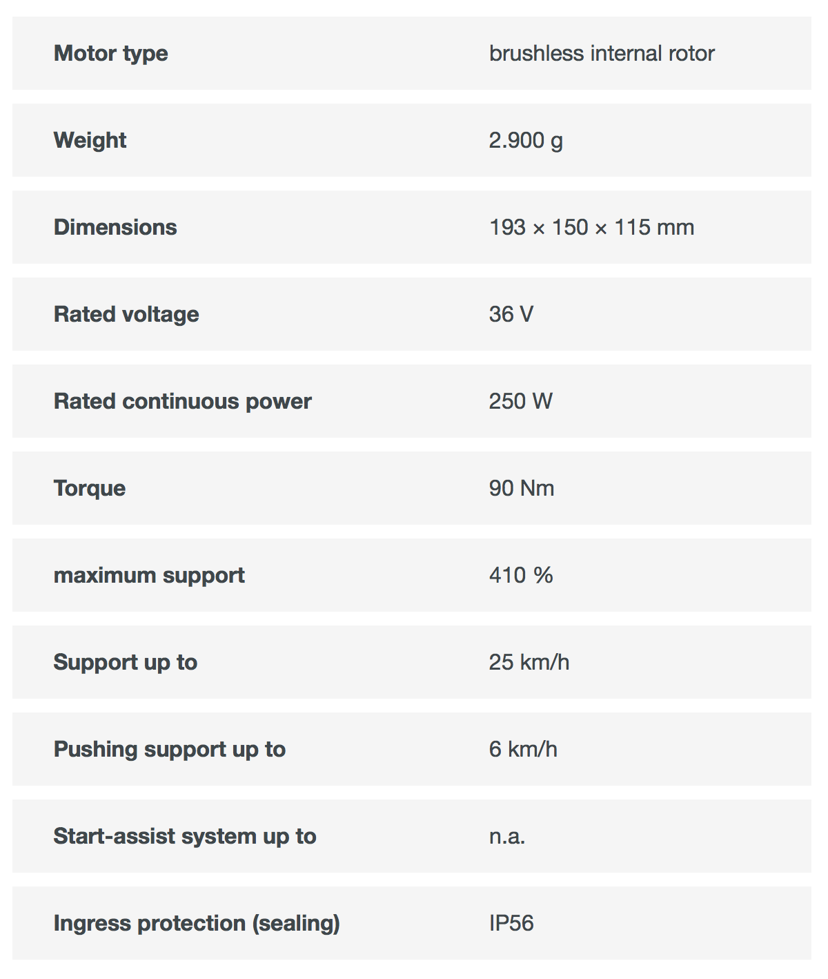

Hot off the heels of Shimano announcing their new E7000 motor today Brose have announced a new smaller, lighter motor. It is 15% smaller than the Drive S Alu and 500 grams lighter due to the magnesium housing. The current Drive S motor is used on the popular Levo and Kenevo, so no doubt these updated Brose motors will make their way into the new bikes, hopefully this year at some point. This could be the first real glimpe we see into an all new Levo.
brose drive s mag motor
This smaller, lighter motor has a significantly improved power to weight ratio. Riders will now benefit from an increased maximum power over an even wider cadence range. Brose are positioning this motor for riders who are looking for 'extremely sporty e-mountain biking'. With an instant power output to achieve a more controlled start on steep inclines and an even more agile EMTB riding experience.

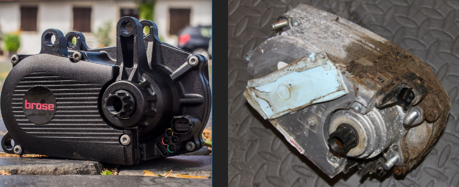

Although it does look like it has the same mounting holes/brackets
Not sure what images you are looking at @Stumpy but the motor mounts are completely different. You cant see all of the 3 engine mounts on the old ALU version but I have put a red arrow on one of them for you. The new motor looks like it has a lot more than 3 mounts.

awesome! Let me put the translated facts from eMTB-News.de here:
- 500g less motor weight (now 2,9kg)
- Magnesium housing which is (besides of the reduced weight) much better in absorbing heat
- 15% smaller volume
- Two versions regarding the mounts: There will be a "weight-optimized" one with integrated mounts which will allow the frame builders to save up to another 500g on their frames. And there will be a version with drafted mounts.
- Improved service-friendliness with new bundled connections and easy access to those
- Light output voltage is now 12V
- New "Flex Power Mode" that gives up to 410% assistance (maximum was 380% before) and consists of two new software features: The "Cadence Power Control" (CPC) that will give up to 30% more assistance on higher cadences. And the "Progressive Pedal Response" (PPR) for a quicker and more sensible responsiveness resulting in a more agile uphill start up handling and a more lively experience on the trail.
- "Flex Power Mode" will only be available in the new Brose S-Mag motor cause the electronics in the Brose S-Alu can not cope the performance increase on the long run
- No changes on the Brose S-Alu for 2019

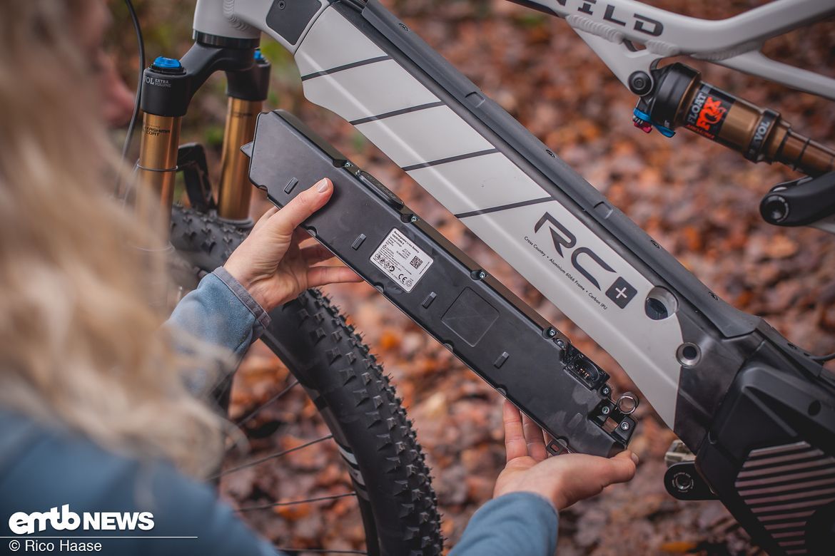

It will be interesting to see what Rotwild do with it, as they have the existing Brose paired up with a 648 integrated battery option on a couple of models.The battery Rotwild use Gives credence to the Specialized bigger battery rumours too.
ROTWILD Integrated Power Unit (IPU)
Ebike mag got 40,24 km / 1001 metres vertical ascent in 1 h 39 min out of the battery in riding fully boost mode!
On test: Rotwild R.C+ Ultra: Timid trail cruiser or an E-bike with stupendous suspension - We find out. – eMTB-News.de
Not sure where the link between Rotwild and Spesh is to give credence to any battery rumours. Fantic also use Brose and have a 630Wh battery but they have no links to Spesh either.
The ROTWILD IPU consists of a Brose drive motor and the battery unit developed by us.

It’s nothing to do with links to Specialized, is just showing that a battery that size is possible to be integrated with current tech into a down tube with the Brose motor

Yeah, I see your point now you put it like that, but Rotwild, Fantic and Specialized have all integrated the batteries in their own way and I suspect the former two designed with larger packs in mind from day 1 whereas Spesh went for form over function.
@Kiwi in Wales You're right (of course :)) - wishful thinking (hoping) on my part I guess! Thanks for explaining it though, much appreciated

@Kiwi in Wales You're right (of course :)) - wishing thinking (hoping) on my part I guess! Thanks for explaining it though, much appreciated
Believe me, I was getting excited about the exact same thing until I saw the side by side photos 🙁

Ok, Firstly, please excuse the photo of my old minging motor before it got changed..... it was the only photo I could find with almost the same view prospective.
This unfortunately shows quite conclusively that we not be able to fit the new motor into our current ebike frames as the motor mounts are completely different.:cry::cry::cry::cry::cry:
I noticed the 'battery to motor' socket has moved down to reside next to the other sockets so this might actually assist with the water ingress issue I had.
I know I keep harping on about it but I wish they had angled the socket positions downwards by 45 degrees to use gravity to prevent water ingress into the motor..... It rains where I live, and then it rains and after it has rained it rains again so it is a big challenge for me to keep water out. It is achievable but it means a lot more maintenance and this takes up valuable riding time :eek:
