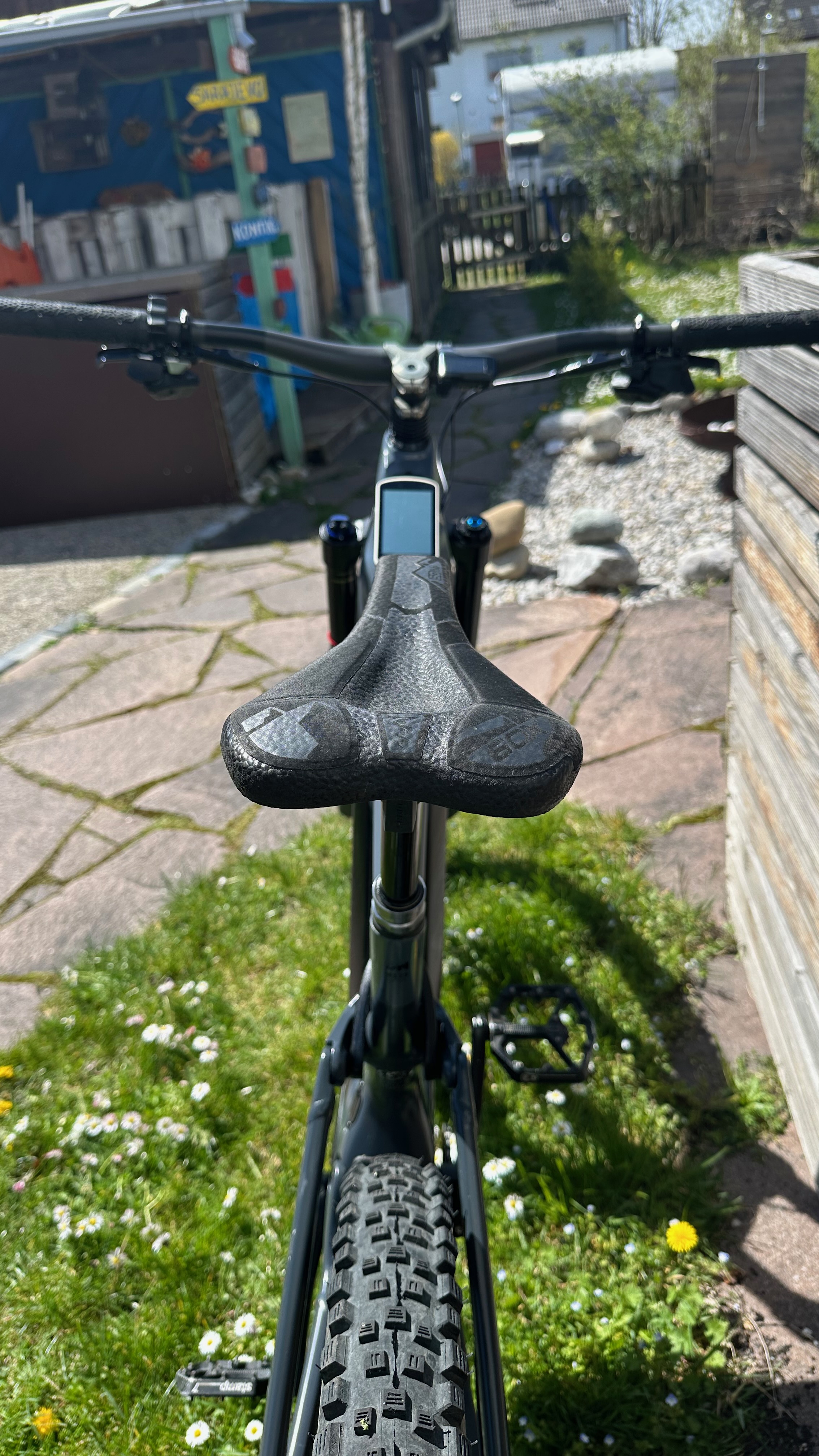

So let's start by myself
The pic is not the best (but a beginning )

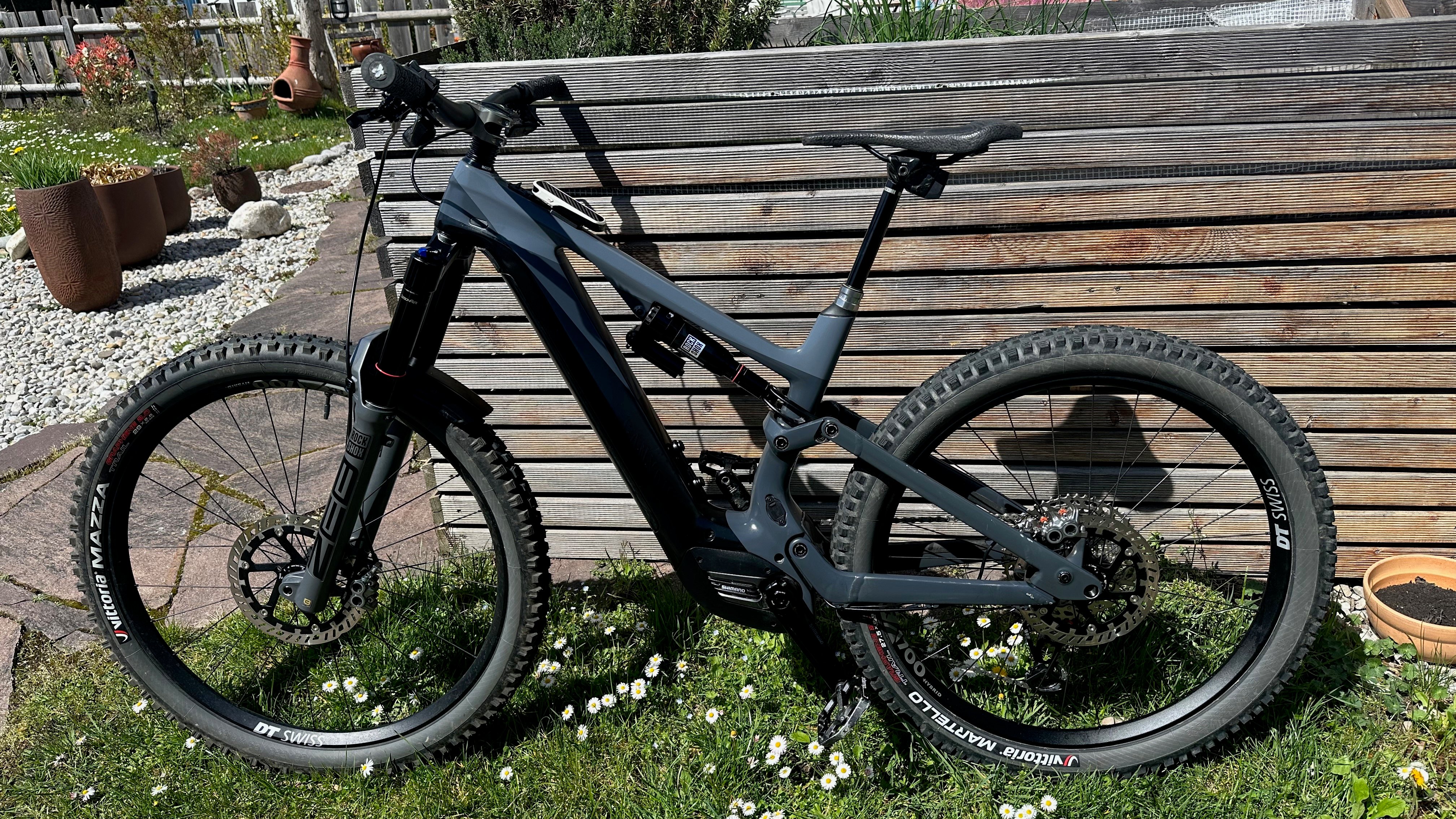

Original a Spectral On CF 7

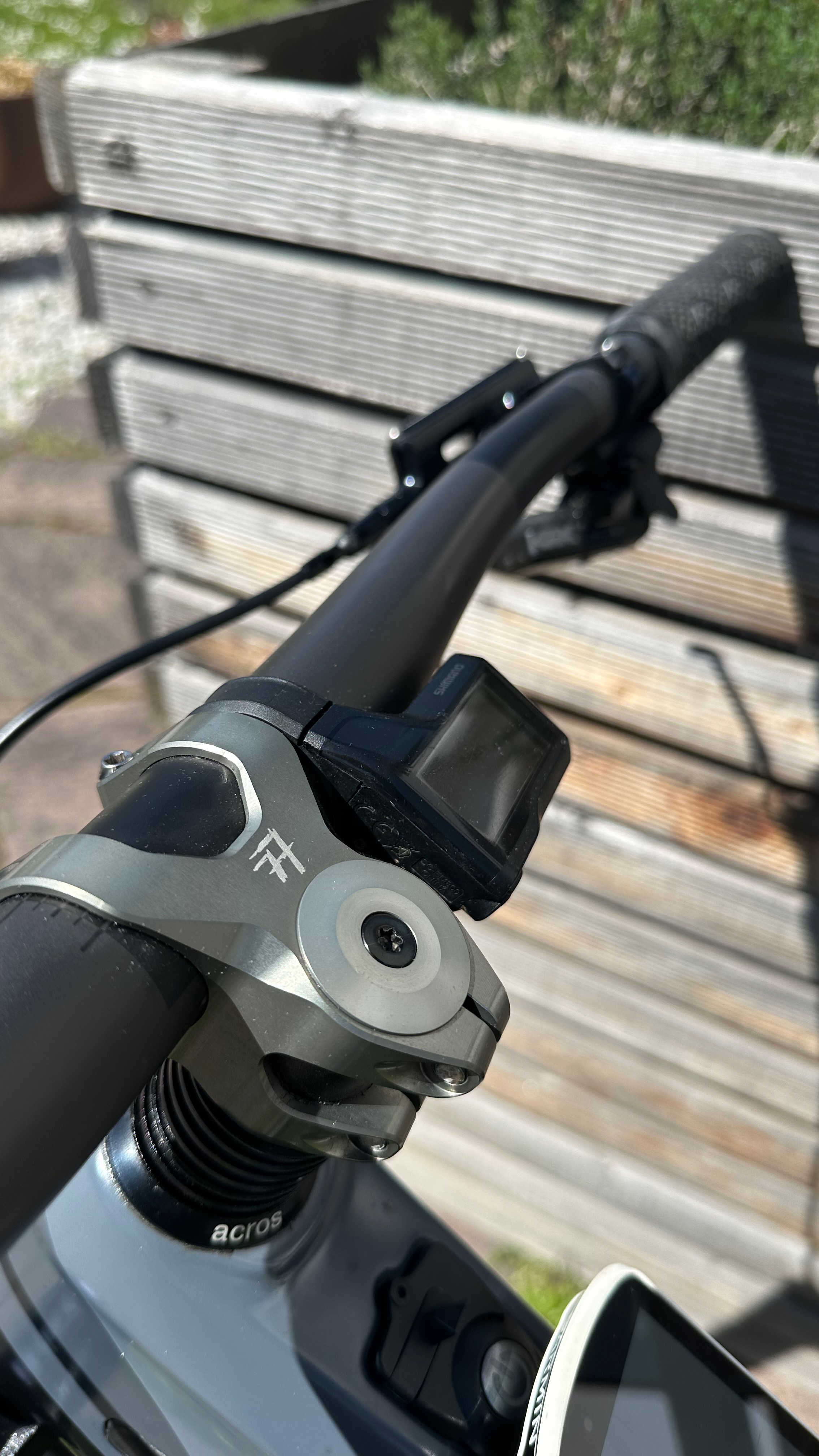

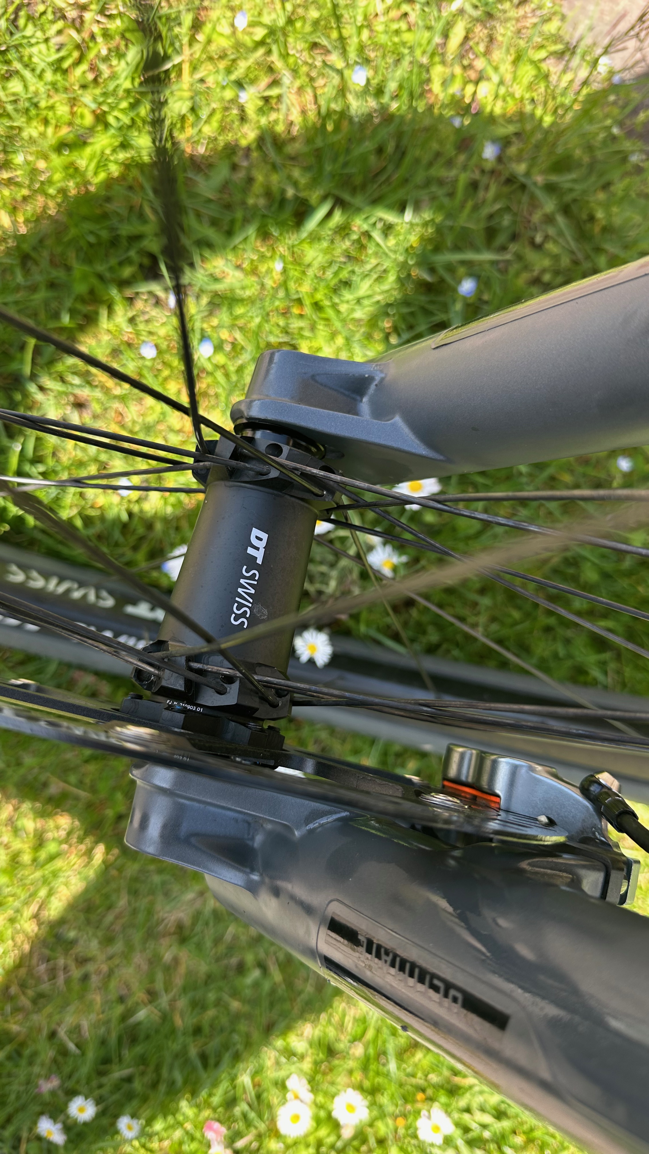

Here are my changes:
- Shigura Brakes with MT7 and Shimano XT Lever
- Magura MDR-P BrakeDisc (front 220, back 203)
- TRICKSTUFF Break Pads 170 POWER
- DT Swiss H 1900 in winter, HX 1700 in summer
- Vitoria Mota in winter, Martello & Mazza in summer

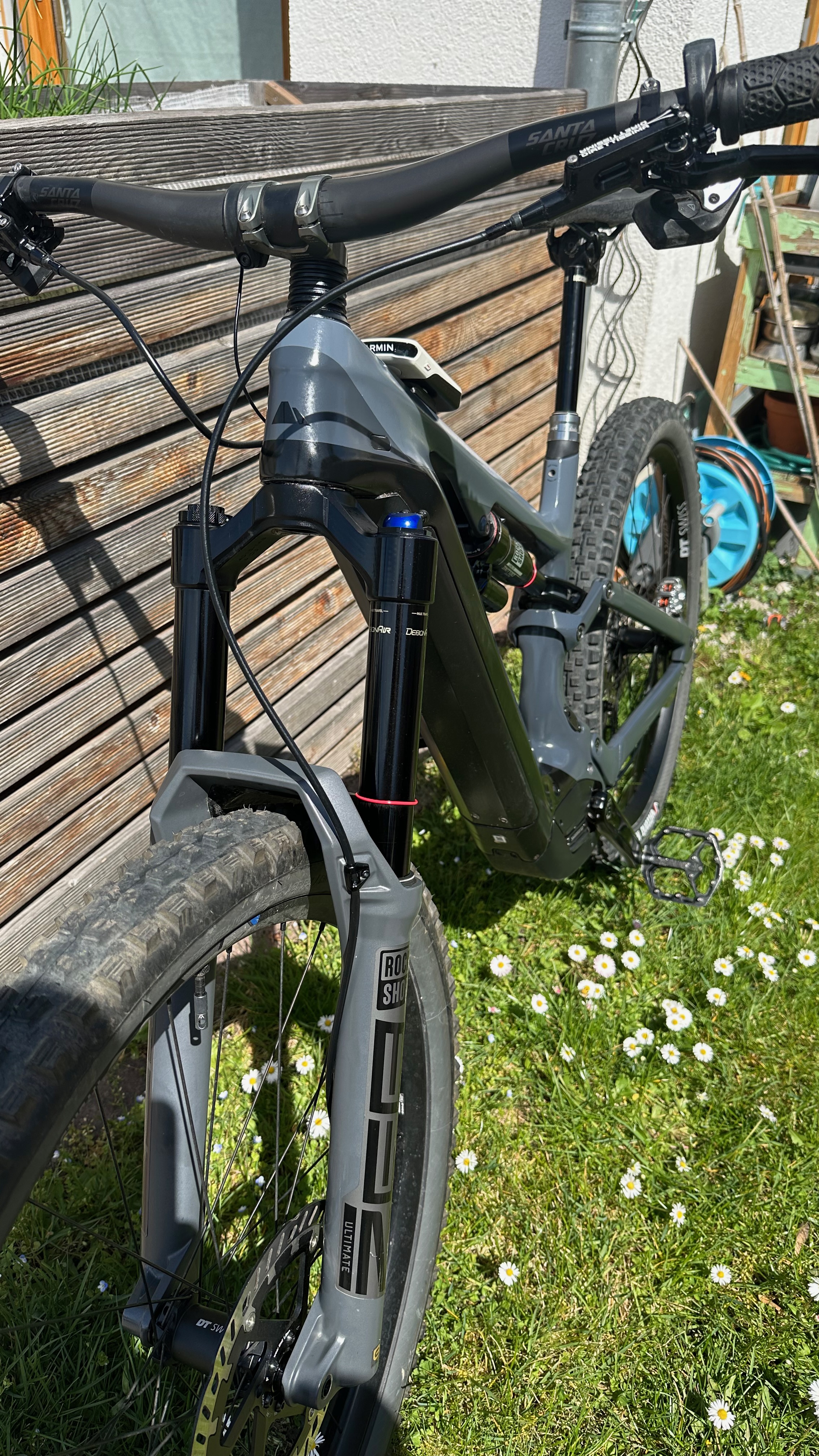

- RockShox Zeb Ultimate 2022 Modell 180mm travel
- 77 design stem 30mm
- Santa Cruz Di2 Trailbar Handlebar Carbon 800mm 20mm Rise 244g 9° Sweep
- Sixpack Racing Z-Trix CF Grips
- Shimano SHIMANO STEPS SC-EM800
- Shimano STEPS EP8 buttons SW-EM800-L

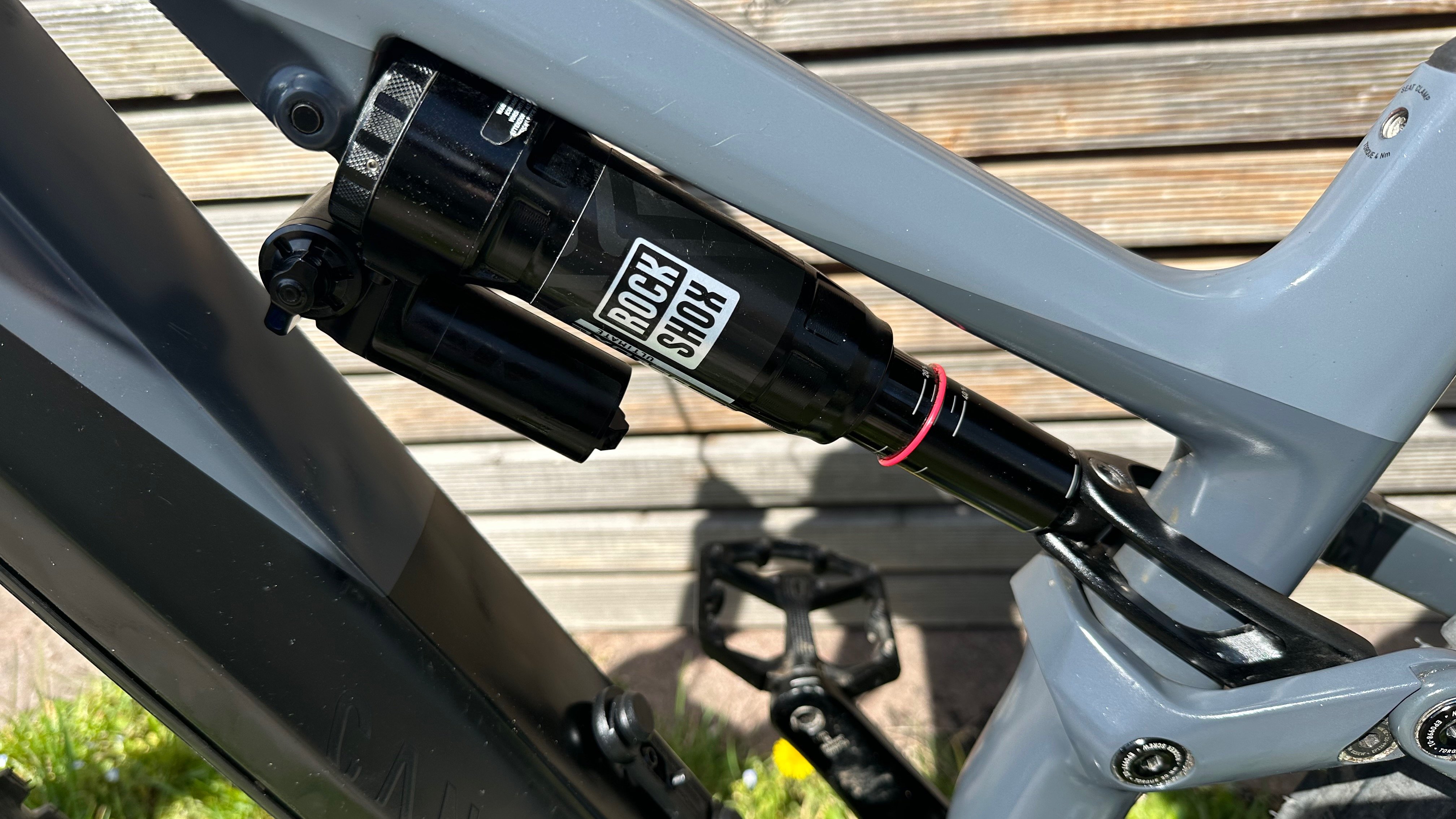

- RockShox Super Deluxe Ultimate Shock 230x65, Modell 2022
- Offset Bushings
- Acros Headset
- Shimano STEPS FC-EM900 160mm crank set
- e*thirteen e*spec Chainring Direct Mount 34t

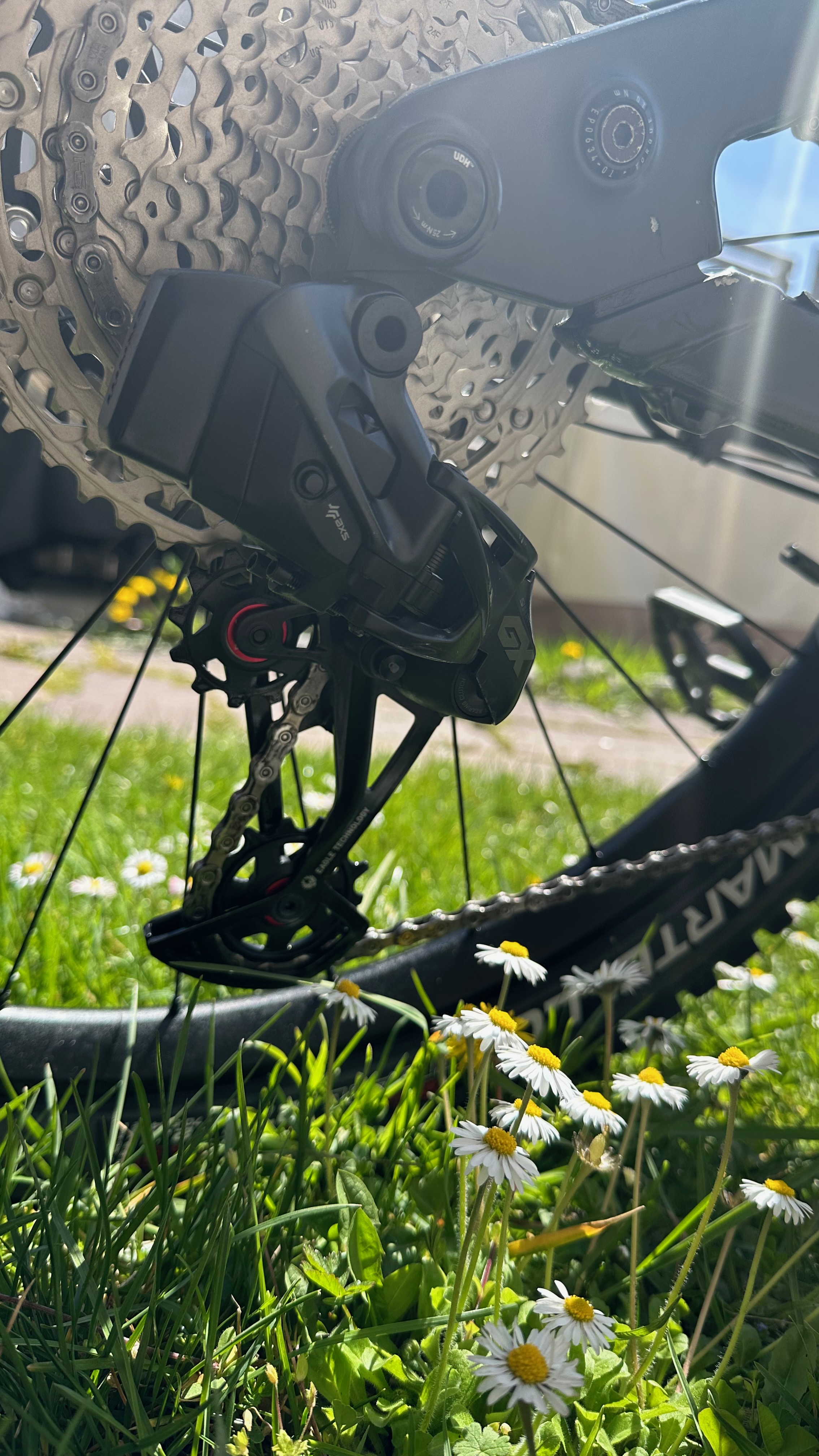

- SRAM GX Eagle AXS Upgrade Kit 1x12
- RockShox Reverb AXS Dropper Post
- SQlab 6OX Infinergy Ergowave 2.1 sattle
- AWK for Zeb
- Crankbrother Stamp 7 with Titanium axis
- most screws changed to Titanium
more to come....

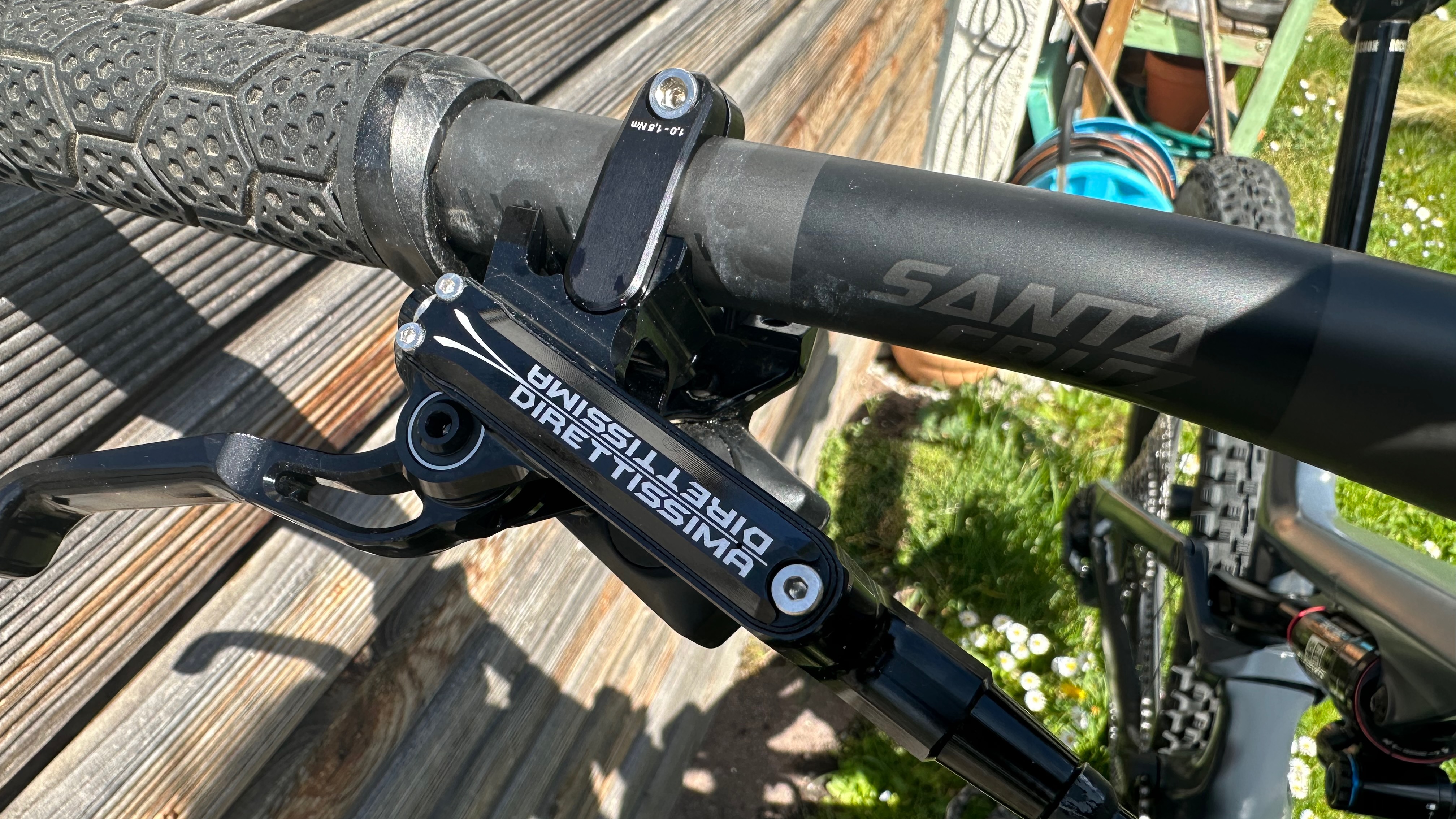

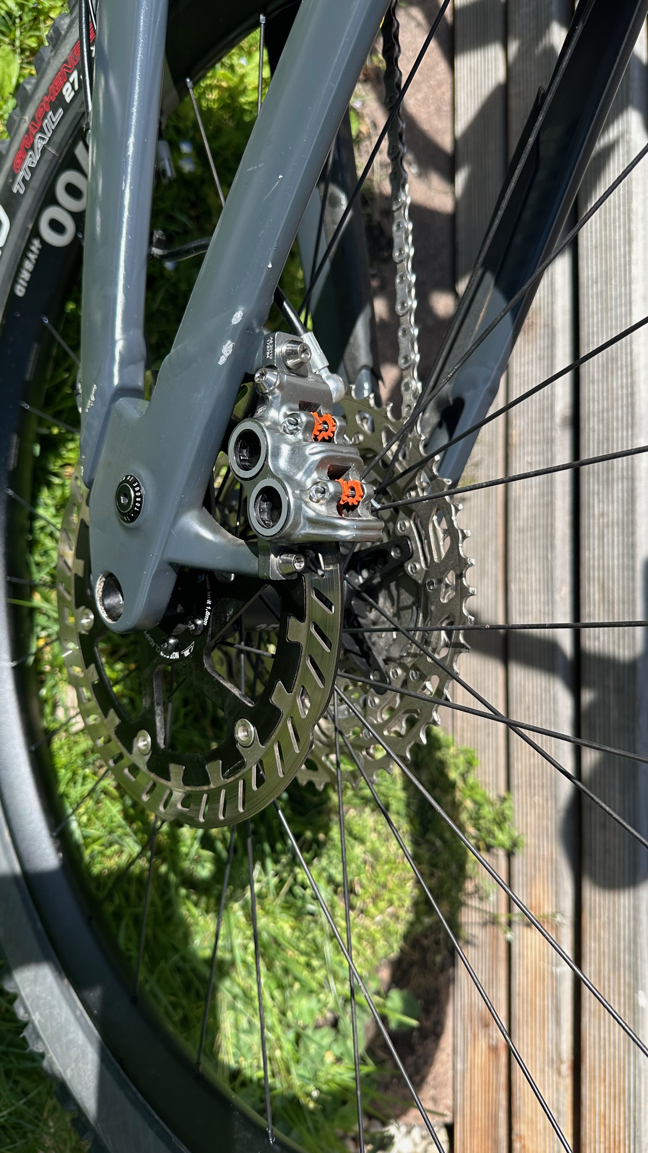

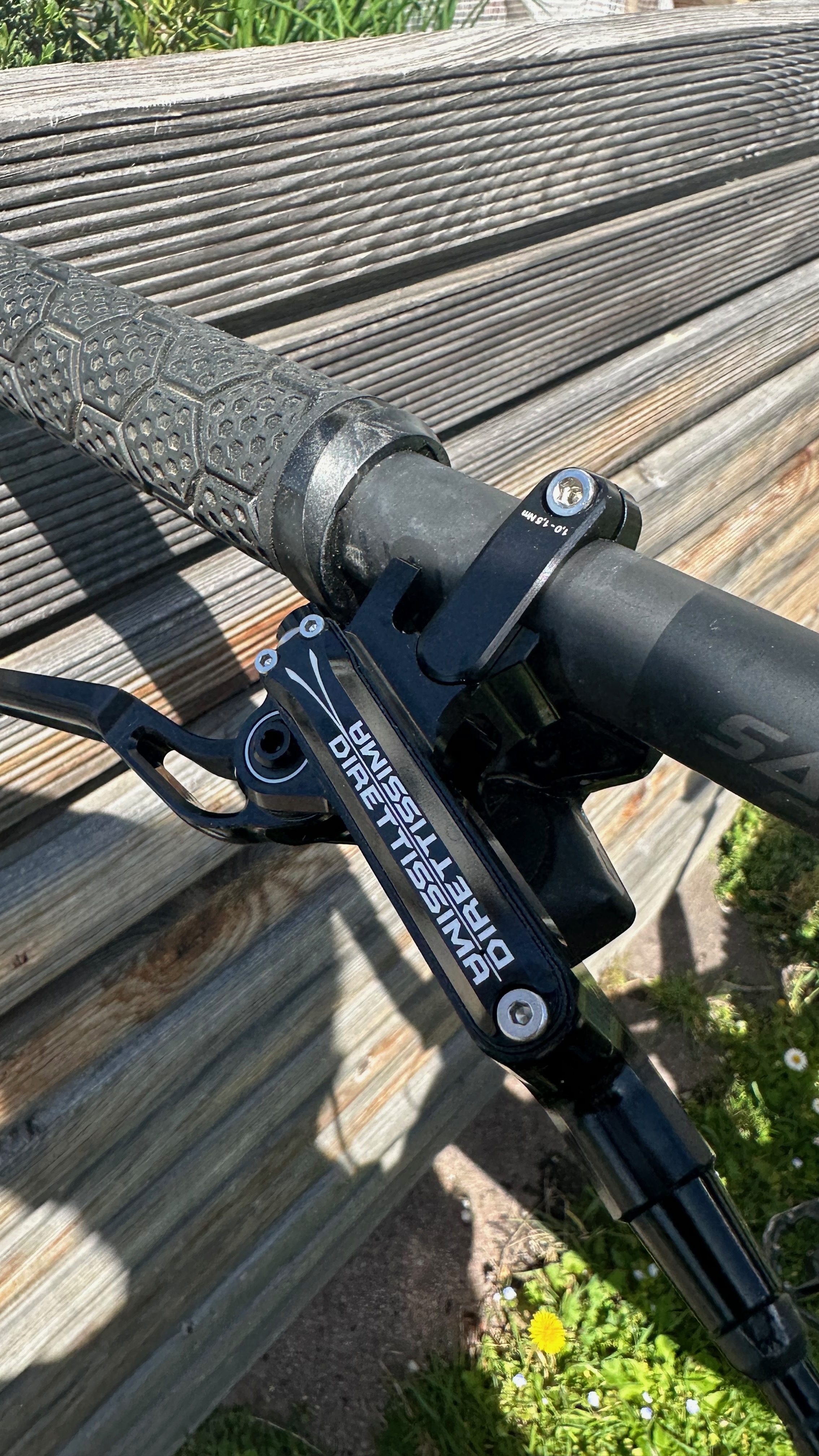

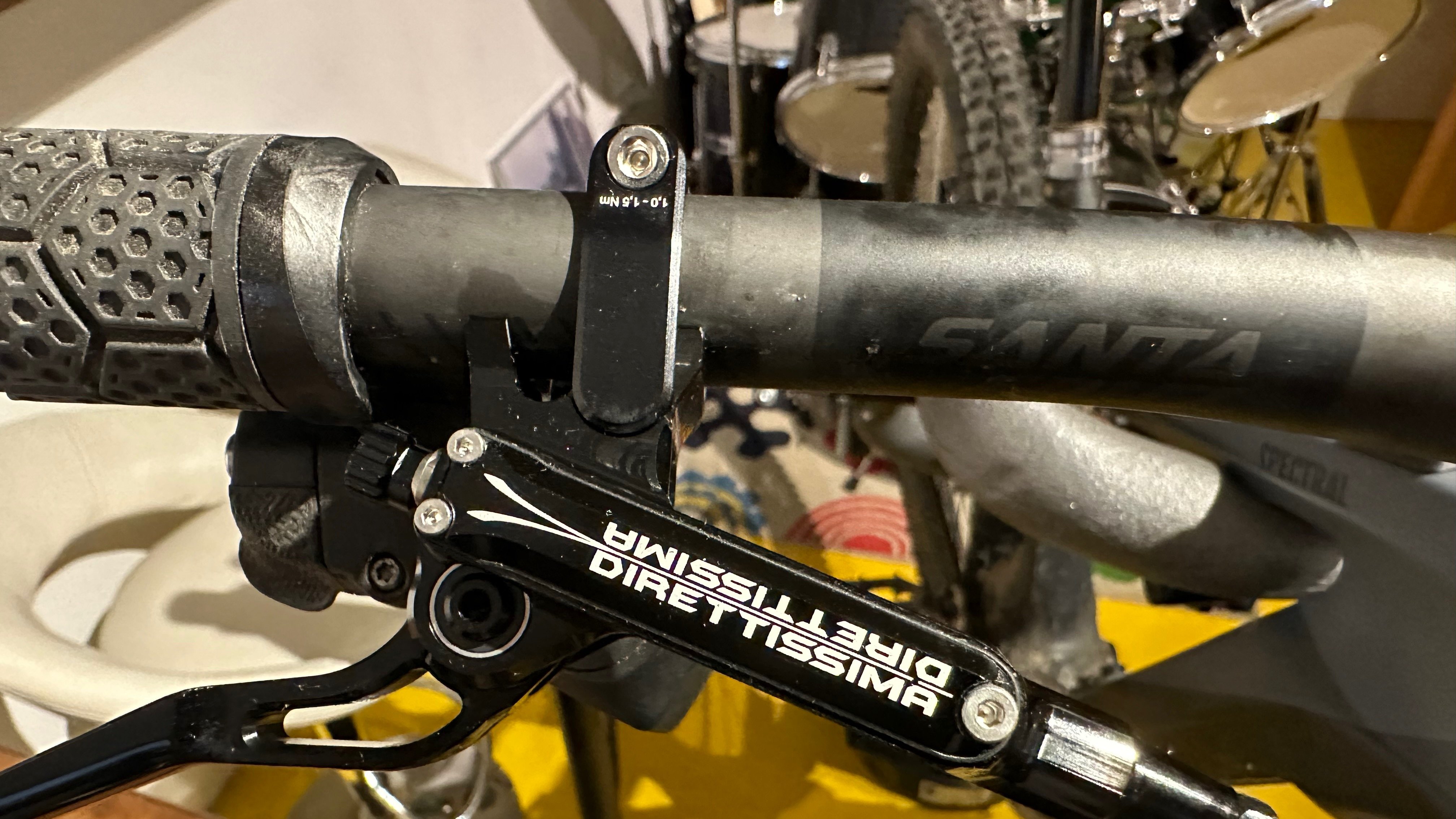

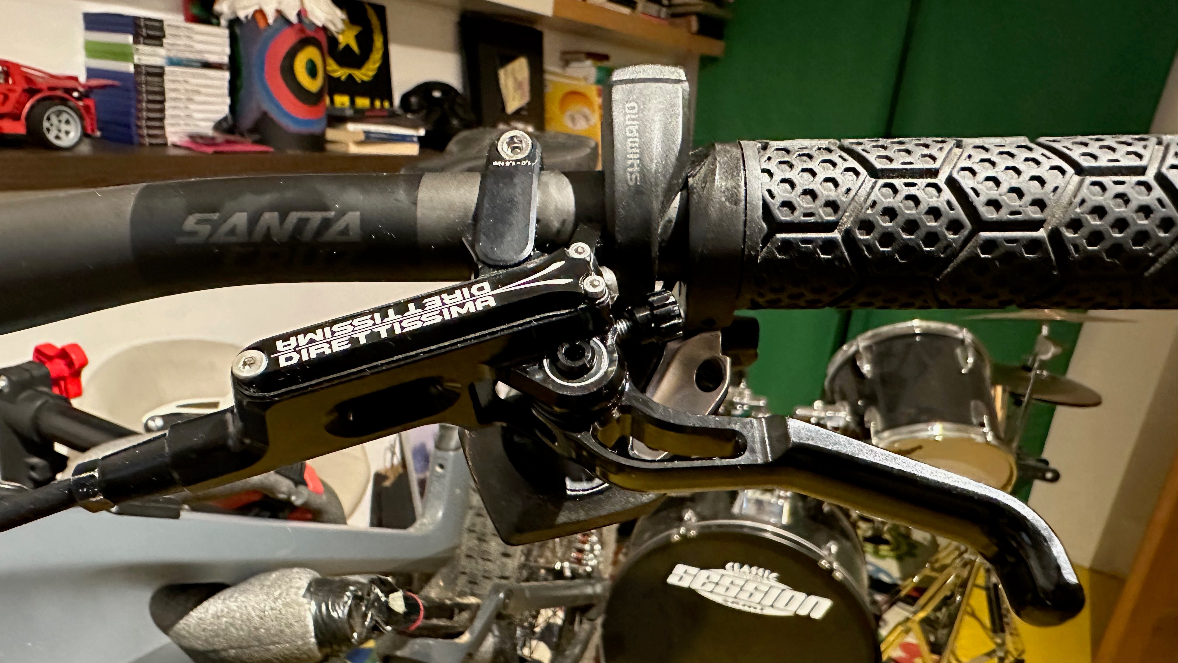

Today, I finaly finished my brakes: Trigura :cool: moved from Shigura with XT Lever
I'm now using Trickstuff DRT + MT7 caliper + Shimano hose + Magura Olive

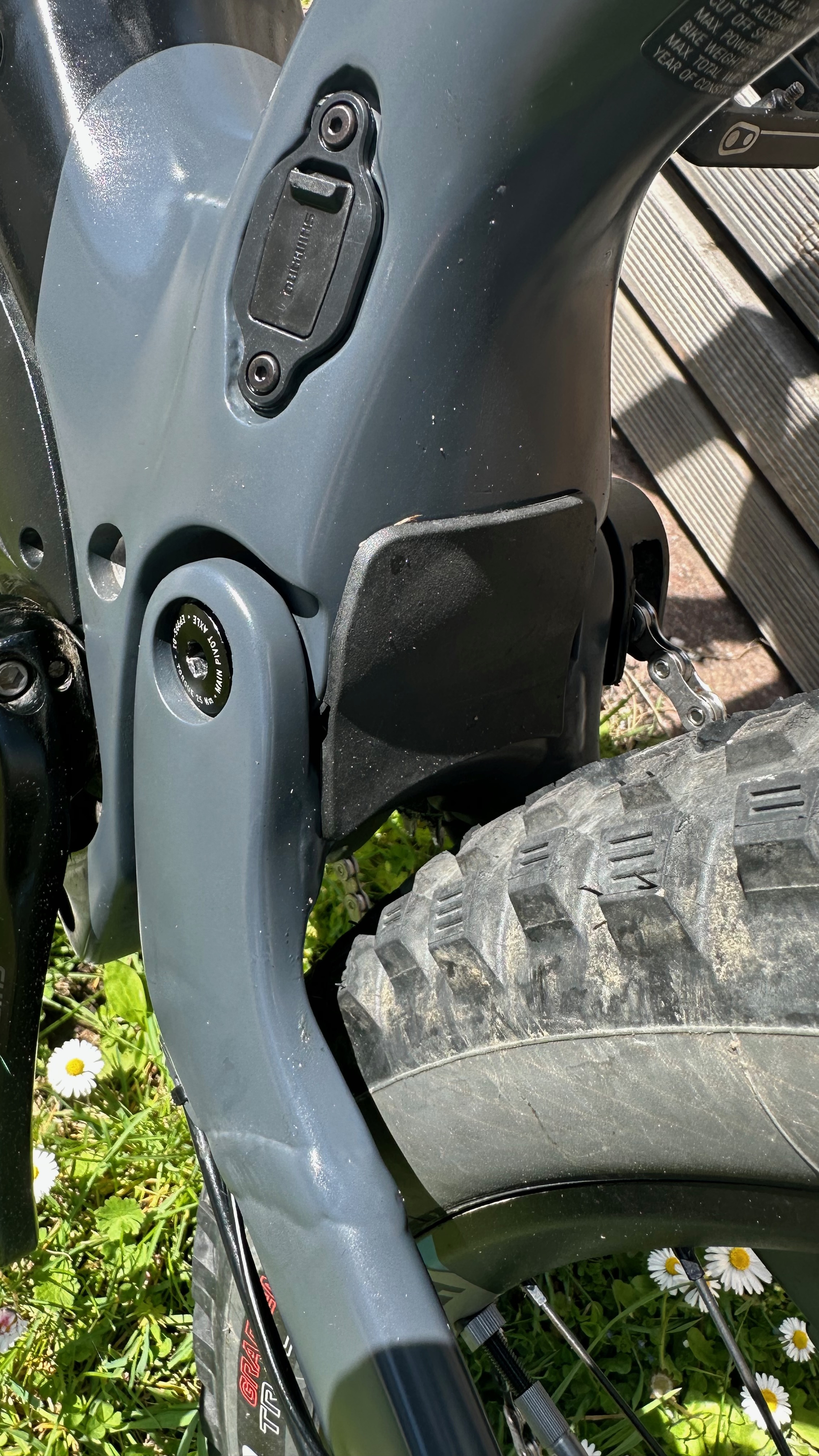

as a new owner of a '22 CF9 I'm sad they got rid of the usb port and moved the on/off switch and the clunky charging port cable harness to the downtube. I wouldn't want to have to work on these parts, though.

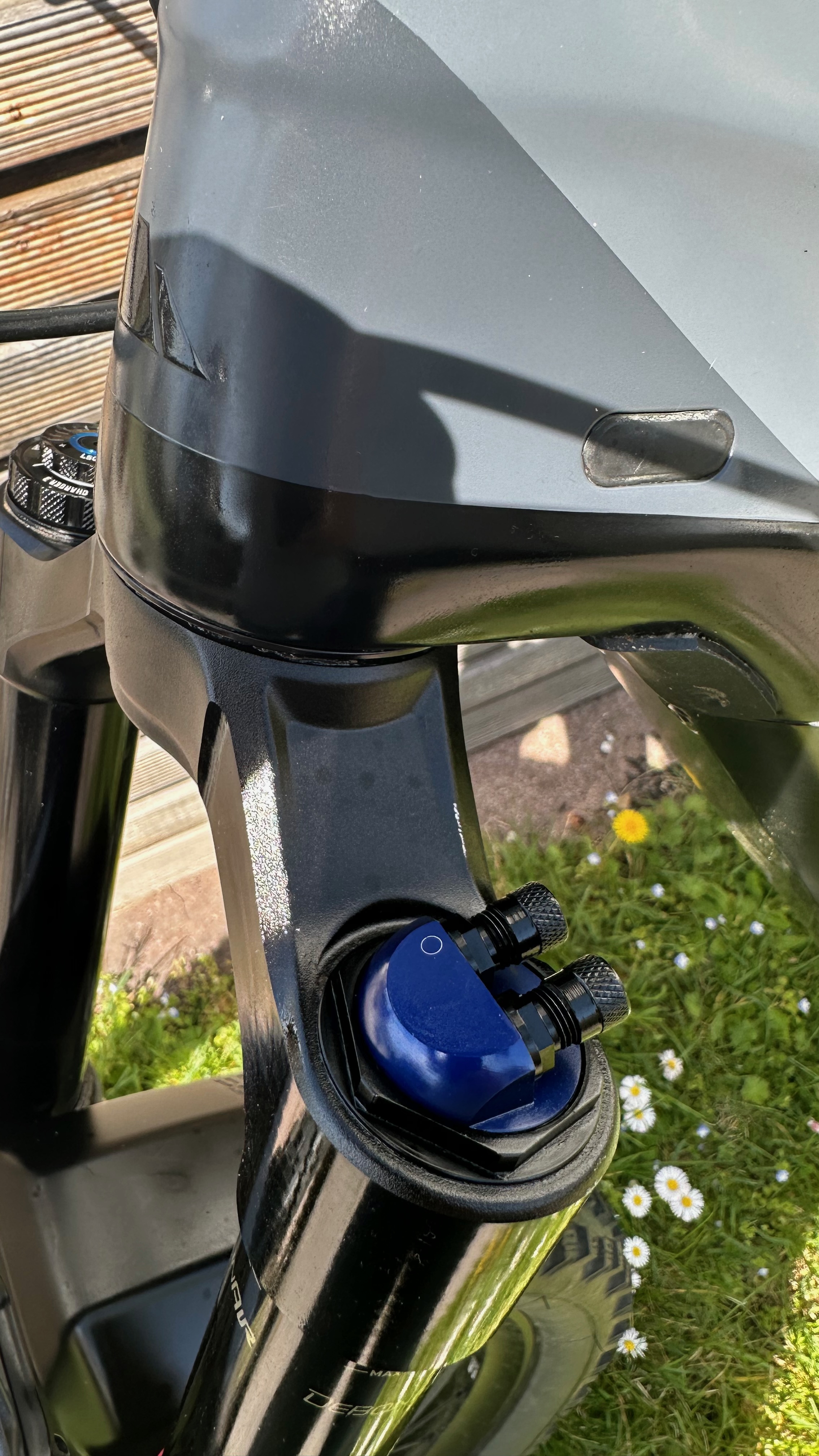

Also, just curious, what is that blue thing in place of the air top cap on your forks?
MBj1703
Jul 15, 2021
147
81
Germany, near Munich
AWK - AusWeichKammer
It is a second positive chamber.
