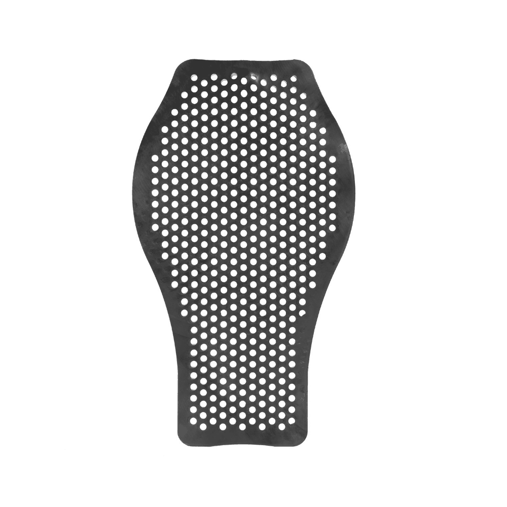

Product Image:
Product name: A-XOC CE2 Replacement back protector

The standard A-XOC is pictured at the top. The version I have is the "Held" version. Held use this is several of their motorcycle jackets. It differs from the standard A-XOC one in that it has an additional 2mm foam panel on the outside. I'm not sure if this is to give the protector more rigidity (they're quite floppy) or just to give a nicer/softer finish against the outside of their jackets. The foam means that some of the standard open holes are blocked, though I guess if you needed more air you could punch holes through.

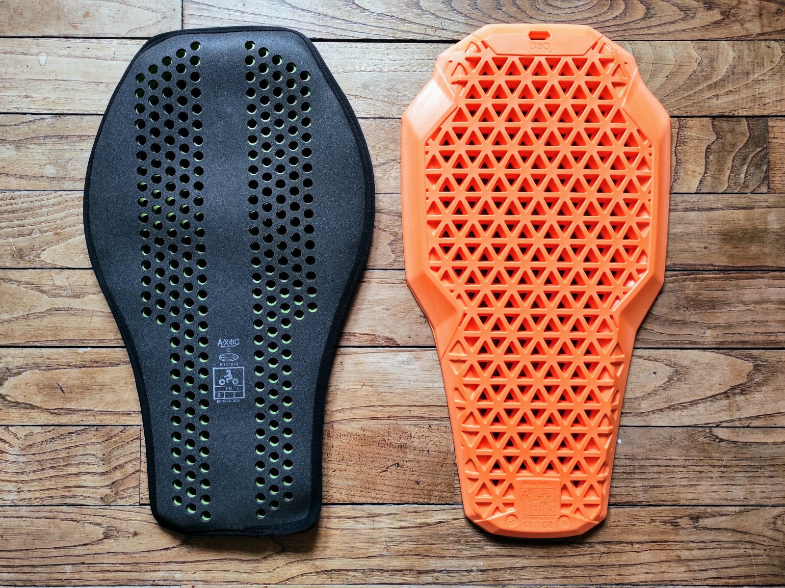

In comparison :
This is the "outside" On the left, the Held A-XOC in Large. On the right a D3O BP4 in Medium.

This being the "Held" version, with the extra 2mm foam pad, means that both armors are 16mm thick. The big difference being that the A-XOC/Held armour breaths better and is CE2 rather than CE1.
Both are very flexible and mould to your back. Both return to their existing shapes if you bend the hell out of them. The A-XOC/Held armour can actually be rolled or squished up quite small, so you could carry your armour in a very small bag if needed.

How does the ventilation work however, one side looks better than the d30 but the other looks worse weirdly

The Held version has a lot more blocked holes than the standard version. The D3O looks really well vented from the outside, but the vent holes taper, so it's not as vented as it first appears. The none vented area is also pressed against your back so there's not much circulalatory airflow under the armour. The "tubes" of the A-XOC let air move around all over, so whilst any structure like that will reduce air flow and ultimately act as some form of insulation (like a string vest) - if feels way cooler than the D3O.
