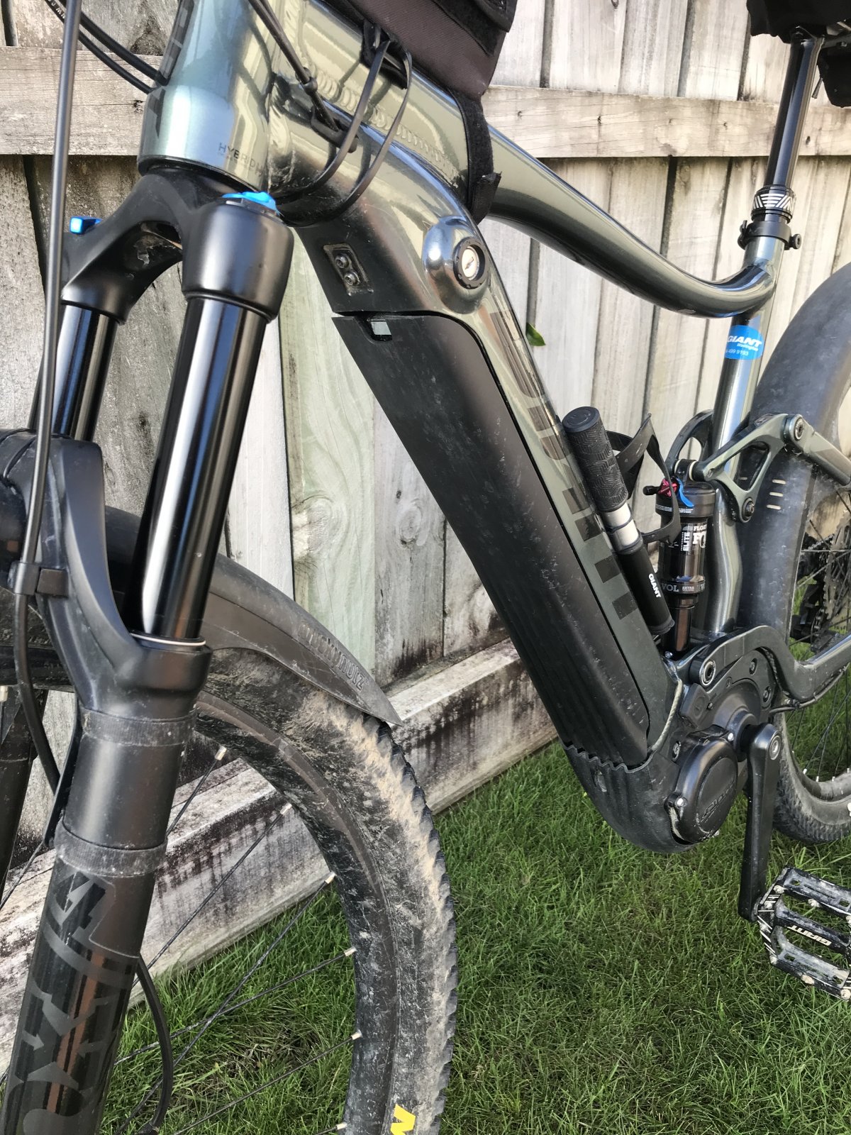

I'm considering getting the 800Wh and maybe (maybe?) selling the 500Wh...
Hmmm...
Just do it Dave! It's only money 💰. I've had couple of rides with the 800Wh now and for me it's the end of any range anxiety I've had with the 500Wh. Typical Giant, it isn't cheap and I've also purchased the modified cover to fit the Stance in black, so it doesn't look out of place at all.

Nice!
Got a pic of the black cover on the Stance? My mind's eye says it should look pretty cool!

Looks OK.

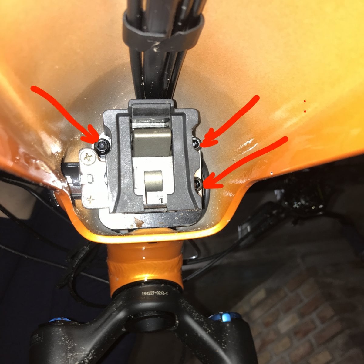

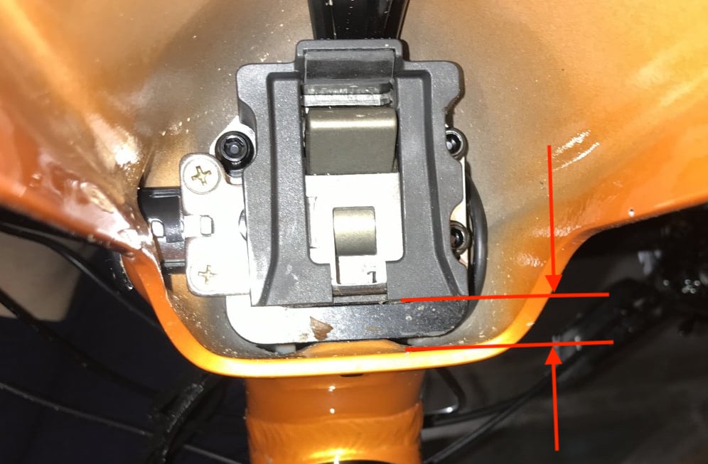

I noticed on yesterdays ride that the 800Wh battery was not locking into place correctly, and that there was a slight gap at the top. No amount of slamming the battery into the frame would get it to lock in place. As soon as I started riding again it would drop slightly. Worse still I discovered that the battery was no be held by the key lock mechanism, only the secondary latch. You could just remove the battery by operating the secondary latch and pulling. I tyrap'ed it in place and rode home. The battery looked like this (not my bike but a Trance with a similar issue):

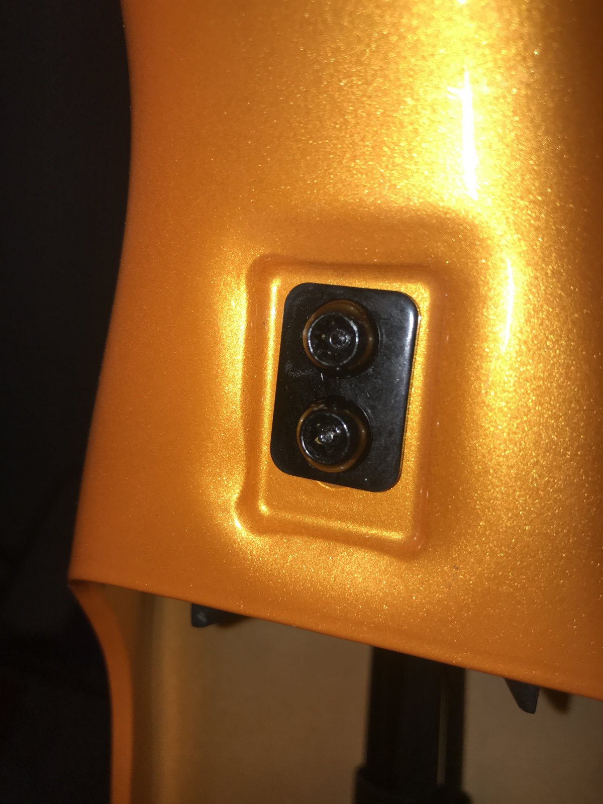

After some reading and comparing it to the 500Wh battery which was latching in just fine I adjusted the battery latch by a very small amount slightly forward (closer to the front of the frame) by loosening the 3 black Allen head bolts (cap screws) and moving the latch on its base plate. Note you don't have to touch the two Security Torx Screws on the outside of the frame, these Torx Screws hold the base plate to the frame. A picture, again not my bike:

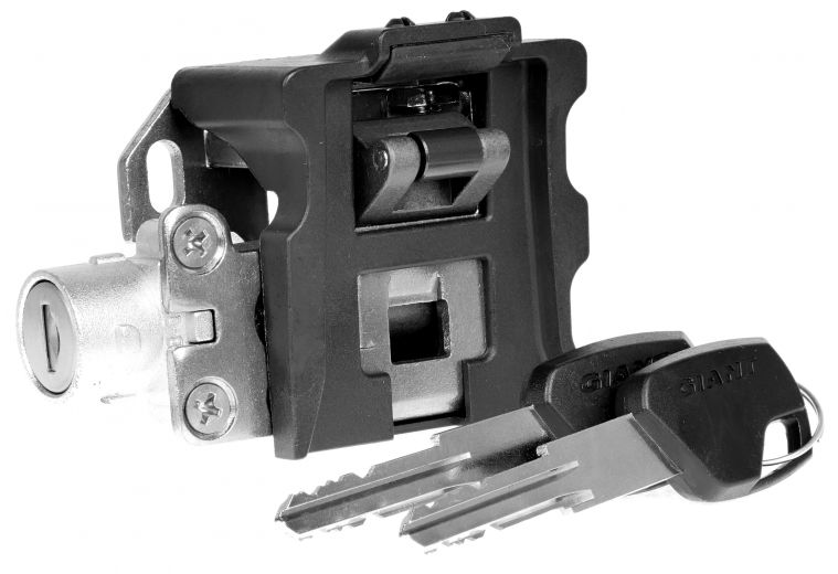

Unlike the Trance pictured my Stance has a roller latch mechanism like this:

No the 500Wh still fits just as snuggly as it always did. With my verniers I measured the the gap between the battery lock mechanism and the frame before and after the adjustment and I judged that I only moved the lock mechanism about 0.3mm. So not much, but enough for the key lock mechanism roller to drop into the recess on the battery.
You can see that the 3 black cap screw holes are slotted for this type of adjustment and I did not completely loosen them off to prevent the whole thing moving around. Just loosened enough for a controlled small adjustment.

I'm an Aircraft Engineer so familiar with screw types. The identified three 3 black Allen Head Bolts (Hex Socket Head Screws/Cap Screws) are used for adjusting the battery lock on the base plate. The two Security Torx Screws on the outside of the frame above the battery compartment hold the base plate to the bike frame. Another picture (again not my bike) is the Security Torx Screw mentioned:
Perhaps you are talking about the two Phillips Screws pictures as part of the lock mechanism, you don't need to touch those either.
