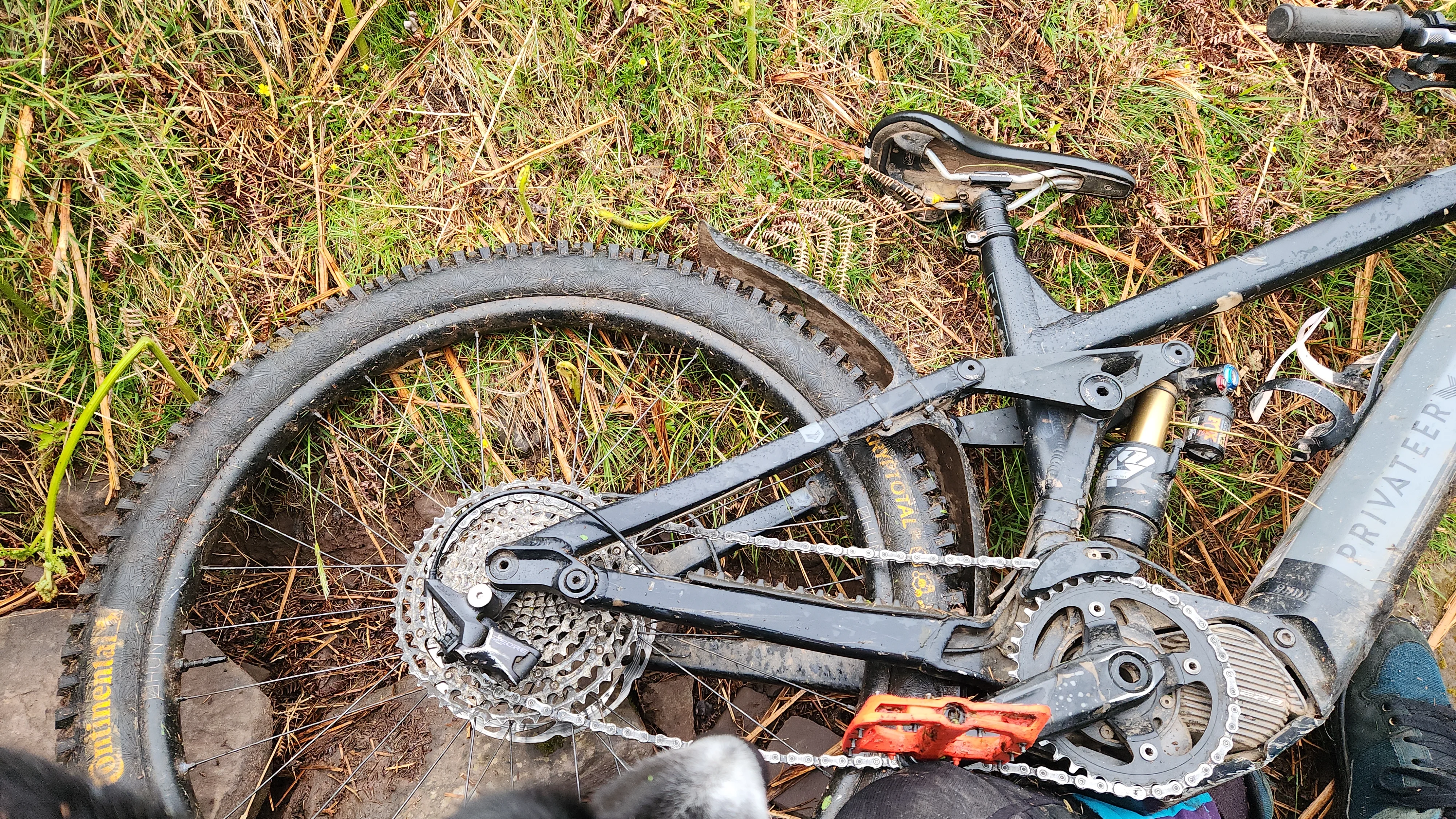

In my emtb use so far the best derailleur has been mechanical 12-speed Eagle GX combined with sturdy Santa Cruz UDH hanger. Derailleur and hanger has taken multiple hits and eventually hanger gave in but derailleur still going strong after 3600km of hard use.

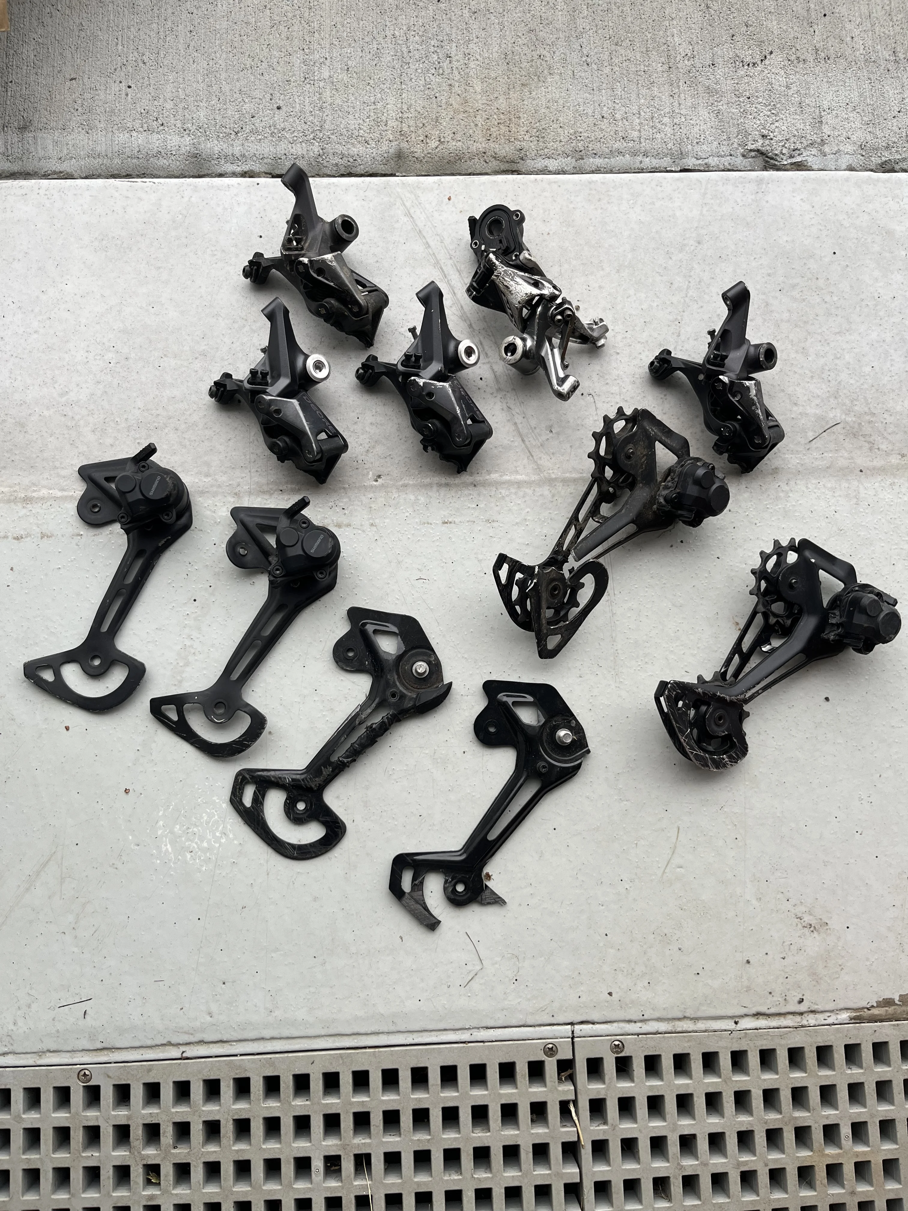

Also on my 4 in about a year and a half. I am now buying 2 packs of Deore RDs for £27 each so as to always have a spare in the riding pack. Latest one went last week.

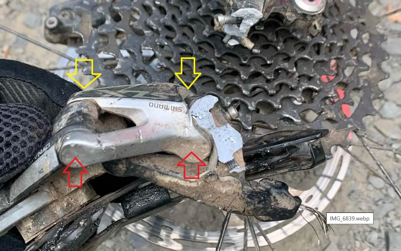

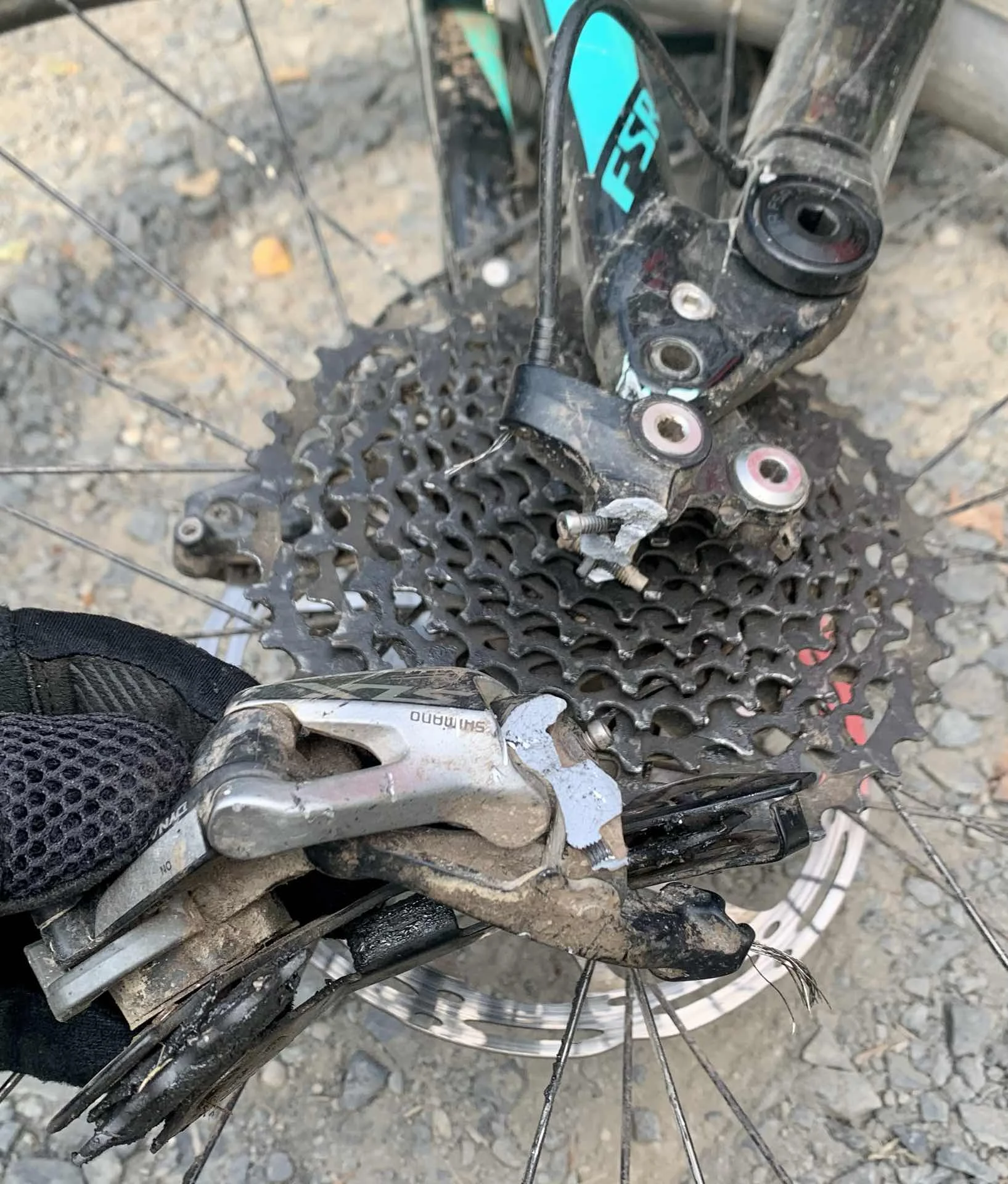

IME with Shimano RD failures, they've never been catastrophic from direct impacts to the parallelogram as witnessed by massive scarring over its lifespan.

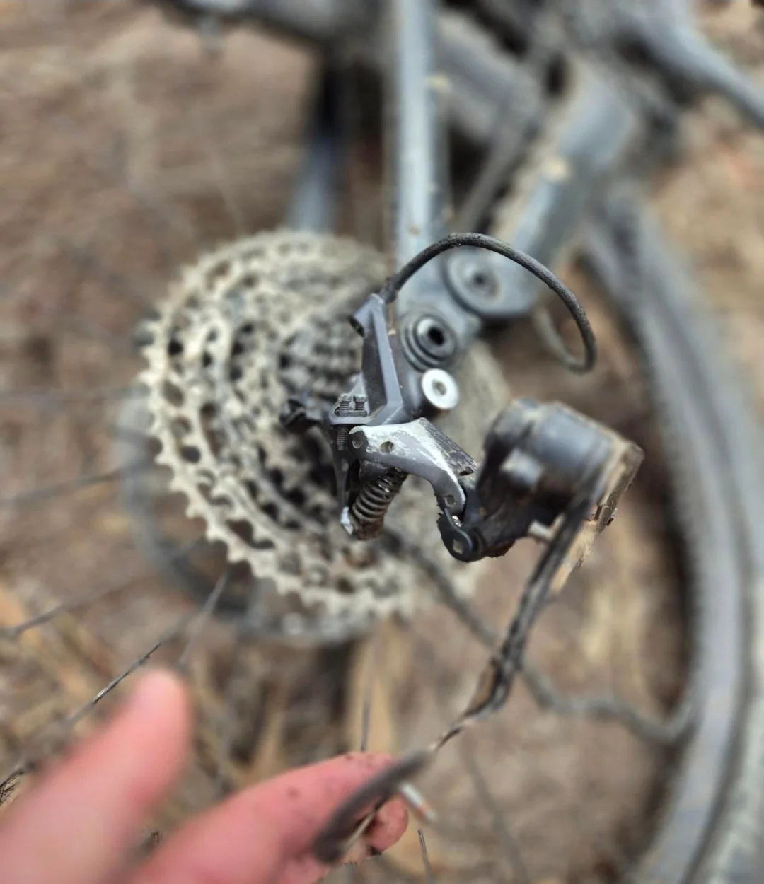

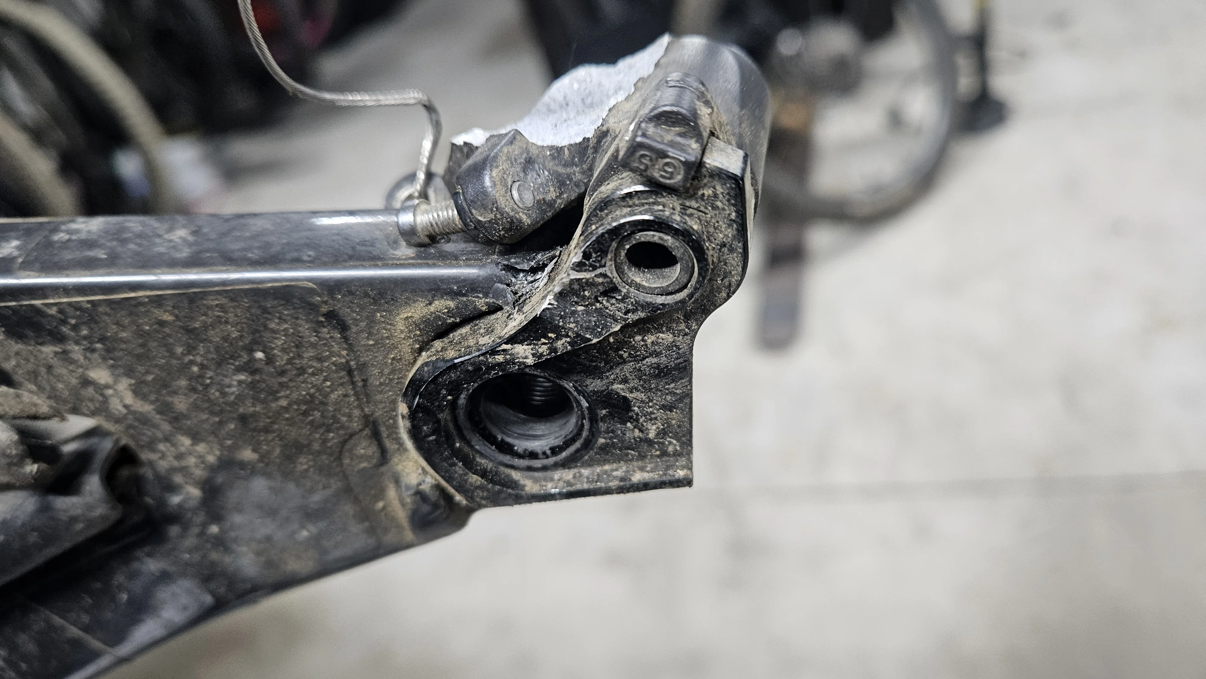

I've bent traditional hangers a couple times and broken/bent a few UHD ones. What typically happens it something causes the cage to push into the wheel spokes and the RD gets obliterated. Usually at "speed" and it takes out the RD (breaks at clutch/p-knuckle), UDH, a couple spokes and the cassette spider a couple times.
I recall ONE time the cage went into the spokes and literally stopped the wheel as I skidded to a stop... no real damage expect bent hangar and scratched spokes.

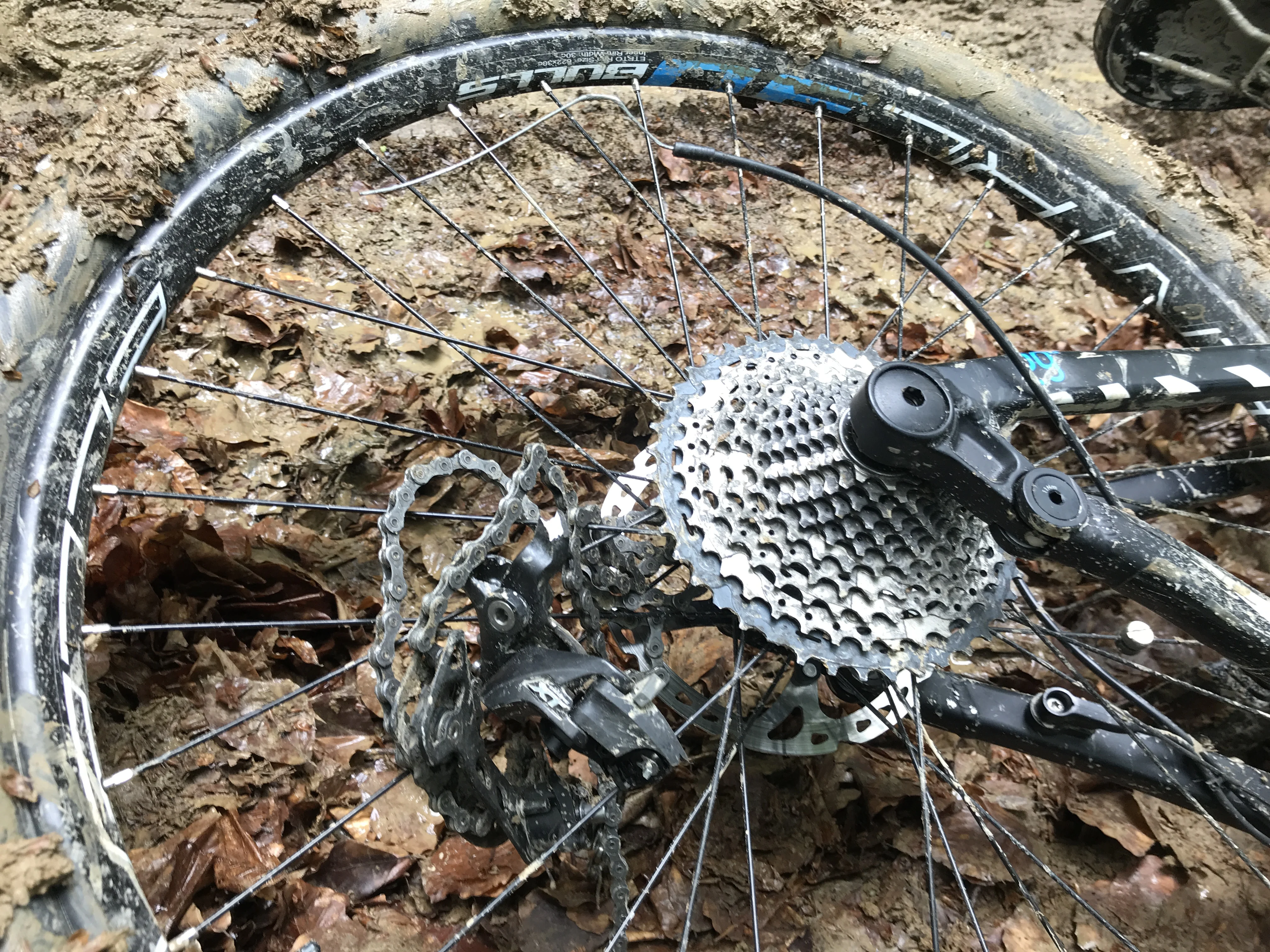

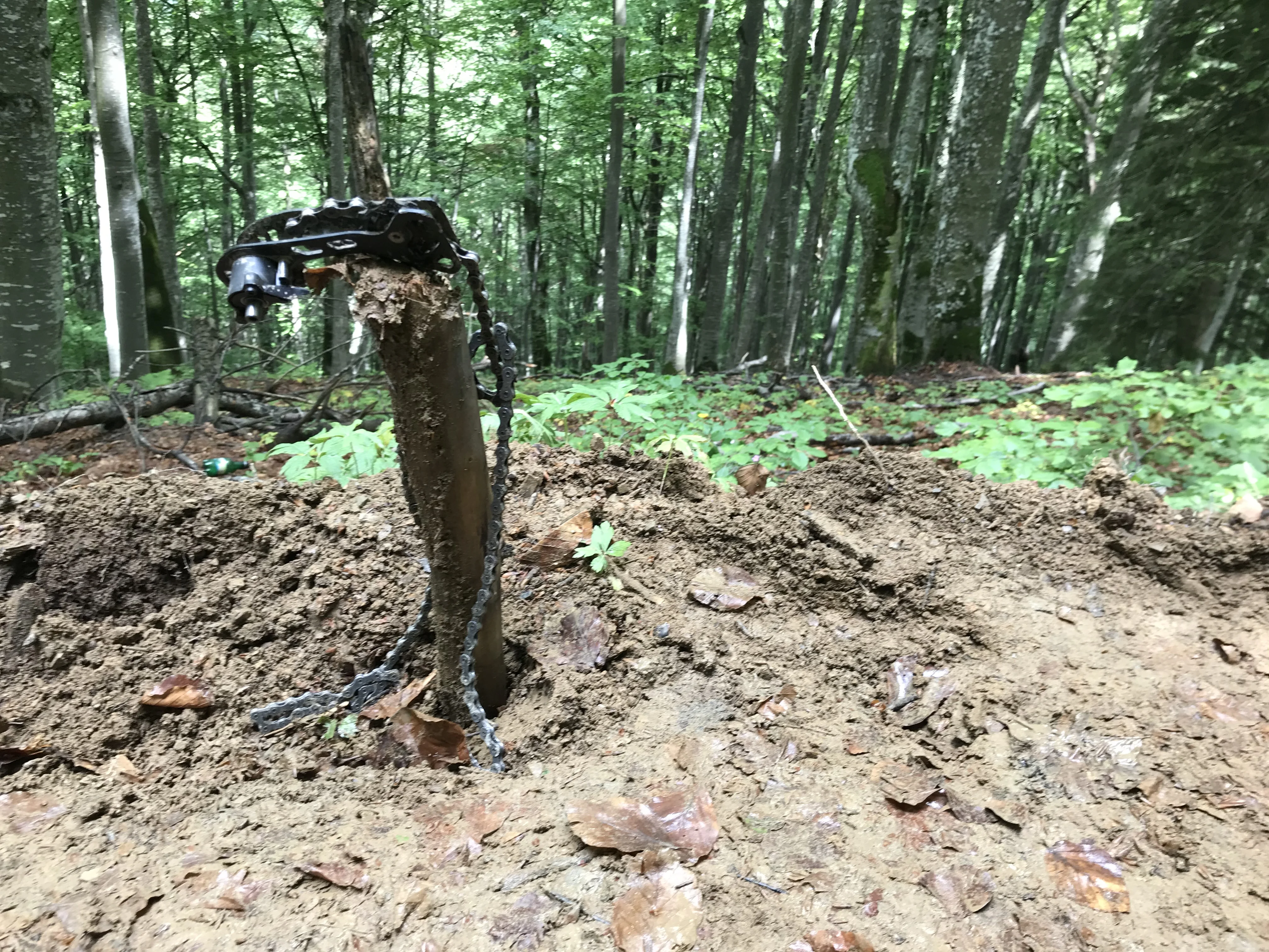

Sharing my explosive experience with a derailleur on a muddy day, uphill…got downhill with no chain. I left a trail of pieces in just a couple of seconds.

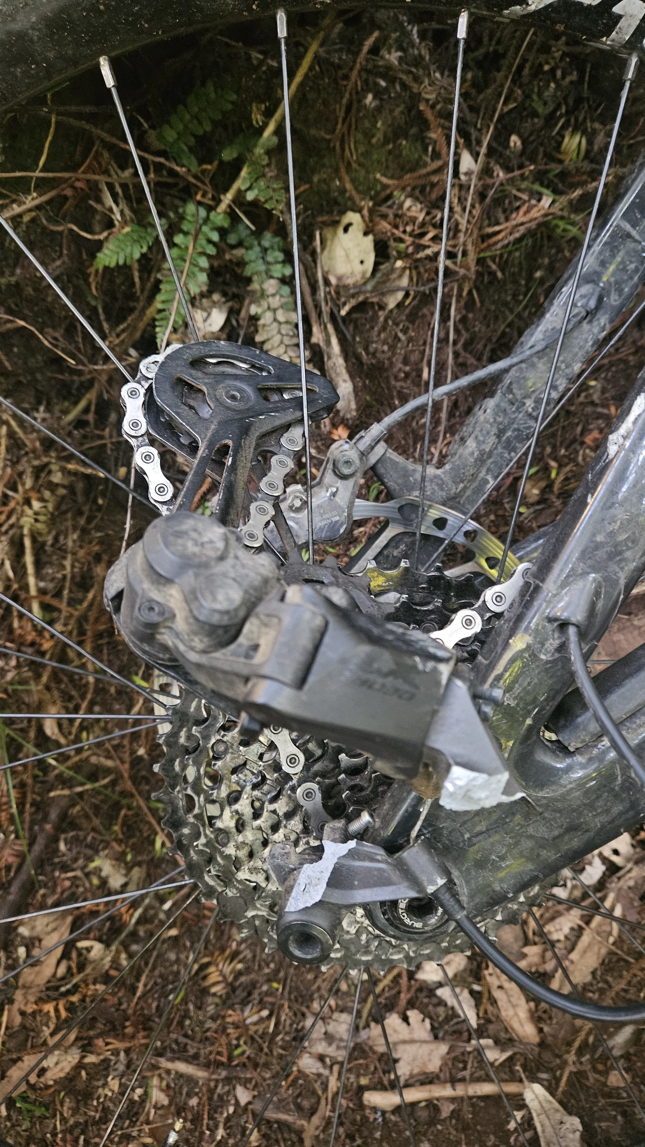

Can't believe people struggle-on buying more and more Shimano derailleurs. I went through this years ago, finally realised that the parallelogram links are super weak and bend, which makes the cage point in towards the spokes and then catch and destroy everything. Switched to SRAM and found a different set of problems, the cheaper chains and cassettes (GX and below) work great for a while but wear out super fast. XO stuff seems incredibly tough and long lasting. I've got huge gouges in my XO derailleur on the bike now from multiple hits and scrapes but it still works really well. I've only destroyed one XO mech in the last 5 years or so and that was from a stick that got caught and bent the cage. Everything up top was fine. Been through several derailleur hangers too.

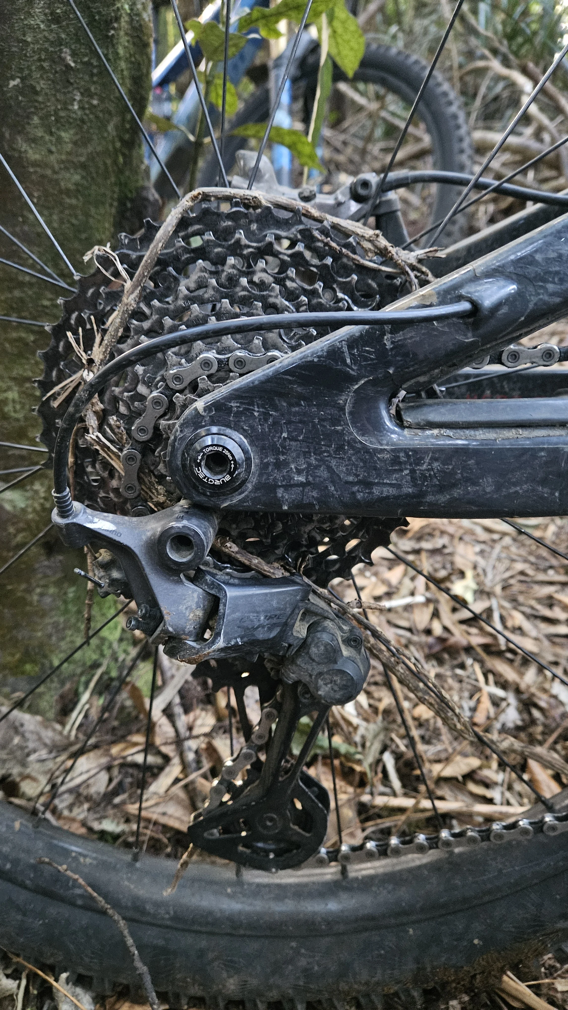

As a breaker of Shimano XT derailleurs ( they are cheap and plentiful and who needs any more than 10 speeds ) there is something I'm becoming aware of. On all the damaged ones the tension clutch on the outer arm has become too restrictive over miles and puts a lot of tension on the Derailleur. my theory is that its not sticks and stones as I thought but the excessive tension pulling the arm into the wheel when it becomes too restrictive.
I started to rebuild parts of into 1 standby and noticed that the arm was very stiff when fitting it. Went back and checked the other bits I had and they were the same. I've backed off the tension quite a lot and not having any problem with the chain coming off even though I only use a narrow & wide chain ring without a guide. To date I've not had another failure, but its early days.
