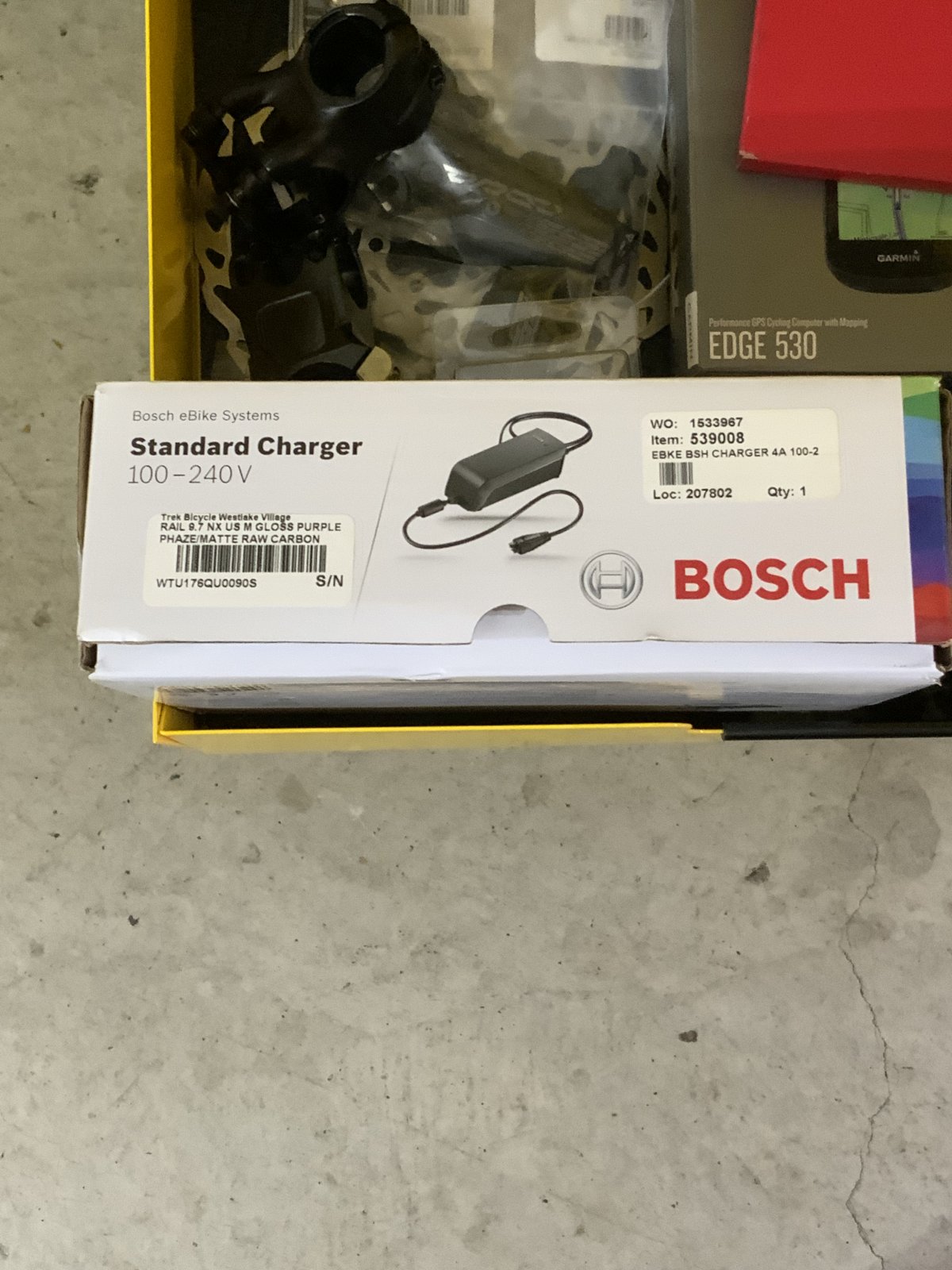

Not sure if this helps but this came with our bikes. My 9.8 and the wife’s 9.7 charge in less the 3.5 hours. Bought in SoCal
Thanks! The bosch website says only the 2A is 120, the others are 240 and that is what all the online sellers say as well, tho prob just because they copied from Bosch. I'll order one and see what shows up. Thanks again!
Here are two retailers that have them in stock. I think online sellers are just using a stock image of the 240v charger.
