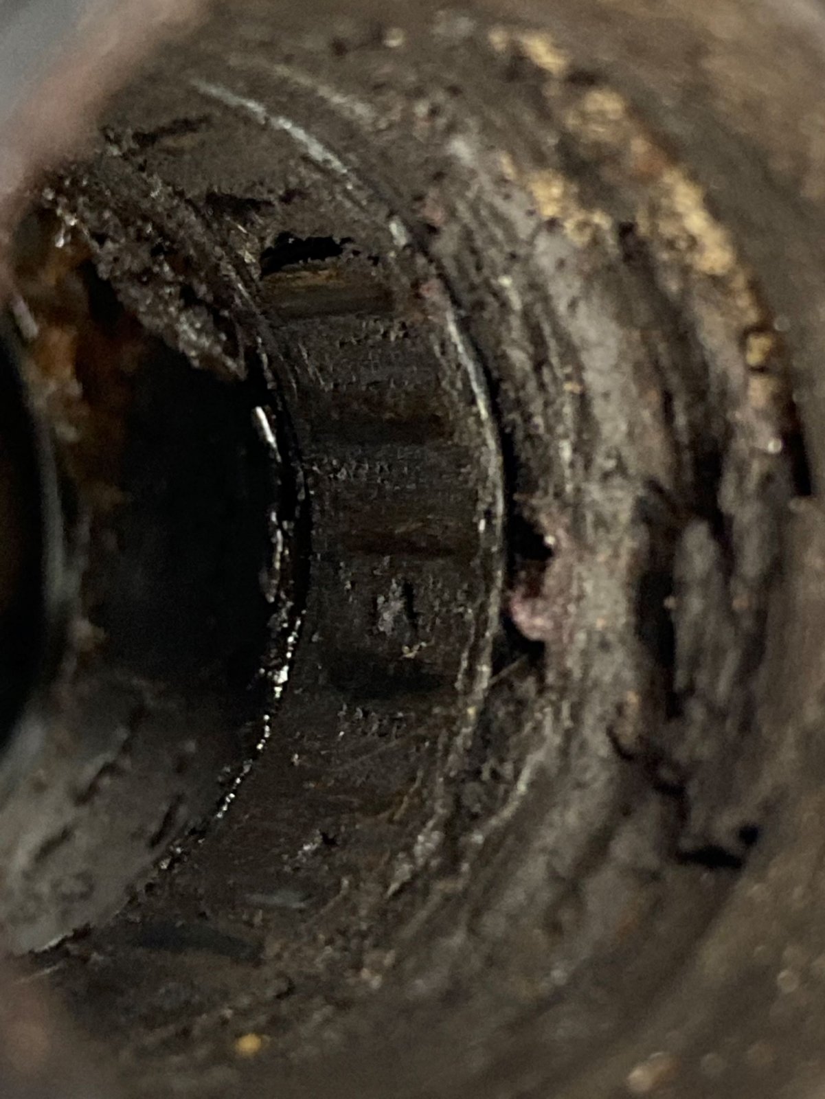

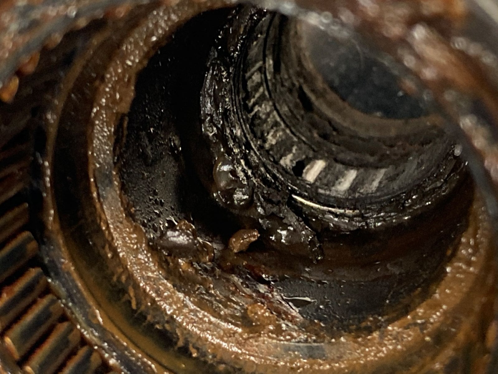

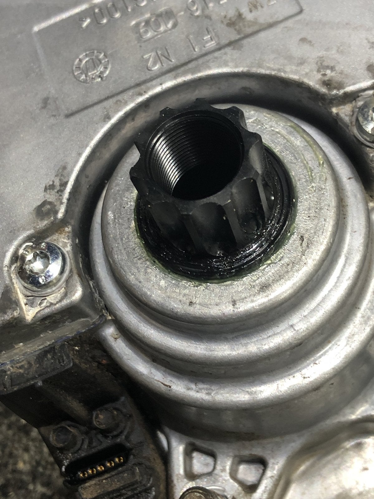

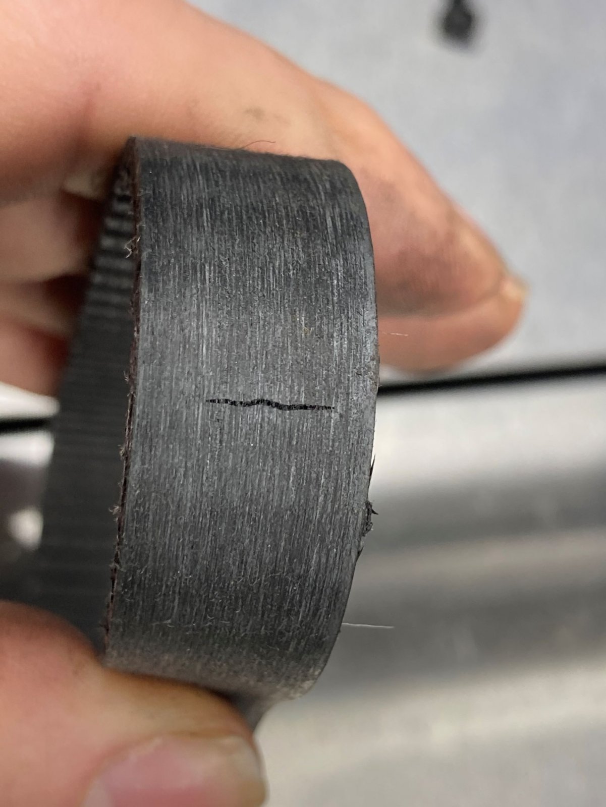

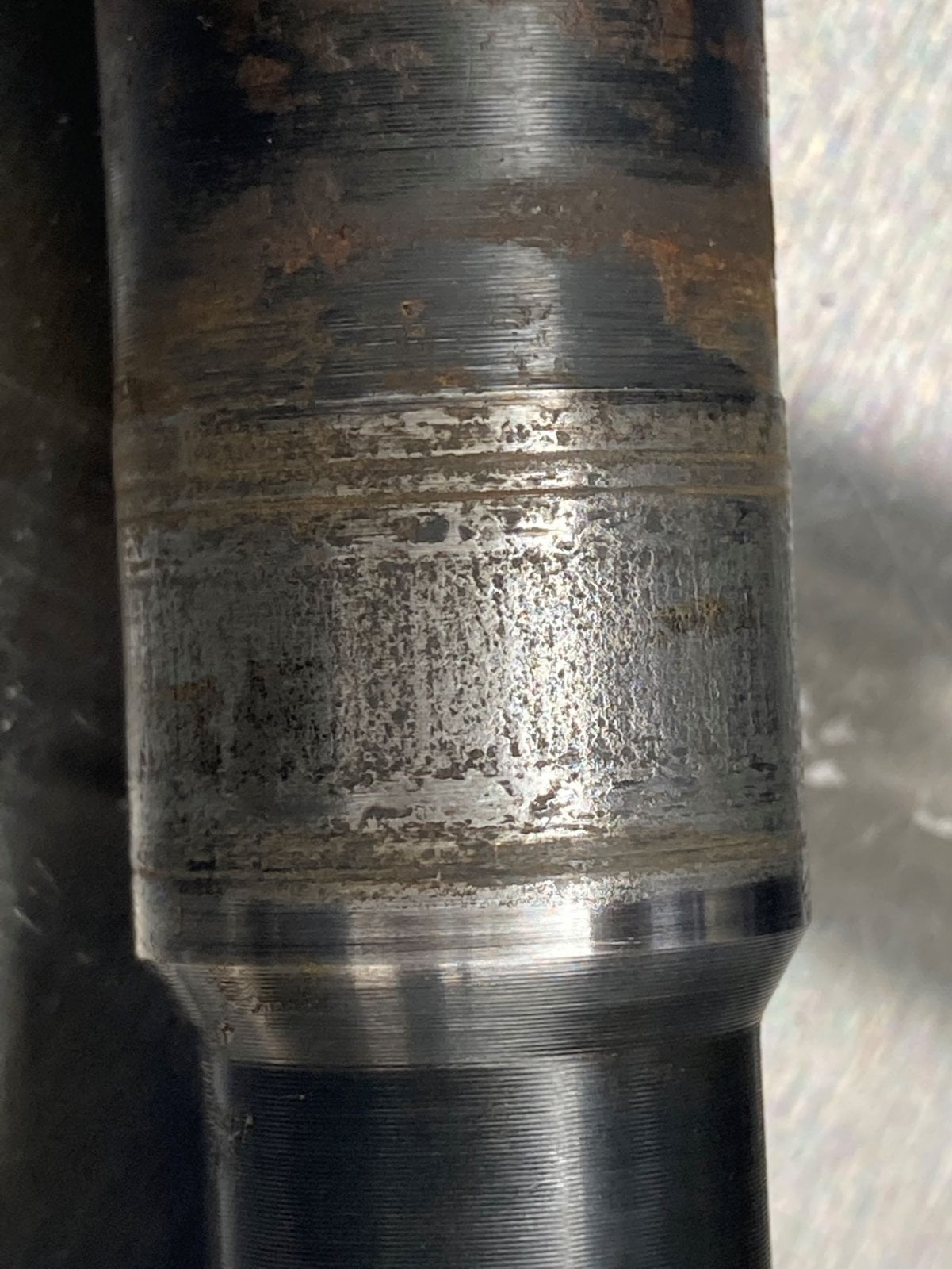

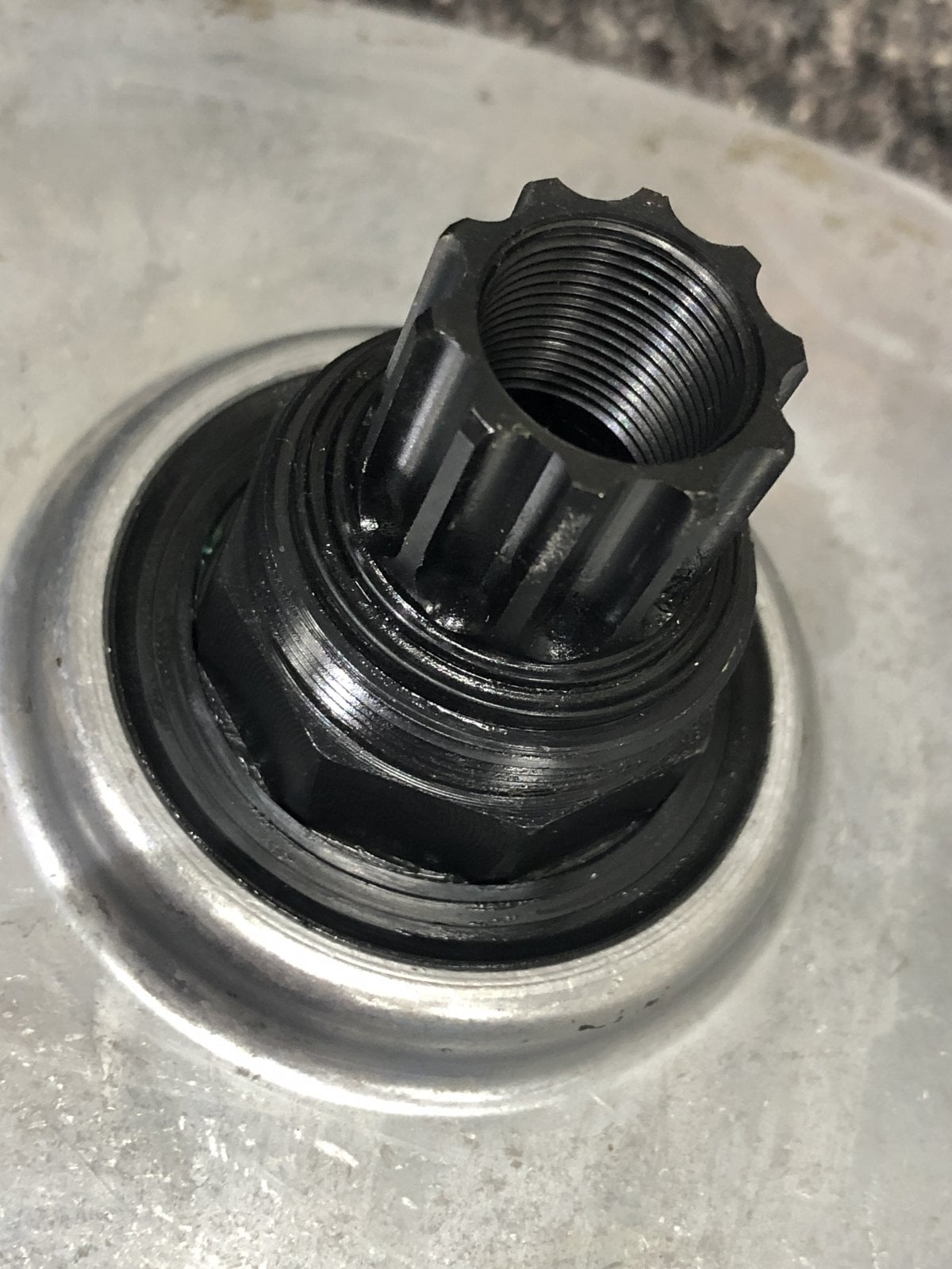

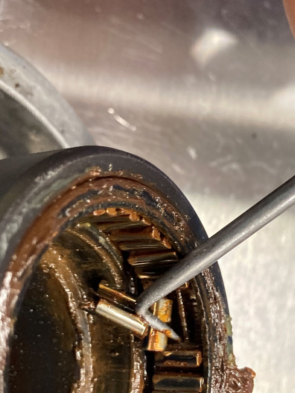

Update...So I removed the motor on Sunday, packed it and sent it Monday. It arrived at 09:25 on Tuesday and by 15:00 I had received an inspection report and photos from the guys at @Performance Line Bearings. I spoke to Pete, paid my money and the motor was dispatched this afternoon. What a service...I really can’t thank Pete @Bearing Man enough. I certainly dodged a bullet by not going out on Sunday morning, I was only only a few pedal strokes away from disaster. When they stripped it down, they found that the belt was split and the whole bottom end was full of mud and grit. The crank shaft bearing surface was obliterated and the needle bearings had to be pressed off!
i’ve added a couple of photos from the report below;
How this motor was still running is beyond me.
It’s now been fully overhauled and is on its way back to me. What a service these guys offer, New crank, new belt, new bearings, new sprag clutch and enhanced water seals. They even cleaned the motor contacts that had signs of corrosion and sealed the screws on the body that tend to let water in and all done within 3 Days....It’s cost me £405 which includes next day postage, but totally worth it, the motor should be better sealed from the elements and if I get another 5,000 miles out of it I’ll be happy!

Wow....just wow...motor arrived this afternoon (Wednesday) I only sent it on Monday. It’s fitted and test ride complete. You just can’t get better service than that. I can see the enhanced water seals on each side of the crank, which should definitely keep the winter crud out.
A massive thanks to @Bearing Man for the exceptional service especially at this time of year!
