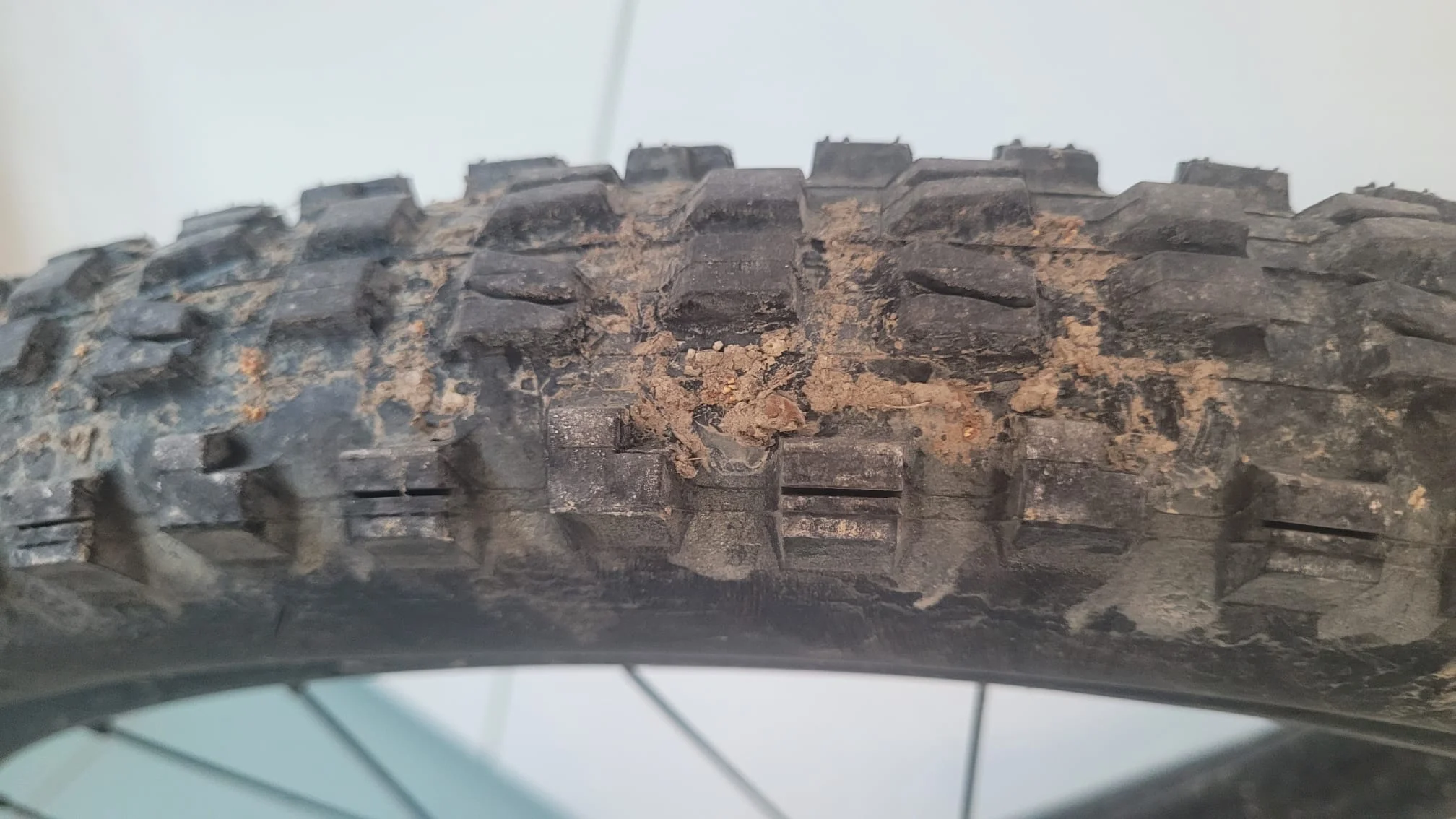

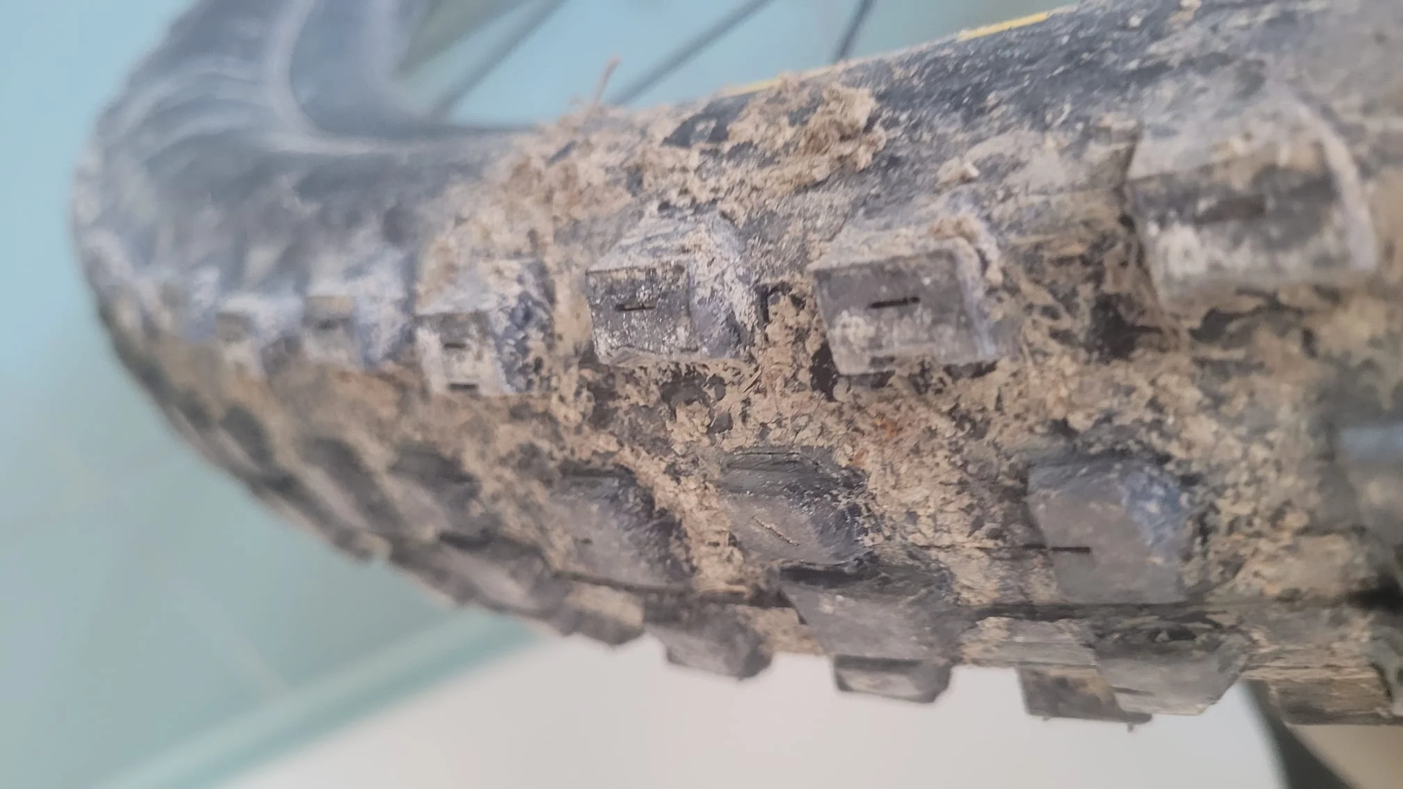

This is the current status of those tyres.
Front:
.... and rear:
not bad... right?
Front:
.... and rear:
not bad... right?
that’s because you don’t use your side knobs. do you even ride trails? you need to lean your bike in curves…
I ride a lot of trails, even challenging ones, but... to be honest, I am not a "racing" type of person. I don't care about speed or jumps or performance. And that's why I am and I have always been a solitary rider: because I do not want to slow down or annoy other riders.
I rather like enjoying the experience, visiting new places, riding for very long time, stopping whenever I like to take a picture, eat or drink something, or watch a beautiful landscape.
Therefore... I do not lean very much, you are right...

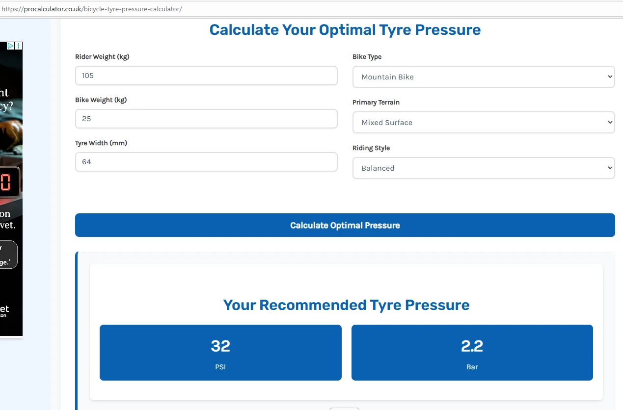

Btw: I am surprised that that tyre pressure calculator Bike Tyre Pressure Calculator | Road & MTB PSI - Pro Calculator UK doesn't make any difference betweer rear and front tyre. Is this correct?
they do say
'Should I use different pressures for front and rear tyres?
Many cyclists run slightly lower pressure in the front tyre (5-10 PSI less) for better steering feel and comfort, whilst maintaining higher pressure in the rear to support more weight and power transfer.'
I run about 5psi difference
but it depends on where your panniers are etc.

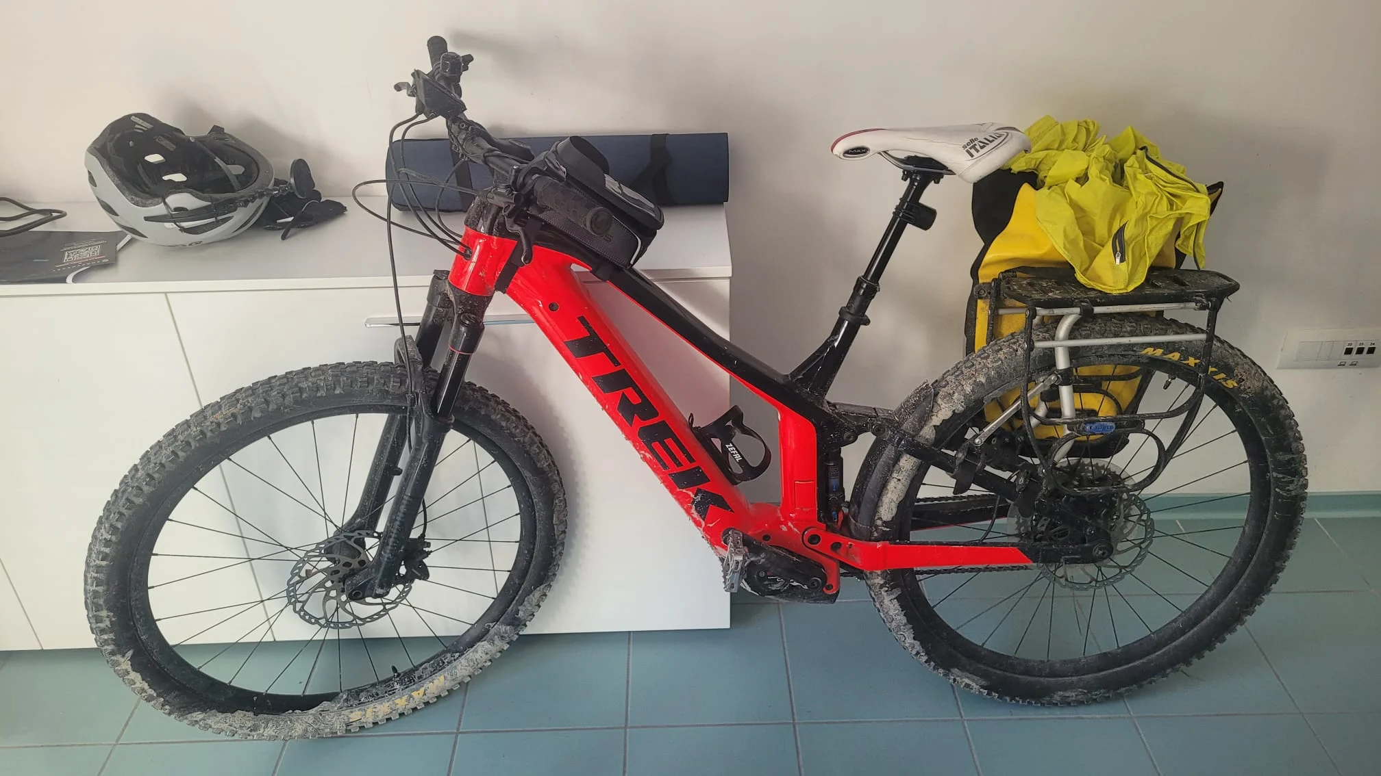

Thanks again. There is just one pannier, usually on the right, weighting a few kgs... This is "her", aka my love (a bit dirty after yesterday trail...), in all its glory:
2 years of trail riding and you still have whiskers on the side lugs... so my take it your riding isn't demanding AND/OR your actual trail mileage is very low over that time span.
I'll be lucky if I get 1 year out of a front tire and 6 months on a rear on my analog bike. On the eMTB I'll probably get half that...
If you got 2 YEARS worth of commuting and trail riding... I wouldn't do anything differently.
