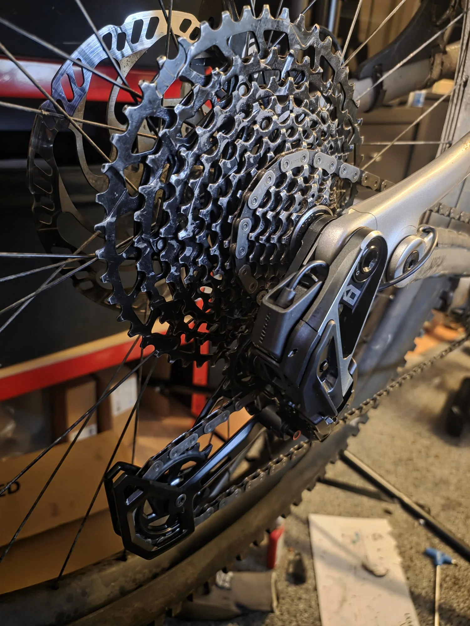

Good evening all, First post here at my whits end.

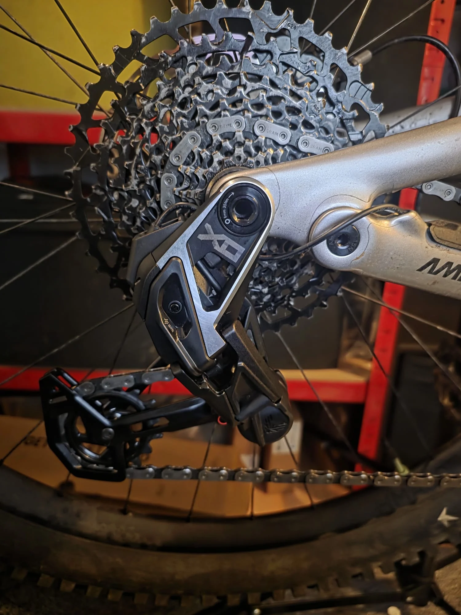

Installed a SRAM XO AXS Transmission to my bike today along with a new chain. All was going well until i tried the setup through AXS app that told me the wrong chain length :rolleyes:.
Anyway the real problem is when i set everything up following SRAM instructions the transmission wont stay on the "setup" gear and jumps down 1 gear no matter what i do with it. Repeated from scratch several times and still same outcome.
Since it jumps down one from setup gear all other gears are -1. So will not change into 12th and chain falls off cassette as its able to go lower than gear 1.
I'm not very experienced with bike parts but can follow these simple instructions. Bike is a non Pro from early 2025.
I have read that maybe a spacer is needed behind the cassette? A little lost what the next step will be so any help would be appreciated so i can get back out on this beast. I maybe purchased the wrong parts or need to replace something else here i have no clue.

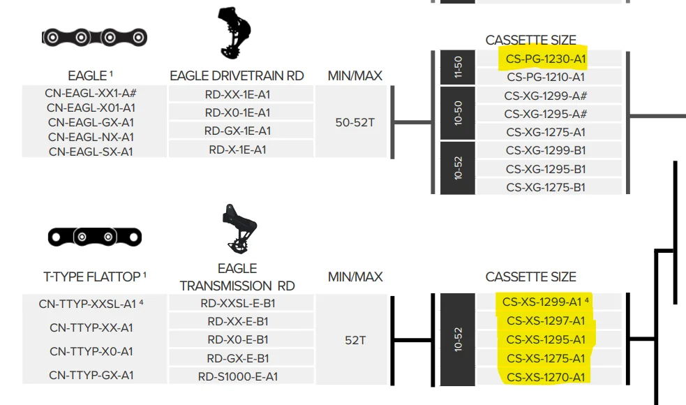

That looks like an Eagle cassette, which isn't really compatible with T-type chains. Otherwise, it should be 120 links, key position A, and 7th cog (6th gear, 24t).
If you change cassettes, note that the XS-1270 fits Shimano 11-speed drivers, which is probably what you have and the XS-1275+ fits SRAM drivers.

Correct. That's an PG cassette. You need an XS cassette. That will never shift properly.
As stated above. The XS-1270 fits a HG Hub. All other XS cassettes fit a XD Hub. So check your hub.

Current cassette is a SRAM PG1230 so i have a HG hub. Fully understand about the chain difference.

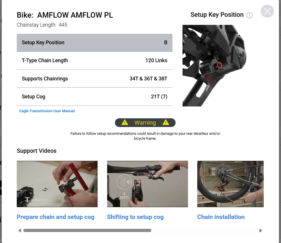

Also you mention Setup position "A" the website says B. 2 times now im getting conflicting info from website/App. Do you use A?

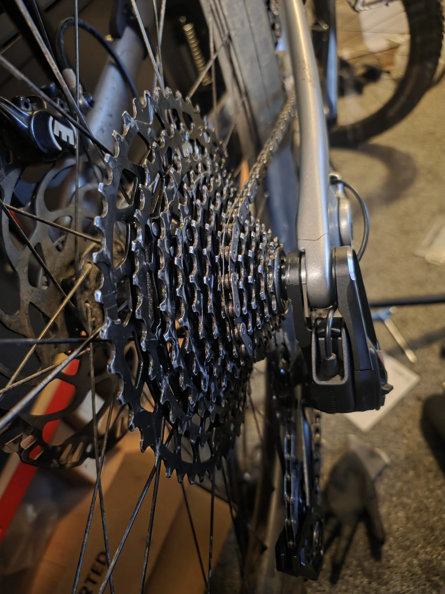

I see from your pics its indeed some unusual large distance between smallest cog and frame dropout. If you have a used HG cassette lying around you could dismantle it and use one of the distance rings between the cogs (they sould be standard for all of the non ultra-highend shimano cassettes and come in plastic or aluminium) and use it as spacer to get some offset. But this would be a tight fit since with HG cassettes the lowest cog sits separately on the tip of the freehub so in worst case it won't grip, so you would need to grind down the spacer until it fits (and hopefully be in range of the AXS micro-adjust).

That's the problem. The new cassette sits 2.5mm further out than the old, and you don't have 2.5mm of micro-adjust in the derailleur. So you cannot get alignment. People have used spacers, but then you get less threads engaging on the hub, and this weakens the connection. There are reports of it stripping under load.

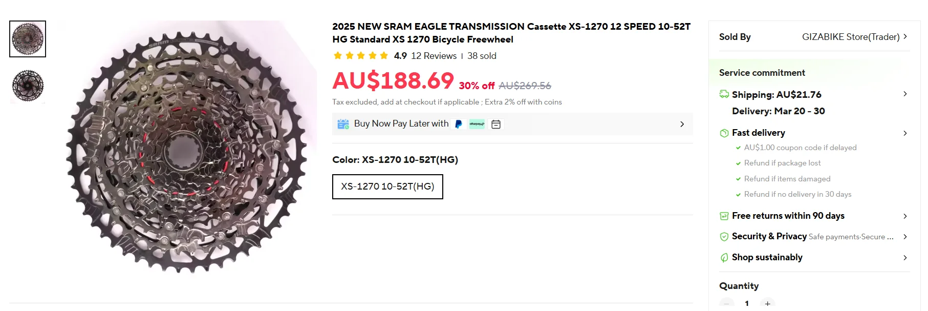

He really needs the XS-1270 T-Type cassette, which will fit correctly on his HG hub. Aliexpress have that cassette for sale for just over 100 pounds. Then the derailleur will align correctly. The T-Type chain will engage properly, and he'll get good life out of his components.
Awesome explanation there. I have purchased XS-1270 today and will report back shorlty.

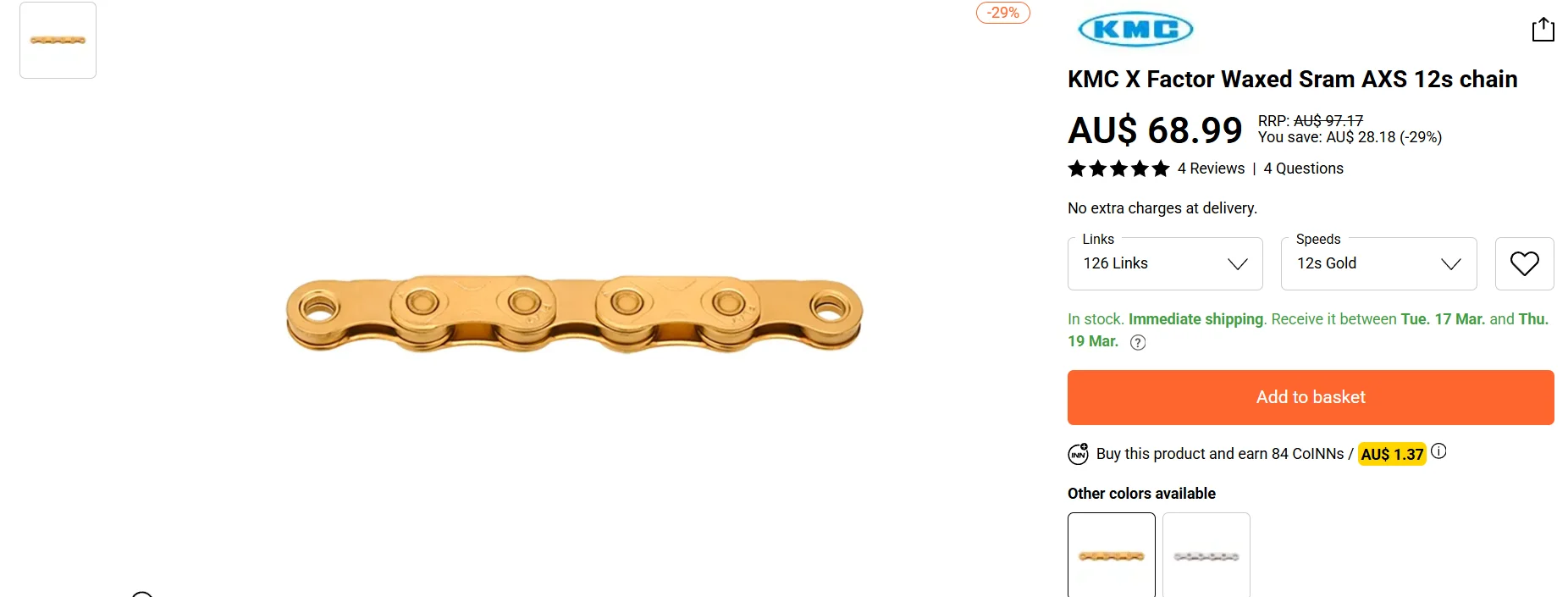

That said, KMC have just released a Gold version of the T-Type Flattop Chain. I am definitely going to try it, as I have a Gold theme going on my Amflow.

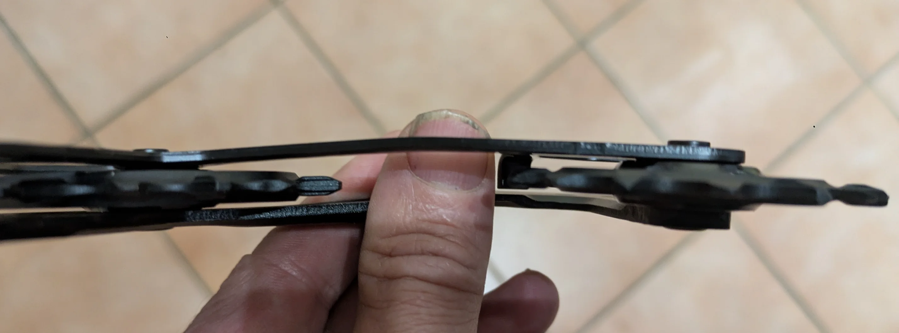

The jockey wheels are exactly centred on their axles in the cage. This is a photo of a spare T-Type cage I keep.
So if you are shimming them 2.5mm inwards, to align with the cassette sprockets that are 2.5mm further inwards, then they will no longer be in the centre, and you would be forcing the cage wider. Both of these facts are not optimal for best performance and life of you transmission. But indeed you have saved a few bucks.
If saving a few bucks is important to you, then well done. But tolerances for perfect shifting are tight, and doing that would allow for more movement of the chain within the cage and thus more movement where the chain engages on the sprockets and ramps, and the jockey wheels would not be rotating centred on their axles.
I meant the jockey wheels aren't centred in the cages after you have shimmed them...
But it really makes very little difference as they are shimmed equally top and bottom, and the two sides of the mech cage are bolted together via the jockey wheel bolts - so as long as the bolts are long enough to engage properly, everything is parallel and will work just as well as it did before.
