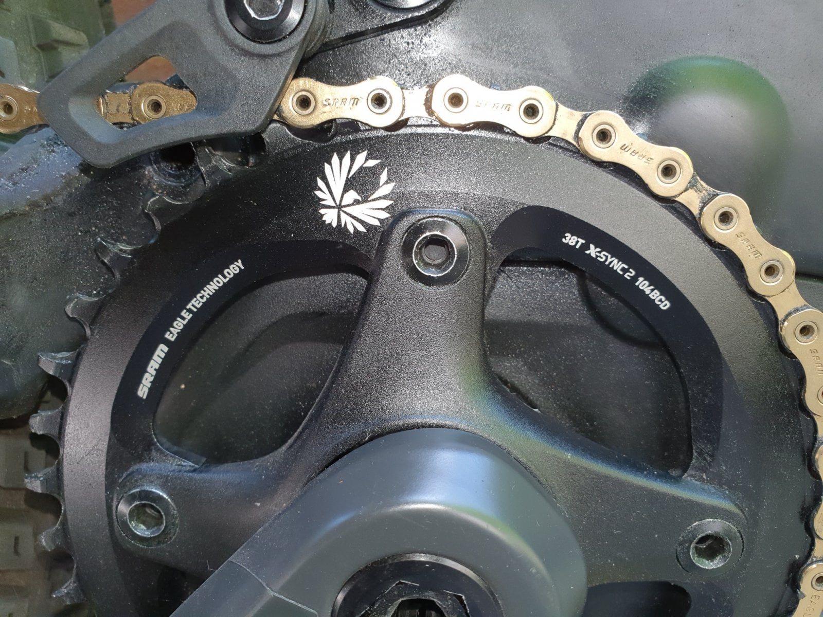

Not sure about any offset... I’ve attached a photo of the chain ring showing what’s printed on it (you can also see the modified chain guide which accommodates the 38T ring). I also needed new chain ring bolts (6mm, not 10mm) because the original chain ring attaches directly onto the spider and the Eagle ring doesn’t. My chain now has 122 links for this set up - I have a 10-50, 12 speed cassette on the back.

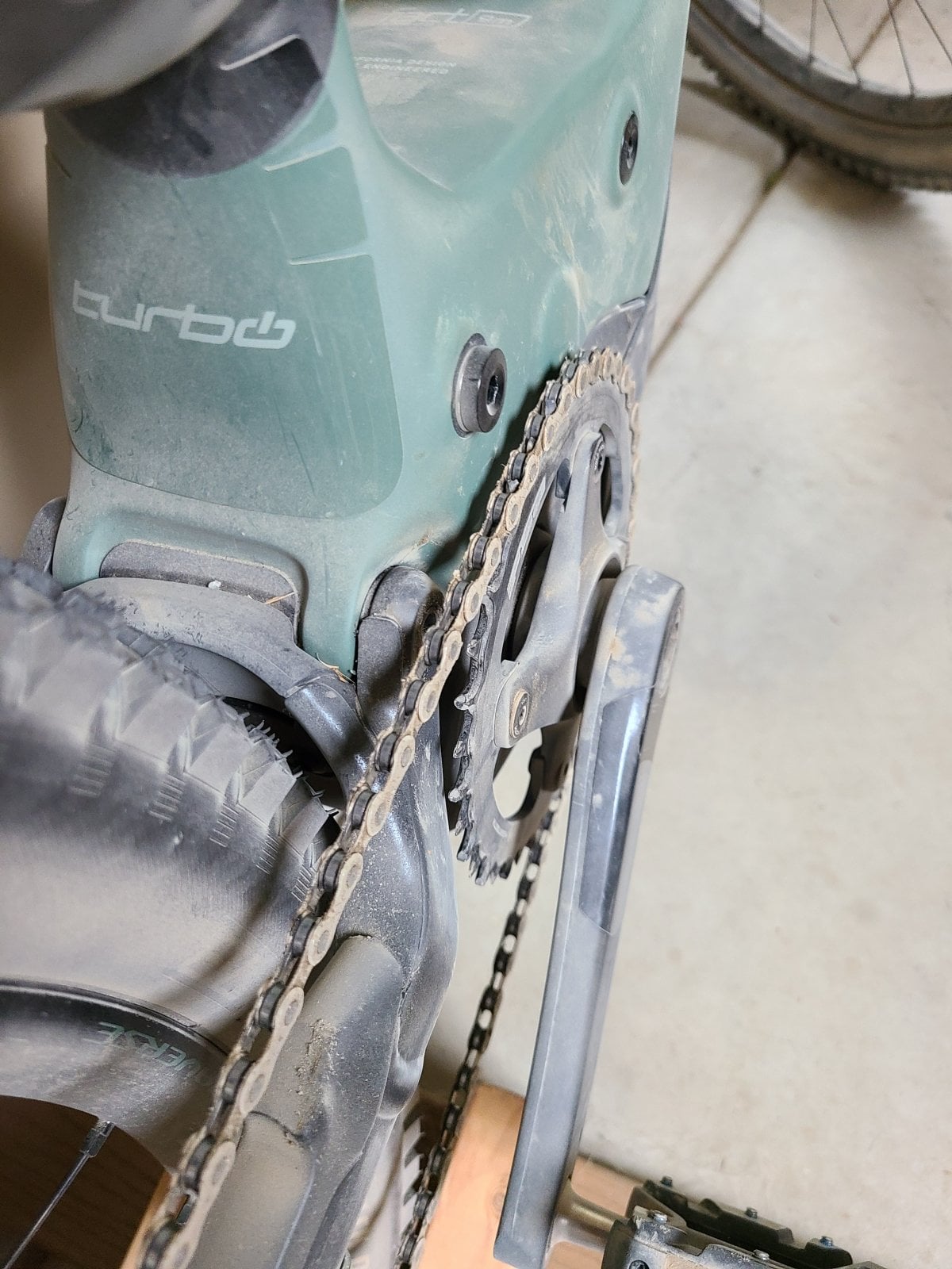

I am running a 38t chainring on a turbo levo and while the tolerances are quite tight to the frame, it does fit and will work with the original chain length. Is anyone running any different cassettes? I am thinking about a 9-42t and maybe dropping the front to 36t. The closeness of the chainring teeth to may carbon frame makes me a bit nervous....

hello guys, i am wondering if you could help me, i just got my turbo levo 2021 and just bought a 38t Sram eagle chainring, however it doesn't fit on the 2021 frame, the teeth are touching the frame.
Does anyone else have the same issue, it seems to me that for the 2021 levo , i could fit only a 36t chainring, looking forward to your feedback. Cheers

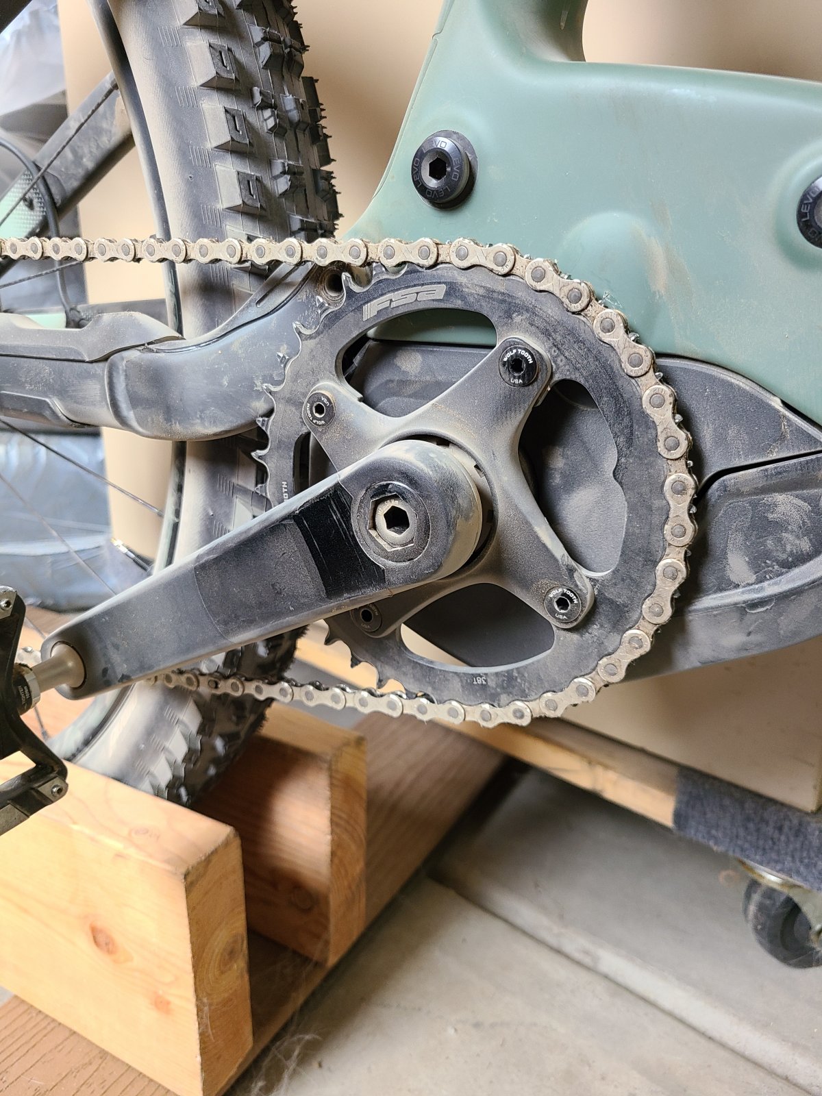

I have a FSA megatooth 38t chainring on my 2020 levo and it is very close to the frame, around 3mm. The guy at the LBS said it was fine but when I asked Specialized they said the maximum that would fit is 36t .
