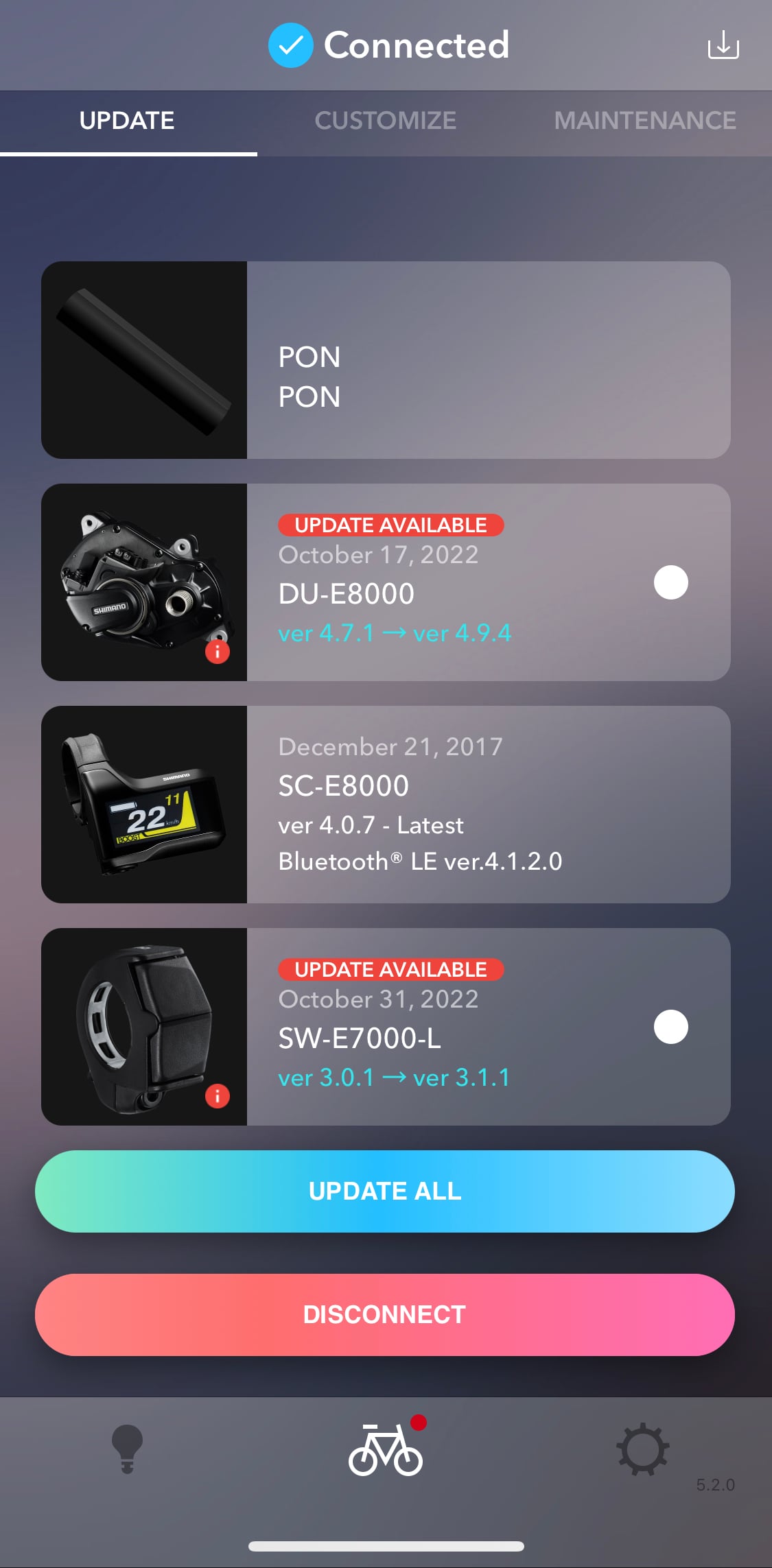

Which firmware are you using? After my last upgrade in a Shimano jam2 my diy battery has stopped working
Tooks
Mar 29, 2020
416
504
Lincs UK
I’ll check next time I’m in the shed, but I haven’t updated the firmware since about 2020, if it ain’t broke don’t fix it and all that! 👍😂
merlot
Apr 27, 2021
23
7
ES
4.9.4 is mine and it's about 1 year old. So, probably yours will be a previous one.
Tooks
Mar 29, 2020
416
504
Lincs UK
Looks like I’m on 4.7.1.
Thanks for the heads up, I’ll not update in case it no longer works with my 2 range extender packs. 👍
