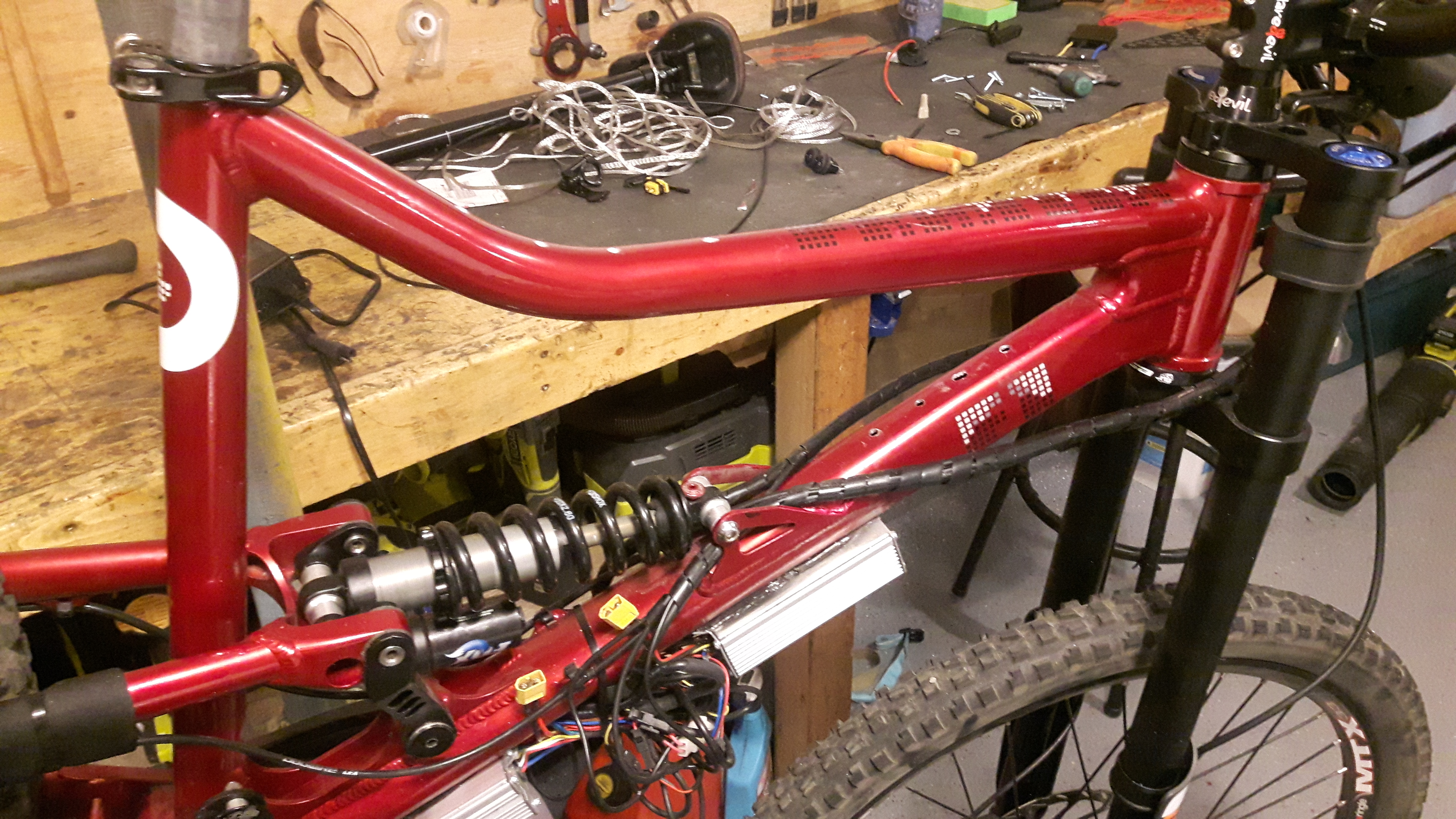

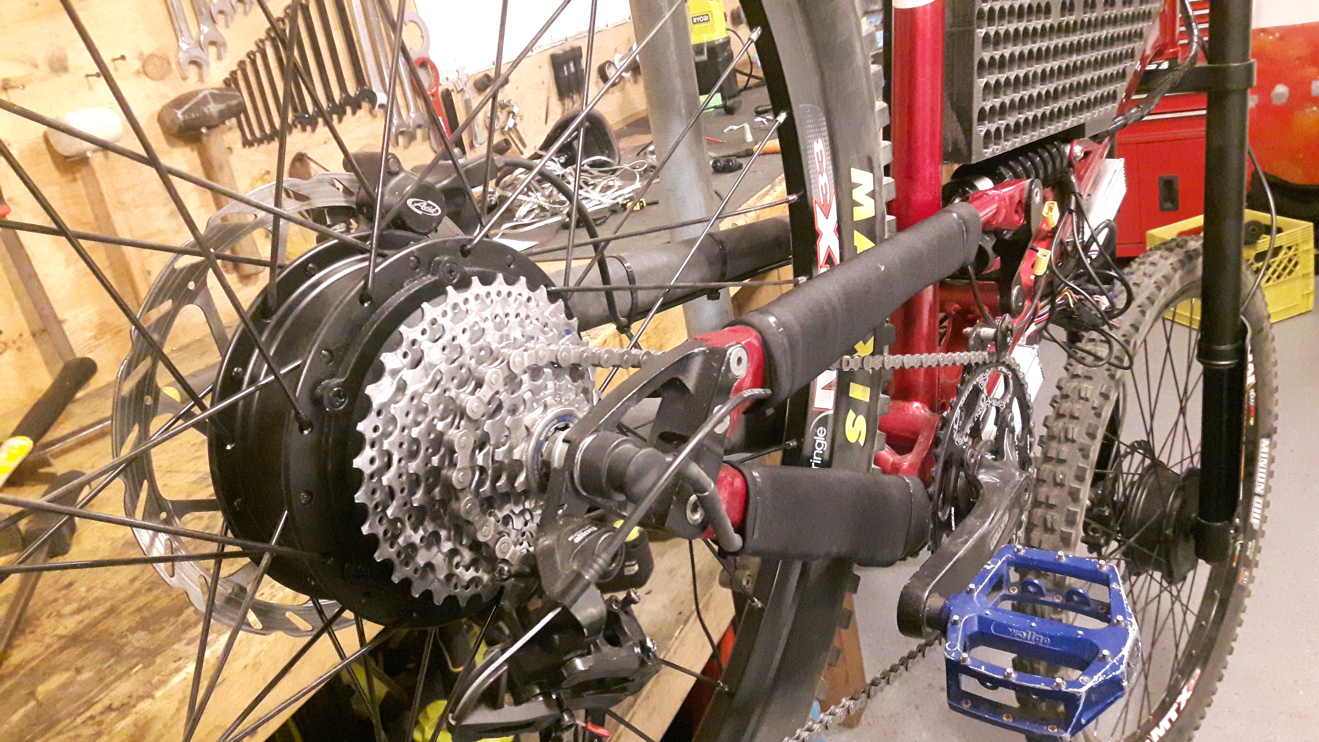

hi all, just another crazy build from your truly.
it was a 27.5, but i re-welded the rear swing arm longer to fit 29er, and larger fork for 29er also.
stock travel was 165mm, increased to 195mm after lengthening the swing arm cuz math's.
front fork is 200mm,
200mm rotors front/ rear.
1500w controller x 2

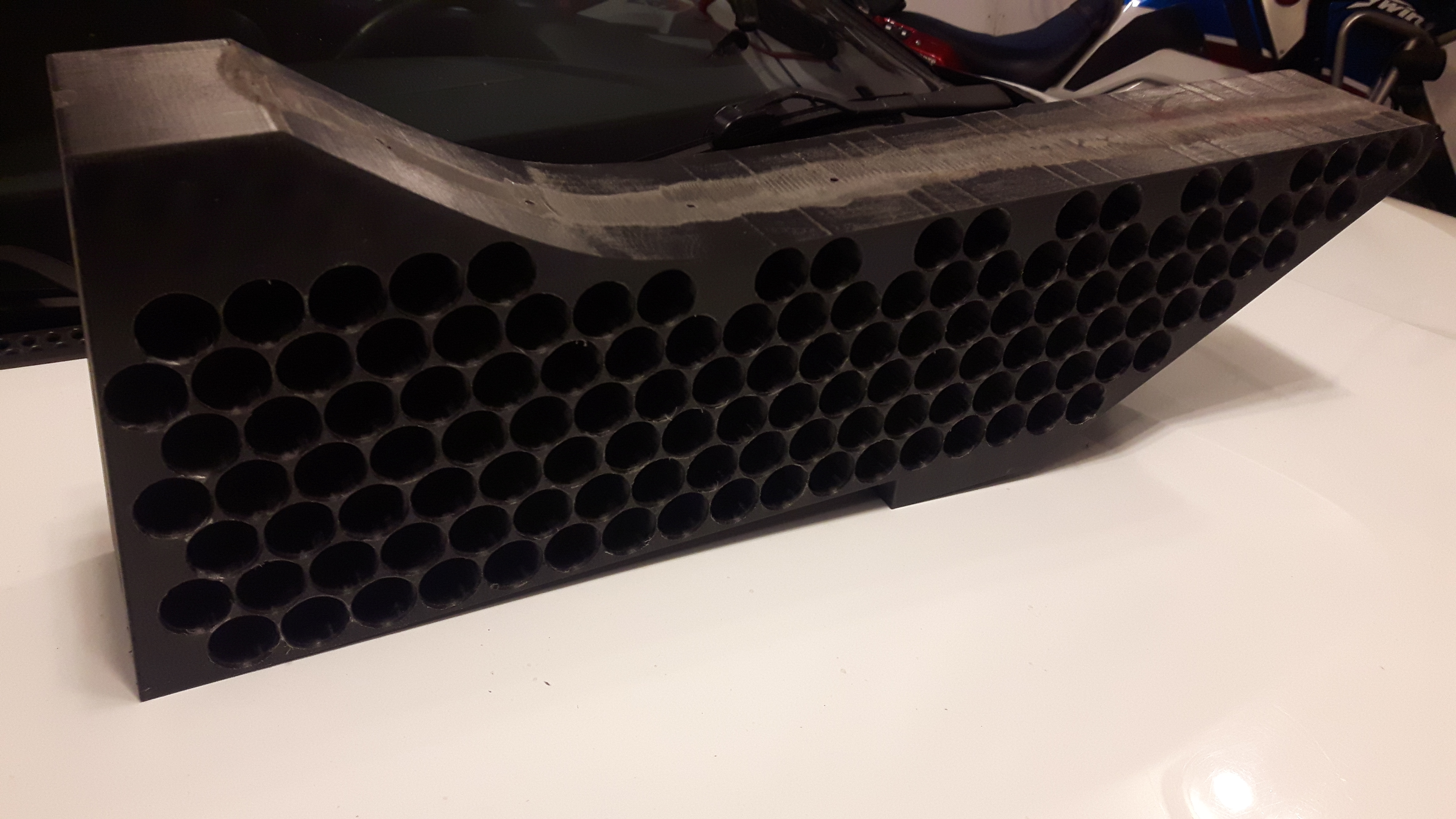

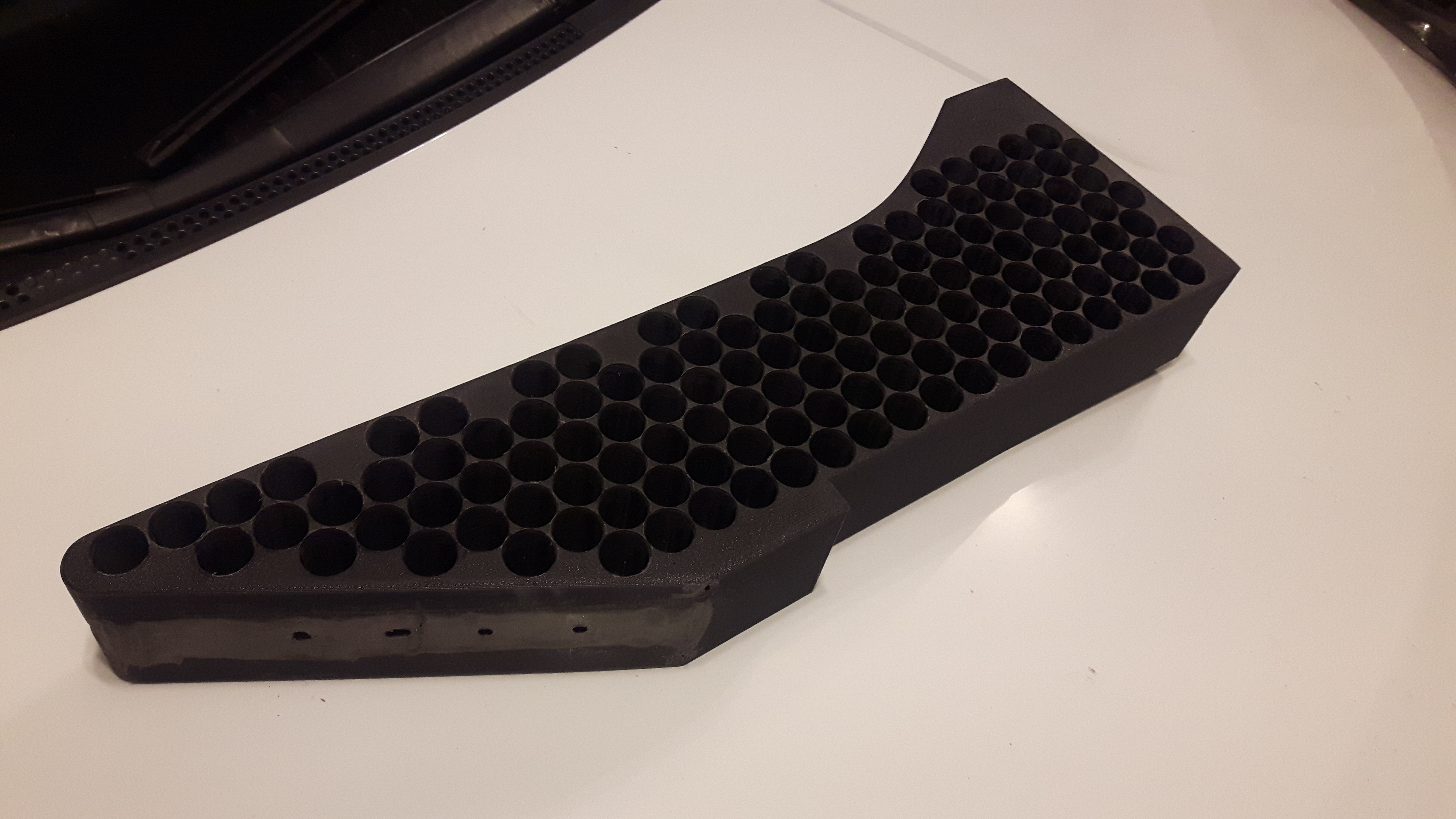

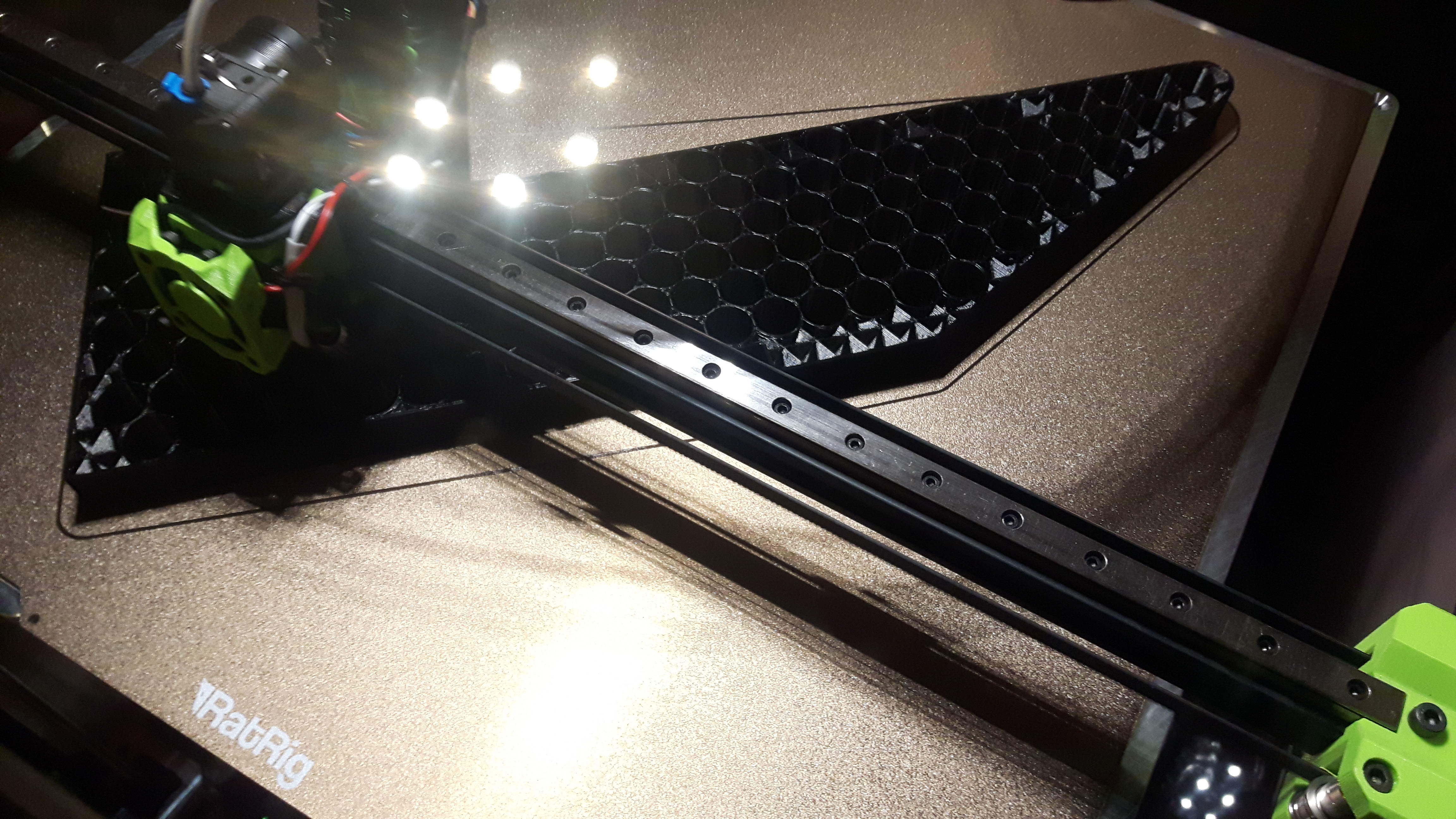

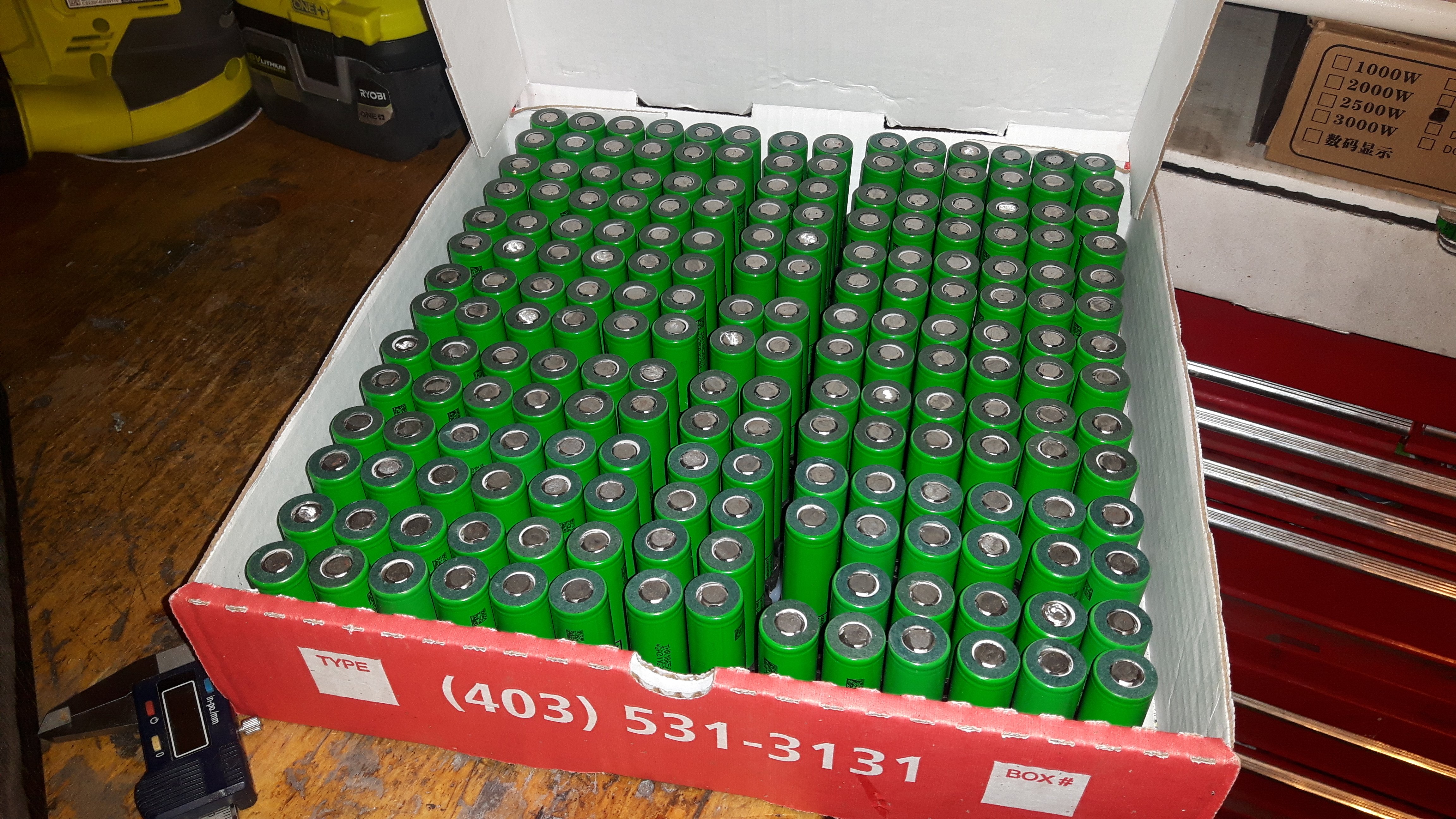

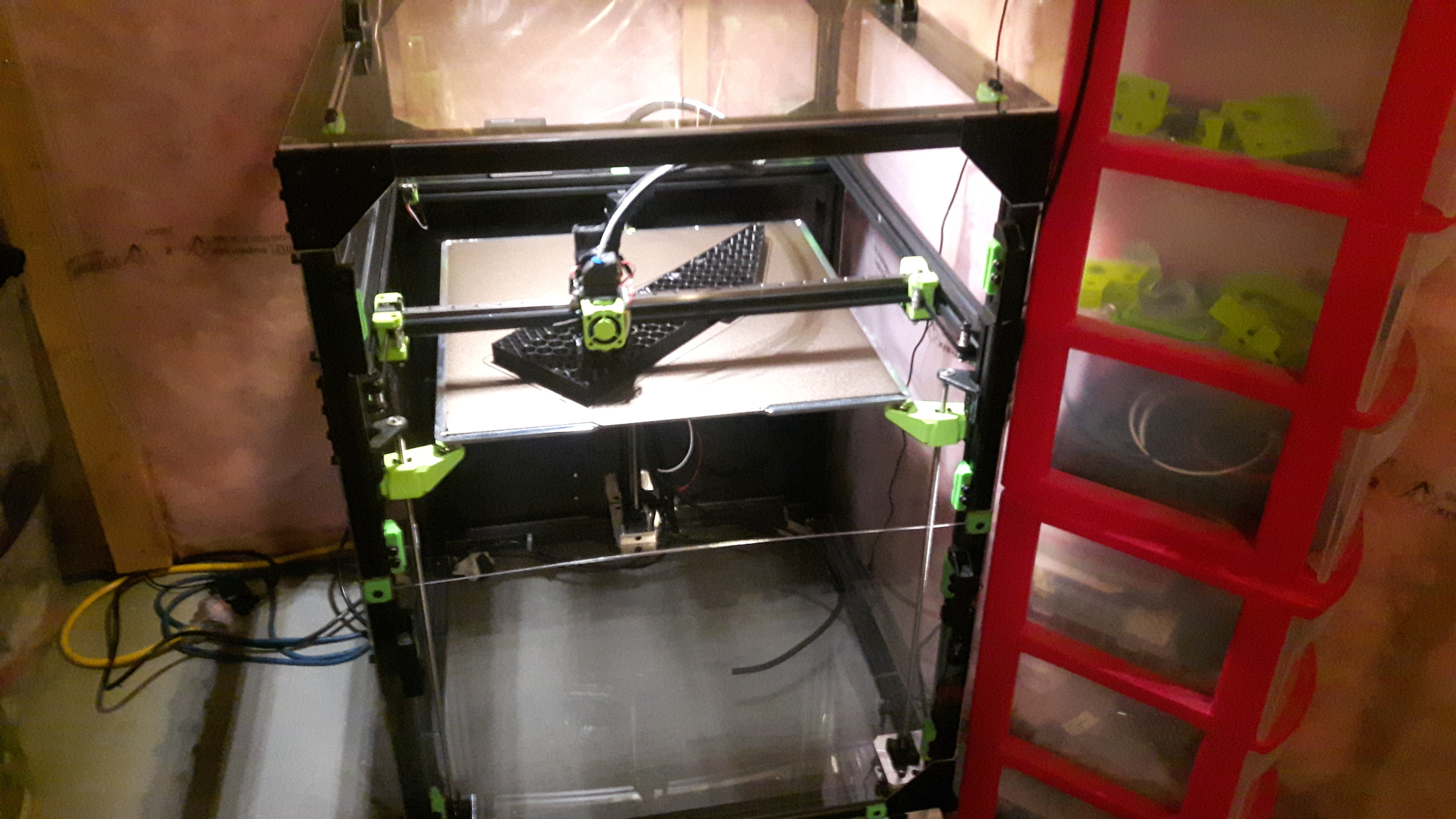

I 3D printed a 126x 18650 holder that fits inside the frame.
using LG-mj1 (3500mah) so 126x 1600wh battery 52v (14s)

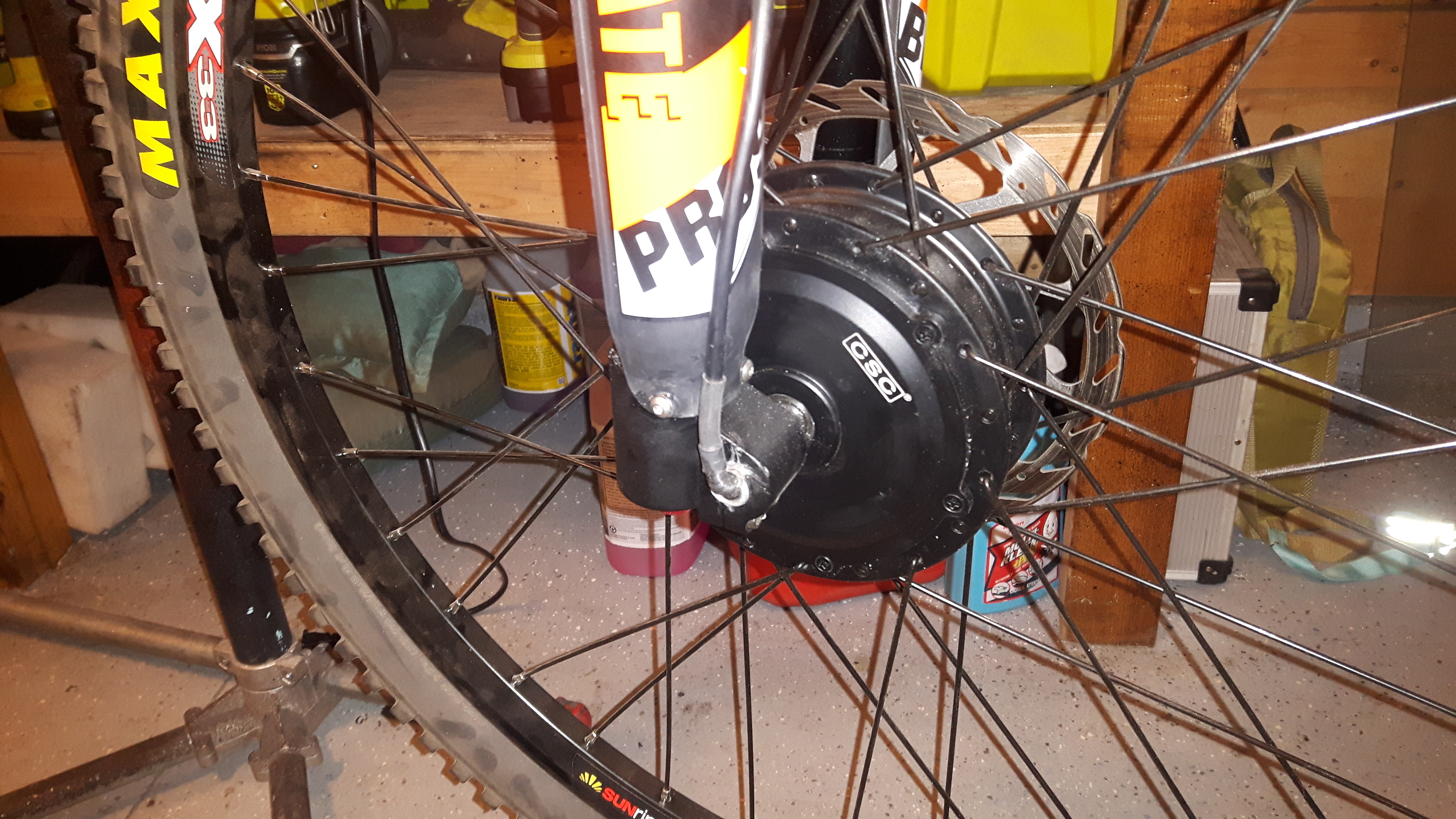

front motor is controlled via thumb throttle only, rear wheel is PAS/different thumb throttle
havent finished yet, but took it out for a test rip, around 70km/hr top speed. motors are gears for Torque and o boy does it pull hard.

Doesn’t the shock hit the battery pack when you bottom out the rear swingarm?

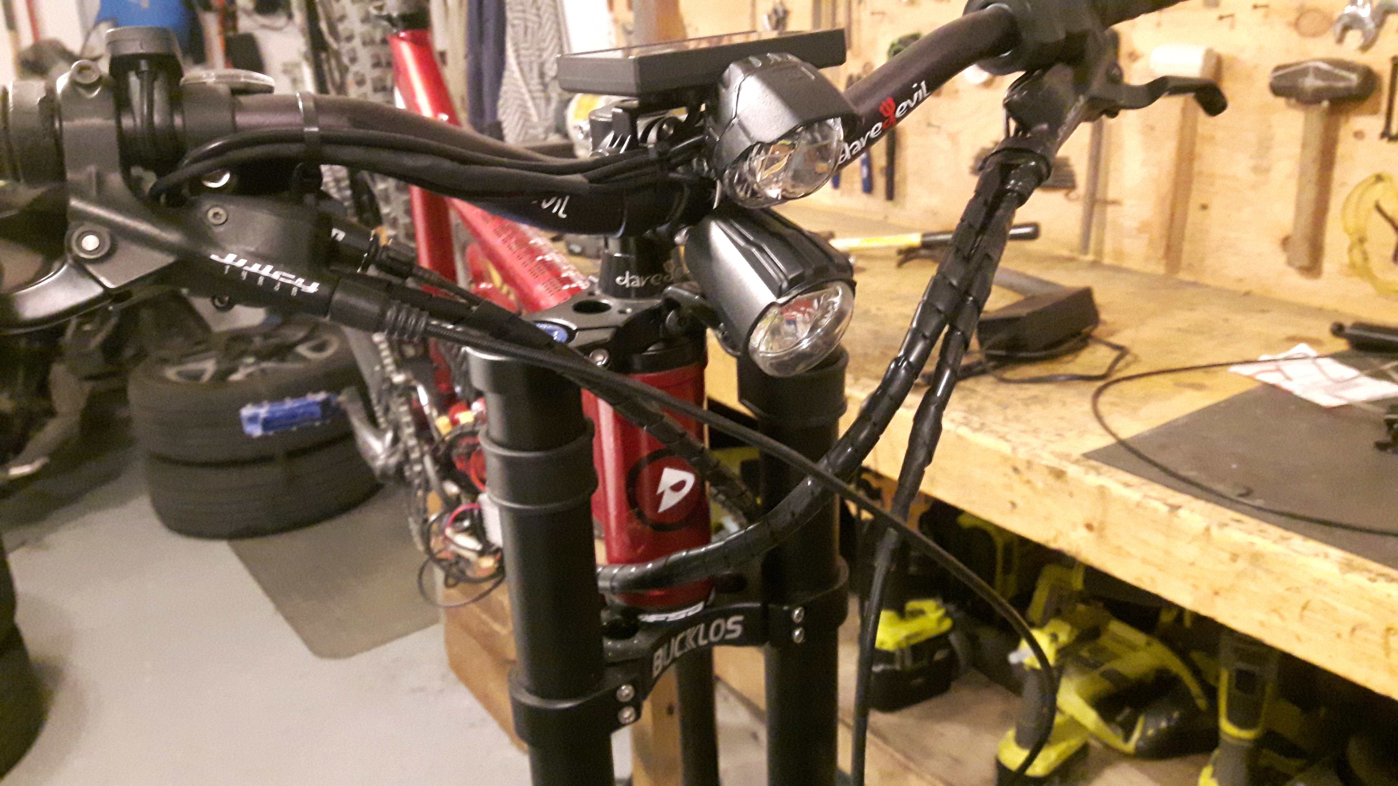

Don't get me wrong that looks amazing fun and I definitely want to have a go! but also I never want to see that on dedicated MTB trails either.
Please put some decent brakes on it, those Juicy's were bad from the factory so god knows what they'll be like now :)

That's way too much weight in the hubs for it to be any good on a DH track and with the extra weight/holes drilled in the frame, I would send it.
Fun project, and maybe a good commute bike.
o yeah, ur 100% right.
no way you can go real hard core down hill any more with it. but thats not the point of the build. its more of a real comfortable trail bike with alittle bit of mild down hill thrown in

It is the Two Wheel drive which really confuses me. What benefit does it add, proven to be a waste of time on Motorbikes.
2wd = double the power cuz two motors.
Another huge advantage of 2wd is half the heat and/or double the cooling cuz double motors/controllers. Assuming you keep it around 1000w. I'll be able to physically go farther without the risk of over heating. Currently when I'm out with my bbshd I have to limit my self to around 500w in order not to cook the motor/controller.
2wd actually provides very little actual benefit in terms of performance. However, it does do a lot in loose dirt and sand. And especially in mud. My God in mud it feels like magic, a very strange feeling on 2 wheels.
