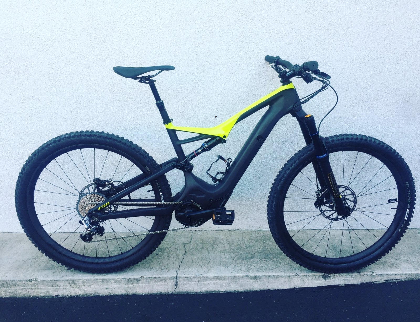

I ran Roval Traverse SL 29s with 2.6” Butchers on my S-Works
Here are DT-Swiss 481s with Maxxis DHF 2.5s on my old Expert
View media item 344

Thanks for posting this, Al. Tires do vary in aspect ratio, and it's good to know that the 29x2.6 Butchers are lower profile than some.
