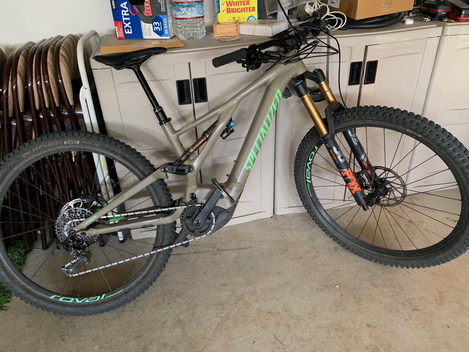

This part # is the DPX2 in 210x52.5. I bought it and installed it on my levo with the existing hardware with no issue:
973-61-017
I also have the Ebike specific F36 160mm.
Extremely pleased with how the bike improved over the original components.

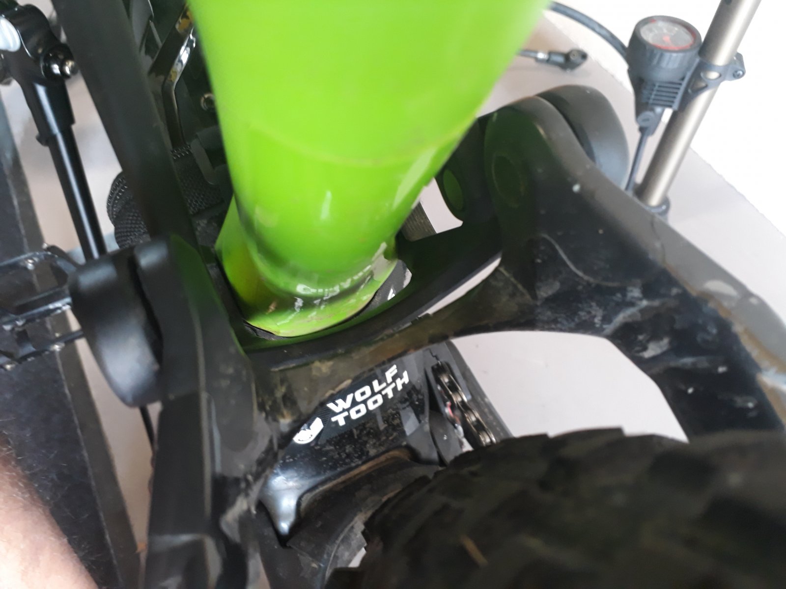

The eye to eye is the same, so mulletting the bike won't help, in fact it may make it worse (see my second point). First, you'd need to make sure than none of the linkages came into contact with the frame on full compression. If there is plenty of clearance your next issue is how much lower the BB will be under full compression, a 27.5 wheel will make this worse.

People are saying the 210x55 is fine on other frame. Never seen anyone try a 210x60 tho. Maybe if you mullet the bike?
i tried today an rs 210x60 and it fits well, very impressed about how it absorbs bumps so well now,none of the linkages came into contact with the frame on full compression.
I run 27.5 , flip chip high, i don't do high jumps.
200psi, one token + one proimpact polimer, 35% sag.
I am 75kg.
I have to do some tests now.
