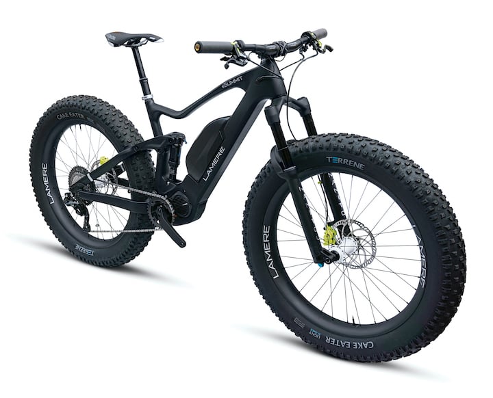

Hi Alex, sorry you had to listen to all the posts just talking about normal eMTBs when you were asking about a full sus eFat.... so to best of my knowledge LaMere Cycles makes the only full suspension full carbon eFat using the Shimano motor, with our custom made cranks. People are blown away by this bike, everyone completely loves it and its truly an awesome bike. We could do HED carbon fat wheels and skip a dropper but would still only be able to get it down to like 46lbs but that's really light for a 630Wh battery bike. If you can think of a way to make it lighter lmk.... but you will not complain about the weight at all when you ride it I promise!
Check it out here:
Thx, JP
Check it out here:
Thx, JP

In defence of LaMere, there bikes are the real deal when it comes to lightweight full power bikes, but they often dont get taken seriously because they still use external batteries.
The issue at the moment is that aesthetics trump engineering when it comes to making a lightweight full power bike - if you go down the external battery route, and stick with a 504wh battery then its possible to get close to or at 20kg - the beauty of the external battery ecosystem from shimano is that you can easily swap in a 630wh battery if wanted.
Engineering the battery into the frame means more weight - the internal batteries weigh more compared to their external counterparts, and the free needs more reinforcement too.

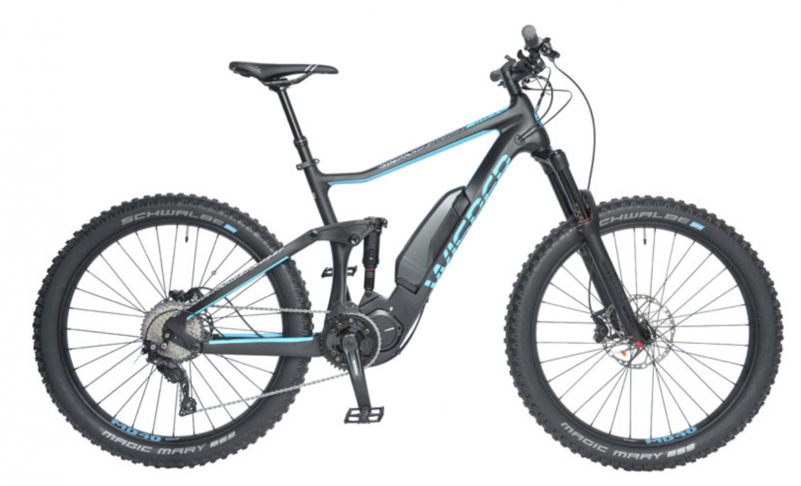

Wisper Bikes, who are more famous for building shopping bikes, produced the Wildcat four years ago - they only did it for one year as sadly they didn't really get the word out, as it was a great bike, I believe based off the same frame as the Lamere. There is a guy out in Surrey Hills who has built one up to be (claimed) just under 20kg, running some very high ens kit, carbon wheels etc.

Hi, so I have to respectfully disagree with all you say, reasons below.
External batteries do not look as stealth to be sure, but they are much lighter. The reason for this is the plastic case Shimano uses on an external battery and also when you do an external battery it is just resting on the downtube so frame requires less structure and support. The internal Shimano batteries have a metal case, making them heavier.... I don't know why they do that I would like to know!
We actually do have an internal battery version of eSummit you can see on our website but we don't sell as many as customers want the bigger external 630Wh battery for more range. So we can only do internal 504Wh battery versions now, but if you do the external battery version of our eSummit we can do a 418Wh, 504Wh, or 630Wh size.
This Whisper bike you show is not a fat bike its a plus bike.... it can not fit fat wheels and tires like a big 26 x 85mm rim with the biggest Johnny 5 fat tires like the eSummit frame can.

The point I was making is that by using an external battery you can get a lower weight - IIRC the external batteries are lighter casing because they are not subject to as much force as an internal battery, where whether intentionally designed to be or not they can act as a stressed member - that is what Shimano told me a few years back - i.e the internal batteries are heavier duty casing because they are likely to be subjected to more forces.
I wasn't specifically referencing fat bikes, more the possibility of building a full power 20kg MTB, is achievable using Shimano EP8, and external 504wh battery. From memory there is negligible difference between the 418 and 504 batteries in terms of weight, but about 1kg difference between the 630 and 504 (I have both but cant remember exact figure from when I weighed them).
I believe the frame you use is an OEM spec frame you use is same from your original Diode as the Whisper? Your OG Diode is a very good example of a 20kg full power bike.

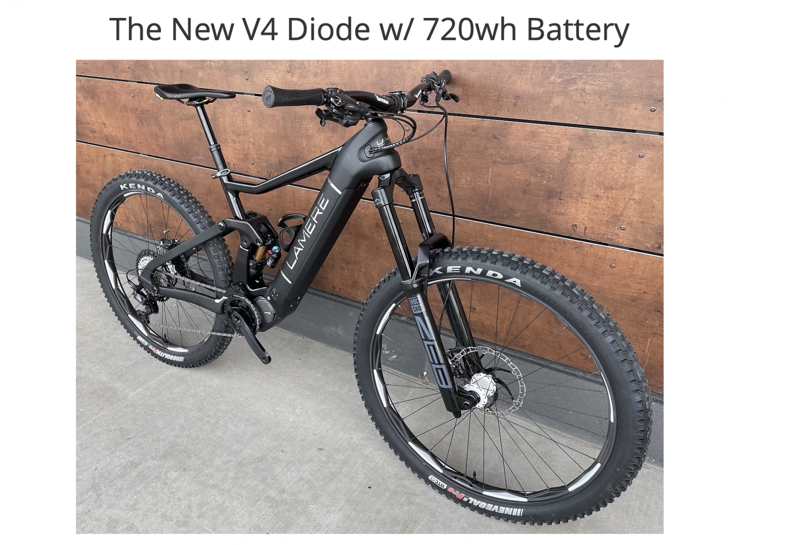

Out of interest how much does you V4 weight in the spec of the attached pic, with the 720wh Battery?
Oooooops, YES I was agreeing with you.... we are on same page: external batteries are lighter but the bike industry does not think they look as cool. Thanks for your explanation of the internal batteries using the metal case, that makes sense and sounds familiar.
So our V4 Diode bikes are heavier with the huge internal 720Wh batteries.... and just bigger travel bikes like this with 160mm rear travel get heavier..... this black one above even with the Kuroshiro rims weighed 49.5lbs (22.45kg) sans pedals..... but most of the builds end up weighing like 51lbs (23g).
Thx! jp
