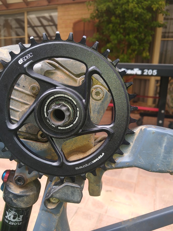

My current Focus Jam 2 has a 34T chainring. After 1800 km my rear sprocket needs to be replaced. This is because I tend to use the top few gears. I want to get a larger chainring so I use a wider range or rear gears. I was thinking a 38T. Would that be a bad idea? I don't know what mount type is used so I'm lost when looking at the range of chainrings. Here is one that says it is specifically for a Bosch CX Gen 4. Would that do? Any other suggestions?
I'd check that the larger diameter chainring doesn't hit the chain stay

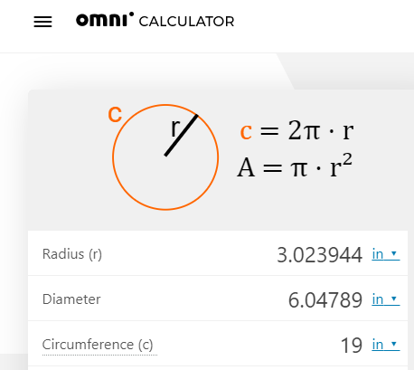

38t =approx 19 inch so divided by pi = approx 6 inch diameter

What Jackware said - I went from 34t - 36t and it's a close fit at the chainstay
:eek:
I've not tried it yet. It's still sitting on my desk. I measured it. It's 6.37" diameter.

Its still not fitted. I need some stupid spider tool.
