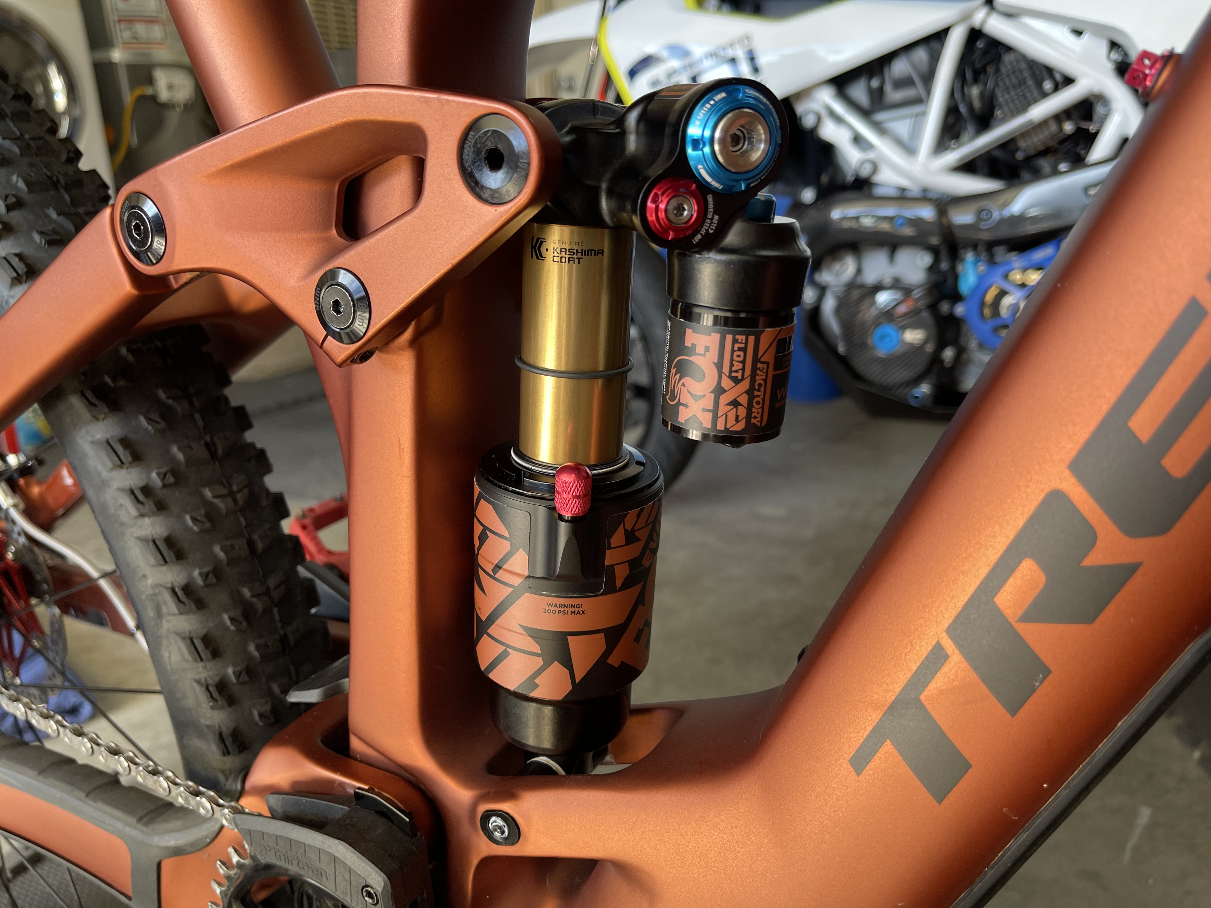

Sent my X2 performance in for warranty today, they will be sending me a 2024 factory model to replace. The shock was still working ok, but when adding a volume spacer, there was a lot of oil in the chamber, and the air pressure was starting to drop as the oil and air chambers co-mingled. It lasted me 5 months, 1300 miles. The bike is a 2022 Levo Expert. I look forward to riding the updated model, hope it lasts a long time!
Canyon Shawn
Feb 4, 2023
246
168
Lake Sherwood, California
Oh nice! It’s nice that Fox steps up and gives people new updated shocks. Although, they should have had a handle on this a long time ago. I’ve installed mine. I have a couple hundred mikes on it. I opened all the adjusters, set sag to 30% and set the adjusters per Fox recommendations, which are based on the psi needed to get 30% sag. I really like it, a lot. And I just installed a Marzocchi coil kit into my Fox 36 Rhythm. It’s a great combination.
