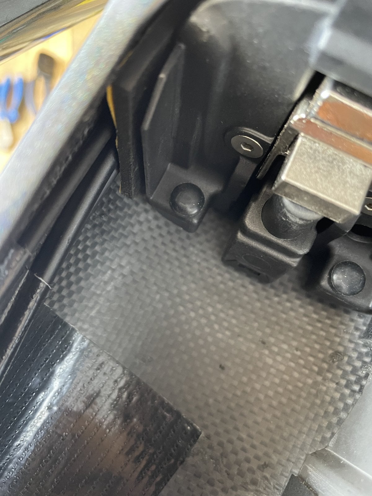

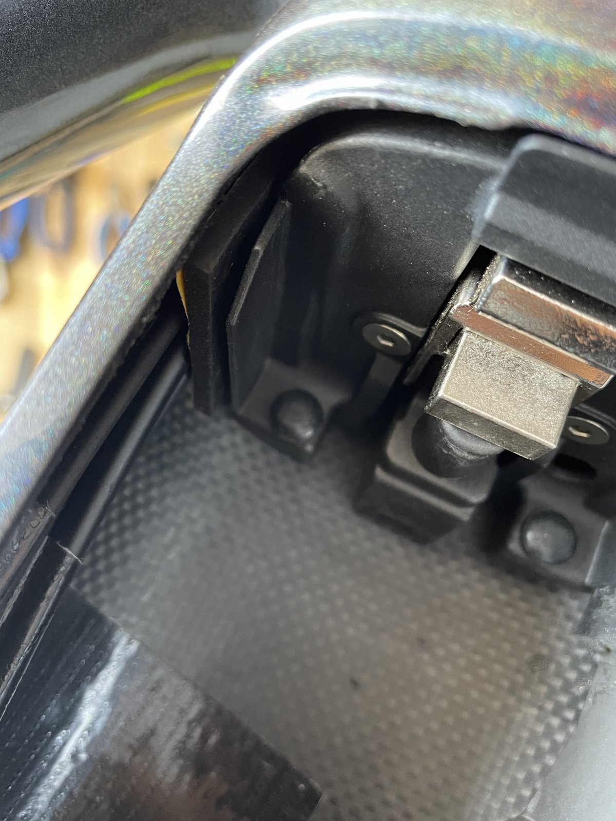

  • Tech informed me that the connectors on the female end of the battery appeared to be bent.
  • All photos have been sent to Bosch for review

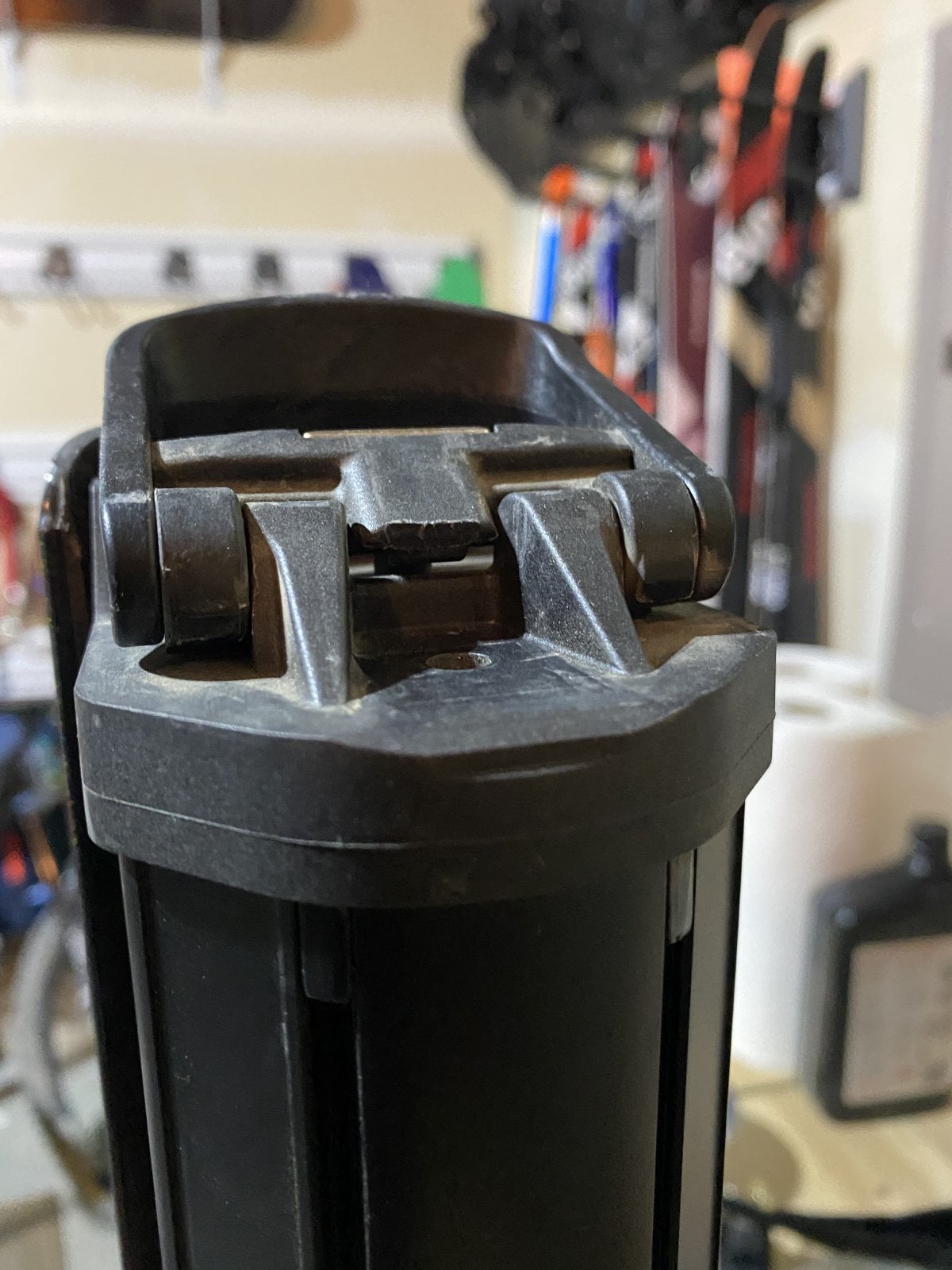

I have been able to replicate the electric shut off. On a test ride tonight I noticed that the Battery rattles up and down. Meaning it moves along the length of the frame. You can grab the battery and slide it up towards the handle bars. I turned the bike on, grabbed the battery, slid it towards the bars and the electrics turned off.
This makes sense considering that the shutoff would normally occur on choppy terrain or washboard roads. This is the type of terrain that would induce this type of movement of the battery.

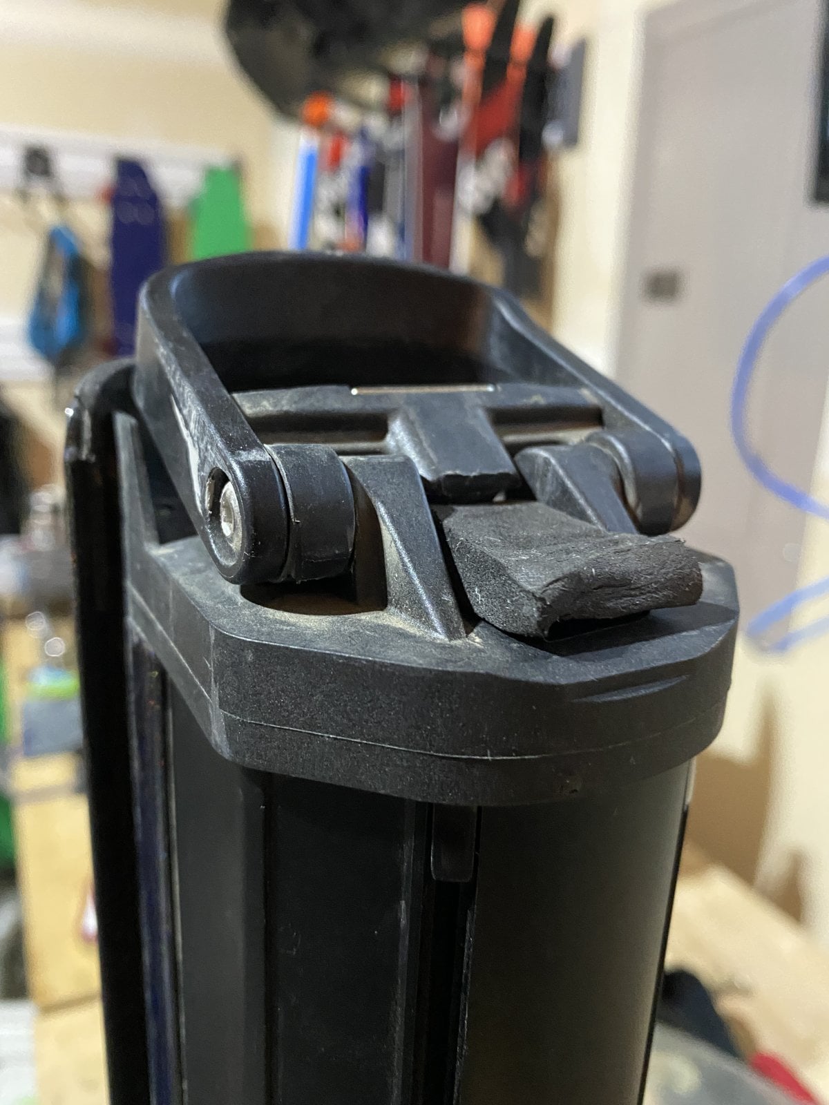

The solution I am trying is to place a small piece of high density foam on the top of the battery. See the images below. One without and then one with the foam. With the foam in place, you can no longer move the battery in a way that allows it to disconnect.
Here is the battery without the foam.
Here is the battery with the small foam piece placed in the notch on the top back side of the battery.
I'll post the results after my next test ride in a couple of days.
Solution Results
Worked on half the trail, then the bike started to cutout again. I think the problem was that the foam squished and moved so that it was no longer effectively stopping the vertical movement of the Battery.
Solution Re-Factor
Fabricated a more stable spacer that doesn't move and squish backwards against the battery. This solution is working so far. I'll post pics later.

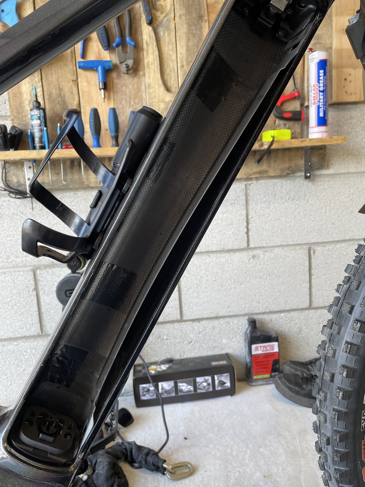

Unfortunately my 2022 9.8 has just started doing the power cut off thing.
It's weird because I have just completed a 220 mile ride over a week and it was faultless, but yesterday it turned itself off numerous times.
I took the battery out when I got home and all seems fine!
I've cleaned the contacts and also removed the damper plate I had installed just in case it's that pushing the contacts apart
Riding again today to see if it still does it 🤬

Well did a 30 mile ride with plenty of jumps and rough terrain, worked faultlessly.
So in my case I feel this is definitely a battery connection issue and that none of the hardware is faulty.
Trek definitely need to get in top of their battery mounting method.

The long and short of it is that the battery mounts in the Rail are very poorly designed.
I had loads of noise from my battery (brand new 9.8) and it did cut out on several occasions going through the trail chunder. I read the new battery alignment procedure but ended up taking the bike back to the shop to be fixed.
the battery alignment document states that you must make sure the plate is flat and not bowed in any direction. This, I think, is still the cause of the issue.
this is how the tech has fixed my rattle and I can report it works and I can also report that the bike no longer powers off. This is not an official Trek fix, but the tech at my local shop is a Trek Rail rider/owner and knows his shit when it comes the Trek bikes.
look how much bow there is in the plate. To me this is a sure sign that the mounts (with a flat plate) are too far apart. I am still using the foam damper on the lower mount.
my battery is now held tight and does not move. Note the thick solid rubber pads that the tech installed to support the rigidity of the top plate.
the battery installs in the same way, but requires a very solid push to get it past the latch and you have to use the key to close the latch down.
i rode over very Rooty trails with this new fix and it held firm with zero issues.
