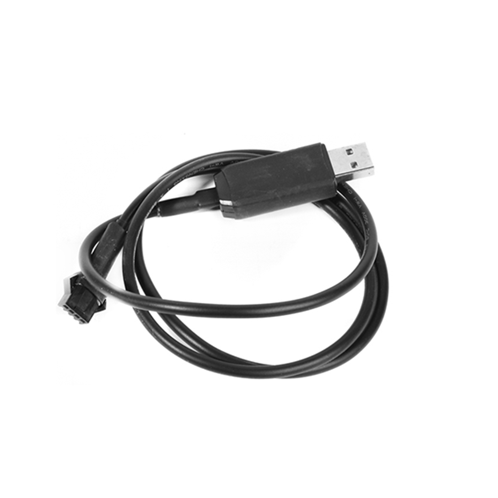

i did some research several months back and never figured out the software since none of the local Rocky Mountain bike shops near me carry Powerplays and aren't equipped to handle e-bikes.

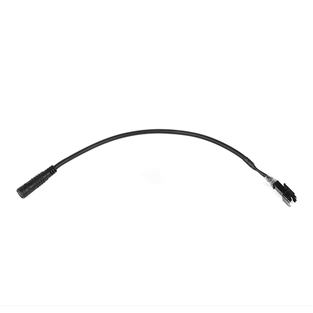

I did find that you need a special usb cable called "Powerplay cable" (part number 1906003740) that plugs into the speed sensor connector.
User manual says to use the ebikemotion app for setting changes and firmware updates but it wasn't doing what I needed it to do so i just ended up buying MTT instead.

I collected the same info about this cable and found also one another (part number 1906003730 ) called POWERPLAY CABLE ‐ USB TO DRIVE (FIRMWARE ADAPTER).
