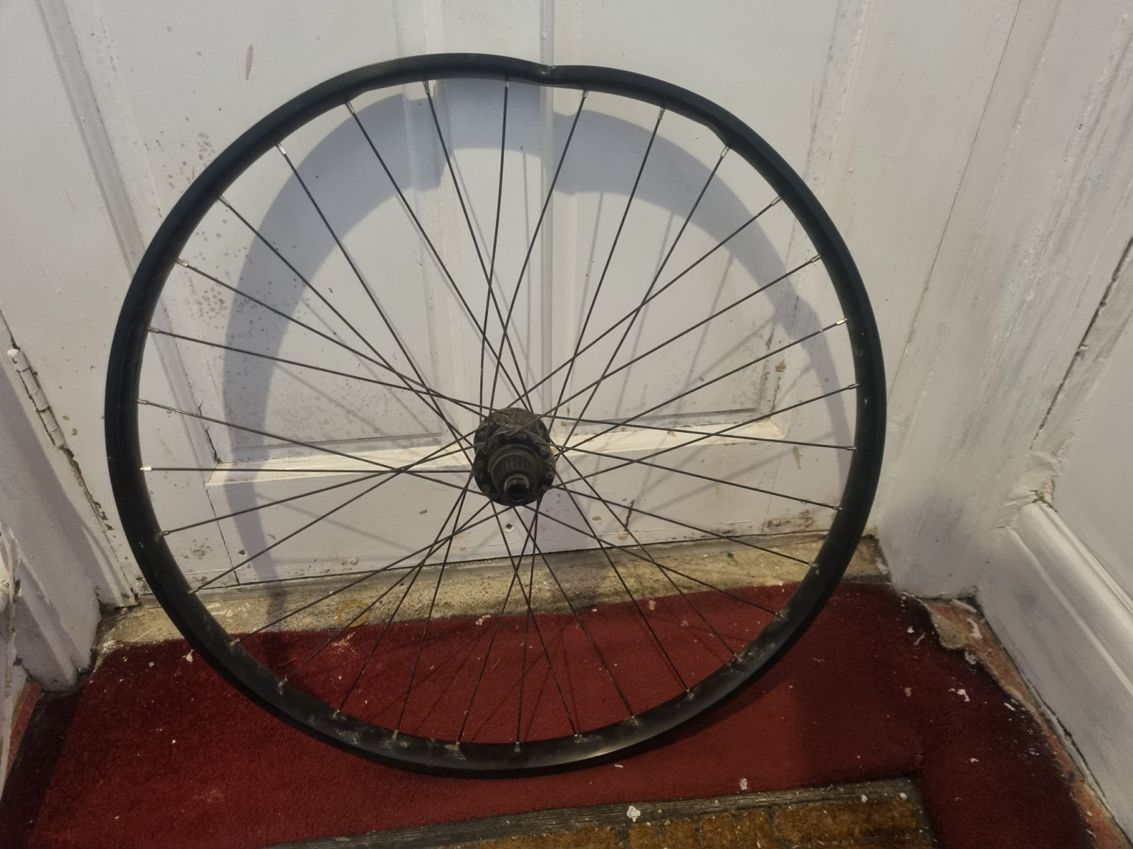

Can someone advise what rear wheel to buy for my rail 5? I think this is the wheel I need but don't fancy waiting a year for it:
"Alex MD35, tubeless compatible, 32-hole, 35 mm width, Presta valve"
I'm struggling to find wheels that wide so if anyone could send me a link or what wheel to but that's actually available it would be great. Thanks.

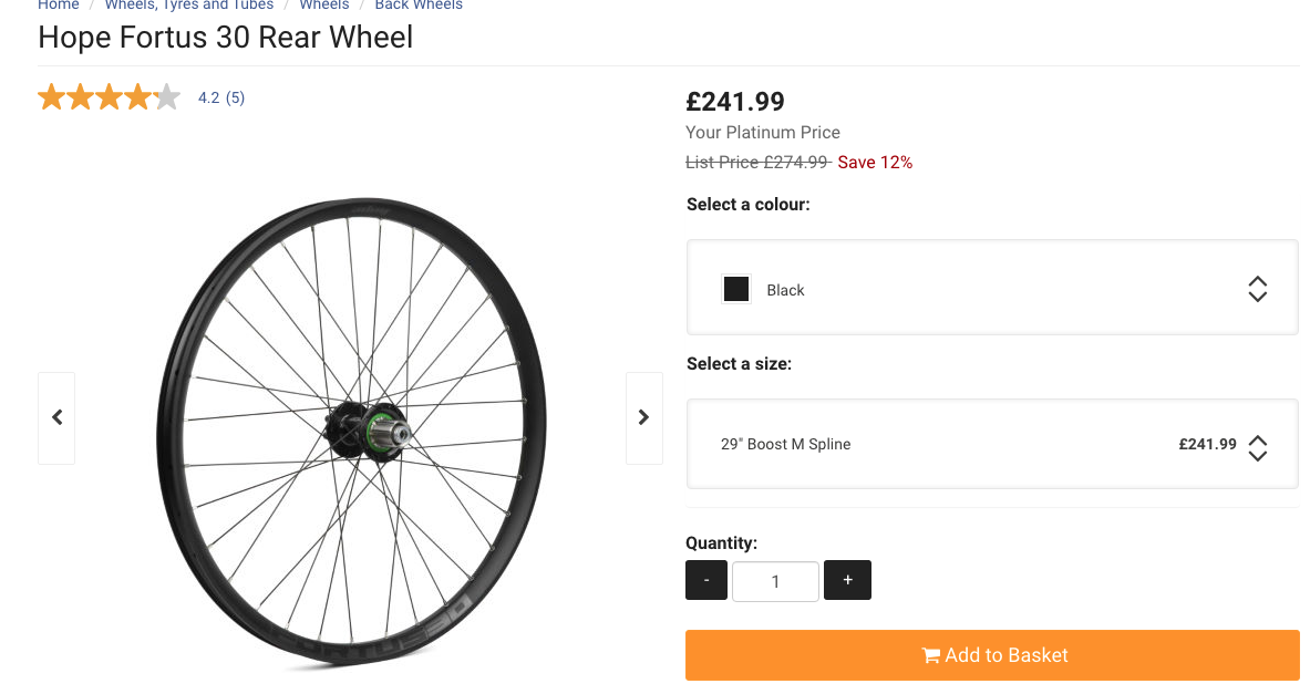

2 questions. Have I chosen the correct options here?
And, should I be paying that much for an aluminium rim or at that price should I go carbon?
Yes, assuming your bike has a Shimano 12 speed cassette.

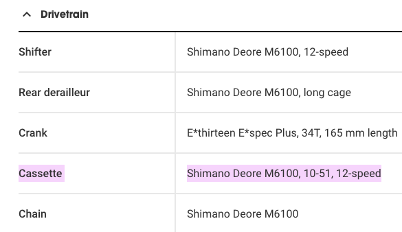

According the the website spec it's this:

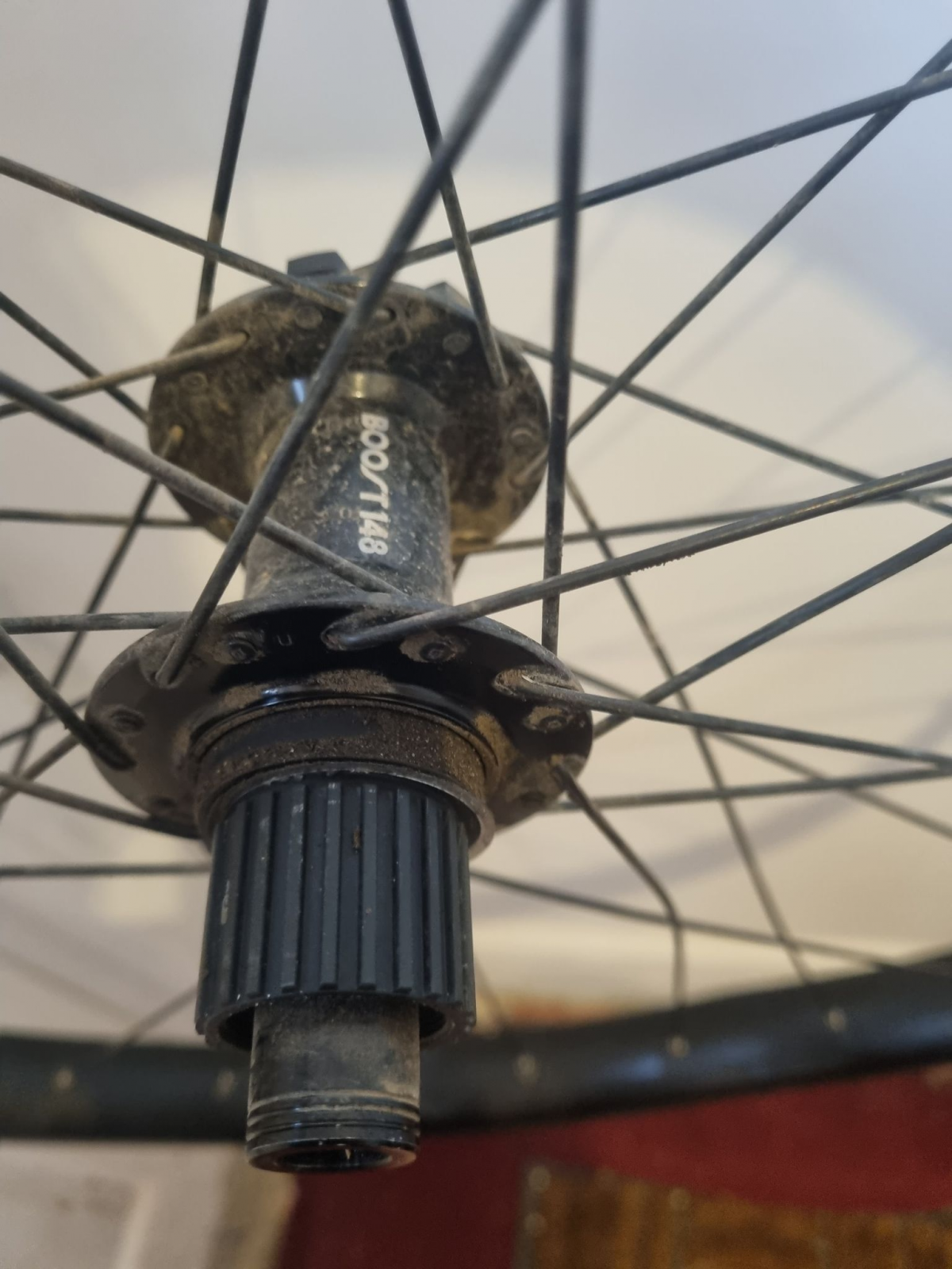

And here's the hub. I bent the rim coming up short on a gap.

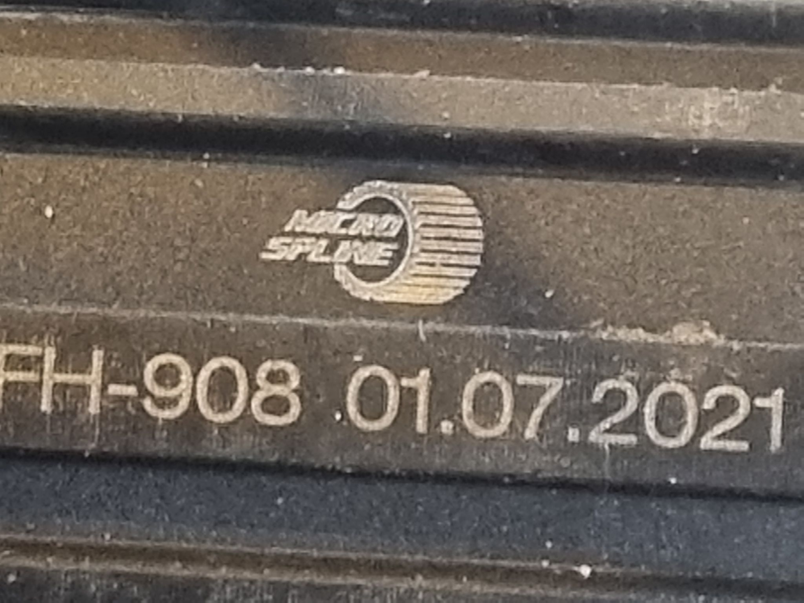

My bike is 2022 Trek Rail (L) and I confirm that you need 29", Boost, Shimano Microspline.

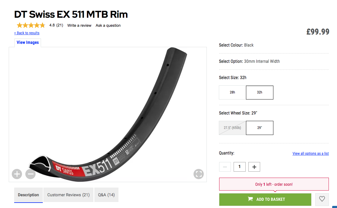

Personally, I'd get a wheel custom built; Hope hub with a DT Swiss EX511 rim.
You could just buy a rim and get it rebuilt onto your hub if you want to save some money.

However, it is looking like replacing the rim is the better option. How about this one? It's available for next day delivery you see.
Just work out how much it's going to cost to build up. I think those EX511's are pretty decent rims.

EX511 is a very good rim; strong but not too heavy. Can your LBS get it built in time for the weekend though? Have you asked them what rims they have in stock? My LBS keeps a good range including EX511.

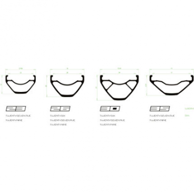

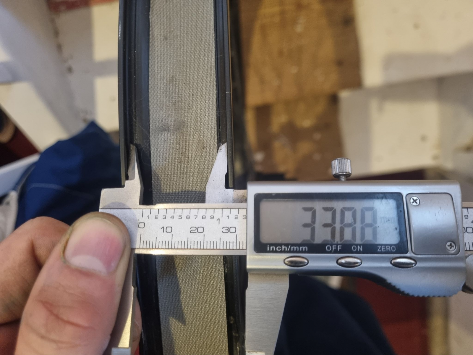

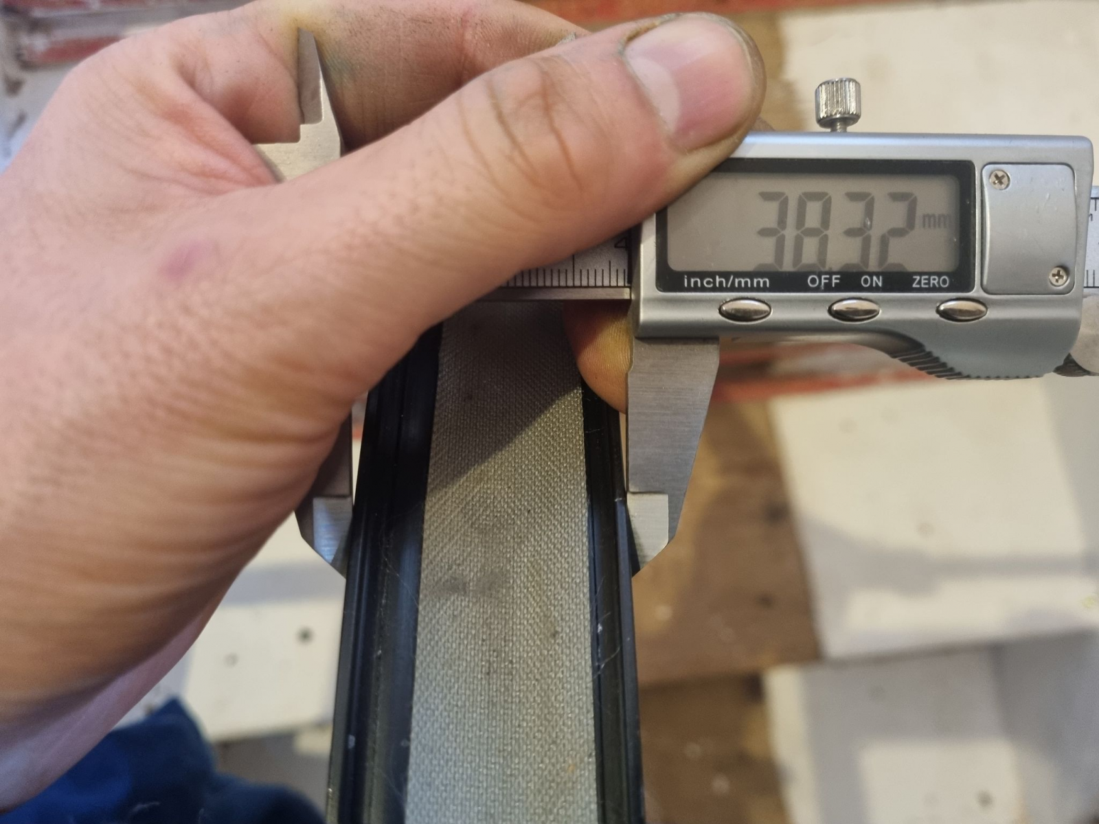

Heres the OD and ID of the original wheel:
So the hope 30 is smaller than this but is apparently ok for the 2.5" minions I've bought?
30mm internal is fine for a 2.5 Minion.

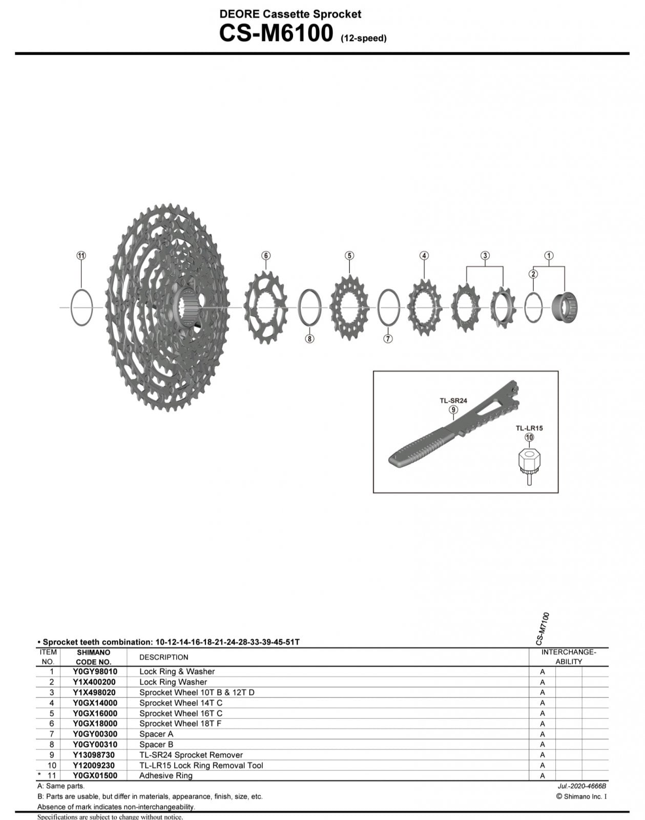

When you swap the cassette onto the new wheel, be careful that you (a) get the spacer in the right position and (b) get the smaller sprockets correctly aligned. If in doubt the LBS will do it for you in 15 mins max. Good luck.

When the cassette is removed from the damaged wheel it will come apart in several pieces.
Yes i understand that
What i was meaning and i thought you meant was the extra spacer you get with hope hubs when there new as you only mentioned one , not whats already fitted to the cassette
But thinking about it he should not get one with a micro spline only a HG hub
My bad
Of course thou he just swaps everything like for like thats a given .
Apologies for any confusion
