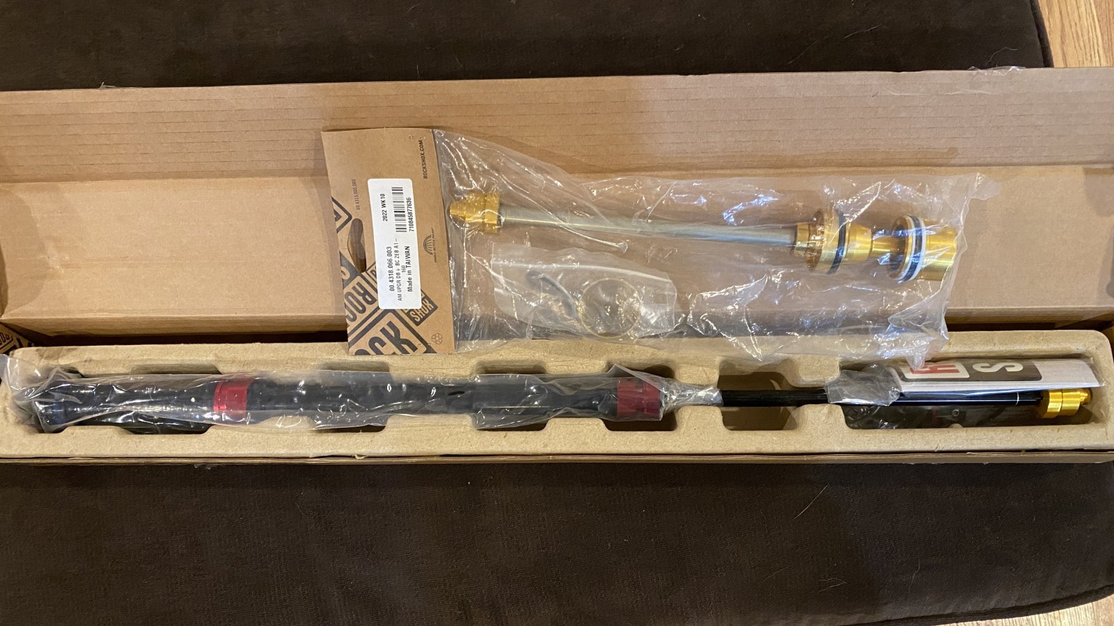

Anyone update their 2021 Zeb with the new Charger3 damper and Debonair+ air spring yet? What are your impressions so far? Just did this and going to hit the trails to dial it in today. Hoping it'll be as easy as setting the same pressure and knob clicks I had before I did the conversion.

I just did the damper in my 22 Select +, waiting for the air spring to come back in stock. So far I’ve got about 50 miles on it and it’s noticeably smoother and quieter. I have no complaints.

Any impression after ten days? I'm waiting the parts too from italian distributor (even SRAM usa told me October or later...)
I found the rebound of the zeb select + quite aggressive on the rebound when going over smallish consecutive bumps, does this upgrade smoothen that out?. What sort of cost is this uopgrade?
Hmm, not sure. My Zeb is the Ultimate which I believe has the same air spring and damper as the Select+. I found small bump compliance very good. This upgrade noticeably improved it more, but I wouldn't say it was an extreme difference.
Perhaps your Zeb needs more tuning? I recall at first I thought my Zeb was quite harsh with small bumps. I was able to make it feel very muted over fast, small, consecutive bumps by lowering my air pressure a bit more than what I had, having very little low speed compression (LSC), and lastly, speeding up the rebound to almost fully open.
