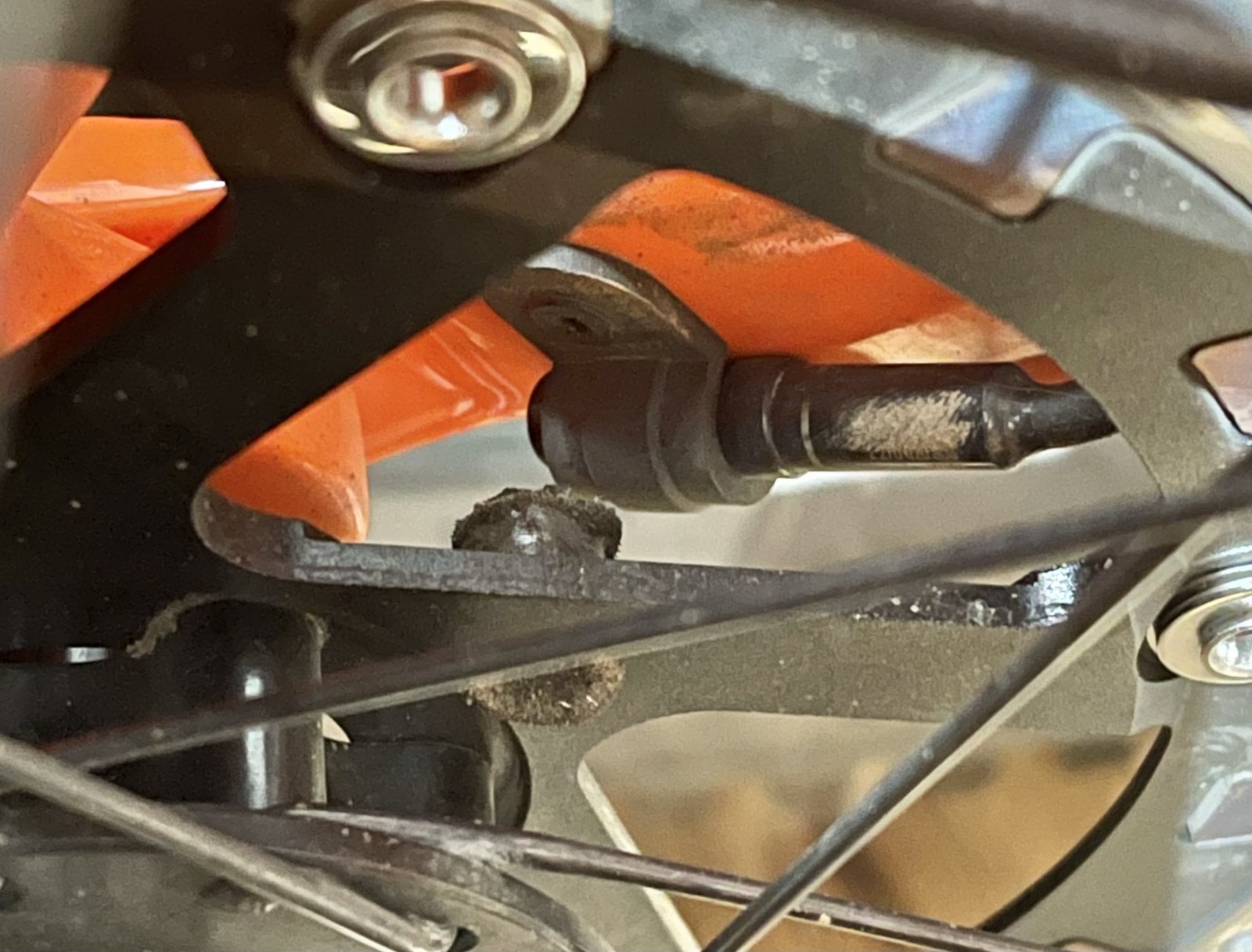

Could you send a pic of your speed sensor\magnet arrangement?
Bike is at the shop but here's one i took while they were trying to troubleshoot over the phone.
The magnet mounts around the Centerlock nut on the hub.
here’s my arrangement. May be erratic reading because the magnet is too far?

That was a disc rotor mounted magnet whereas the OP said he has a magnet built into the lock nut for the centre mount rotor ( which presumably is a Shimano rotor) If that is the case the sensor is often located in the frame just a bove the thru axle.
All of my bikes have had 6 bolt mounted rotors so I am not familiar with the arrangement for a centre mount. Is it possible to to put the centre mount lock nut on either way? Just thining that if the rotor had been removed for whatever reason and the lock nut magnet is one sided, putting it on with the magnet side towards the hub would prevent it working???
Well the crappy clip is doing its job... I can see nothing wrong there. Do you have any photos of the disc rotor/centre lock nut? With reference to my earlier post do you have any photos of the point at which the sensor cable leaves the front of the chainstay? As I said before that exit point is one area that the cable can be damaged due to rubbing on the hole in the chainstay as the rear triangle moves with the suspension.
