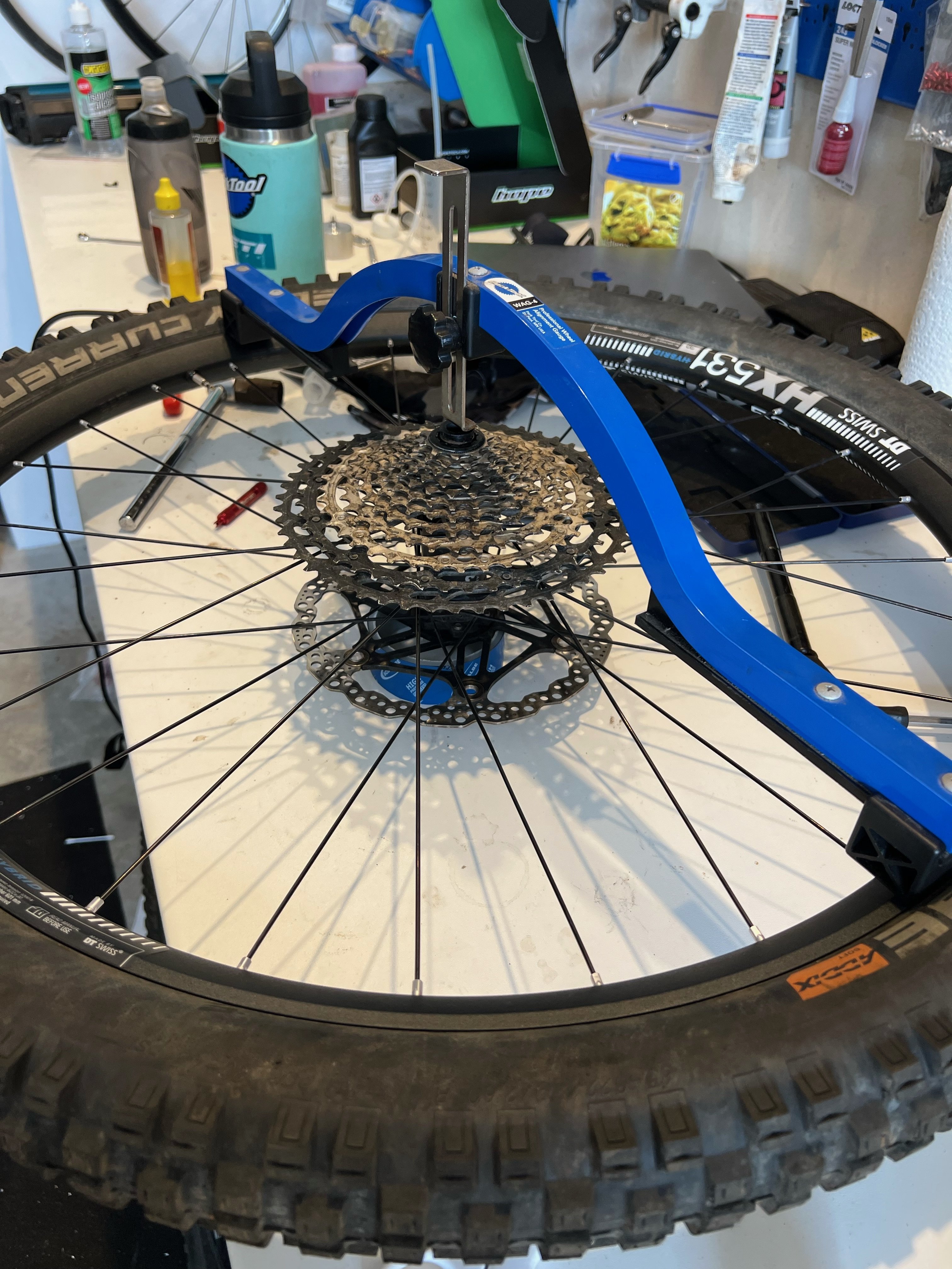

I have double checked the dish on my wheel, it is nearly perfect, less than 1mm out of centre.

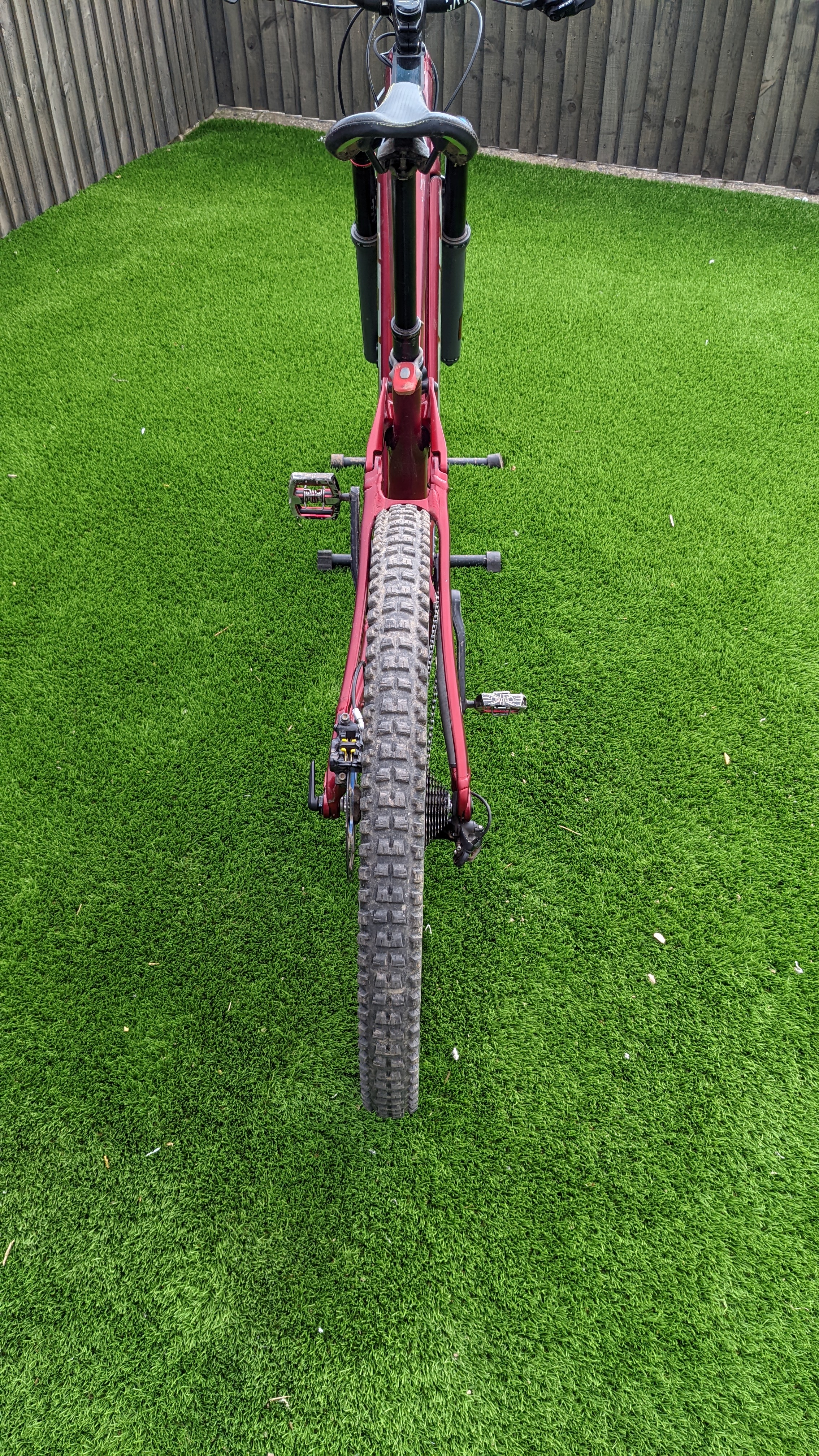

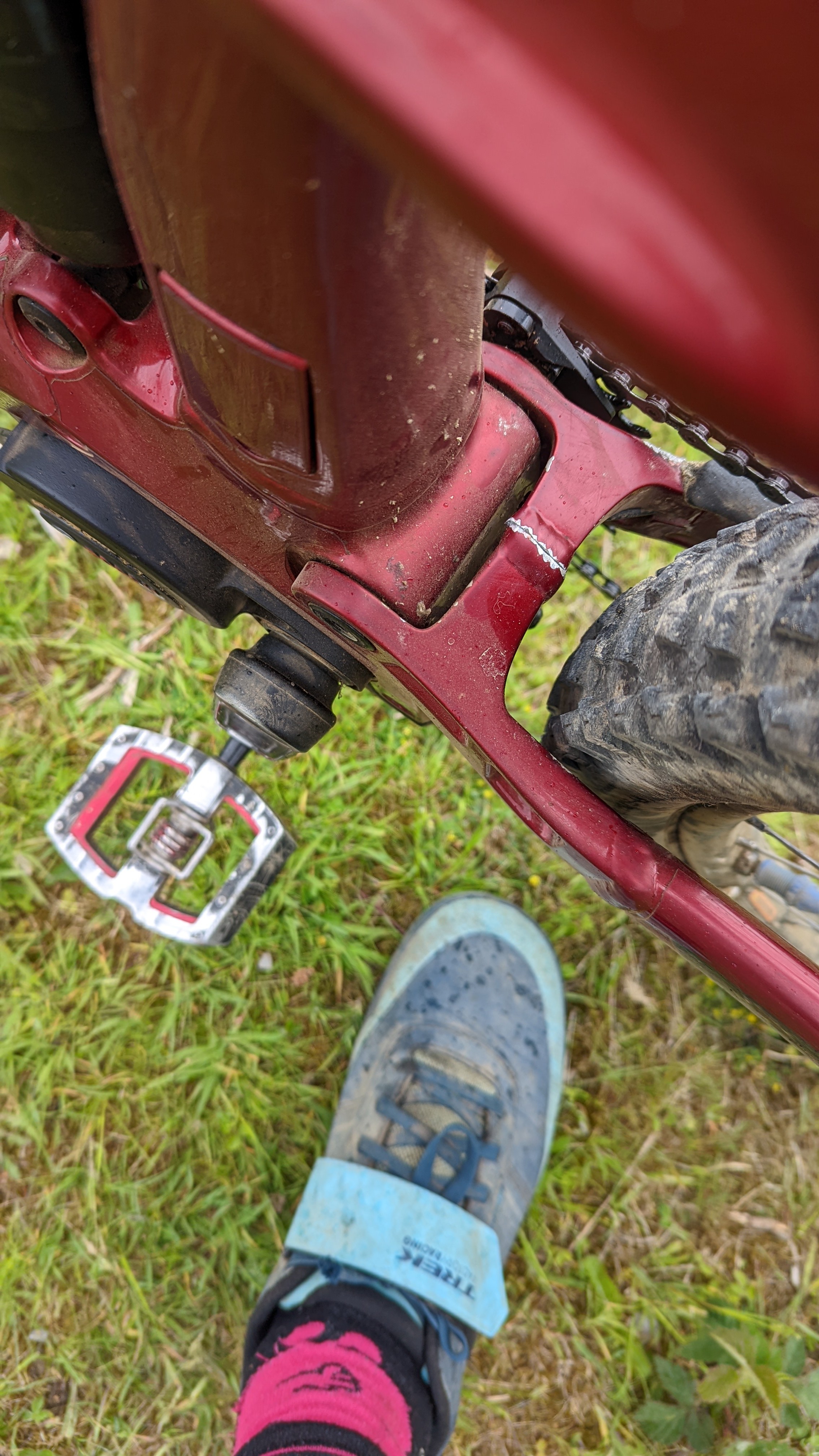

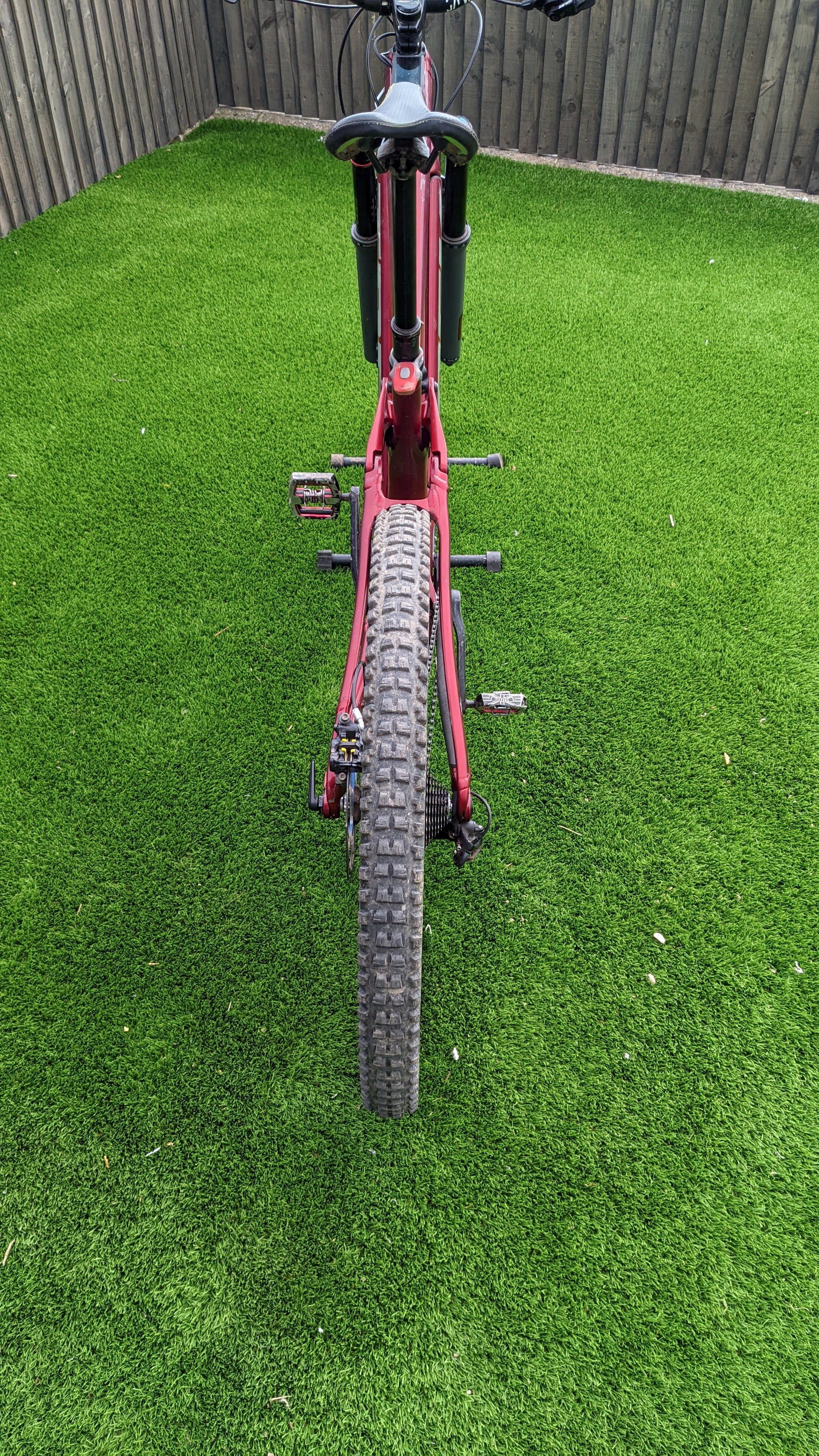

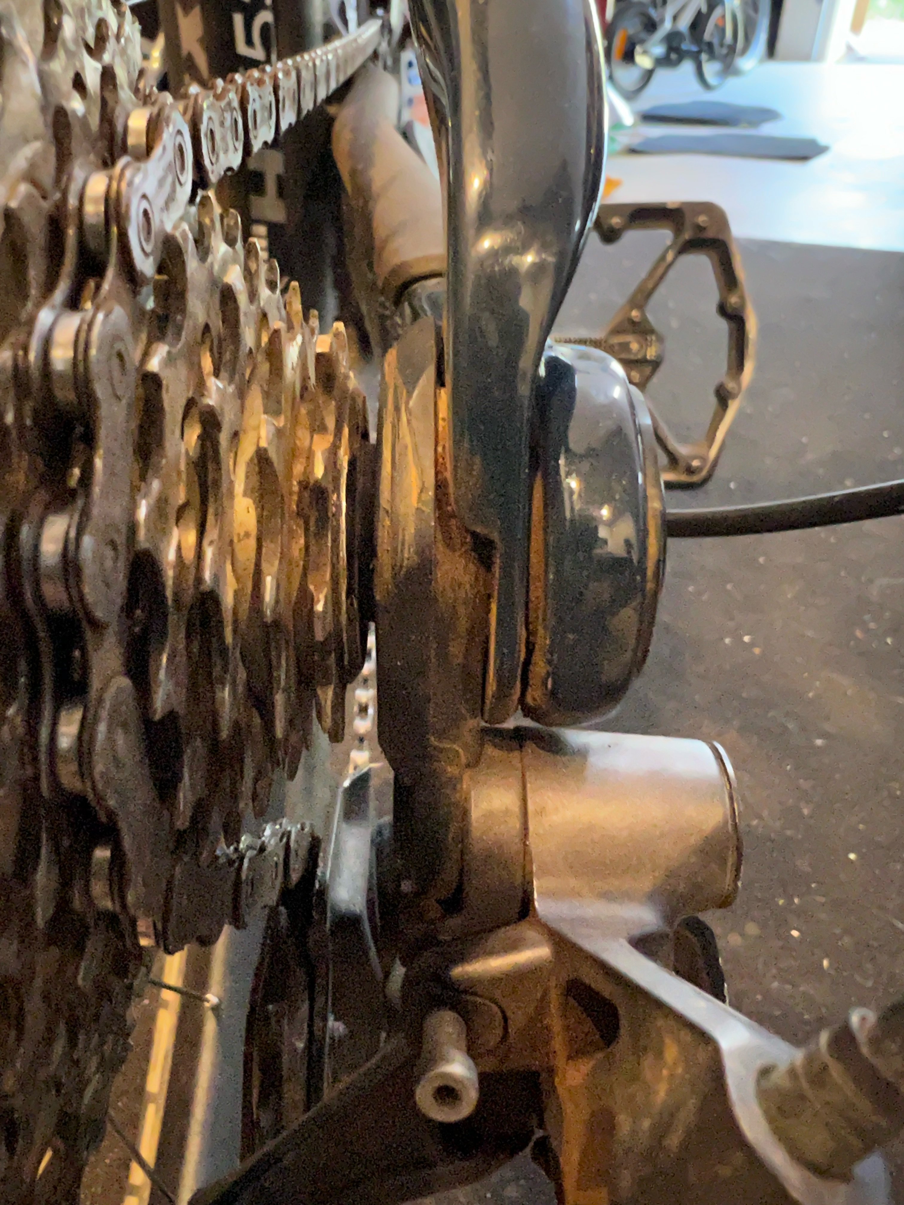

I had similar issue .. my backend of the bike was twisted .. trek were not having any of it even sent it back to them to check for alignment and came back all ok (even tho as from pics you can clearly see it was bent) ... Within a few weeks of having it back I heard a twang and noticed the weld had completely split on the chainstay as seen in 3rd pic .. trek soon changed there mind and kindly sent a new chainstay and seatstays under warranty 👍👍

Looks like a poor alloy weld. Maybe the paint hid the flaw for a while, until it finally snapped.
I think the OP’s frame is carbon, but it could still fail.

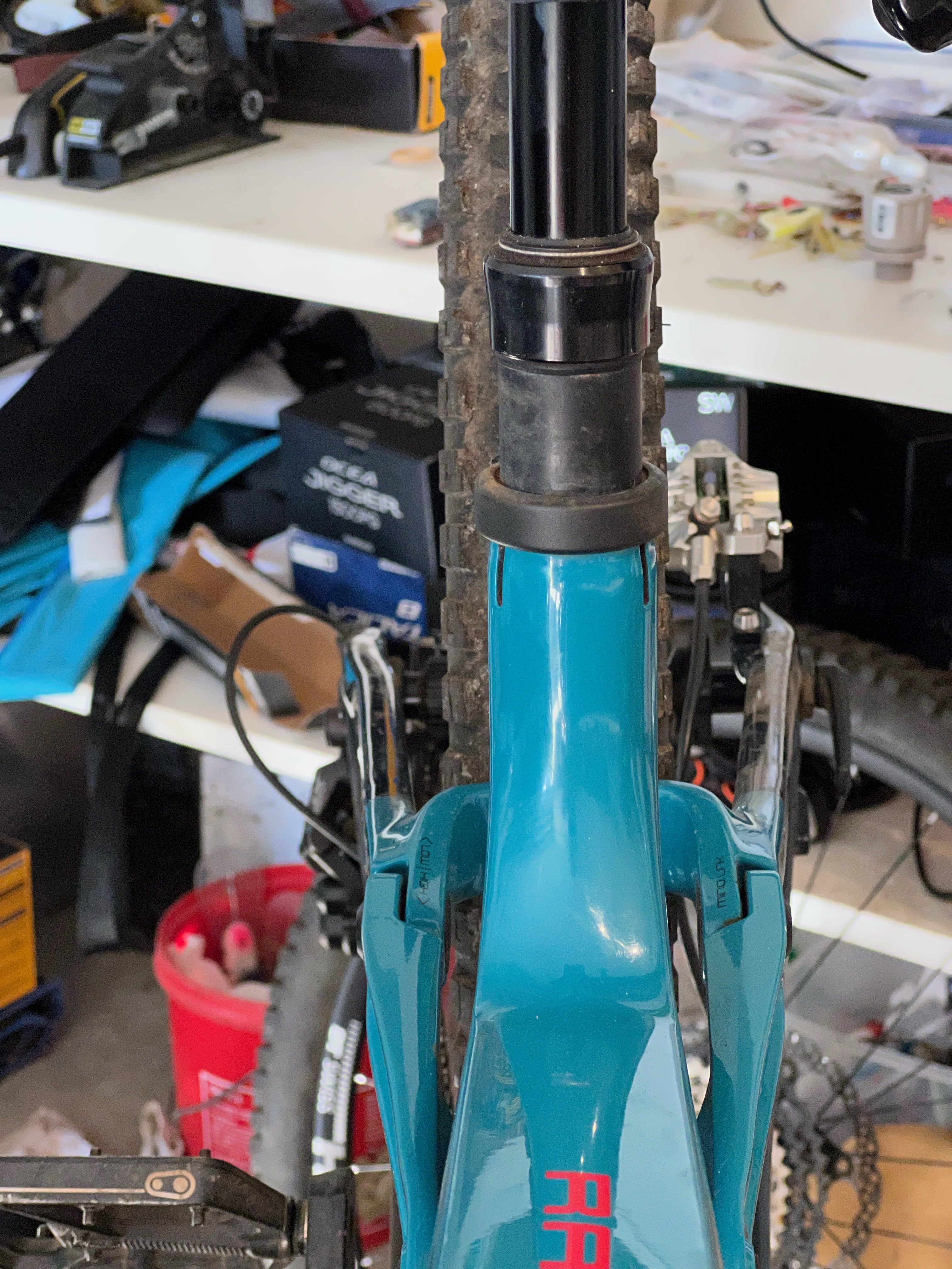

Here’s a pic of the same area on my carbon frame. I carefully measured the wheel centring as best as I could (3mm from the rim), on both sides. The wheel is centred.
View attachment 102636 View attachment 102637 View attachment 102638
that broken weld looks more like the result of a misaligned back end than the cause.

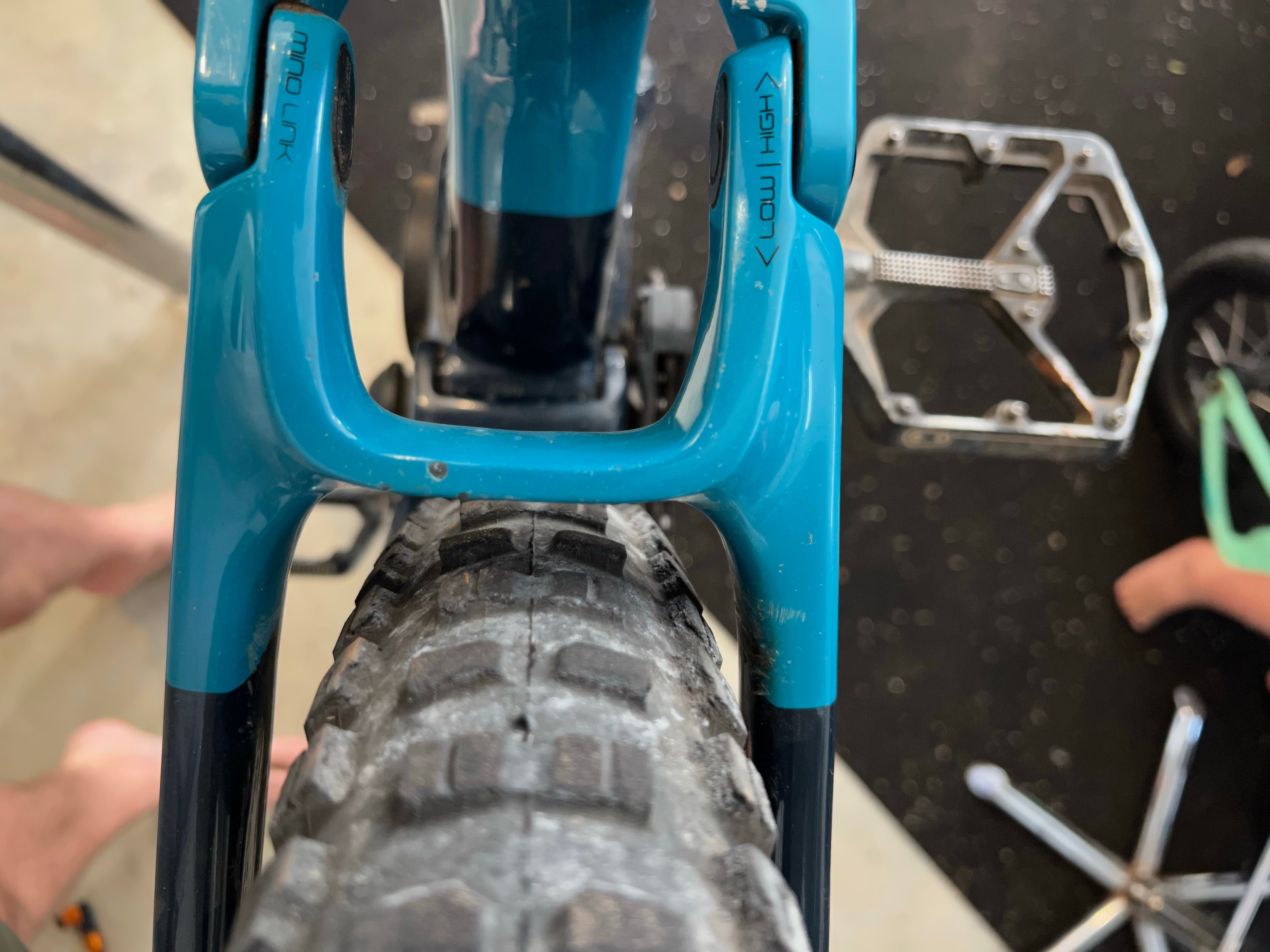

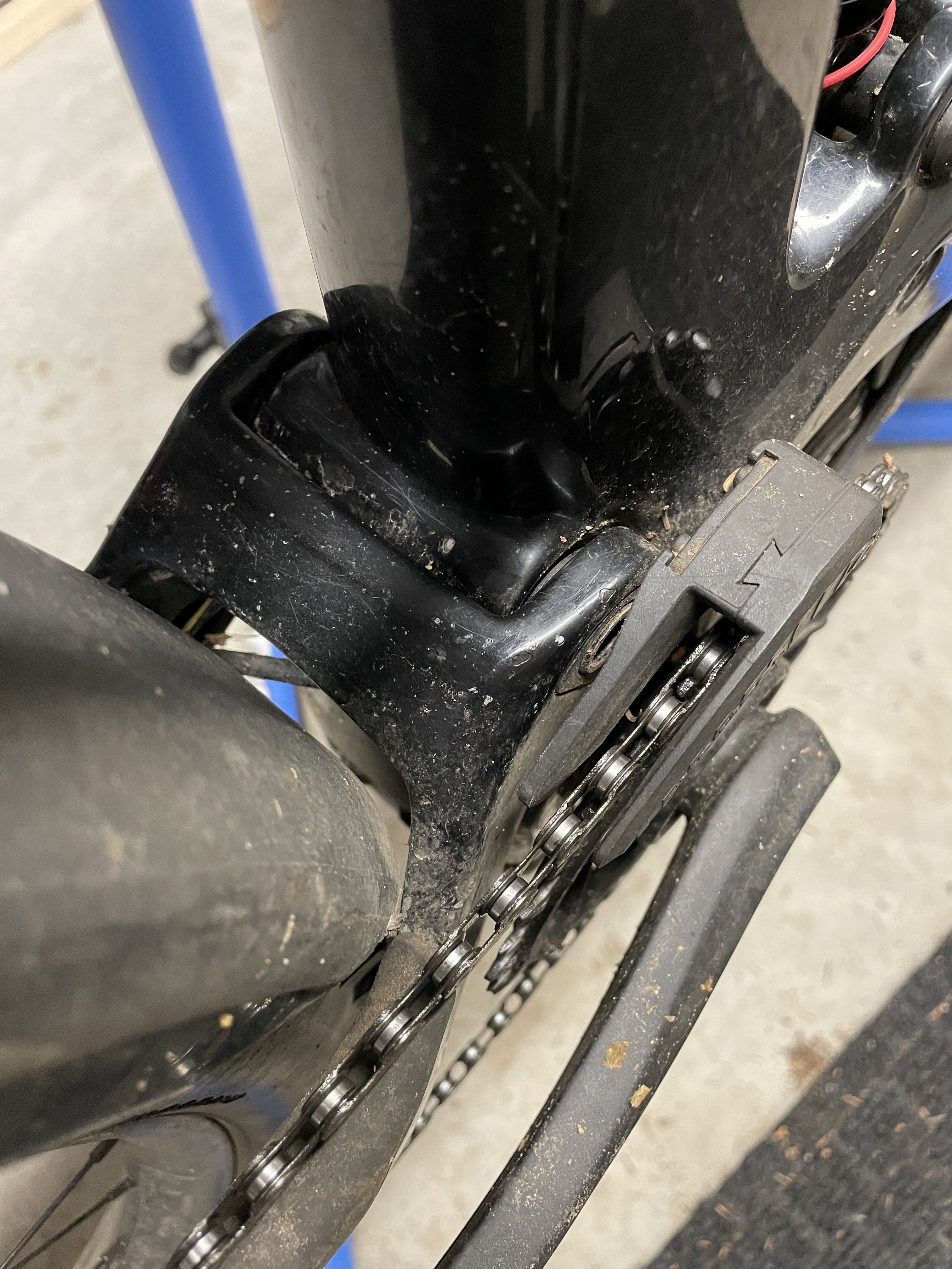

So my local Trek dealer took a good look over my bike yesterday and agreed that it's not right. There is a bearing alignment issue. They have filed a warranty claim with Trek.
They believe the issue is most likely around the Active Braking Pivots where the seat stays join the chan stay and on the non drive side in particular.
As you can see in the pics, the clearance in the pivot between the seat and chain stay is very tight on the non-drive side compared to the drive side. There is a spacer in the pivot that should maintain even clearance both sides. The stays are basically touching on the non drive side.
Hopefully Trek will come to the party and get me rolling straight again..
