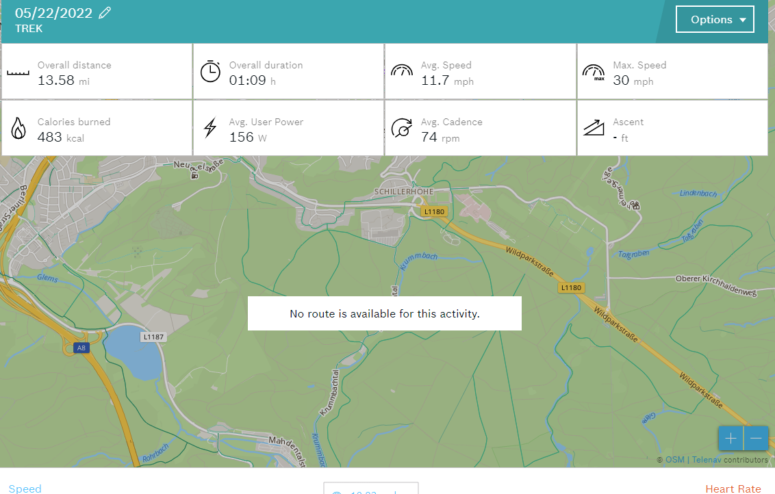

2021 Rail 9.8 Kiox, how do I get it to show my ride data with the map
Murch
Aug 9, 2019
226
201
United States
Just picked up a 2021 Rail 9.8 and it has the Bosch Kiox computer. I set it up with the e-bike connect app along with my heart rate monitor. I went for a ride and looked up my ride after on the ebike connect site and now I see what is below. How do I get it to map my ride? I would also like to upload it to Strava as I use it to track my mileage between my bikes.
Thanks for the help, I have been a Levo rider for a few years now and know all about it, but the Bosch system is a bit different with the app and tracking.
Perhaps you need to have the ebike connect app running when starting your ride...
I have the same bike (Rail 9.8 XT)
When I went for a ride a couple days ago, I started the ebike connect app, and also started the the Garmin Connect app at the same time (I have a Garmin Edge 530) and everything worked fine

Thanks, I did a test yesterday and at least with the iPhone the connect app must be open and the last app on screen in order for it to track.
