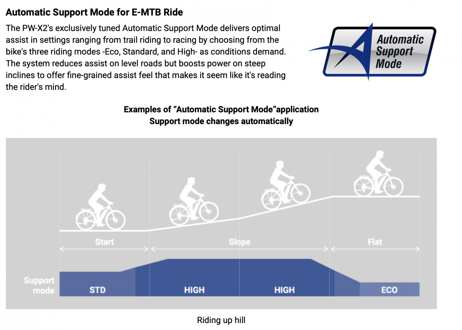

A couple of things to note: the eagerness of the motor to get going from standstill makes the motor one of the best for hill starts and there is actually a hidden auto feature, similar to emtb and trail mode. Press and hold the + button for a few seconds and you will see A appear on the display. This puts the motor in auto mode and will give you up too the full 80nm.

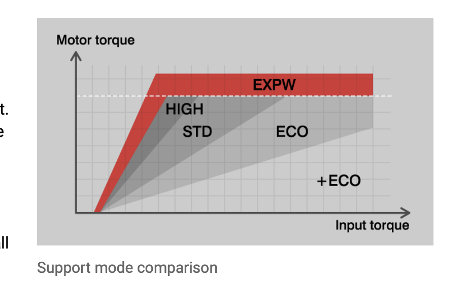

I also checked when I was making the video about the Auto mode. From what Yamaha are saying it will only choose between the bikes three riding modes (Eco, Standard or High) - not the EXPW mode (that is the only mode that uses the full 80Nm).
Source: PW-X2
