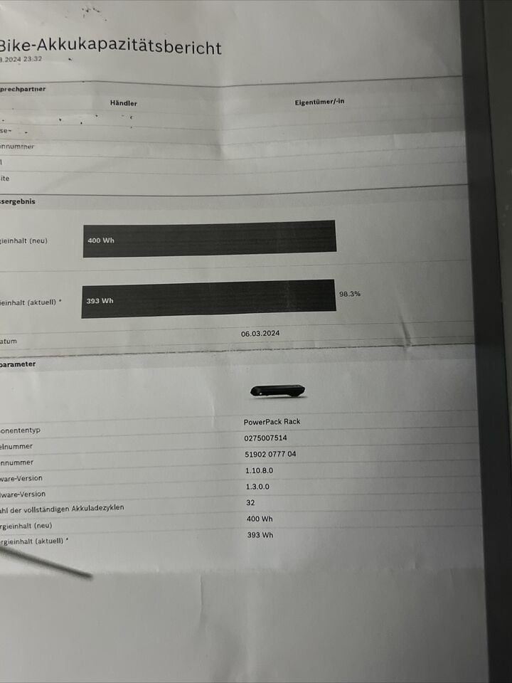

Check if your Bosch dealer have a battery checker like this Bosch Battery Capacity Tester , if they do have it they will print a report like in the picture.
