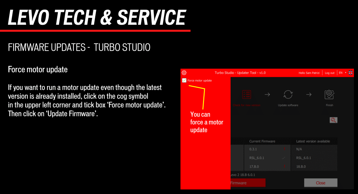

Here is page from service manual:
Click on cog symbol in the upper left corner to display options menu, then tick 'Force motor update':

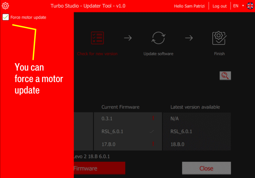

Here is another image of Turbo Studio showing overview of the Firmware Update process. On the last step "Finish", they can change the wheel size for you. The smallest valid wheel circumference is 2000.
