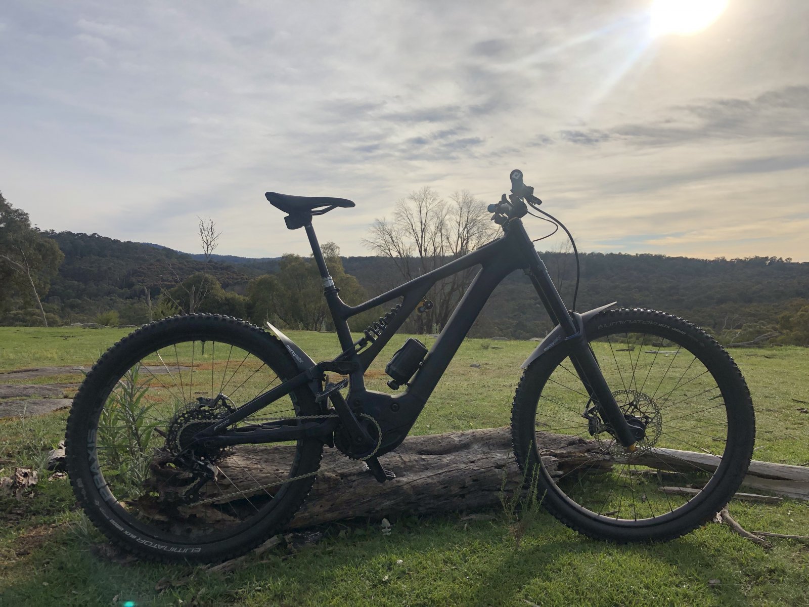

To answer the questions, yes you can put 29 wheels in the rear without issue
Untitled by Sales Punk, on Flickr
To balance out the bike the fork is a 29/170 setup
To answer the next question, the BB height is not a hinderance at all. Mine measures out at 361 or about 7 mm higher than my Enduro. The bike is insanely fast every where. We ride a lot of very steep and raw natural trails along with some big jump lines and the bike absolutely slays. Getting to those trails is done via steep technical singletrack climbs with lots of tight switchbacks. Again, no issues with the 29 wheels. Happy to answer any specific questions about the changes.
