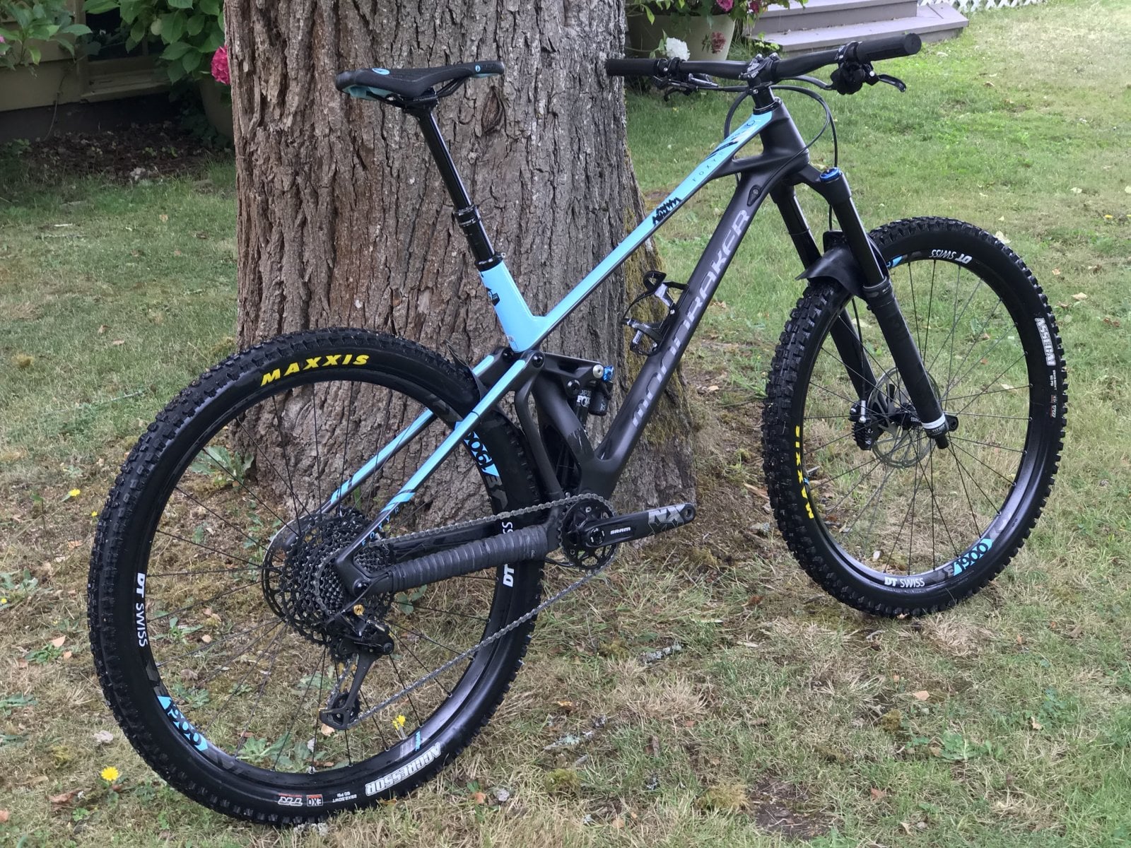

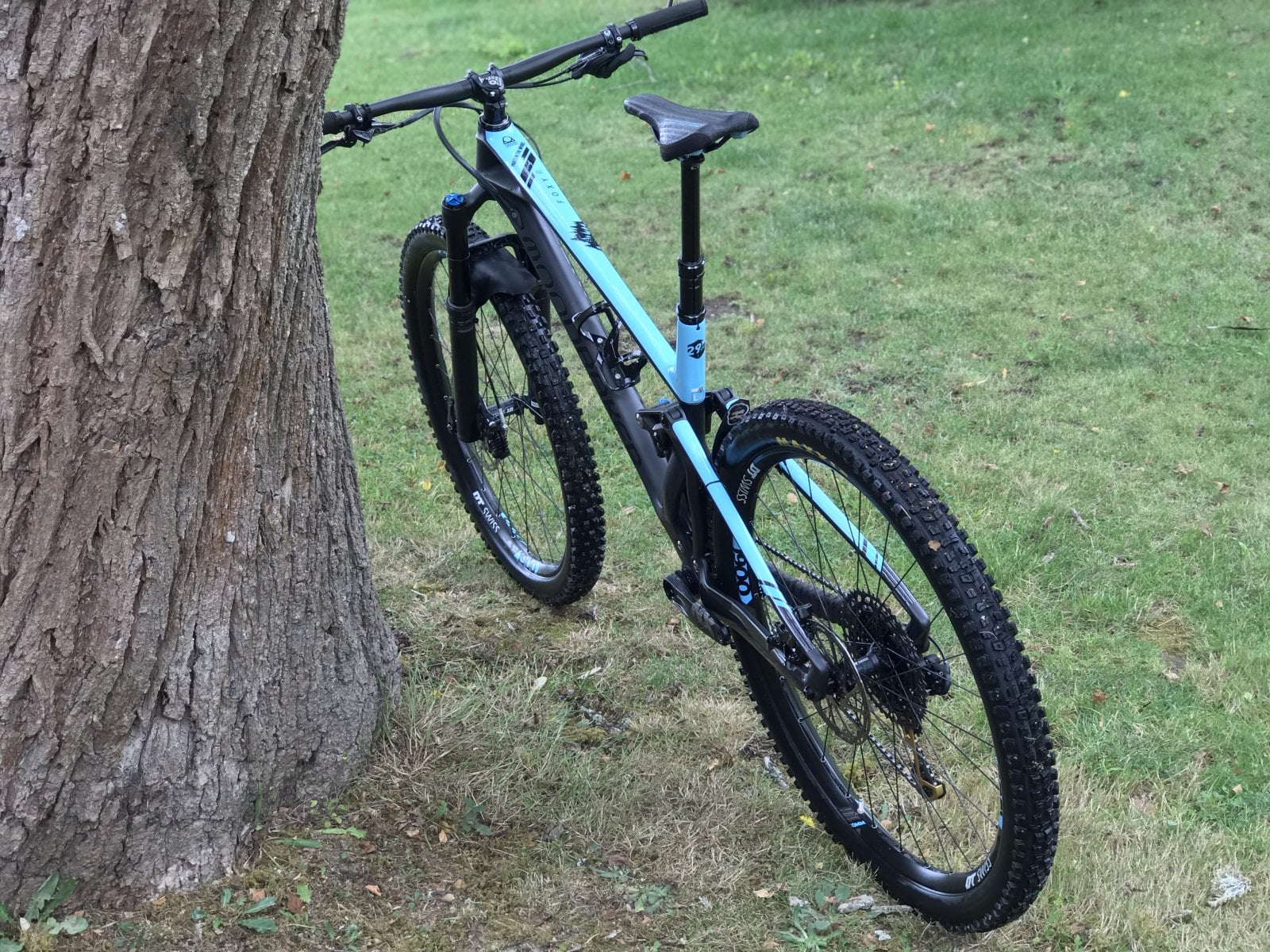

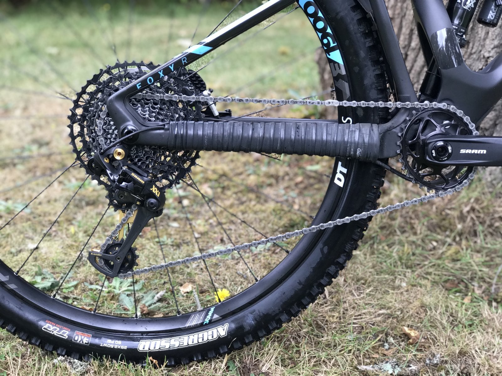

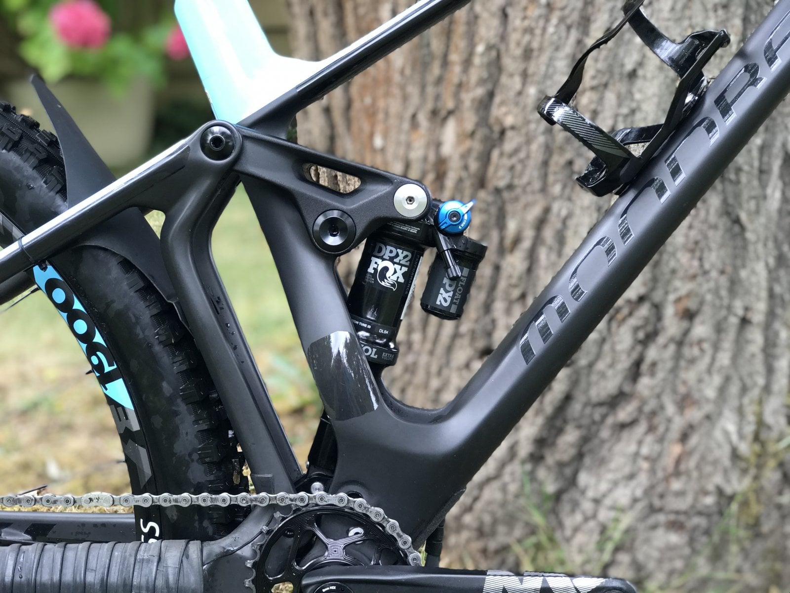

I did try it but was not a blast! Not that lively I felt, not really fun... (just my personnal feeling)
If you want lively, you REALLY want to walk away from the Mondraker then lol, thing is like a tank.
The issue is really the “forward geo” they try to push so hard. It really outcomes as a bike that initiates corners horribly! I have ridden a few, I own a 2019 Foxy and have ridden the Crafty. You get a bad feeling of imbalance across almost all of the bikes. Here is my foxy

Yeah. Across the board the Mondrakers have that very unique (sub par balance) ride, I spend forever setting up suspension to help with it but it’s like splitting hairs and at that point other bikes ride nicer even set up wrong.
I’m surprised you felt the Spesh was dead feeling, do you think spending time with suspension tuning would help? It sure did for me, messing with volume spacers and keeping sag to 27% both front and rear, the big one for ebikes is the rebound, MAKE THAT SH*T FAST! It’s what makes any ebike start to be very lively.
I’ve had a lot of experience with tuning bike setup for customers here at my home shop, and my gut says give a 2019 Levo another look, (comp or expert model) SET YOUR SAG and disregard psi until you hit the % front AND rear you want TOGETHER with all your weight on JUST the cranks while applying FRONT BRAKE to get the front to sag in properly.
