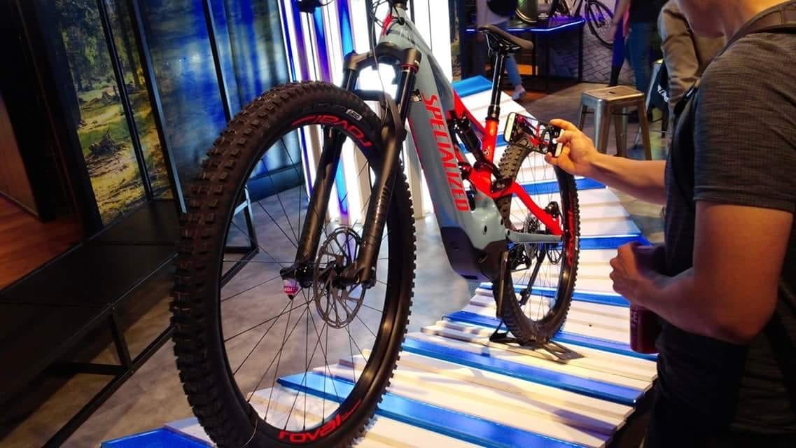

Specialized are about to launch an all new 2019 Levo on the 18th September. Below are the full confirmed details.
2019 Levo Comp in Sand
The bike should feel significantly different to the 2018, with revised geometry, lighter weight and longer travel. The pricing has increased by approximately 12% across the range, so expect to be paying out a lot more dollars in return for what looks like the worlds most advanced EMTB.
Pictures have been leaking over the past few days and we are now in a position where we have an excellent idea of the bike, down to the exact specification of the Expert and S-Works model.
A few standouts that are worth calling out are the move to 29" wheels, an all new, asymmetric frame based on the 2019 Stumpjumper, an all new display on the top tube showing battery and motor modes (photo has been removed), all new way of integrating the battery into the downtime (sliding it inside the tube). The battery will be 700 Wh on the Expert and S-Works models, and 500 Wh on the other models.
Only the S-Works and Expert level are getting the increased battery. All in the range will get the new 2.1 motor. The 700 Wh battery WILL fit into all the models. So you can buy a Comp and later a 700 Wh battery.
The new 2.1 motors are the Brose Drive S Mag motors. These offer a 15% smaller size and Specialized are mentioning an 11% weight saving.
[Edited to update the battery, and 2.1 motor confirmed on all models.]

2019 Levo Comp Specs. Expected Price: TBC
  • All new frame based on the new 2019 Stumpjumper. Asymmetrical design with revised geometry
  • 150mm front and rear (up from 135mm rear)
  • All new 500Wh battery
  • Rockshox Revelation Charger RC 150mm
  • Rockshox Deluxe RT 150mm
  • SRAM Guide RE Brakes, 200mm F/R rotors
  • SRAM GX rear mech
  • SRAM S700 Shifters
  • X-Fusion 150mm dropper
  • 2.6" Butcher Tyres
  • Turbo 2.1 Custom Rx Trail-tuned motor (New Brose Mag S motor)
  • Roval Traverse 29" Wheels, 30mm internal diameter
2019 Levo Expert Specs. Expected Price: £7000
  • Carbon FACT 9m front triangle, Aluminium M5 rear
  • RockShox Deluxe RT3 150mm Shock
  • RockShox Pike RC29 150mm
  • SRAM Code R Brakes, 200m F/R rotors
  • SRAM S700 E-Click simple-click shifters (All new?)
  • SRAM XG-1175 Cassette
  • Praxis 165mm Cranks
  • Roval Traverse 29" Carbon wheels
  • 160mm Command Post Dropper, 34.9mm
  • 700 Wh battery
2019 Levo Expert
2019 Levo S-Works Specs. Expected price: £10000
  • Carbon FACT 11m full carbon
  • Fox FLOAT Factory DPS 150mm, 210x52.5
  • Fox 36 Factory 29" 150mm travel
  • SRAM Code RSC Brakes, 200m F/R rotors
  • SRAM XX1 shifters
  • SRAM XG-1199 Cassette
  • Praxis full carbon 165mm Cranks
  • 700 Wh battery
