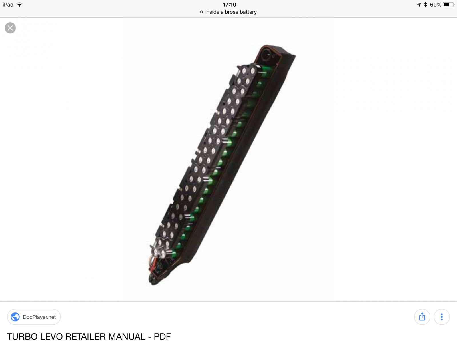

I believe they use 40 x 18650 batteries for the Levo/Kenevo battery unit. Please feel free to correct me if I am wrong on the following as I am doing this from memory. The 18650 batteries are 18mm wide by 65mm high.These batteries range from 2.5Ah to 3.5Ah. Not sure what value Ah battery they used to create the 460wh and 504wh battery but it would be somewhere in the above stated range.
Have a look at the attached screen shot of the Levo battery. There appears to be quite a big gap between the batteries so in theory they could, with a bit of jiggery pokery use the slightly larger and higher output batteries that have been released ...... either the 21700 21mm x 70mm or the 22650 22mm x 65mm. These put out around 3.8Ah to 4.5Ah.
So if they could squeeze 40 x 4.5Ah batteries in I believe this would give you your 630wh battery?

Assuming the use of 18650s, most packs are 10s4p (10 cells in series to get 36v, 4 sets of 10cells in parallel to get the capacity). I suspect the 630Wh battery is 10s5p of 3500mAh 18650 cells rather than a different size cell.
It would be very simple for Bosch 5000Wh Powerpack owners to use a battery that's 25% bigger in one dimension, not so sure Levos have the same leeway.
Do any premium battery manufacturers make the bigger cell with high "C" ratings? I'd be very reluctant to sit on bike full of Trust(me, we will catch)Fire batteries... :eek:

Looking at the screenshot of the battery it looks like it may be possible to squeeze in another 10 x 18650 batteries into the same space by moving all the existing batteries closer together.... well I guess we will find out when it gets released ?
