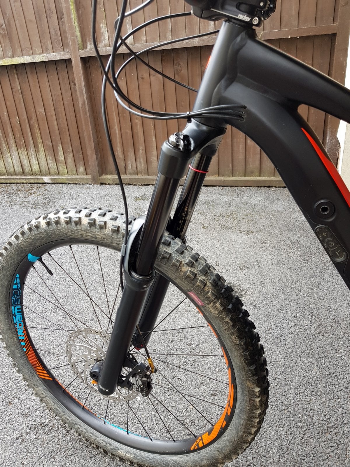

Be careful on this one all,
I did the same on my 2017 Levo. However, be aware of a couple of gotchas.
1. The remote will work on some Levo’s but not others. This was the experience and feedback from the team at Rutland cycles in the UK when I purchased my one. I was lucky enough to have my bike in there for some work so they were able to physically try it out on my bike to ensure it worked before selling it to me. They had had issues with a few other Levo’s where it just would not work despite checking everything and upgrading to the latest software. This was a few months ago so I am not sure if they have since found the ‘root cause’ of why some worked and some didn’t so please call them if you want to get further info.
2. On the 2017 Levo there is no hole in the frame to route the remote cable and plug end that connects to the motor. You can route the cable on the outside but you will need external cable clips of sorts that will stick to the frame and route the cable down to the motor where the connection for the remote is. You will need to cut or file a small slot in the upper plastic motor cover to gain access to motor area and feed the cable down to the connection point.
3. Or....... you could do what I did and drill a hole in your frame. NOT RECOMMENDED if you are worried about frame warranty or you don’t have the tools or skill set to do this task. This includes drilling a 4mm hole in your lovely frame :eek:, cutting the cable of the remote as the plug end that connects to the connection on the motor would require a huge hole in your frame. Feeding the cable through the frame where the new 4mm hole is and rejoining the cable by twisting the ends and soldering and insulating the ends by fitting waterproof heat shrink. When you get past this point it is easy as you can just route the cable down the down tube with the rear brake cable and then divert it down to the connection point.
Photos below show the hole in the frame and the remote controller fitted.
Hope this helps ;)
