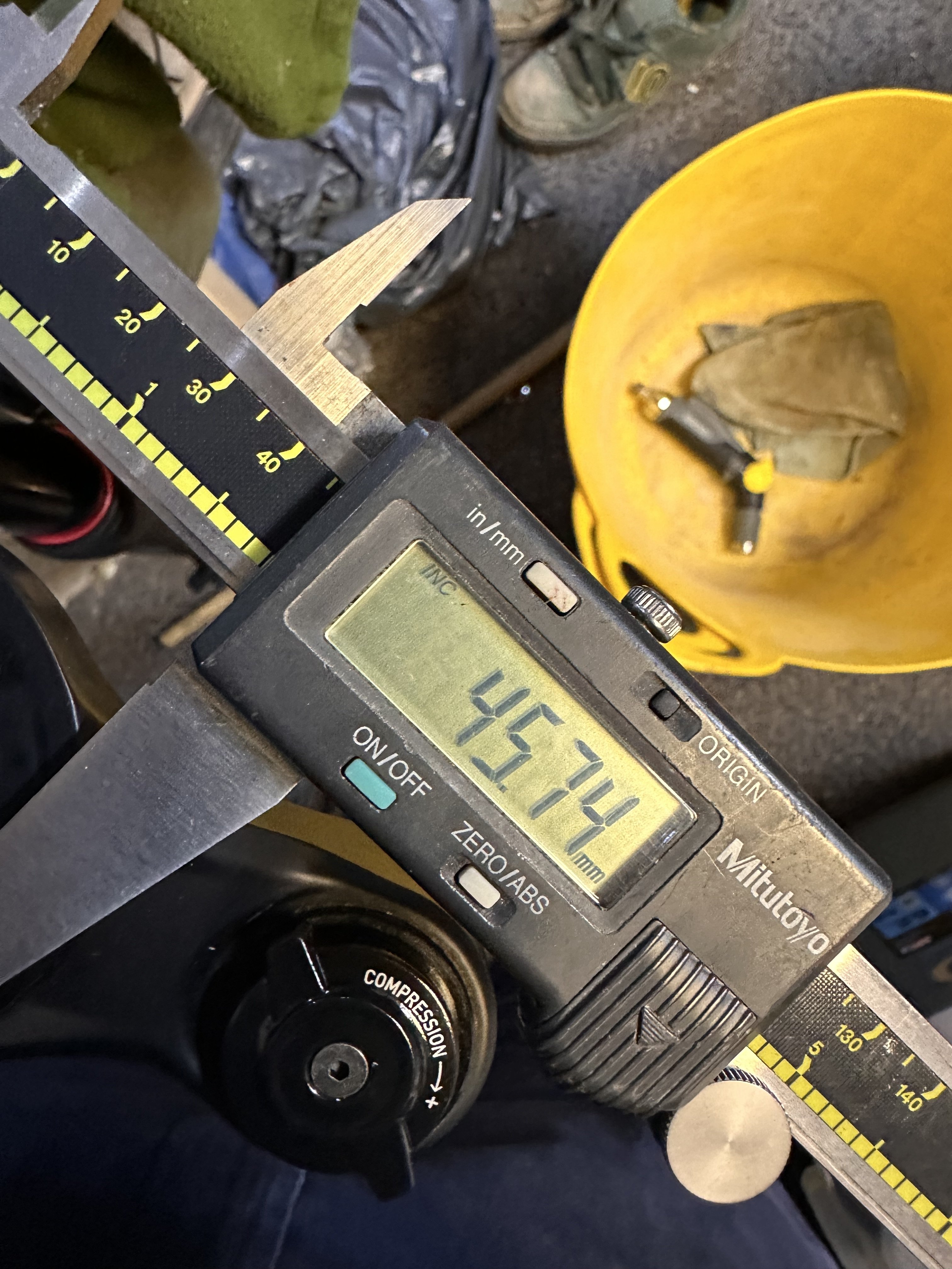

Good morning all,
Prior to posting this new thread I’ve trawled through multiple other looking for an answer to this simple question.
I own a 2024 Rail 9.5 and bought a pre owned Zeb fork as an upgrade, but when I came to swap over the original fork crown race I found it was too small to fit over the steerer.
Spec from Trek Website:
OCLV Mountain Carbon main frame, 1.8'' lower head tube.
On further investigation I noticed that the original fork steerer diameter was 1.5” and the crown race had a larger land that effectively reducing the inner diameter and converting the 1.5” steerer to accommodate a 1.8” bearing. All very confusing and annoying as the Bike Spec states it has a 1.8” bottom steerer bearing, and so you would have thought the fork would also have a 1.8” crown race.
So naturally I’ve search the Interweb for a replacement and have only found one on the Trek Website, trouble is they have no stock.
Does anyone have an idea where I can find one of these as currently I can’t fit the new shock.

#lazy…I feel your pain mate. That’s exactly what happened to me! But unless the fork has a 1.8” crown race fitted on the steerer I’m buggered because my old forks had a 1.5” OD on the bottom steerer with a 1.5” to 1.8” converter crown race so that they fit in the oversize Trek head tube. I need a 1.8” crown race and can’t find one anywhere!

Would this solve it?
I can’t be sure…the title says 1.8”, but the description says 1 1/8”. I might give them a call and ask. Thanks for taking the time to try and help out though.

No problem, whenever I see a post where someone can't find an item I take the challenge 😁
The measurement shown, 45.8mm, equates to 1.8" not 1 1/8" so figures crossed.

That’s what I thought!

I ordered one anyway, I’ll buy you a pint if it fits! 👍🍻
