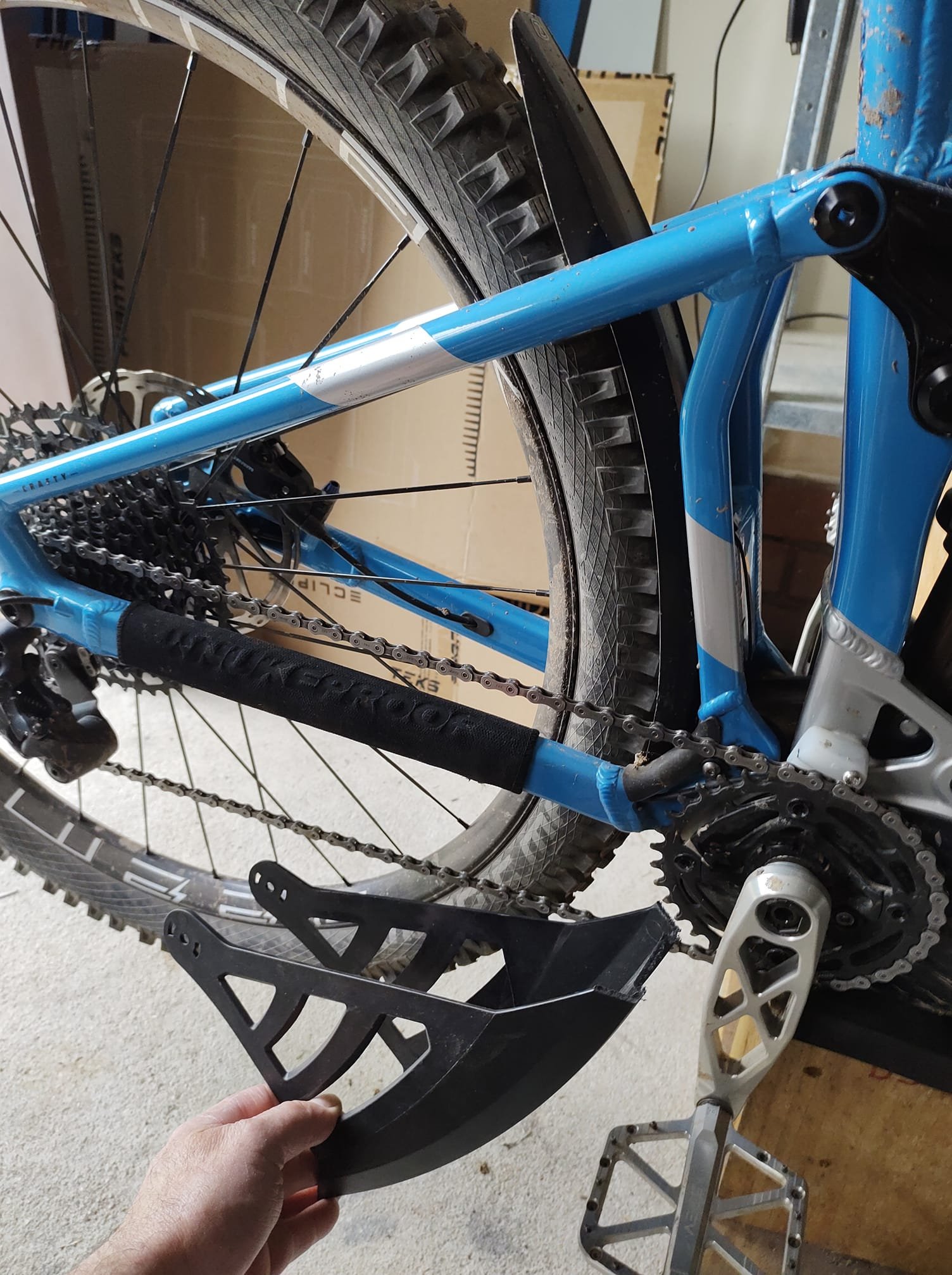

I modified this Zefal to fit. It extends all the way down to the bottom of the chainstay , lower link bearings are protected
Mounted with one large cable tie.

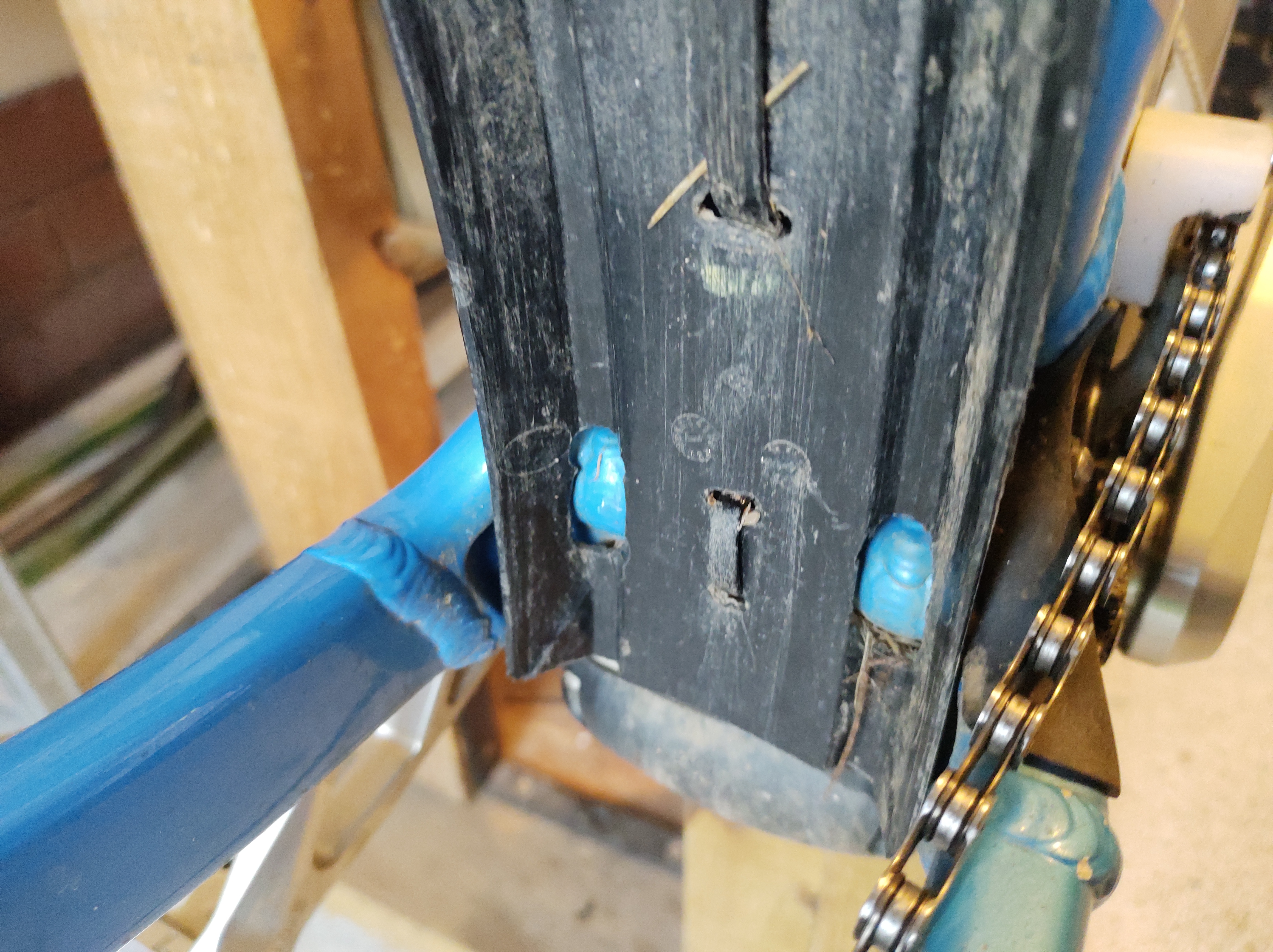

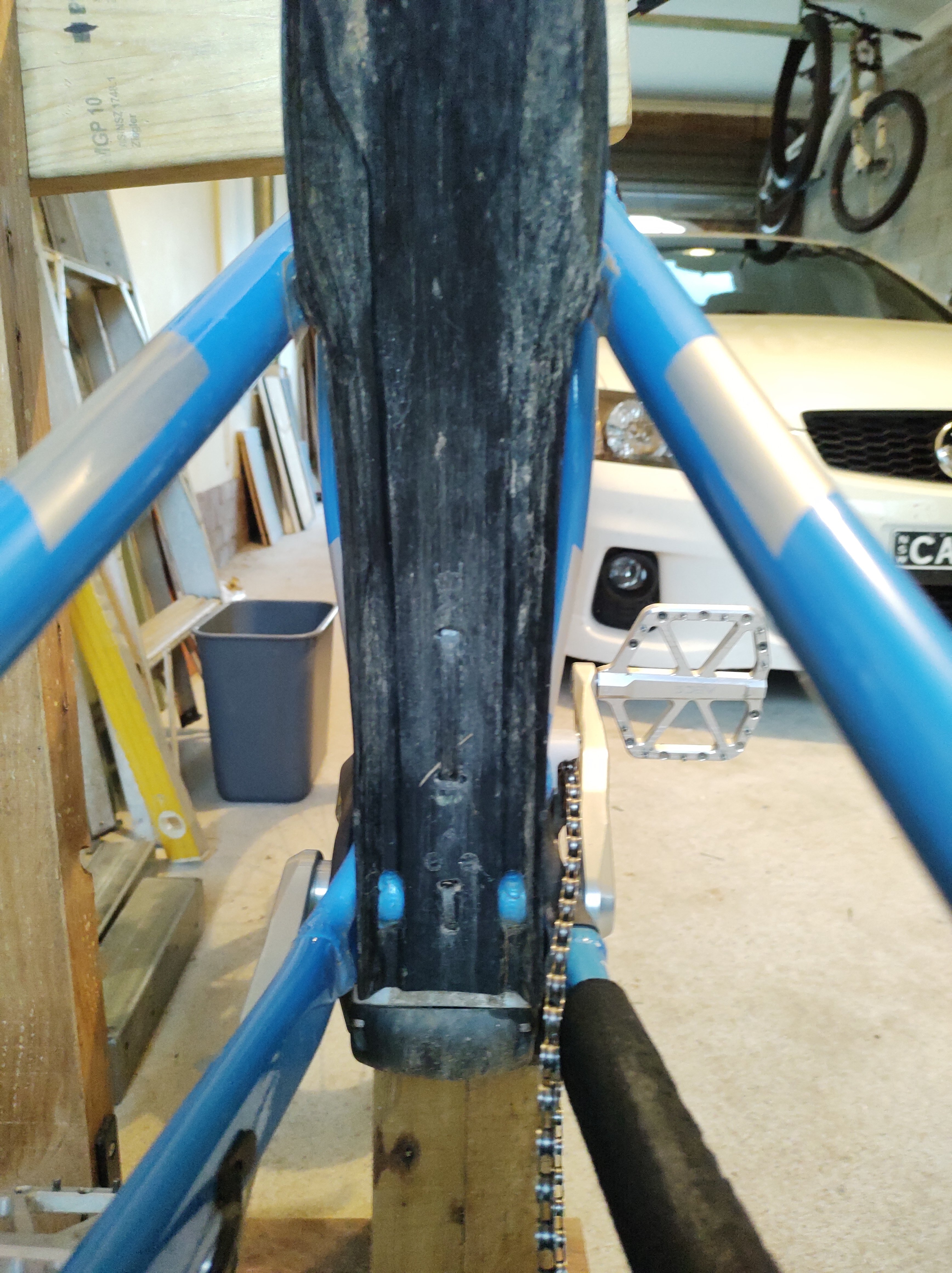

Aside from cutting the length down , I had to make 2 small holes to allow it to tuck into the welds on the seatstays as much as possible. I also used a heat gun to "reshape" to give maximum clearance from the tyre. Sometimes a stone will stick to the tyre and drag through the gap but it only does one revolution!
It's not perfect but the width is perfect , the plastic is quite thick and it doesn't rattle around.
