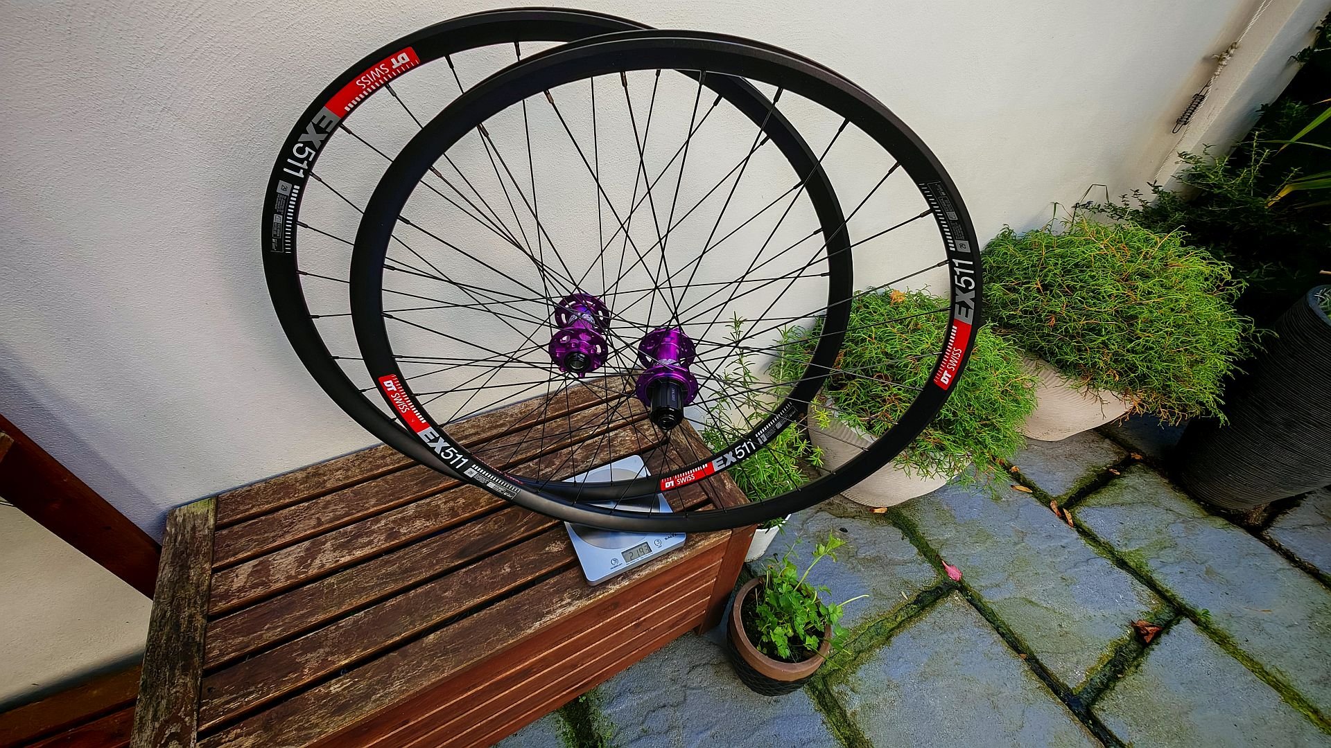

-Wheels - koozer 450 hubs, ex511 rims, brass nipples, Sapim race/D-light spokes (2.2kG set)

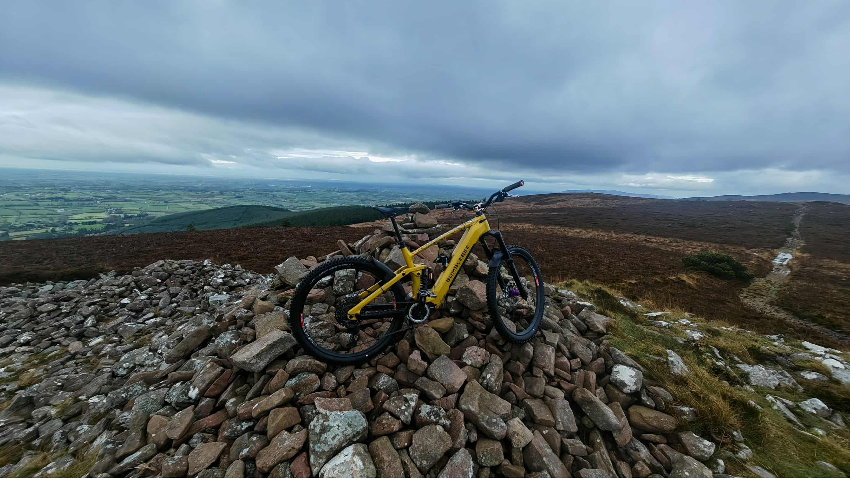

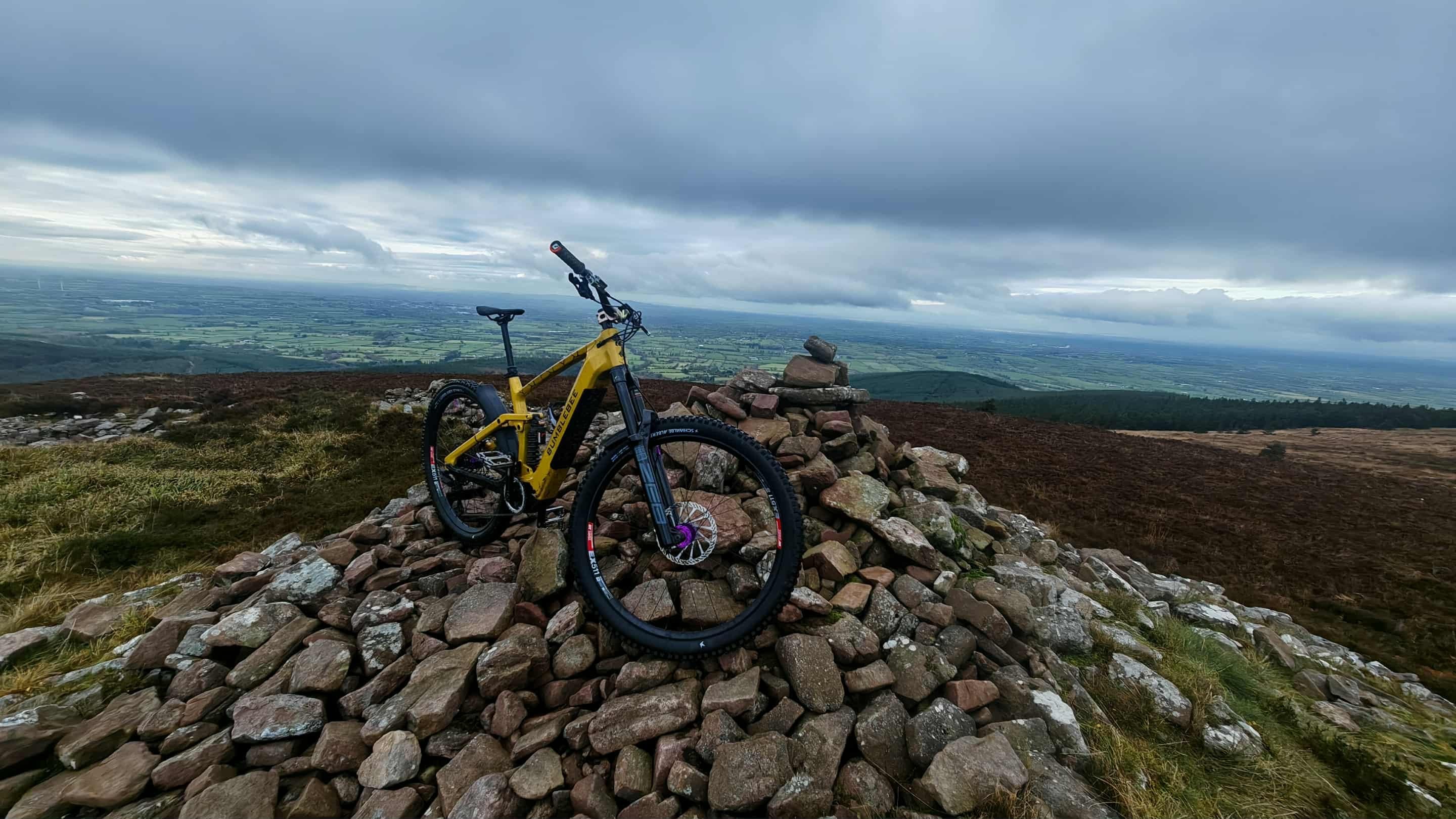

Gave it a nice little wack over the weekend.
So far so good, bike is very quiet, surprisingly nimble (probably due low DIY battery placement). I feel a nice balance when do pumps and jumps. Frame feels solid with very little flex. After about 80km all the bolts were tight, no loose headset etc.
When taking sharp corners bike feels light and easily goes where I would like it to go.
Only moment I feel the bike is heavy - lifting it.
What could be better ?
-Dropper post insertion and seat tube length combo are limiting dropper post to 160mm at my height about 184cm.
-Limited option to fit air shock. The rocker link catches the top cap of the most of the air shocks so mostly frame will be for coil shocks.
Overall happy.
Regards
