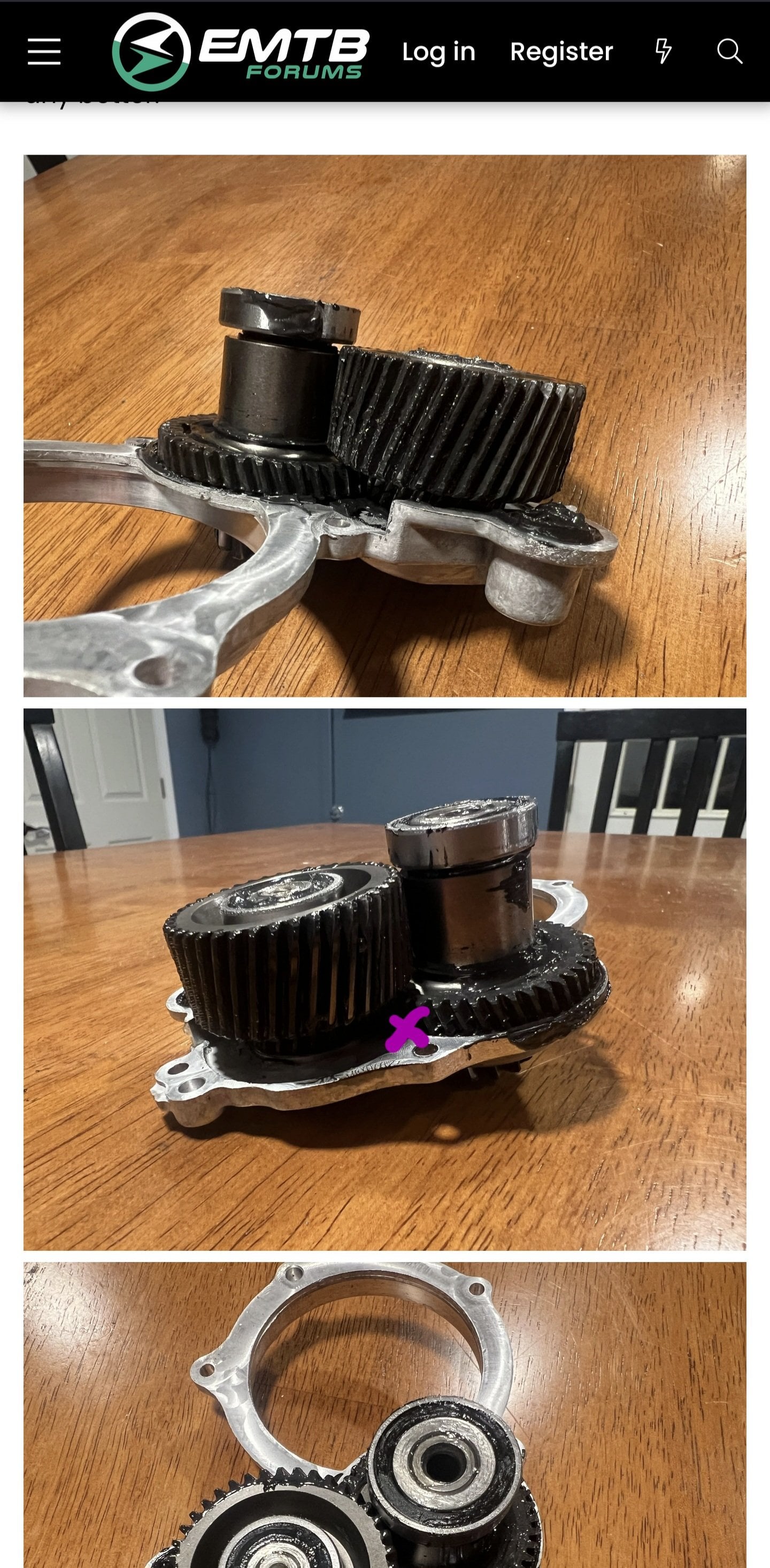

20250902_204441.jpg 20260118_171548.jpg 20250811_200844.jpg 20241101_152730.jpg 20250602_151520.jpg
It looks like the second gear overrun clutch is the weak part of the motor. It also looks like Bafang did not address this issue since m600.
Thanks for your feedback. Please tell me if I'm wrong, but I suspect the contact area on these parts is too narrow to handle the torque.
I will open my motor as soon as I receive it on February 3rd. I had already inspected the other gears before sending it to Bafang (which is why my warranty was denied). I need to check the one-way bearings and the subsequent gears shown in the photos (from what I understand, it's gears 2 and 3).
Nb: These photos are from this forum it's not from my motor.

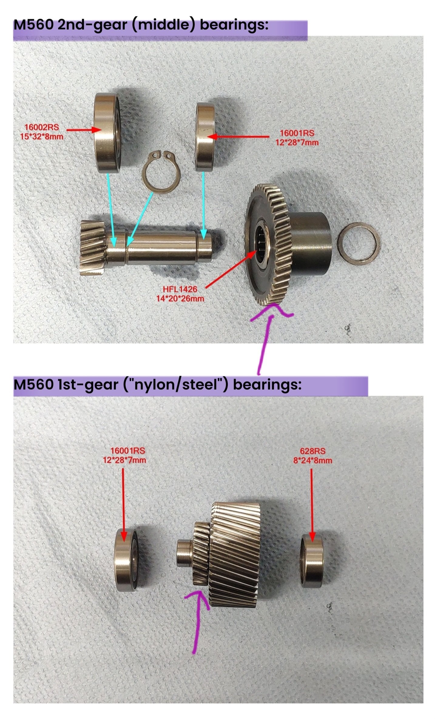

I truly hope it's only the one-way bearing (HFL1426) that failed, without any gear damage. If I replace it with an INA one, it should solve the problem and avoid having to change it every 1300km. I also hope that better quality grease (like SHC 100) will limit maintenance. From my experience, stock Bafang grease needs to be changed every 1000km because it can't handle the heat and turns into black sludge too fast.

Which specific component is the most common failure point in the Bafang M560? I want to stock up on spare parts to have them on hand if something fails.
HFL1426 bearing?
HFL1426 bearing?
Yep for that one way bearing (inside the main cog) i'm looking at buying in advance the INA version and also for the main axle bearings looking at SKF 61810 RS, i'm thinking to replace all of them when the motor arrives so i don't have to deal with it down the line (tinkering with the gearing doesn't worry me too much, thats the farm boy in me)

Yes, is true Bafang did design wrong this one way bearing. I think they did not tested for enough of km.
