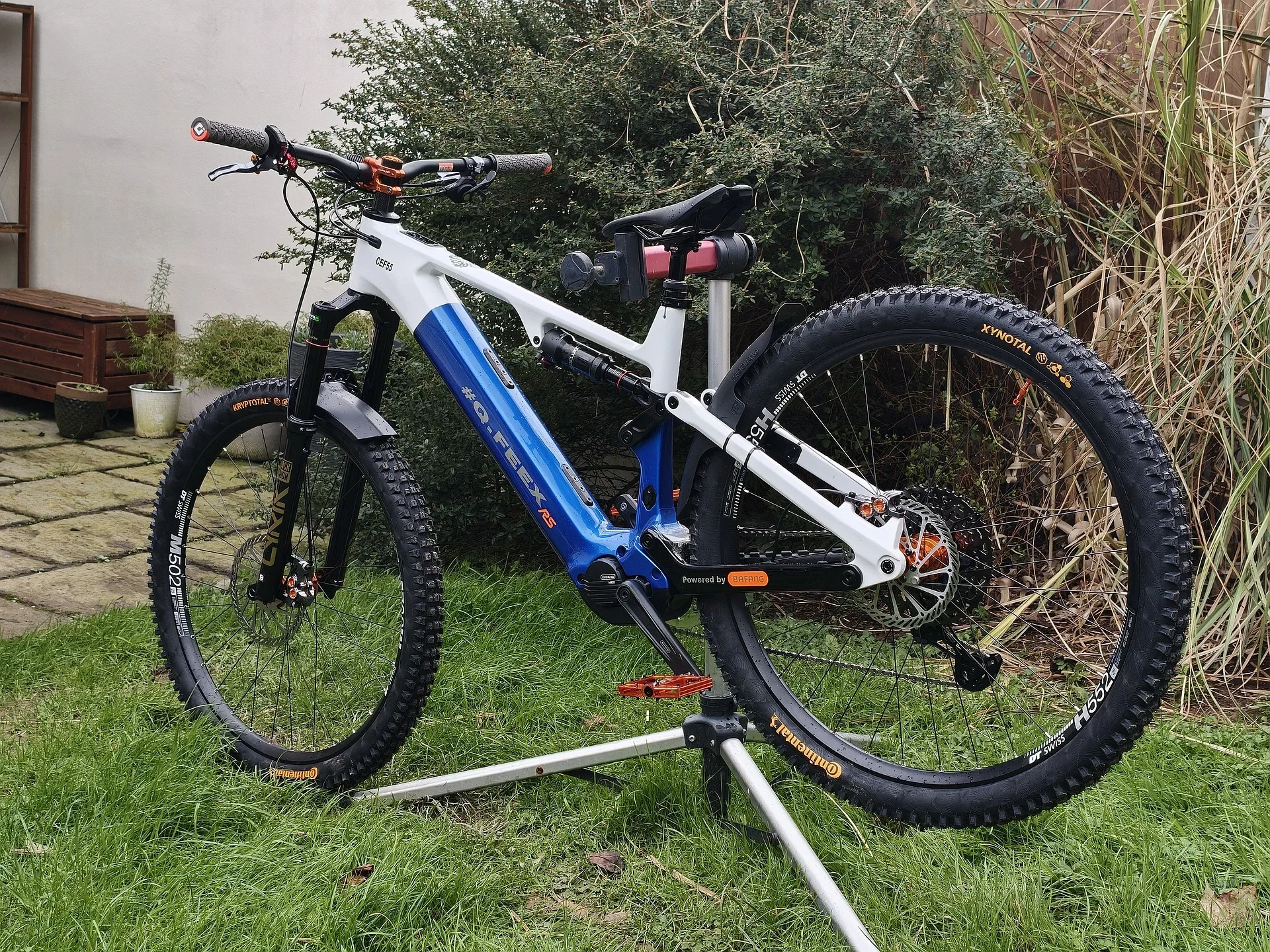

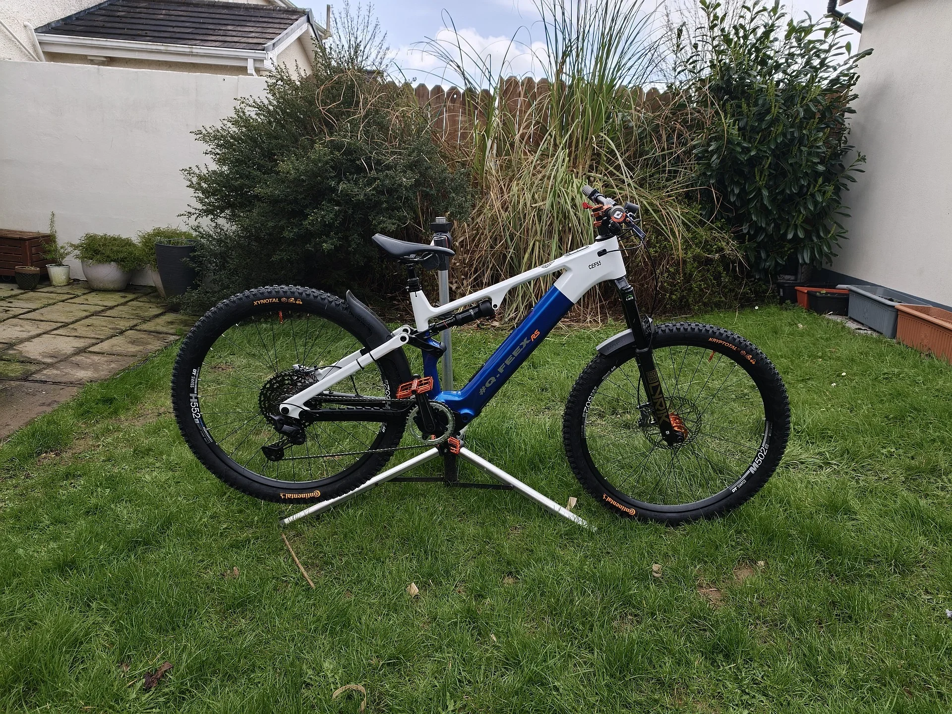

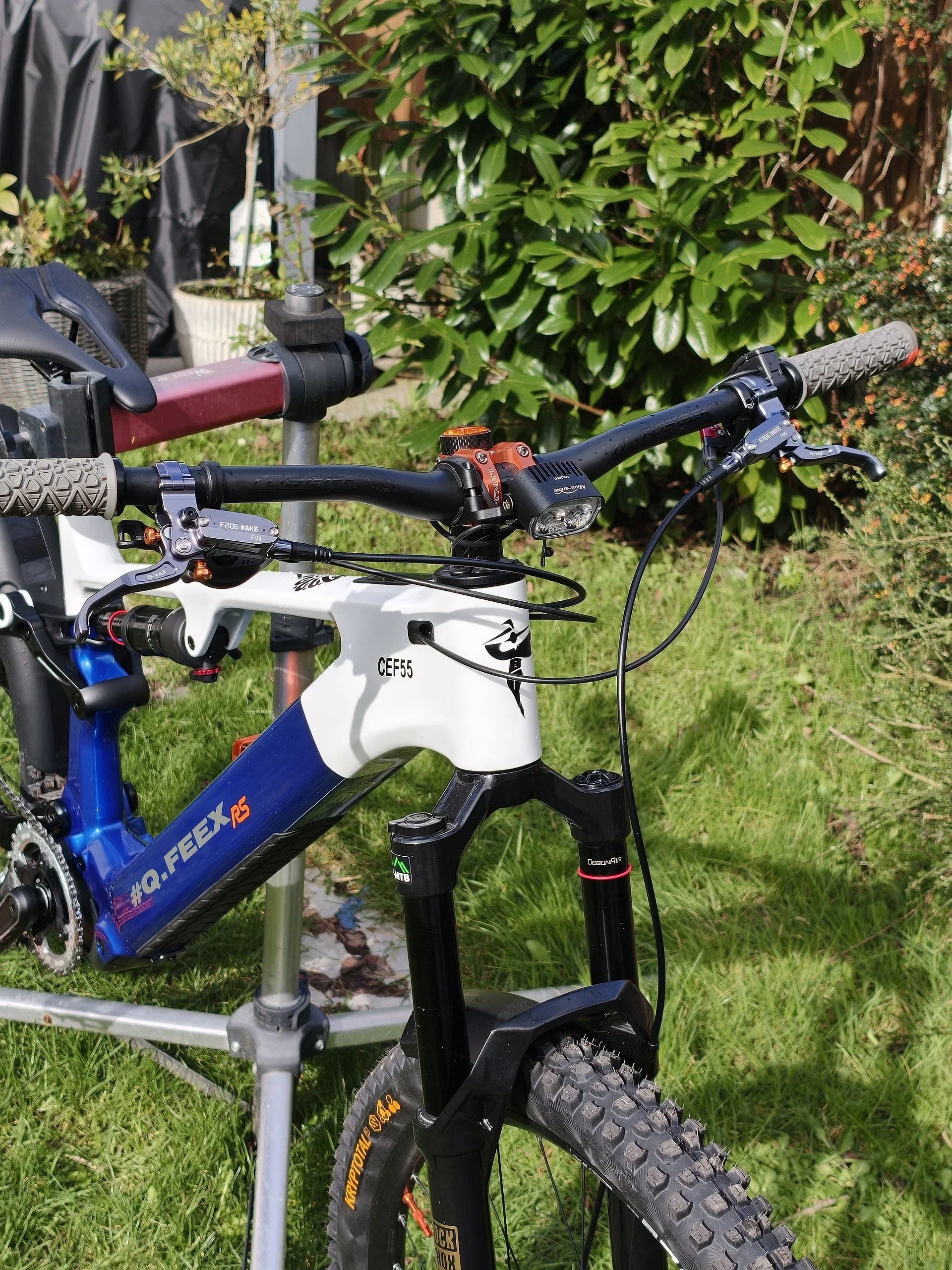

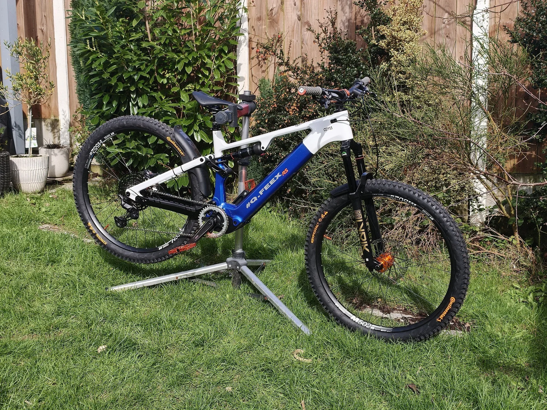

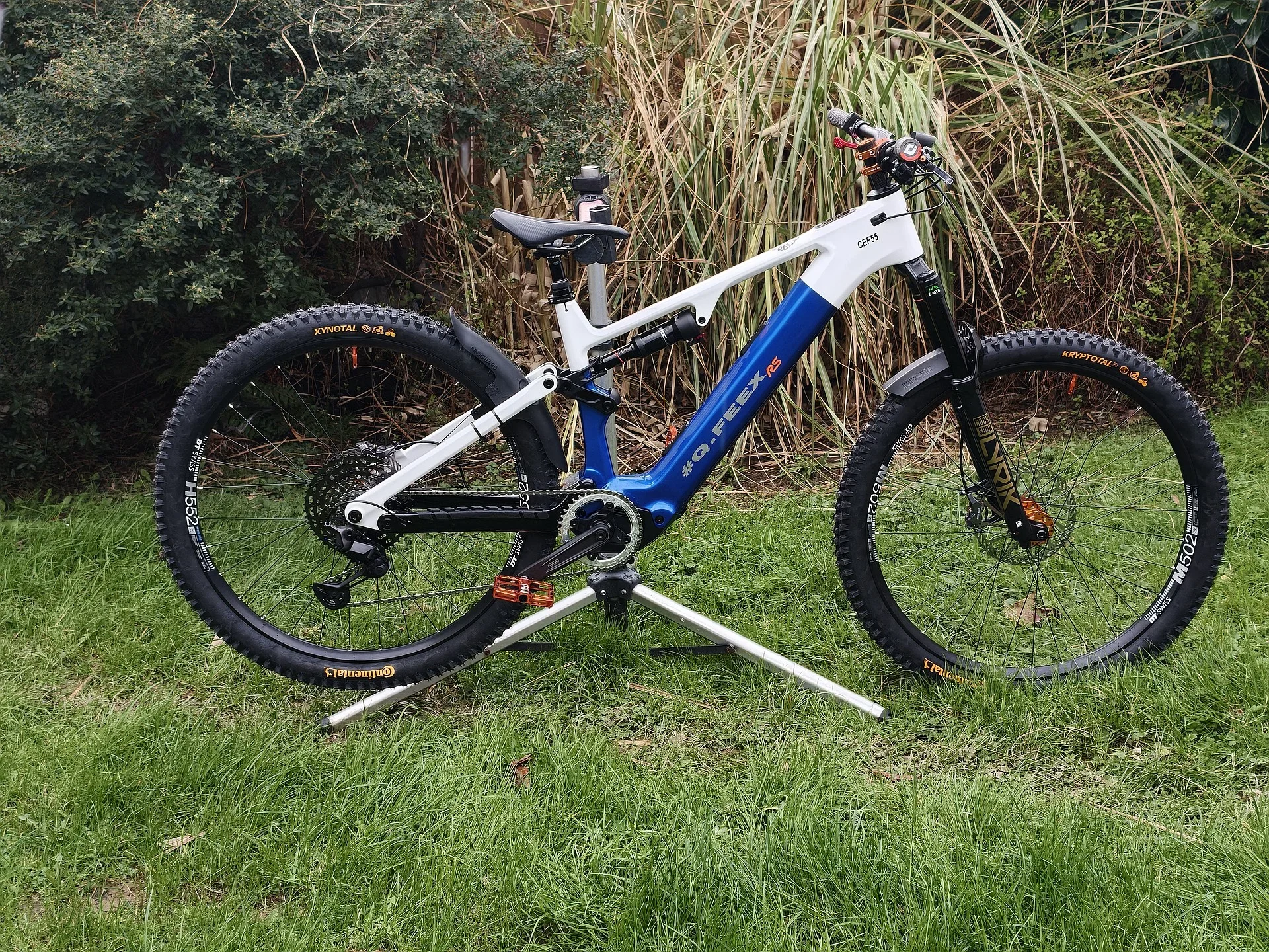

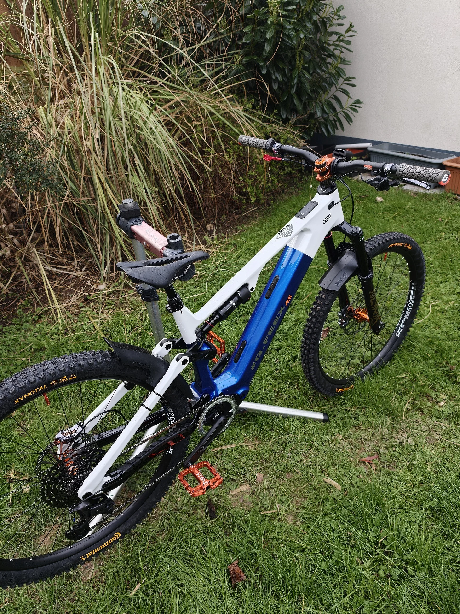

Hi all mad bikers.
Another day, another bike to build.
Some time ago I got two frames, CEF55 and CEF69.
Decided to build CEF55 first.
This is trail bike build for the long journeys.
Painted with RCF blue and some AUDI white color paint.
FORK: LYRIK 150MM
SHOCK: SELECT+ 210X55
BRAKES: SOME V4 FROM ALI
BRAKE ROTORS: Avid 203mm-front and 180mm rear
WHEELS: DT Swiss rims (models as on the photos), Alpine 1.7MM spokes, brass niples and KOOZER 455 hubs (32 hole)
TYRES: Continental Enduro Soft 29x2,4''- Kryptotal FR and Xynotal
DRIVETRAIN: 11S LINKGLIDE
CHAINRING: 38T (max size)

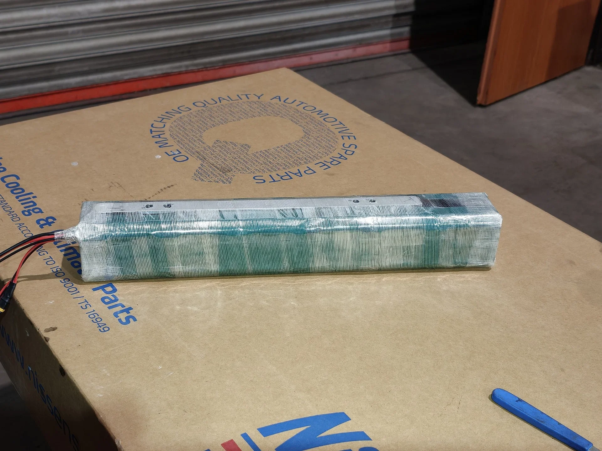

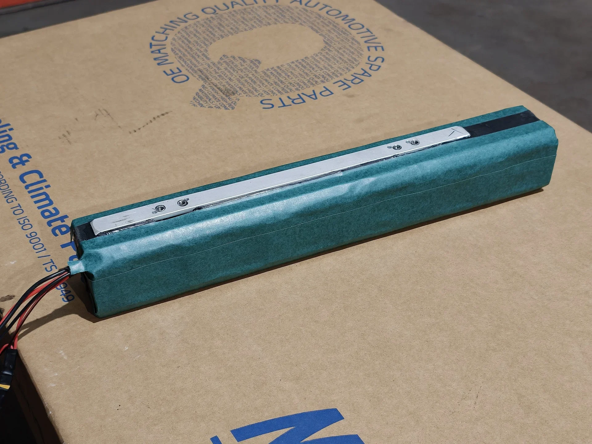

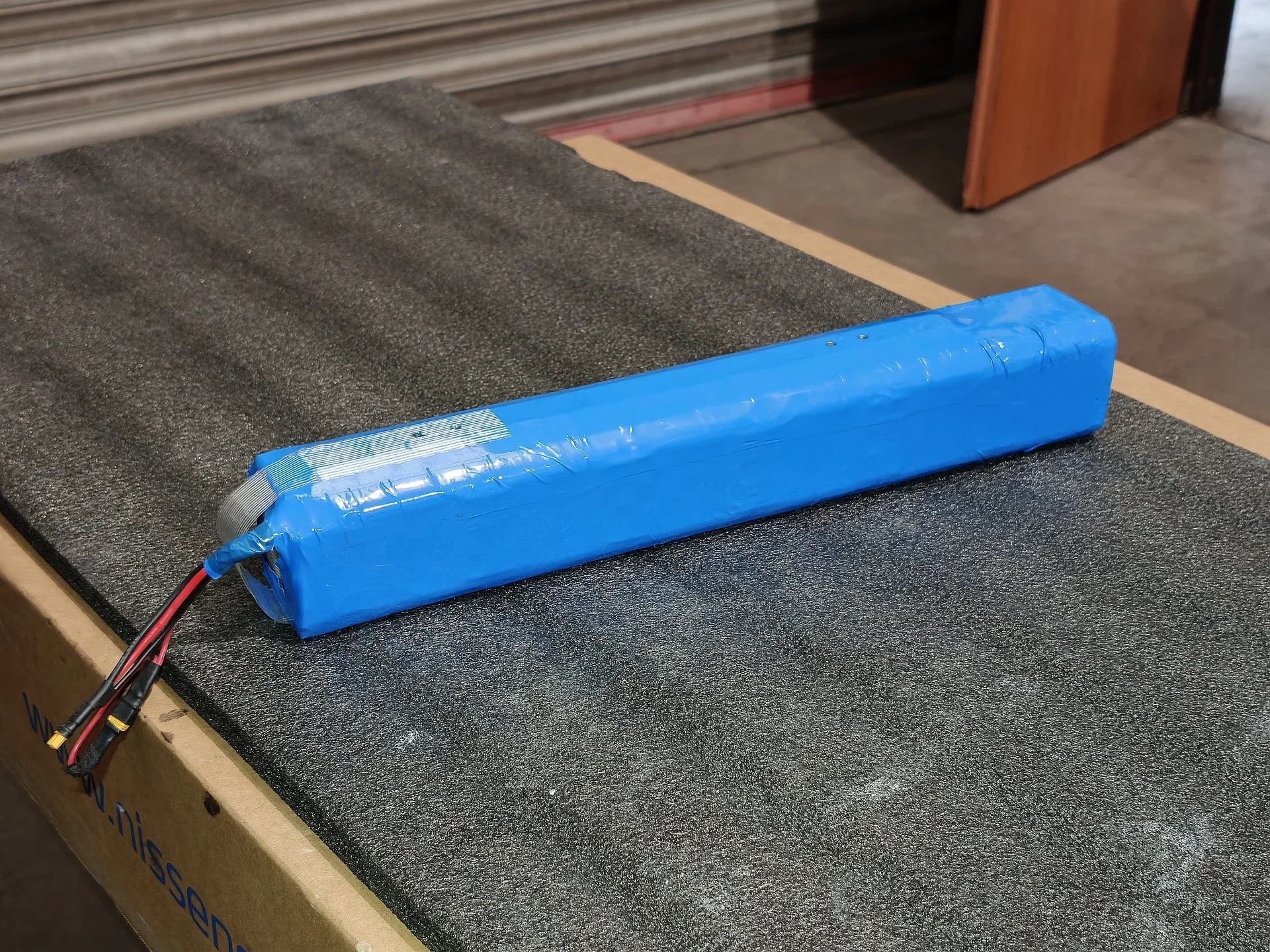

BATTERY: 13S4P 48V 1000Wh Samsung INR21700-58E (CC5563F101)
I have measured few cells at 0.5A discharge, outputing close to 5500mAh
BACK FENDER: RRP Proguard Front Mudguard - SHORT
DROPPER: E13 VARIO 180MM slammed all the way down as insertion lenght of L frame is only about 295mm.
PEDALS, SADDLE, STEM, HANDLEBAR: got it on ALI
A few pictures bellow:

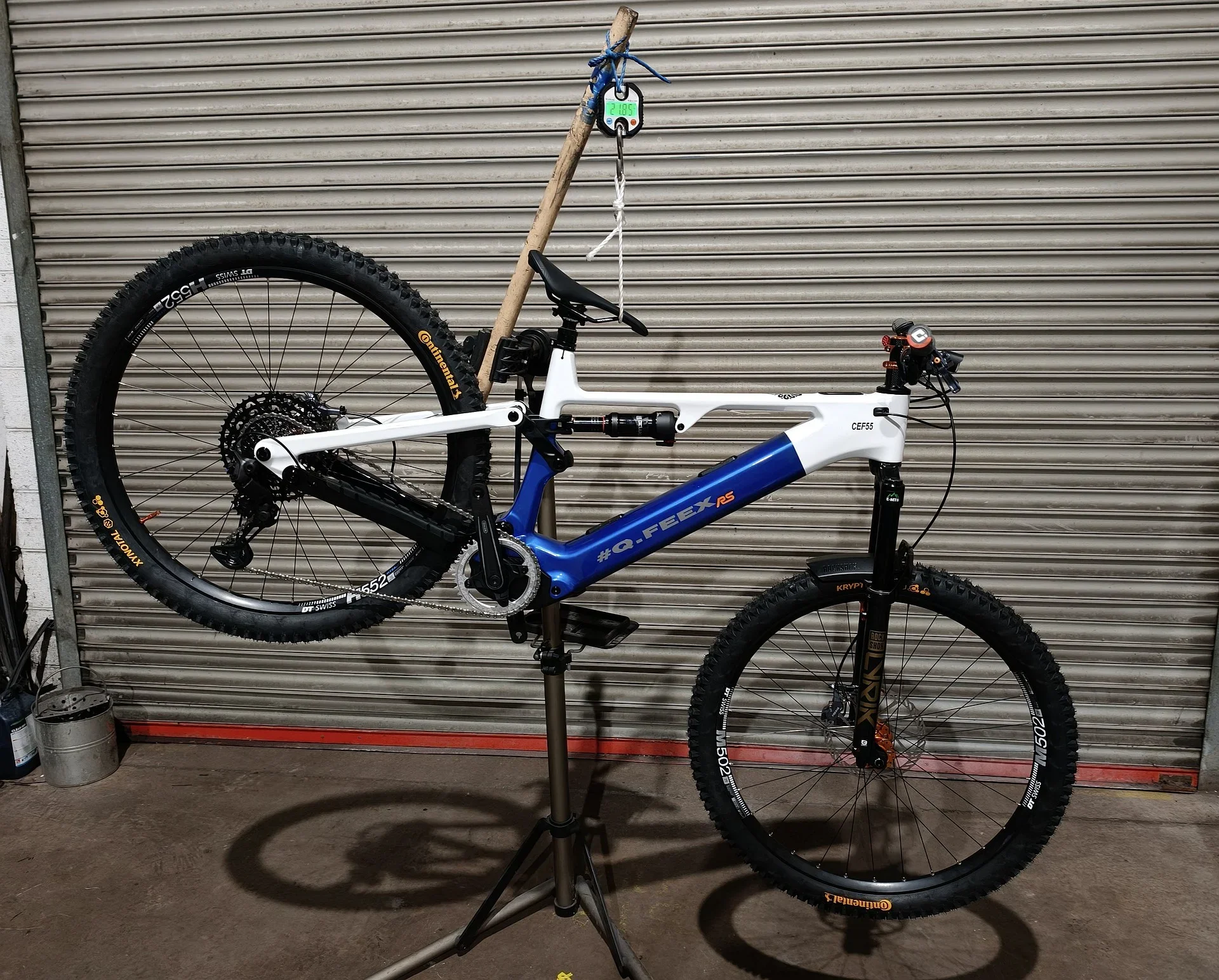

Weight of the bike with no pedals is about 21.85kG

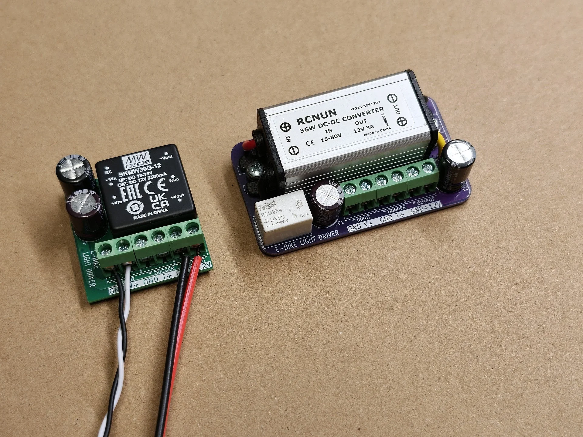

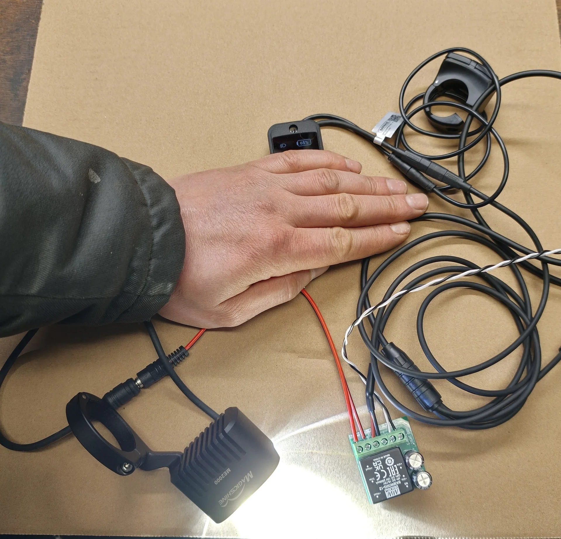

Additionally I made a small module (about 30W max) for automatic LED headlight. I used Magicshine ME2000 light, gives plenty of light.
Battery is mounted very tight in the frame. Wrapped as below in 3 simple steps:

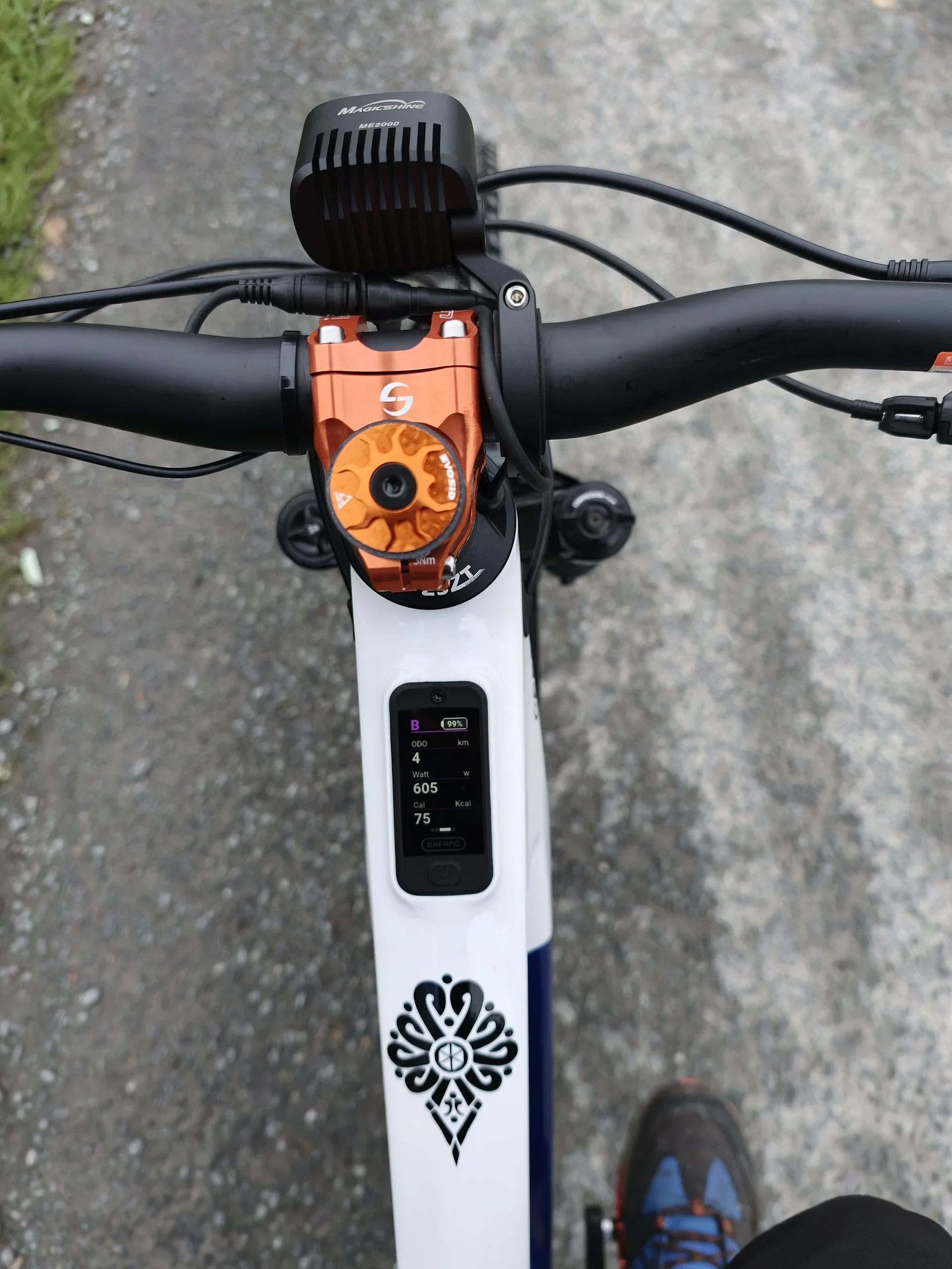

Done only short ride to bed in the brakes, max power I could get on the display with full battery is about 605W (which is plenty for me).

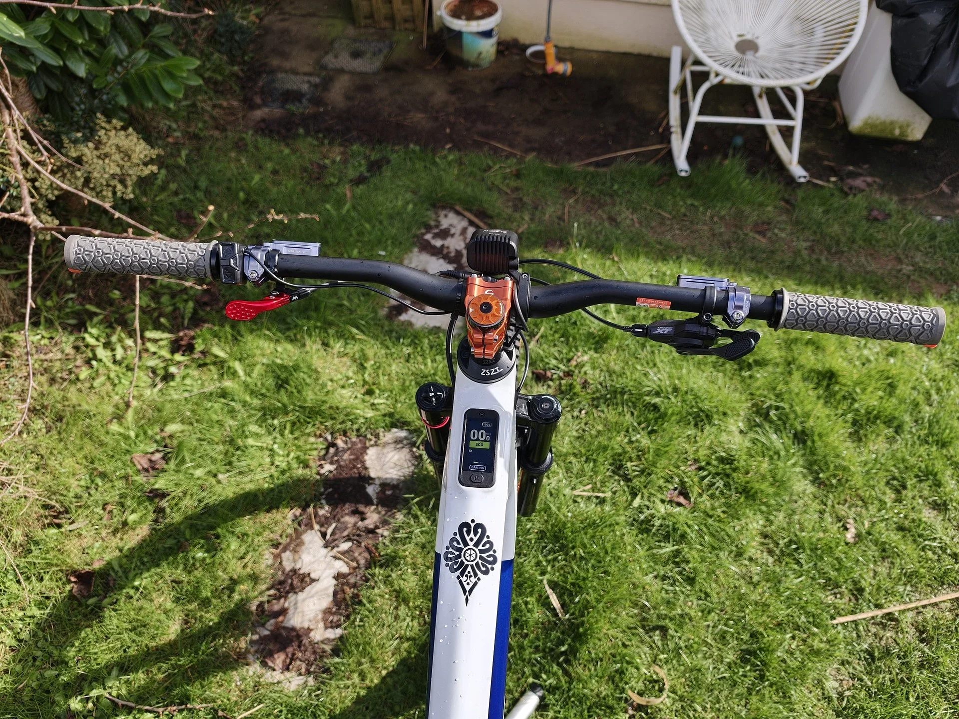

Paired Garmin Explorer2 with DPC030.1 display. There were 3 new sensors visible:
-3377 speed sensor
-3377 power sensor
-3377 eBike (for battery and modes used)
Is there a way to display rider input power with bafang stuff?
Thanks

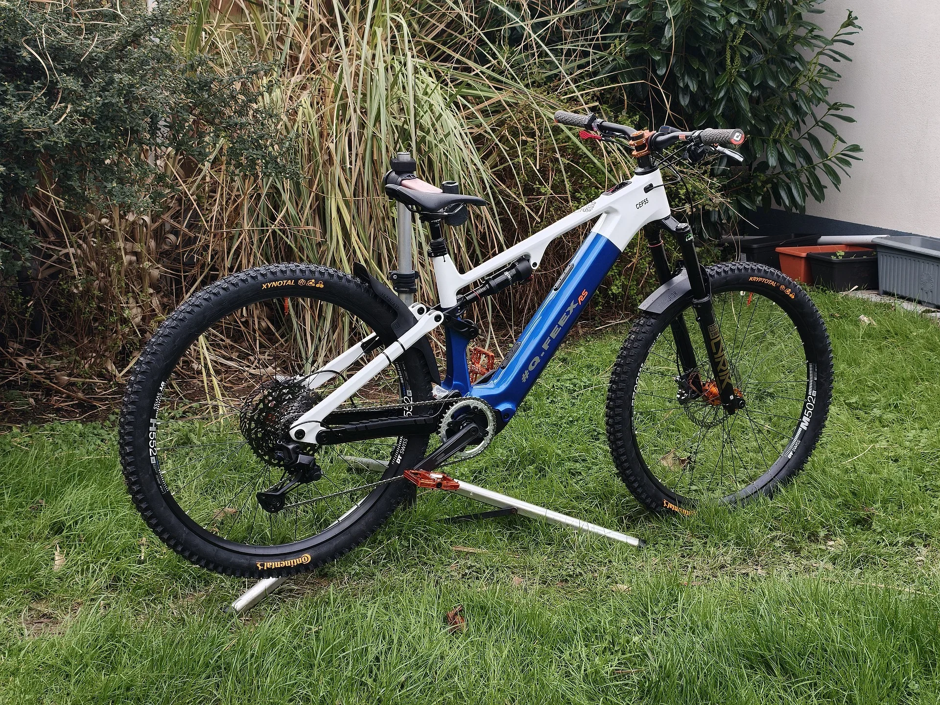

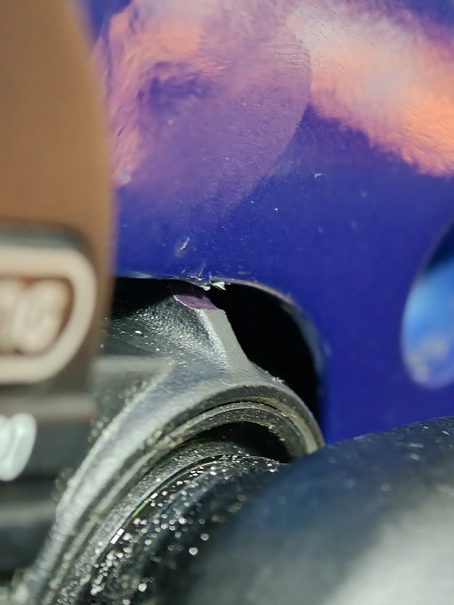

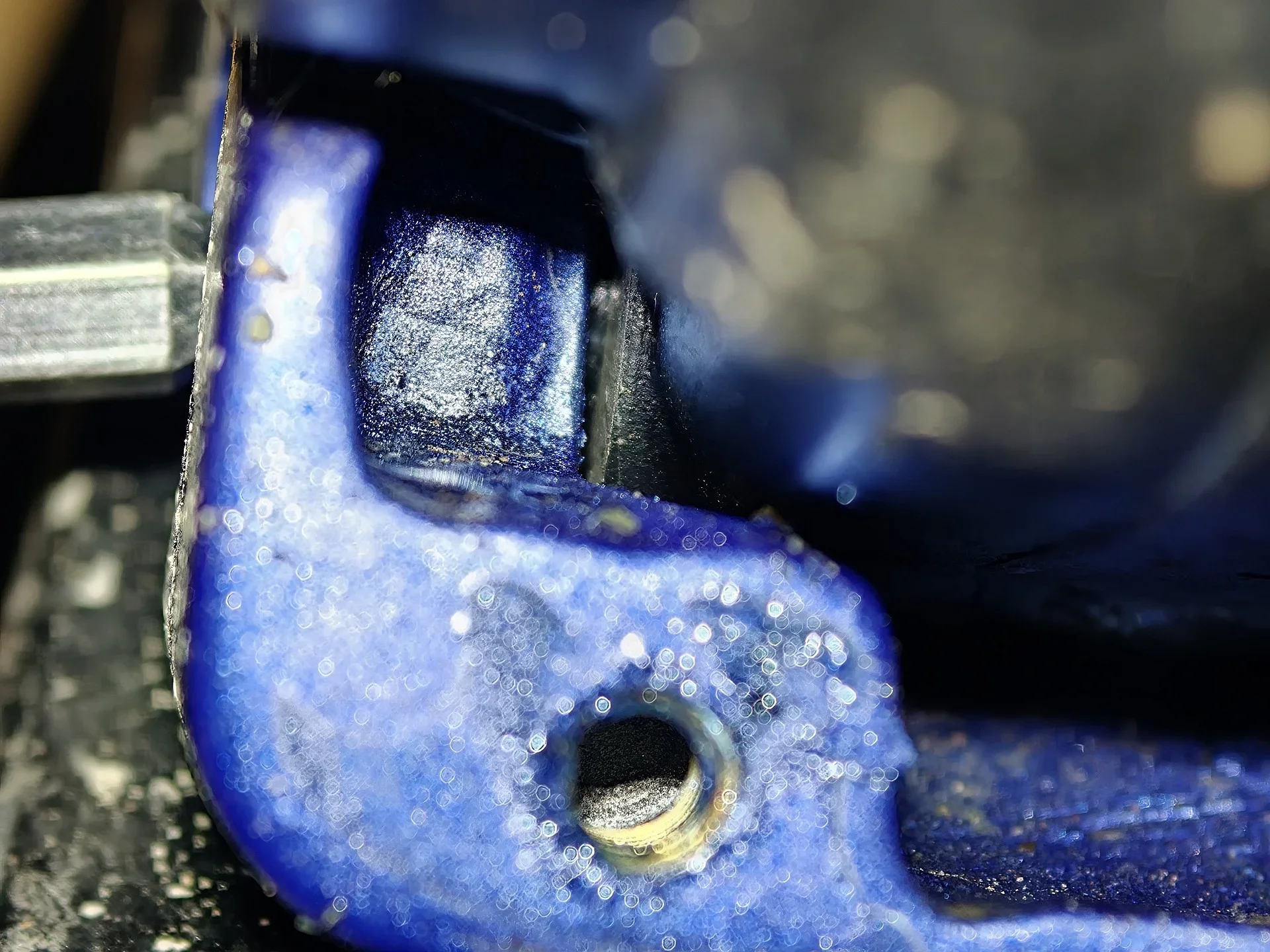

During a past few days found 2 minor bugs related to the CEF55 frame.
no1.

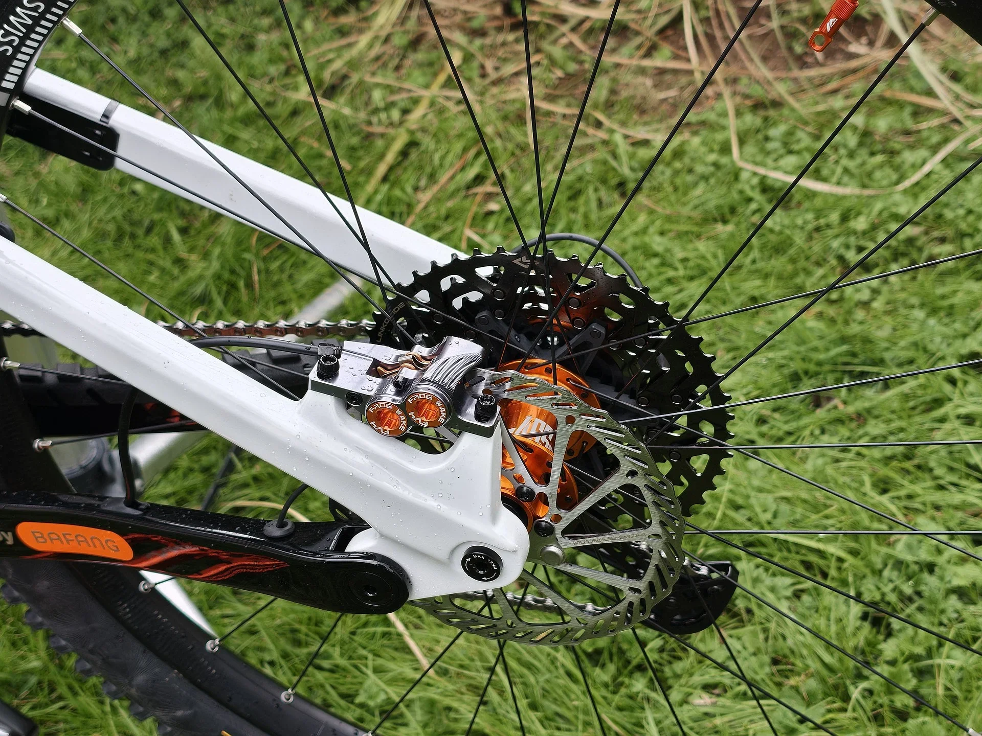

Lower motor mounting has a good bit of the play in the frame. The gap gets smaller when the mounting bolt is tightened (but it is still there).
In my case I have to make a distance washer --> ID-10mm, OD-20mm, 0.7mm thick.
My advice is to install the distance washer on the non drive side of the motor, so the max 38T chainring clearance is not affected.

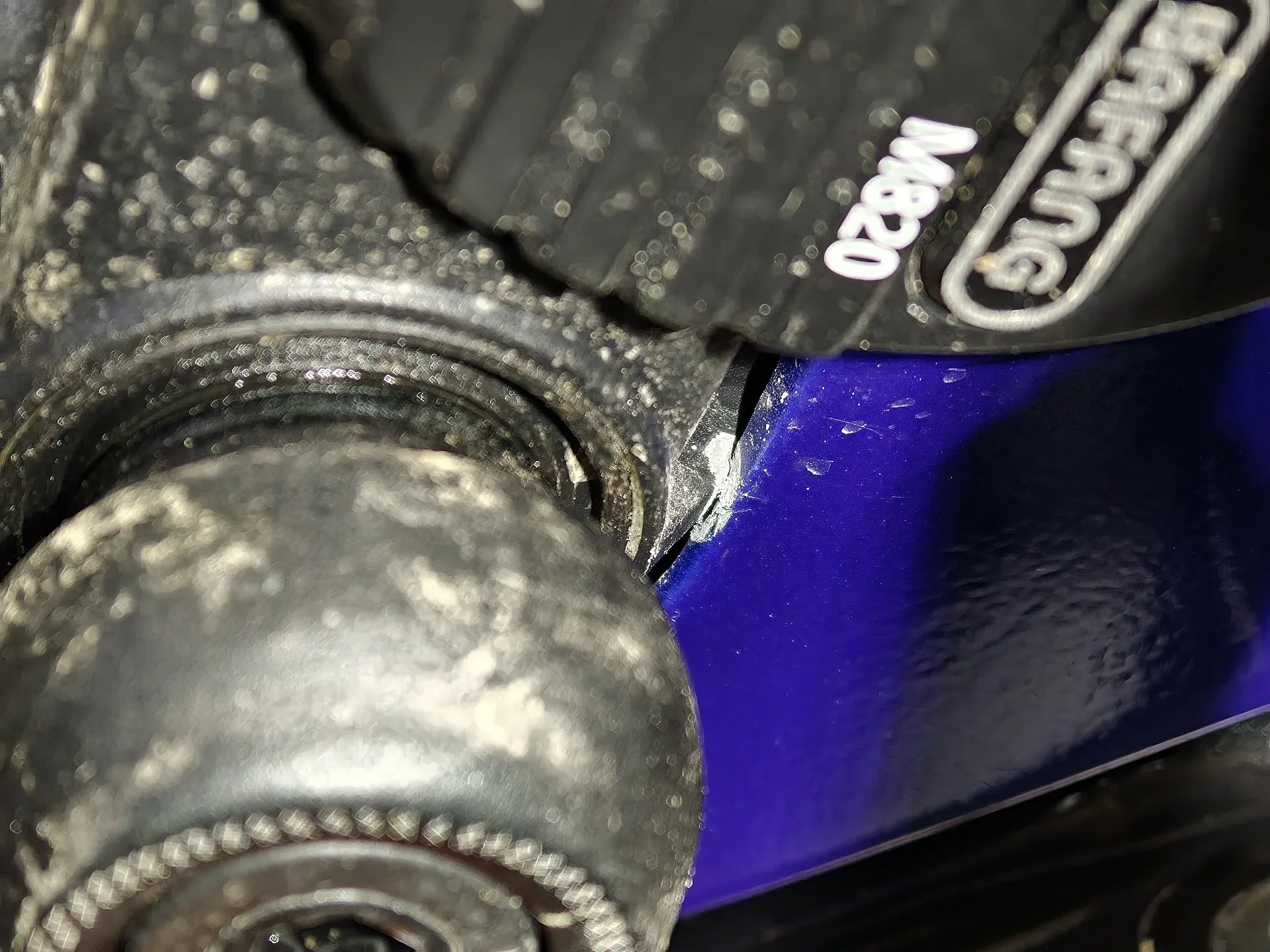

no2.
Non drive side motor casing is rubbing badly on the frame - as on the pic bellow. It is so bad that it caused a small crack on the frame + some of carbon fibers got cut. Hope crack will not develop any further.
I just filed a bit of the material of the motor and problem is gone.
Other than that - so far so good.
