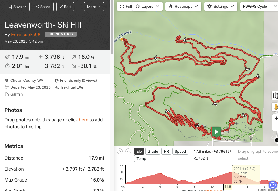

This was on my old Trek Fuel EXe with a TQhpr50 & 360wh battery, mostly all trail mode. Mullet wheels, Assegai / DHR DD, Zeb, coil shock.
So this works out to 1187m with a 360wh, or 303wh/1000wh, all singletrack. I did finish with some battery left though, so actually a little better than that.
I had rides with that same set-up where I got <50% of that range. I figure it just depends on the trails....
