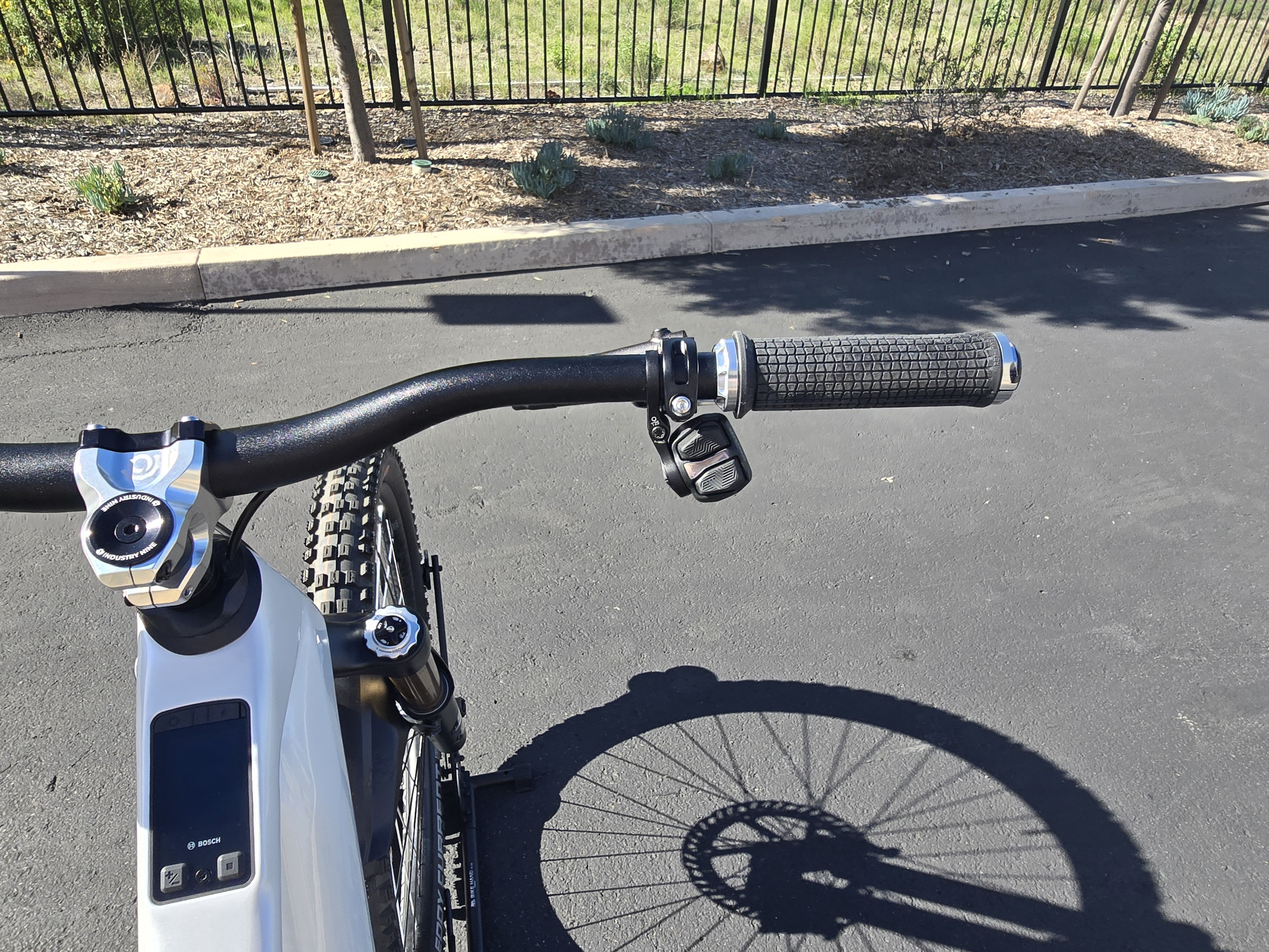

Just finished building a new custom 2026 M10.
FRAME
Orbea Wild Hydro 2026 Carbon, 170mm Travel, 29" Wheels, Concentric Boost 12x148
Custom Paint-Metallic White Chic
MOTOR
Bosch Gen5 Performance Line Race
CX-R BDU3863
INTEGRATED DISPLAY
Bosch Kiox 400C
BATTERY
Bosch Powertube 750Wh Horizontal BBP3770
RANGE EXTENDER
Bosch PowerMore 250Wh
SHOCK
MRP Hazard Custom 205x65mm Trunion/450lb Progressive Spring
FORK
Fox 38 Float Factory, E-Optimized 170mm, Grip 3-Position E-Bike Optimized, Custom Slik Graphics Fox 38 Decals
HEADSET
Alloy 1-1/2", Black Oxidated Bearing
CHAINRING
SRAM XX Eagle AXS Transmission Direct Mount 36T Boost
CRANK
SRAM XO Eagle
CONTROLLER
SRAM Eagle AXS Transmission Pod Ultimate
CASSETTE
SRAM XX Eagle AXS Transmission 10-51t 12-Speed
REAR DERAILLEUR
CHAIN
HANDLEBAR
SQLab Carbon, 4-degree upsweep, 12 degrees backsweep, 45mm rise, 780 x 31.8mm
GRIPS
Revolution Pro Series Large (black grip/silver lock-on rings)
STEM
Industry Nine 31.8 x 40mm (silver body/black stem cap with silver bolts)
BRAKES
Shimano Saint with Oak Raw Brake Levers
Magura MT7 Calipers
Magura MDR-P Rotors (220mm front/200mm rear)
Front Pads - Sport (green)
Rear Pads - Performance (grey)
WHEELSET
Rims
Industry Nine EN 305 V3 29"
Hubs
Industry Nine Hydra - 6 Bolt
Front 15 x 110mm
Rear 12 x 148mm/SRAM XD Driver
TIRES
Swalbe Eddy Current 29 x 2.6"
SEATPOST
Rockshox Reverb AXS B1
Ø 31.6 mm 200mm travel
SADDLE
Ergon SM E Mountain Sport
PEDALS
Race Face Atlas
20260118_132111.jpg 20260118_132247.jpg 20260118_132309.jpg 20260118_132350.jpg 20260118_132354.jpg 20260118_132403.jpg 20260118_132432.jpg 20260118_132323.jpg 20260118_132325.jpg

How you finding the i9's? are they making your motor rattle? they did with mine.
