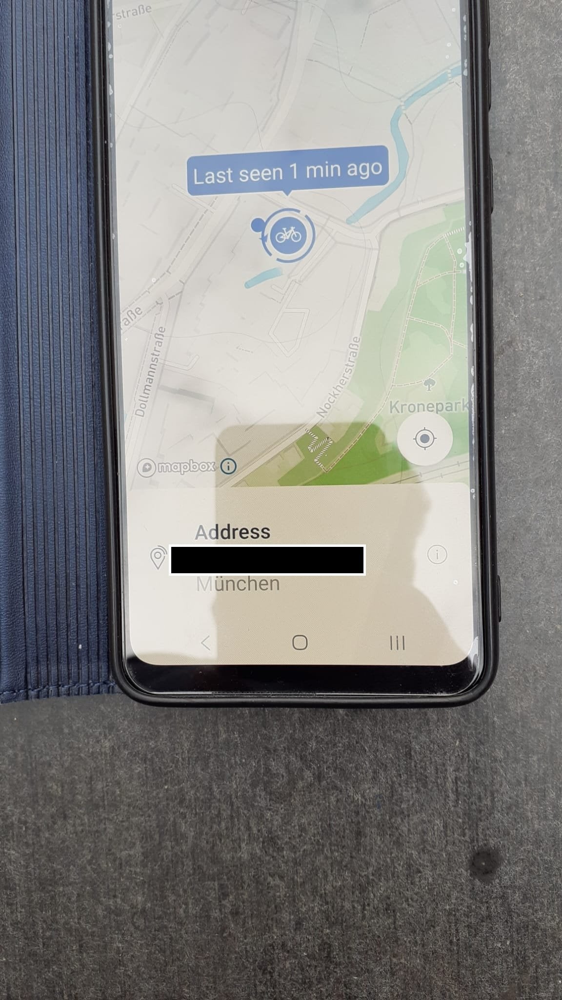

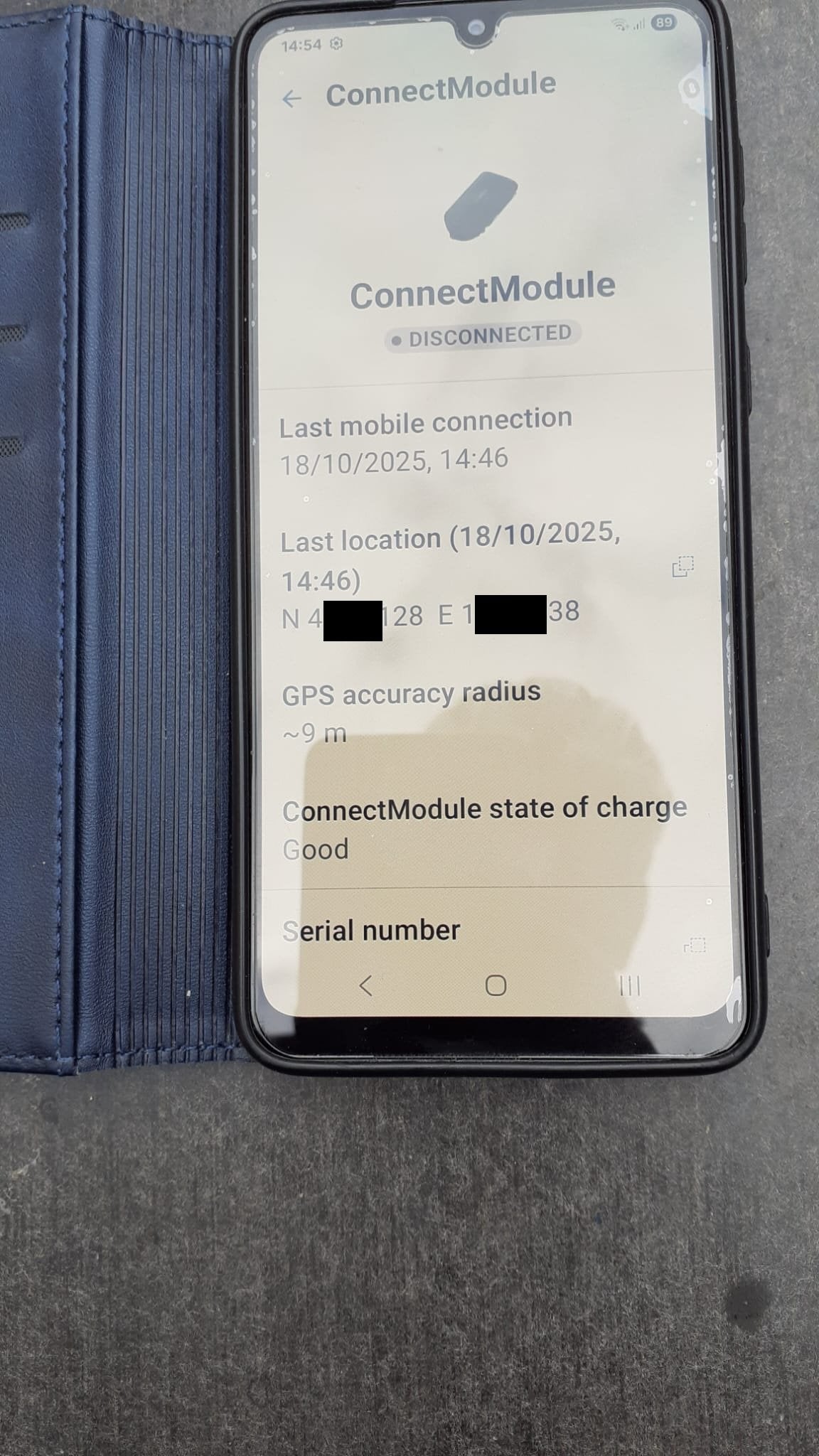

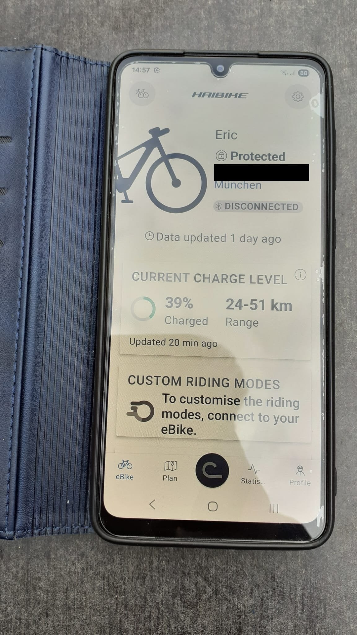

OK here is how the test went. I took 2 mobiles with me on a short ride, both are paired to the bike, from the start with the bike turned off the Flow apps would display its location on a map by tapping the bike icon shown in the 1st and second photo below. With the bike turned on one phone connected to the bike automatically to unlock it while the other remained disconnected. With the bike turned on it was no longer possible to display its location on a map, as before, on either phone but by going to settings>components>Link Module there is a map reference listed, see photo 3 below, which if you put in the search box of Google Maps will show the location on a map. This map reference does change while riding but how dynamic it is was hard to say. One thing I did notice was that the disconnected phone showed a notification that it could not establish a Bluetooth link (blocked by the other phones connection) and I do wonder if it was not adjacent to the bike, which would be the situation if it was your wife's mobile and you we out on a ride, that perhaps it would still directly display the bikes location on a map. You will have to try that and see.
Hope that helps.:) WhatsApp Image 2025-10-18 at 16.38.49_fb60caa8.jpgWhatsApp Image 2025-10-18 at 16.38.49_229695d5.jpgWhatsApp Image 2025-10-18 at 16.38.49_5ea4b0b5.jpg
Hope that helps.:)View attachment 169791View attachment 169792View attachment 169793
