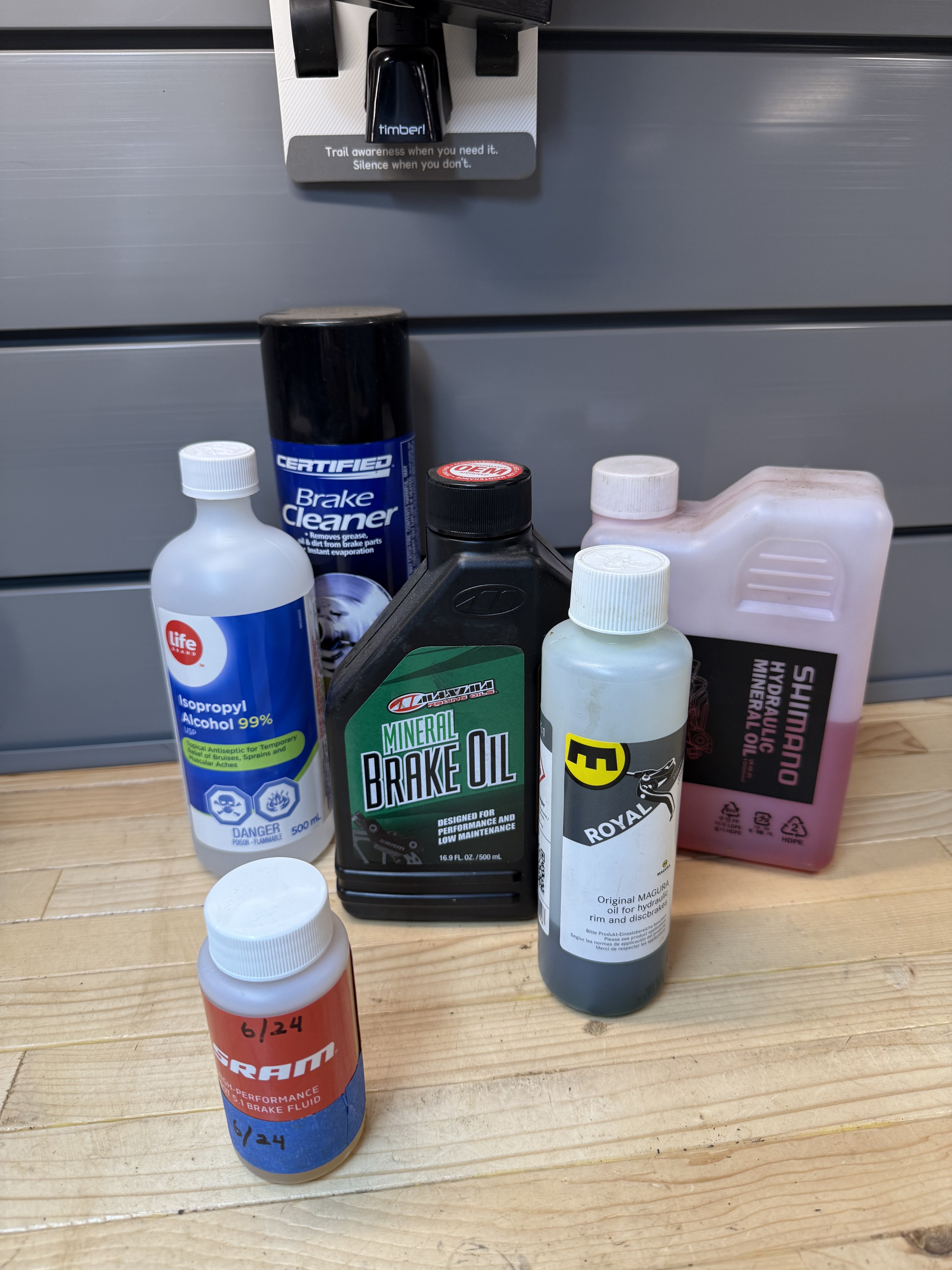

What kind of brake fluid would you use? DOT fluid or the specific brake fluid for that particular brand of brake system? Will certain types of brake fluids damage seals and O rings in different brake systems? …even when cleaning and re-lubricating pistons that were cleaned by iso or brake cleaner?
My LEVO uses DOT 5.1 as I think most MTBs do these days. DOT 5.1 is a glycol-based fluid compatible with DOT3, and 4 (apart from temperature rating). The standout is DOT 5 which is a silicone-based fluid and must not be mixed with the others. If a DOT 5 system was thoroughly cleaned and then DOT 5.1 used, (or vice-versa) I'm not sure if seals and hoses would be o.k. My guess is not. More info here: DOT 5 vs DOT 5.1 Brake Fluid: What’s Best for Your Brakes? - AskMyAuto.com
Majority of MTB brakes use mineral oil these days. Even SRAM is switching from DOT to mineral oil, as evidenced by their latest models like Maven and Motive.
I would suggest not putting mineral oil anywhere near pistons or caliper internals...it will destroy piston seals. Clean with alcohol and lubricate with brake fluid only before reassembly.
IIRC Shimano recommends the use of mineral brake fluid oil with its 4 piston MTB brakes so are you saying that this is wrong?
It’s my understanding that brake fluid’s (Dot or Mineral) also have different boiling points. Dot fluids are heavily regulated …mineral fluids …not so much.
I use the recommended brake fluid. The boiling points and additives can vary between fluid brands. The warranty on your brake system could be void if you decide to mix things up…so I don’t mix things up.
Dot fluid is good but there are pros and cons. Shelf life, moisture absorption, bad for paint. I’ve used Magura Royal Blood as a facial moisturizer during a full bleed before …when I pressed too hard on the syringe and caused a mini-explosion …good times 🙄.
Anyways, I prefer not to use Dot fluid brake systems. In fact, if I could store that little bottle of Dot fluid in a secured bunker, behind a safe, 50’ below my home, I would, but a family member needs it. 😉
