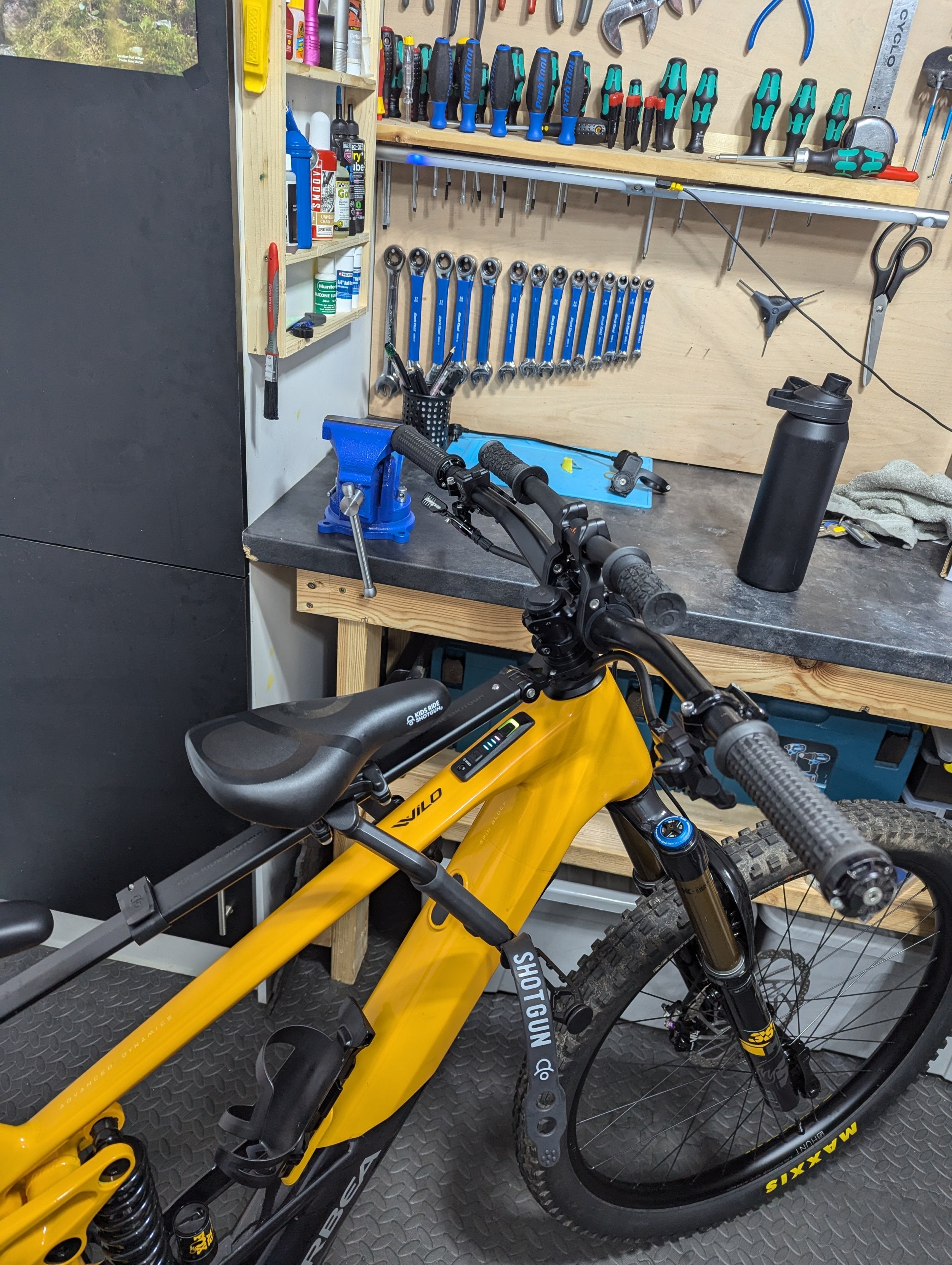

You need the SIC HS02-06 universal headset cable collector for HS02 internal cabling headset.
This allows you to use a normal stem and headset spacers, although this will allow the top of the Fork to hit the downtube if you have a smaller frame. Not an issue for me on a XL, but not sure about smaller sizes.
I've attached a picture with a different angle so hopefully you can get a better view. The headseat routed cables make it a little more of a faff than it should be, but still not an issue.

To be honest, it's not fun!
Since this picture, I've actually gone for a wireless Dropper and SRAM AXS transmission wireless just to have less cables going through the headset.
I've also switched the headset to the easybikeparts IS52 headset as it allows for headset cable routing without going through the bearing and the original headset kept creaking!
But now I just have the rear brake line going through the headset.
