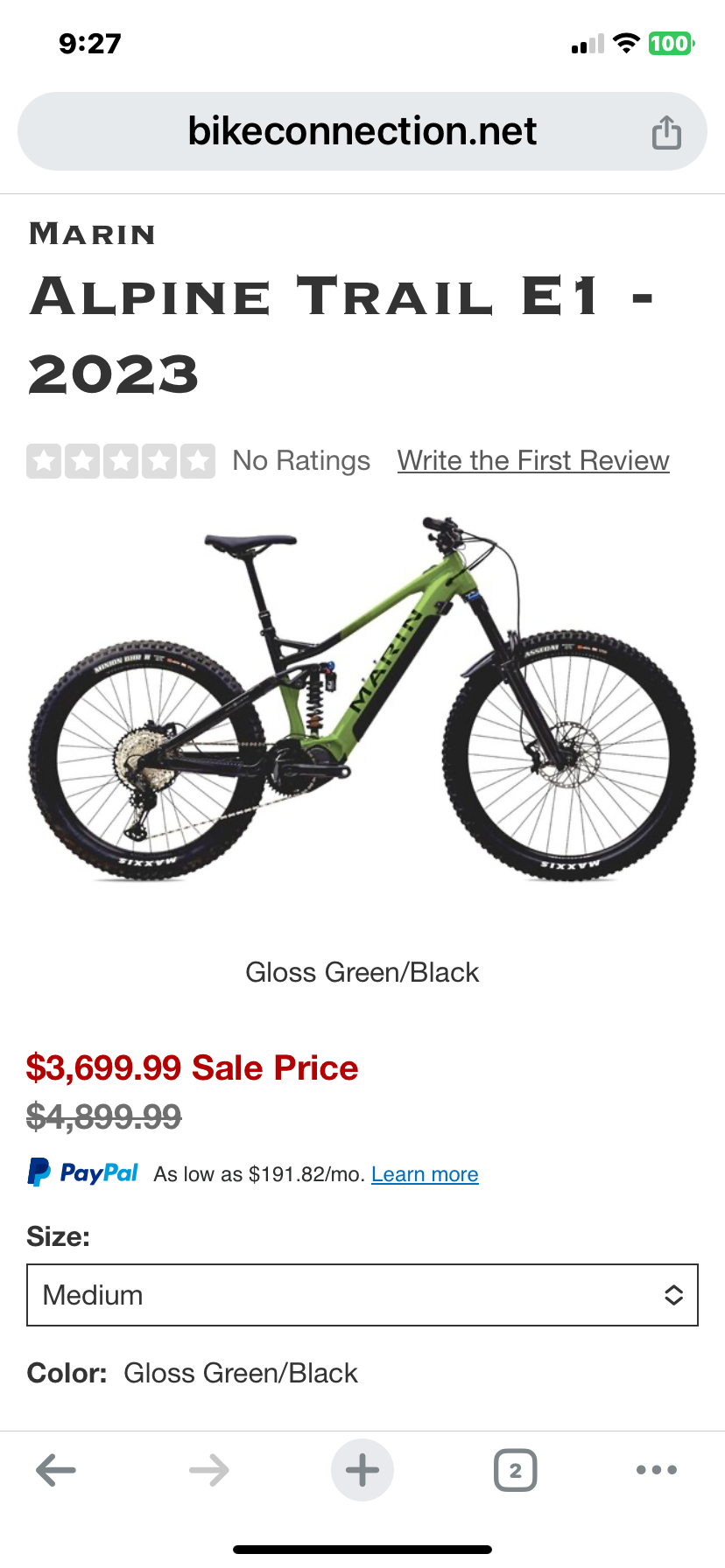

Not sure of the exchange rate but I think the Marin is cheaper. I am pretty sure the Alpine trail is getting a redesign so the are marked down.
Marin Alpine Trail e1…. Best deal I can think of for your use.
My Girlfriend has one. It's a nice bike for the price. The 500 watt hr battery is just enough to get the OP up as high as he wants to go. Maybe even 2 twice. Great Idea mate. The only thing is the 2 amp character. It take about 6 hrs to change from 1 battery bar. My Rocky Mountain Powerplay Altitude has a 720 watt hr battery and with the supplied 4 amp character I can charge mine from 2% to full in 4 hrs or so.

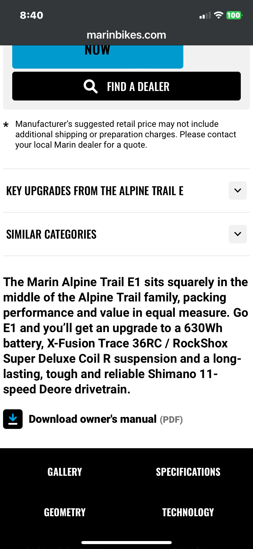

The Alpine trail E1 has the 630wh battery, the E has the 500wh battery.
No, it's a 504wh battery. The Alpine trail E2 has a 630wh battery.
The alpine trail e has the 504wh battery, the e1 and e2 have the 630wh, below is a screenshot shot from the Marin sight of the e1 model. In the 2024 model year Marin came out with the e level models to make an extra low entry level e bike.
Her's is a 2023. I see they made some up grades to them as well as the battery. Better drive train as well. That is a lot of bike for $3,700 dollars. I think my girlfriend paid more for her 2023. Crazy. Thanks for posting the new bike info. If I needed a new EMTB this would be on my shirt list..
