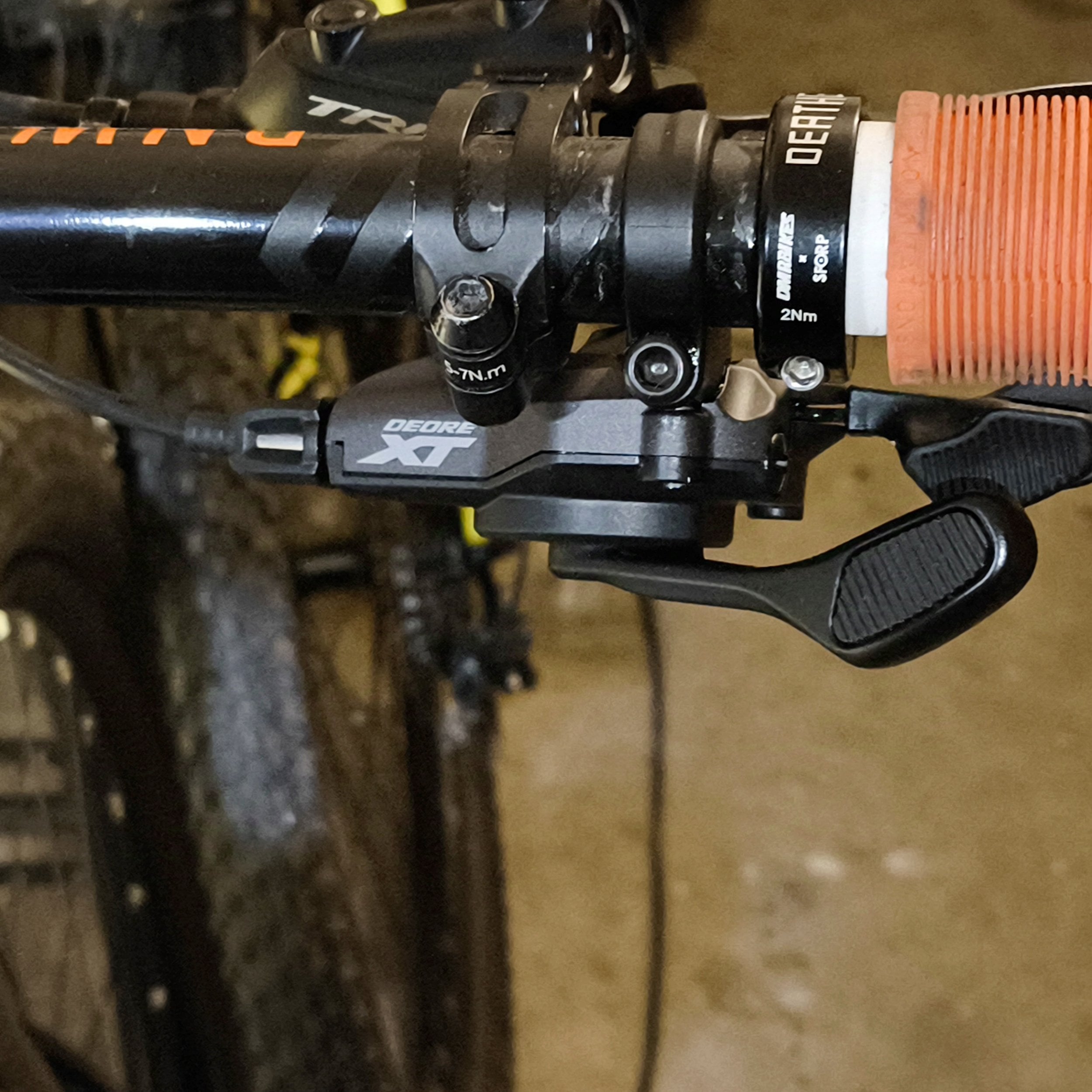

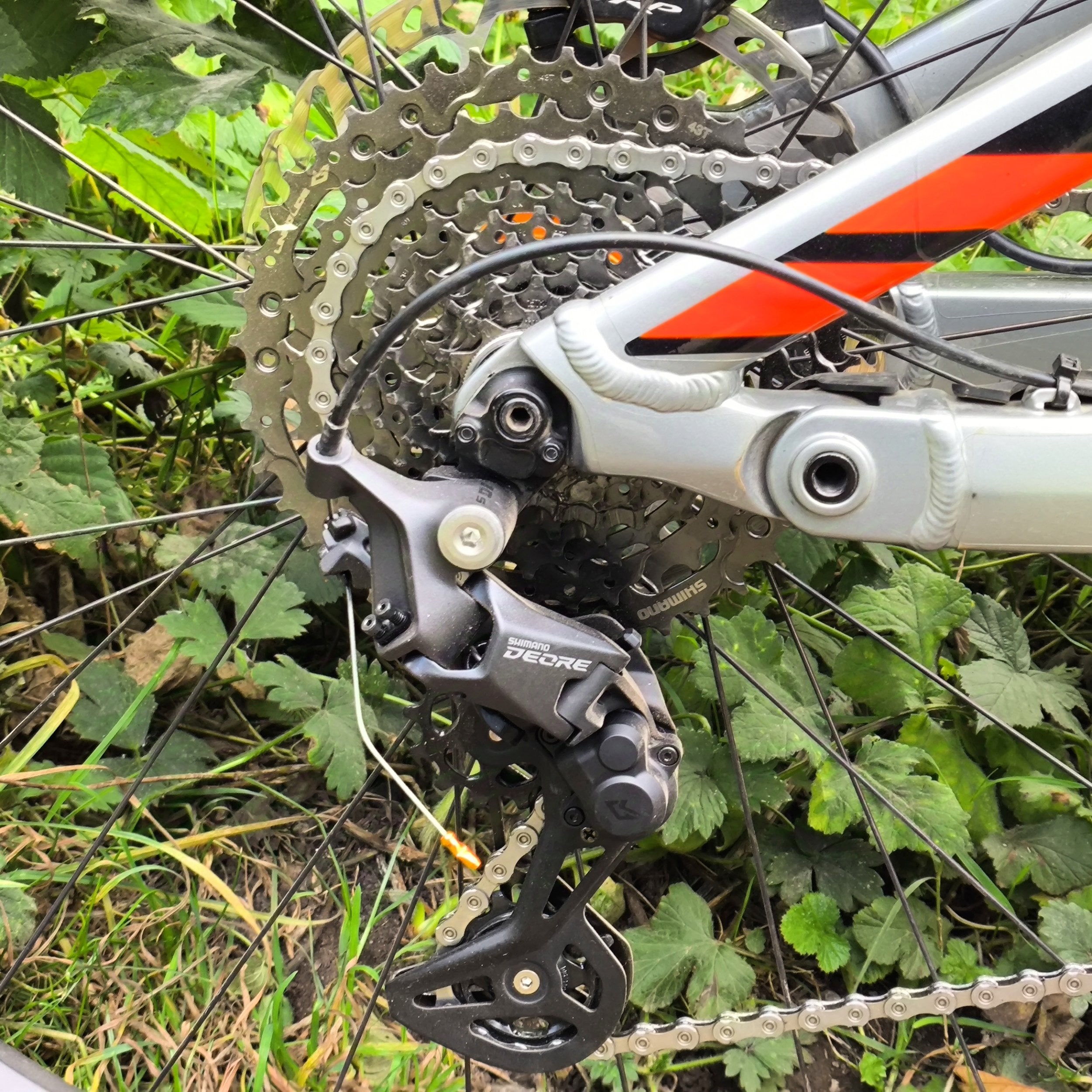

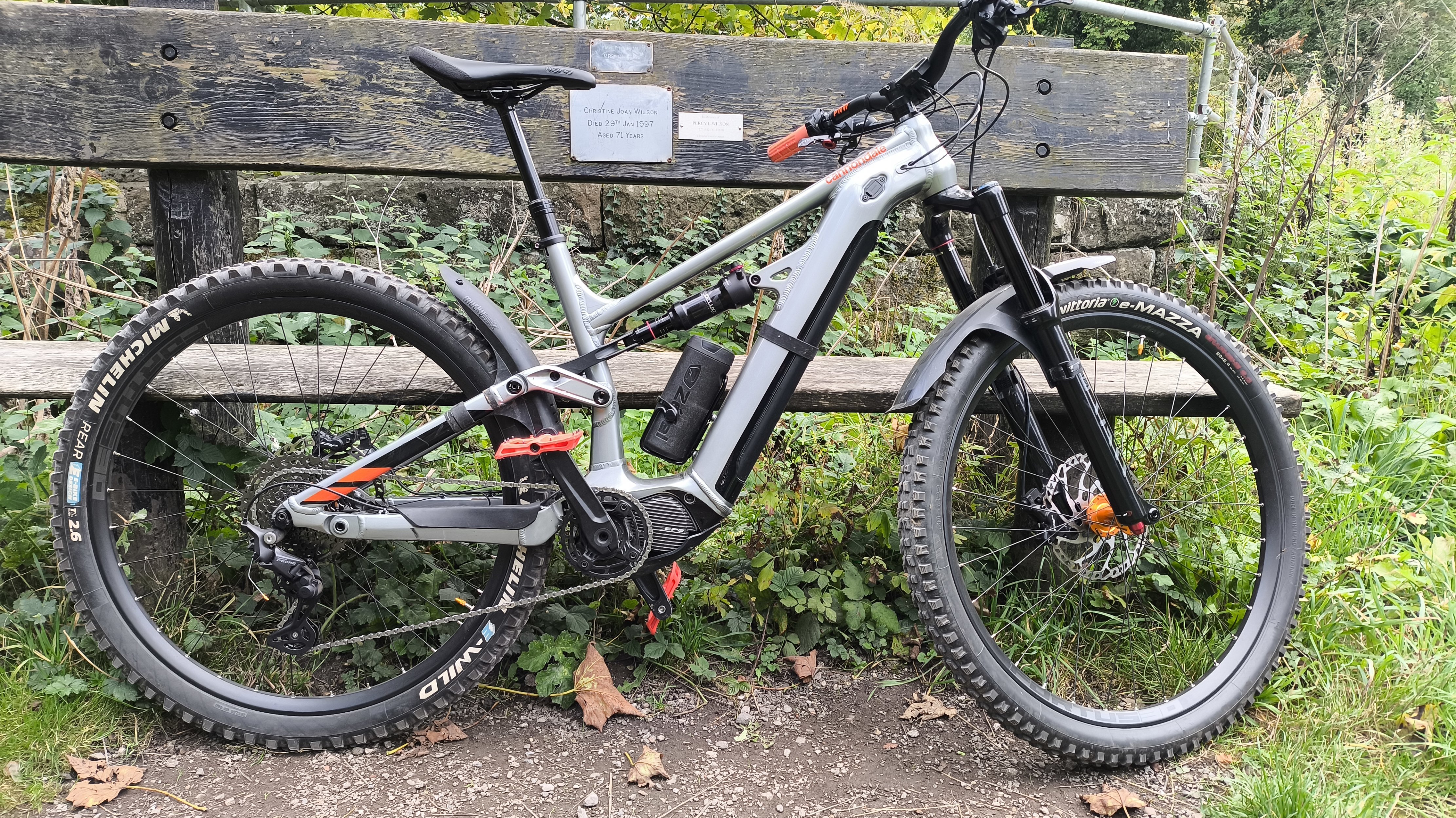

Yes it's fitted and all good. The only problem you'll probably run into is the original B screw is laughably short. I pinched the screw out of the SRAM derailleur I replaced (don't forget to swap over the small friction block before installing the longer screw).
When installed it's just a case of limiting the upper and lower screws to get the correct cassette range, and setting the B screw. The 11sp XT shifter works fine with the 10spd Deore derailleur. The shifter has single downshifts (going to a larger sprocket, easier pedalling) if using your forefinger, or double shifts if using your thumb. Which is great.
Shifting is a little slower, say 0.2 seconds which takes a while to compute that you need the pressure off the pedals slightly longer than normal, but once keyed in, it's a smooth firm shift. First ride setting the gear cable tension is also critical but easily done whilst riding, the drivetrain taking about 15 miles to bed in, it gets much smoother after those initial first miles and you change your 'off pedal pressure timing'. Single half shifts with the thumb (to a larger cog) aren't super accurate but work as your guessing the single shift point (bar the full double shift from the thumb).
Changing gear on techy climbs is WAY easier with the double shift, two full presses and you've moved 4 (over the NX shifter I had before) and being a 10spd and not a 12spd thats bloody fantastic for gradient changes. Here's a few pics:
I forgot to add, you will need a spacer between the hub and cassette (you will probably already have one fitted on the HG driver). Ensure it's on before torquing up to 40NM!
