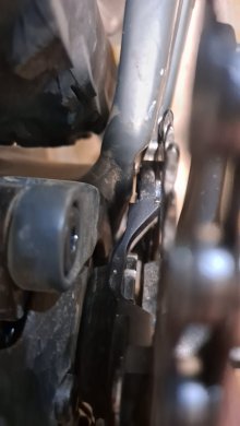

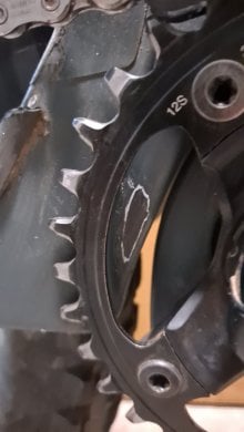

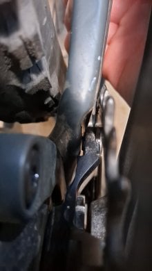

Chainstay Clearance/Chainring Bolt Rub/EP8 Crank Spring loaded Play issue:
After about 450 miles the chain ring bolts are rubbing on the chain stay when the cranks are laterally loaded. It seems the very tight clearance between the crank spider and the frame do not tolerate the spring loaded lateral play in the EP8 Motor system. From what I've read this play is normal for the system. Though it must have increased moderately because the conflict did not exist prior to this week. I did not bend my chain ring. As you can see from the photos, the distance between the stay and the chain ring spider is a few millimeters. Beyond the fact that this space seems too tight given the chain ring spec; there is not metal or rubber insert in the area of conflic to prevent rub/scratching on the carbon chain stay. I put some frame tape in this area but it was quickly eaten through. I'm concerned continued rubbing/scratching will eat at the chain stay to the extent of compromising the carbon. I've let both my dealer and Scor know as of 24 hours ago. For now I'm trying to drum up some slightly shorter chain ring bolts to reduce or eliminate the scratching. The stock bolts are T30 head M8x8.5. I'm going to put in some steel 5mm hex head M8x7mm bolts. On a separate thread this issue was discussed and it seems some Scor 4060 Owners were complaining of this in Italy. My guess is that they spec'd the same rear triangle on the EMTB as their Acoustic MTB and it didn't factor in the spring loaded play in the EP8. Photos 1) chainring bolt clearance without lateral leverage on the crank 2) chainring bolt clearance with lateral leverage on the crank 3) Wear area on the chainstay from the chain ring bolts.
Will keep you guys posted on the outcome with the the bike shop and Scor. Also, will let you know which bolts end up working for the short term fix.

Update from the Bike Shop and BMC/Scor. The Chainstay rub issue is known and "cosmetic" the fix is spacer for the crank as I understand it that will put the crank slightly outboard of it's current position. They will also install a chainstay protector. Once the parts get in the bike shop will install at no cost to me courtesy of the BMC/Scor Warranty issue.
Meantime, I swapped out my current bolts which were 8.5mm thread length for 6mm thread length, steel, single chain ring bolts made by MCS. Got them on Dan's Comp for $5.99. I torqued them to 10nm as I had issues shearing some bike co-op steel bolts of similar length. I tried to install at 12+nm. It might have been me over torque-ing with my giant automotive style torque wrench, but I had two different bolts shear the heads right off. Put a little grease on the MCS bolt threads and back side of the bolt head and torqued to 10nm. Haven't had any issues loosening. Been checking after each ride. Obviously, you do you, at your own risk. Good news is that the 6mm bolts clear the chain stay. Have to be honest that if I left the OEM bolts in there and kept e-mtb-ing away, I believe the issue would have been more than "cosmetic"
